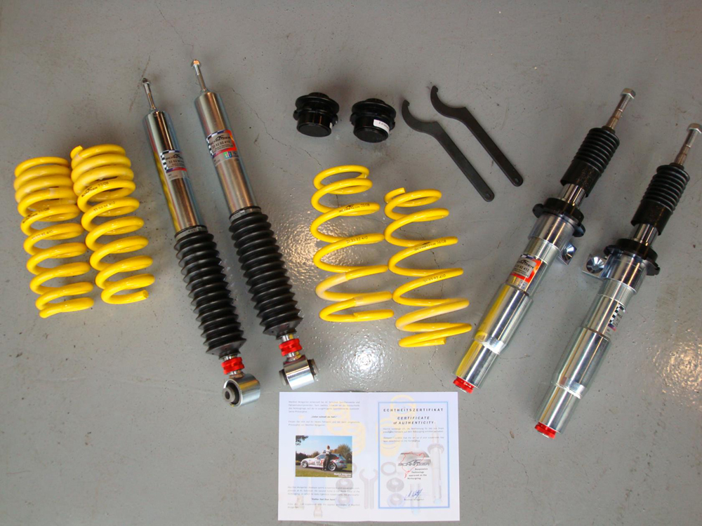

KW Club Sport
www.kw-suspension.com
MSRP $3,595
  • Height Adjustable: 0.4"-1.5"F/0.2"-1.4"R
  • Spring Rates: 514F/800R
  • Wheel Rates: 474F/269R
  • Compression and Rebound Individually Adjustable: 9 levels/18 levels, via special tools
http://www.m3post.com/forums/showthread.php?t=231678
http://www.m3post.com/forums/showthread.php?p=6047702&posted=1#post6047702
Image hosted on: i617.photobucket.com
Post referenced by rzm3 in Guys with KW clubsports...come in 12-14-2010
Post referenced by rzm3 in AST 4200 & Vorshlag Camber Plate Review 05-18-2011
