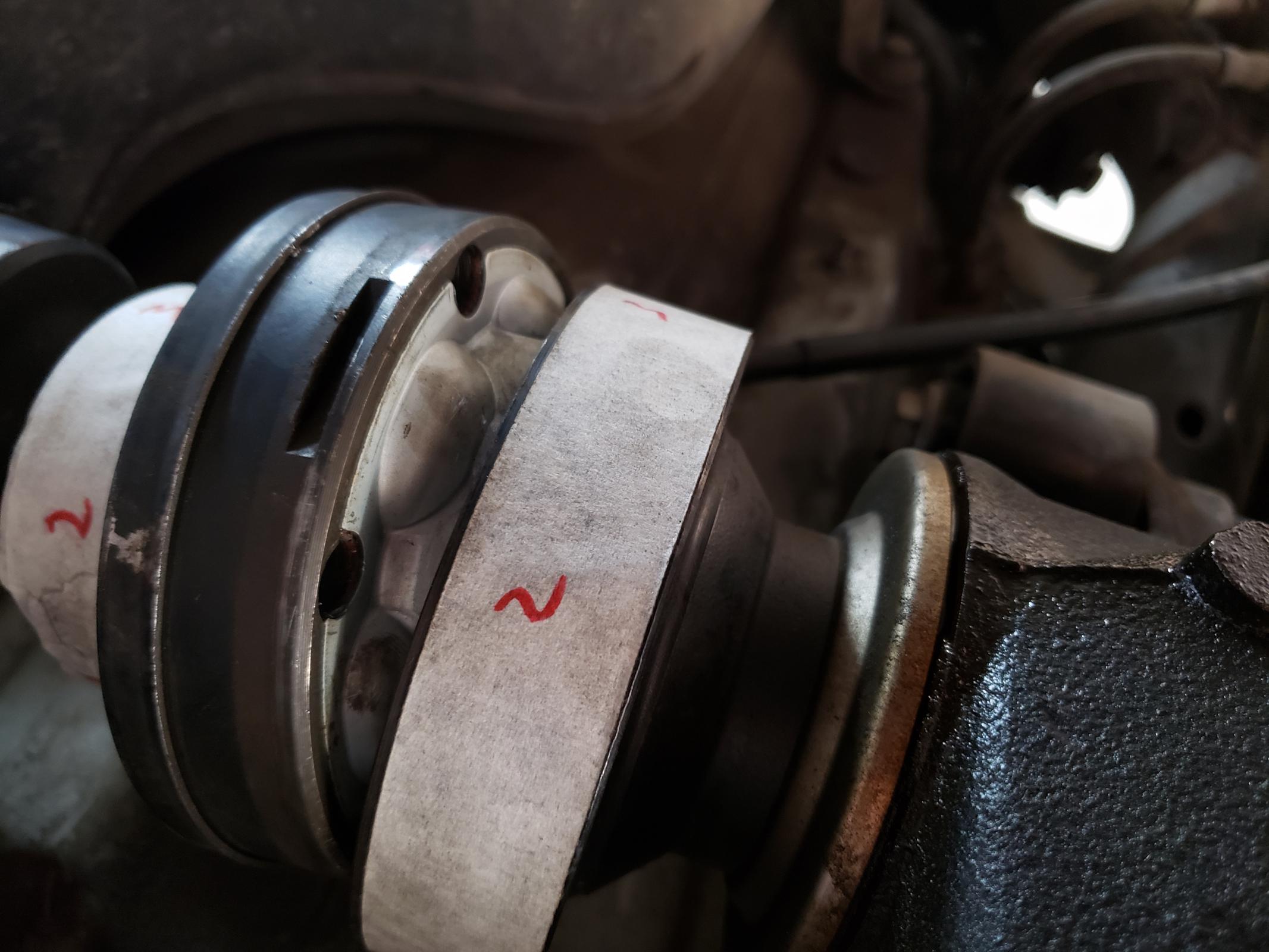

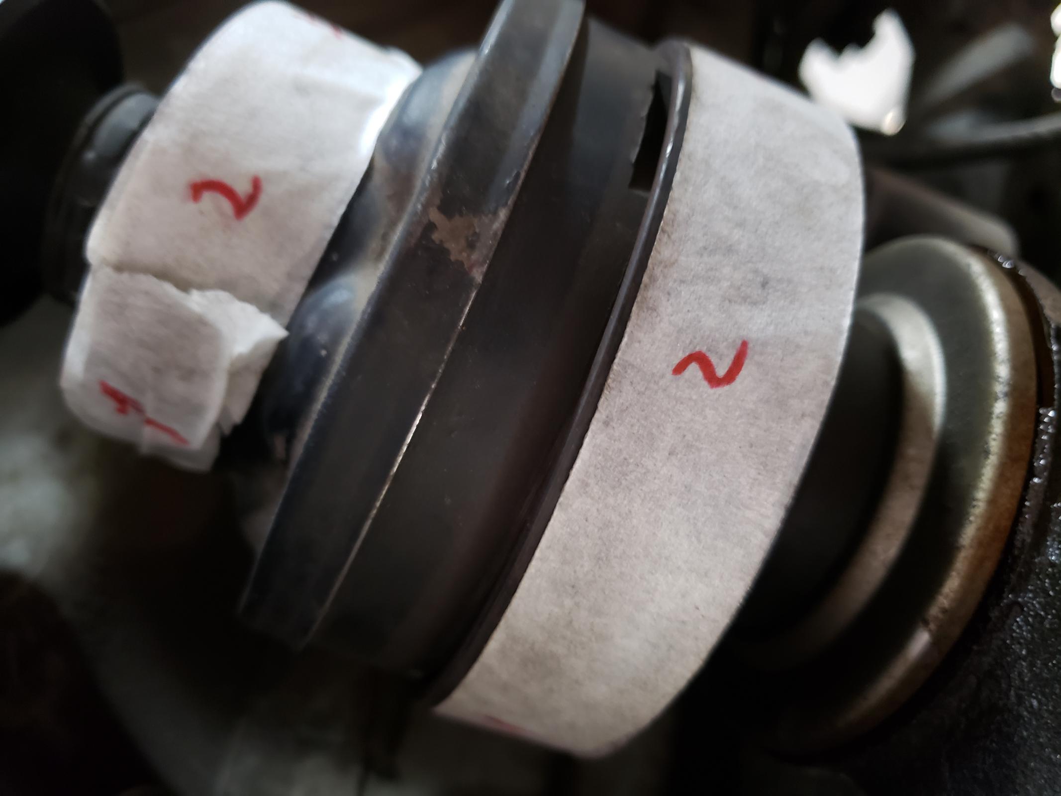

c. Remove the 6 drive shaft bolts. A torx E12 socket will be needed. Mark the position of any colored (weighted) bolts to return them to the same position. If you are following BMW's recommendation to replace all of these bolts, be prepared (or prepare in advance) to have any needed specialty (green or black) bolts on hand.
d. Mark the position of the pinion nut with a line, remove the flimsy pinion nut retainer and count how many thread rotations is it to the return the pinion nut to its original position (not shown). Also draw the same line on your socket (32mm).

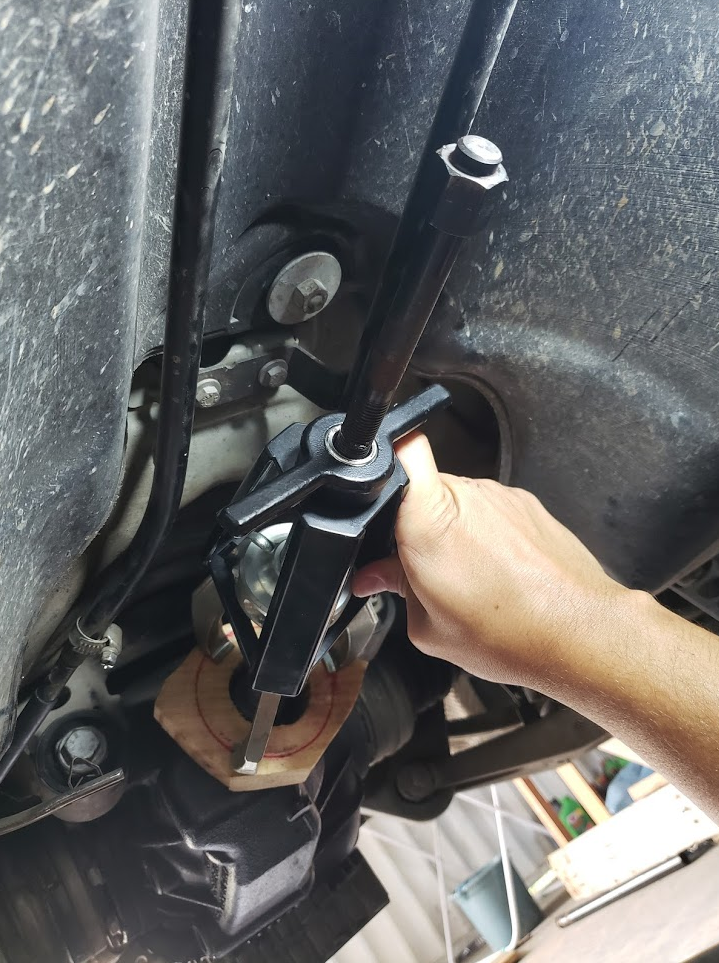

e. Use puller (this cheap one works fine for this job) to remove driveshaft flange.

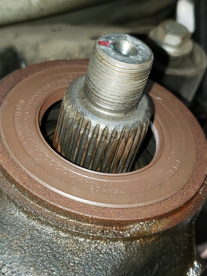

f. Remove the leaking pinion seal with a seal puller tool.
g. Use a seal driving tool to hammer in the new pinion seal flush with the lip oft the differential (the Miller Pinion Seal Installer 8891 is widely available on Ebay, sells for cheap and offers great fitment for the E9X M3 diff). Coat the sides of the seal with diff oil.
h. Admire the new pinon seal, coat the face of the drive flange with oil and reinstall everything in reverse order. Top off the differential with oil (you'll lose just a little during this fix). The online TIS offers up two competing torque specs for driveshaft to differential bolts (ZNS M10 with ribs), which to appear to both offer a final torque value very similar to one another, either:

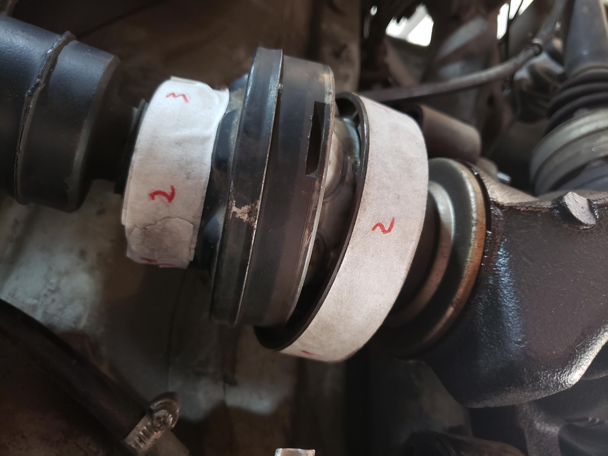

Hey guys
I'm planning on doing the pinion seal soon, when I'll do the aluminum subframe bushings. As the diff will be off the car, should be easier.
By the way, I don't have the seal installer, could improvise with a wood block, but I'm afraid it doesn't fit so perfectly. As I'll use dry ice to shrink the aluminum sf bushing, can I do the same to the pinion seal, in order to avoid needing the seal installer?
Actually, I think it's not gonna work, because, at the same time outer diameter shrinks, inner does too. Forget about it.
How do I take that off?
That thing doesn't pass through. I feel like there are two separated parts that are united there, but shouldn't be.

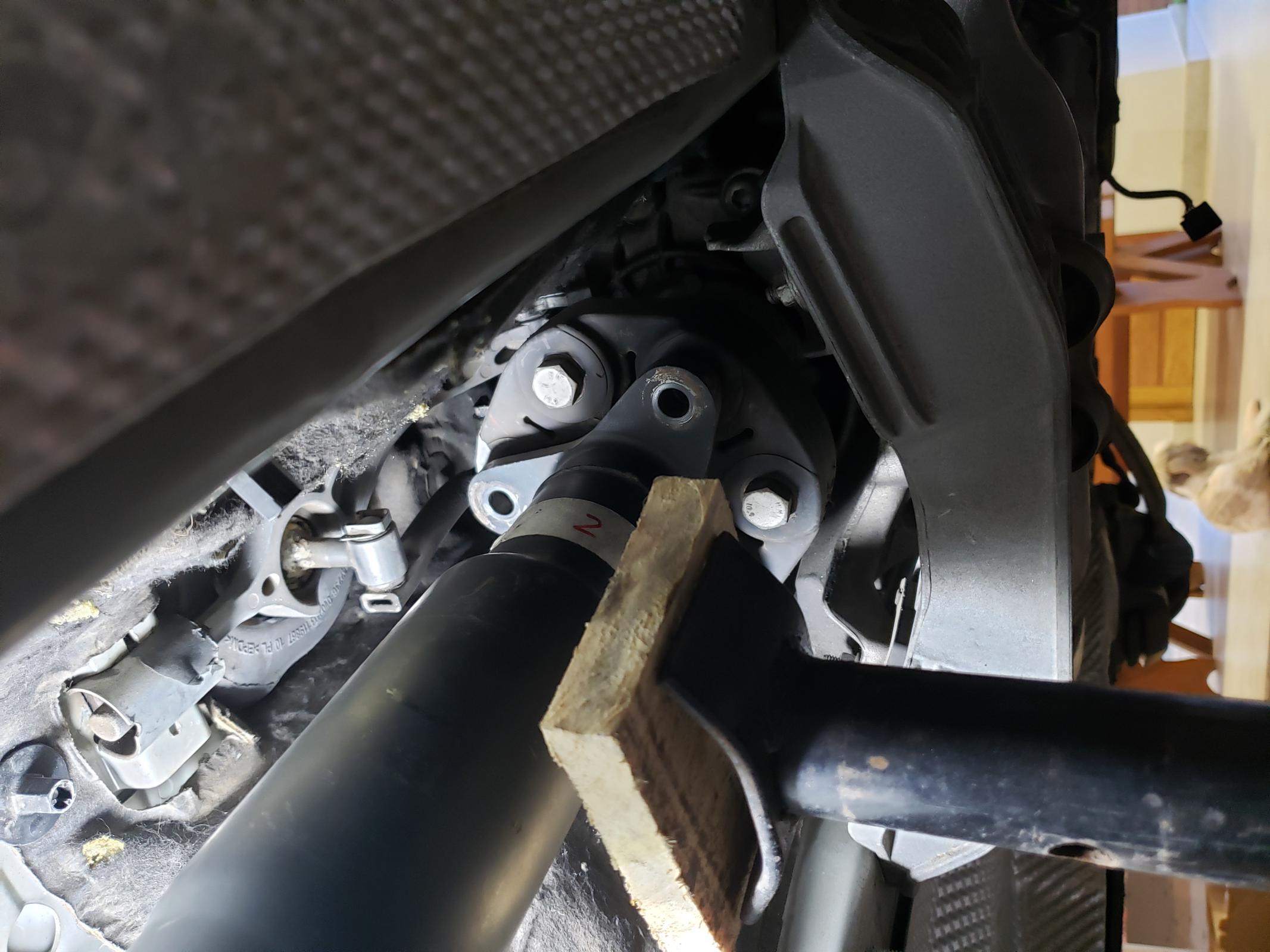

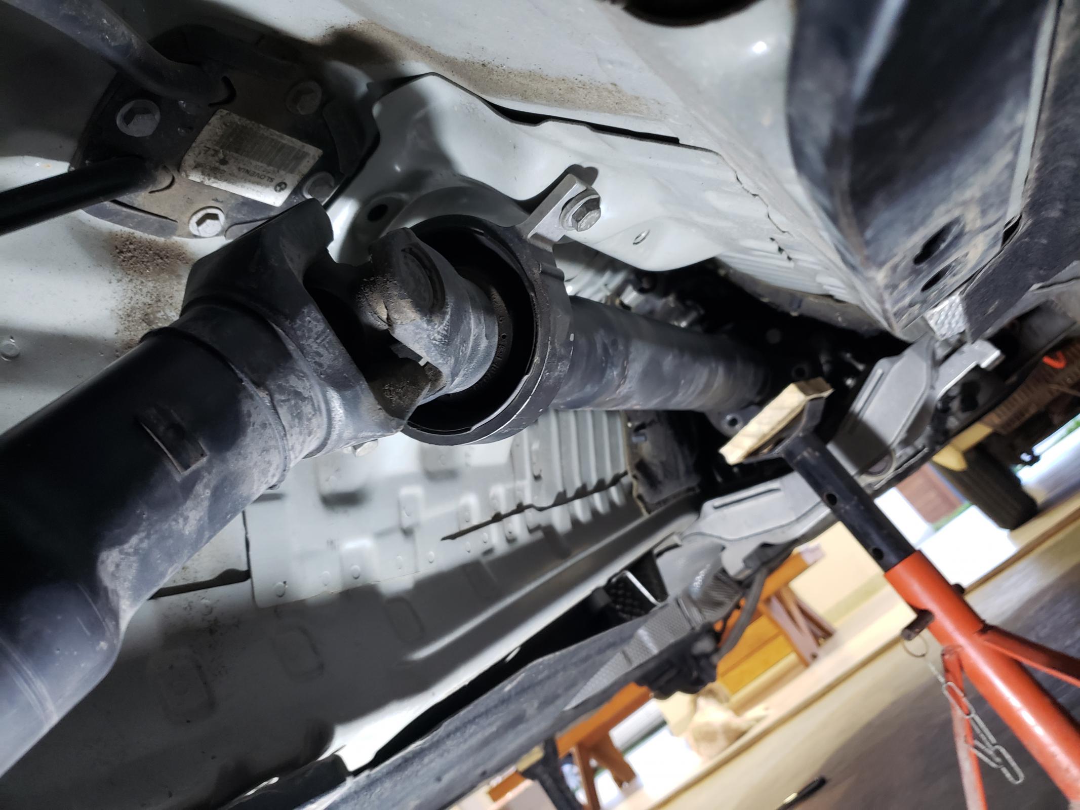

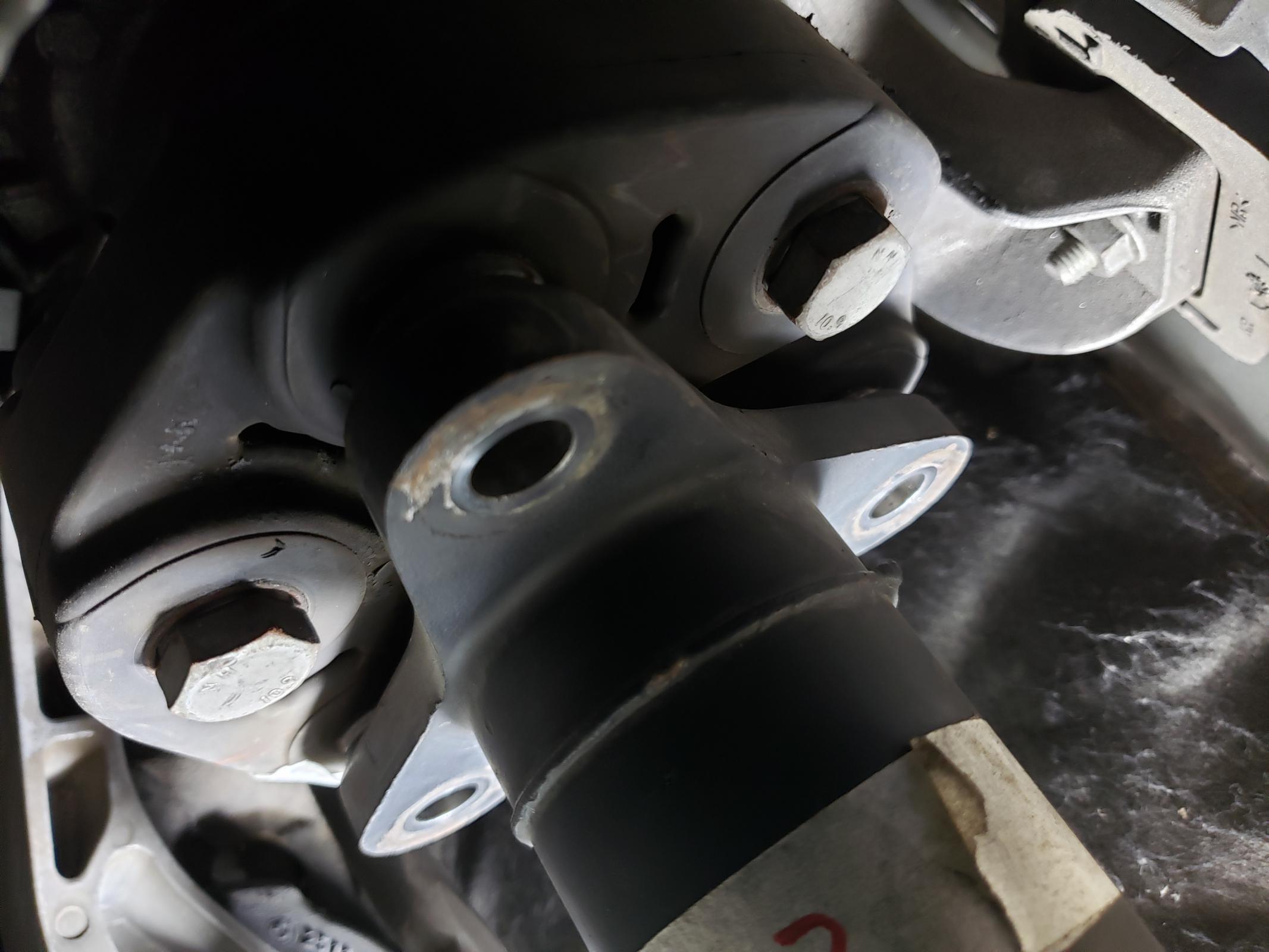

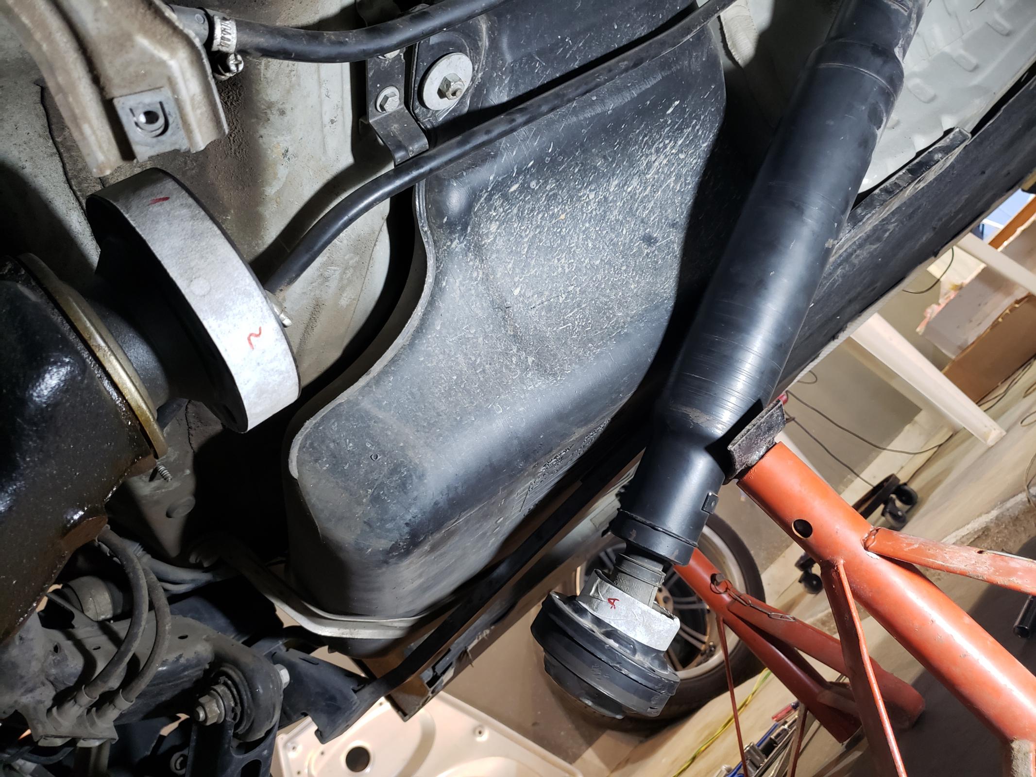

Done.
So, I needed to disconnect tri-angle flange at the trans, and the CSB, in order to fold the drive shaft, and get the clearance to remove it from the diff.
I don't know if every one had to do that and it was obvious, but for me it didn't look obvious. So if it's the case, OP should consider adding that information in the letter C of the procedure.

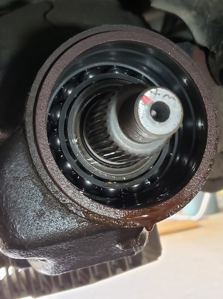

Pinion nut wouldn't go out, so I used the impact wrench. Easy!!
But I wasn't able to count the thread rotations.
After removing the nut, I drove it back again and counted 9 easy rotations, and the 10th one would be the torque rotation.

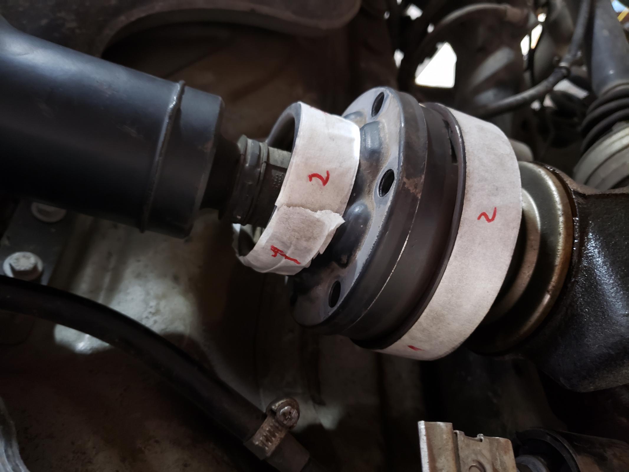

Guys,
I installed all back, no problems. It's pending only the exhaust, because I had to travel on work, leaving the car home.
I'm going home this week and before I install the exhaust, I'd like to ask: I didn't coat with oil the inner face nor the outer one (refer to the picture below). I just installed it the way it was. Will I have problem with that?
The drive flange was oily, as I just cleaned it with a dry cloth. Did the same with the diff case.
Thank you to the OP for the DIY! I feel good about being able to tackle this on my own. As jvictormp's user avatarjvictormp mentioned I also had to disconnect the driveshaft from the guibo and the CSB in order to fold the driveshaft and remove it from the diff flange. 10 rotations on the pinion nut for me as well. Getting the last bit of the 10th rotation was honestly the most difficult part of the whole process. It would have been much easier to get the leverage needed with the car on a lift.

2/ My puller only has two arms...think that is good enough or will I struggle w/o the third arm?
1. The slippery slope of old BMW maintenance, might as well...
2. 2 jaw puller should work fine, it's not on there very tight.

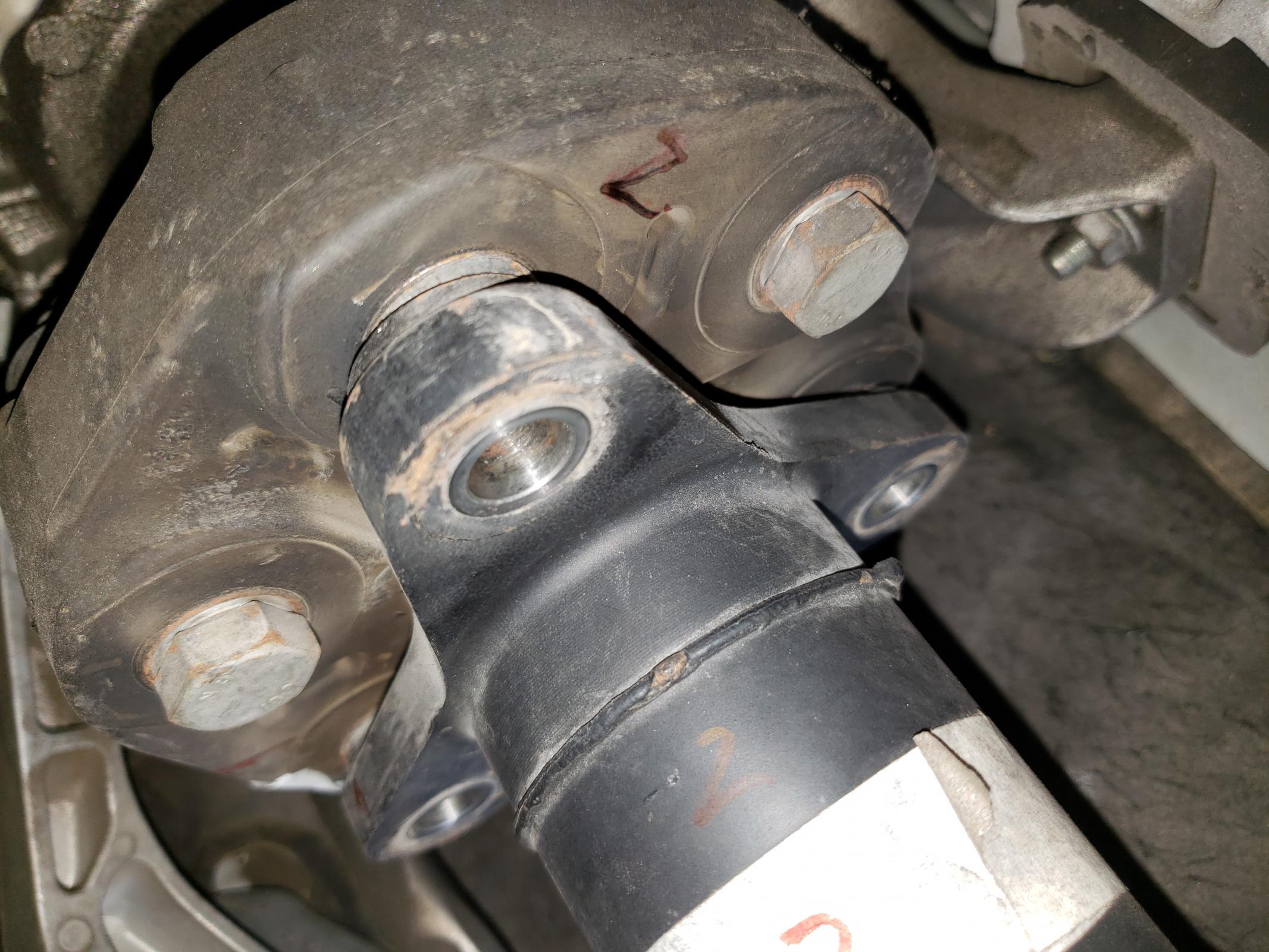

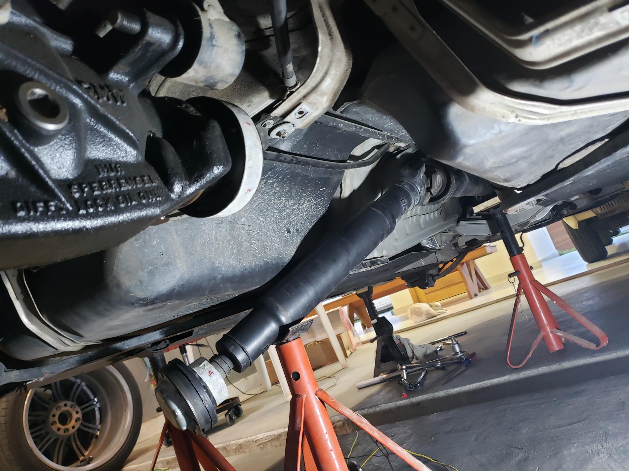

So I removed the drive shaft bolts, but can't get any axial movement on the drive shaft to get it away from the pinion flange. Is the only method to do so as described by jvictormp? I really don't want to mess with the drive shaft near the tranny but I guess I have no choice?
I should also add that the drive shaft is in a position such that one of the trip-flange bolts is exactly at 12 o'clock so no way to really access it.
Thoughts?
And for the axle seals....fyi....now that I am under the car I'm pretty sure they are also leaking....quite a bit of grease all over the area.
