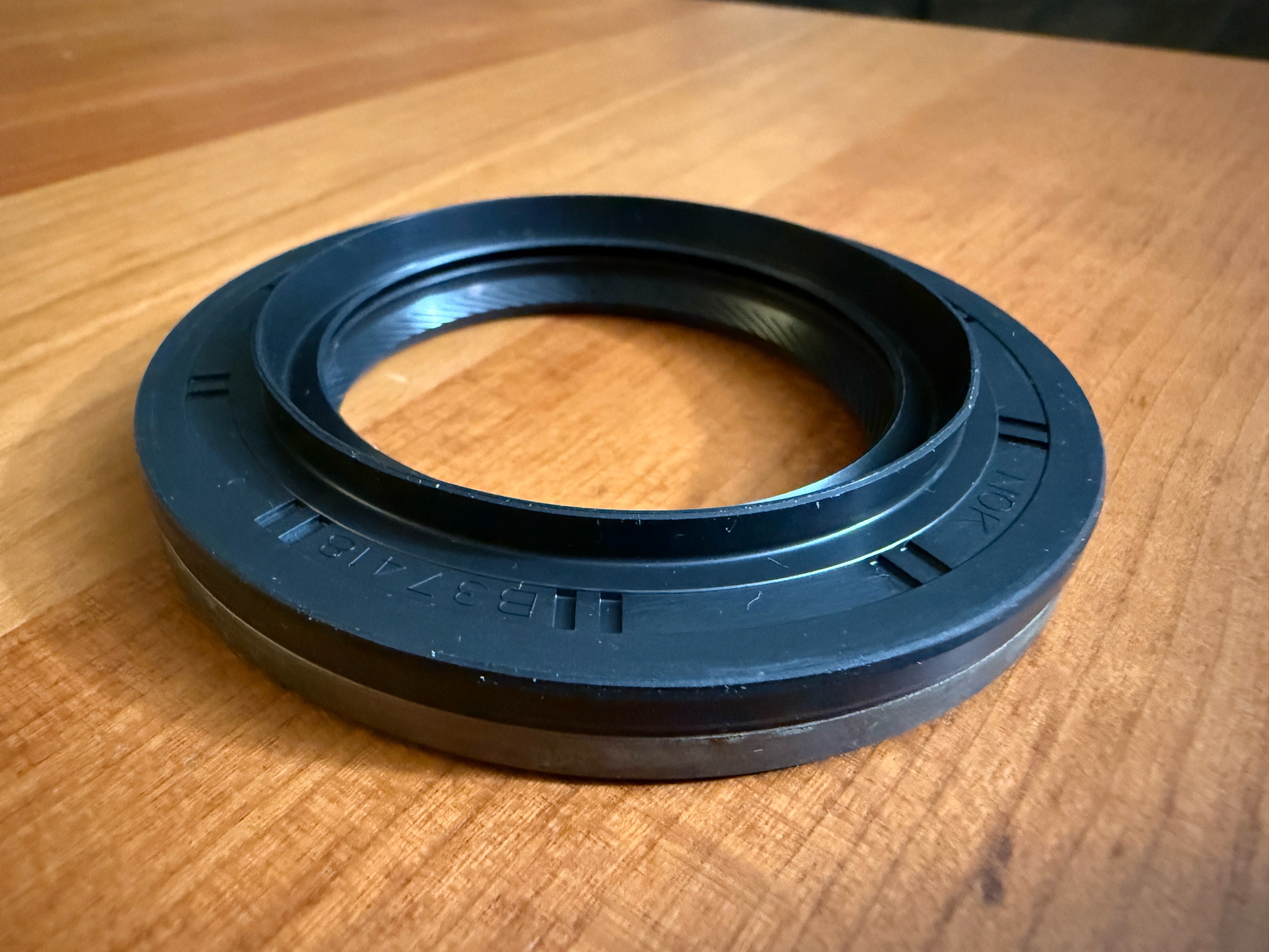

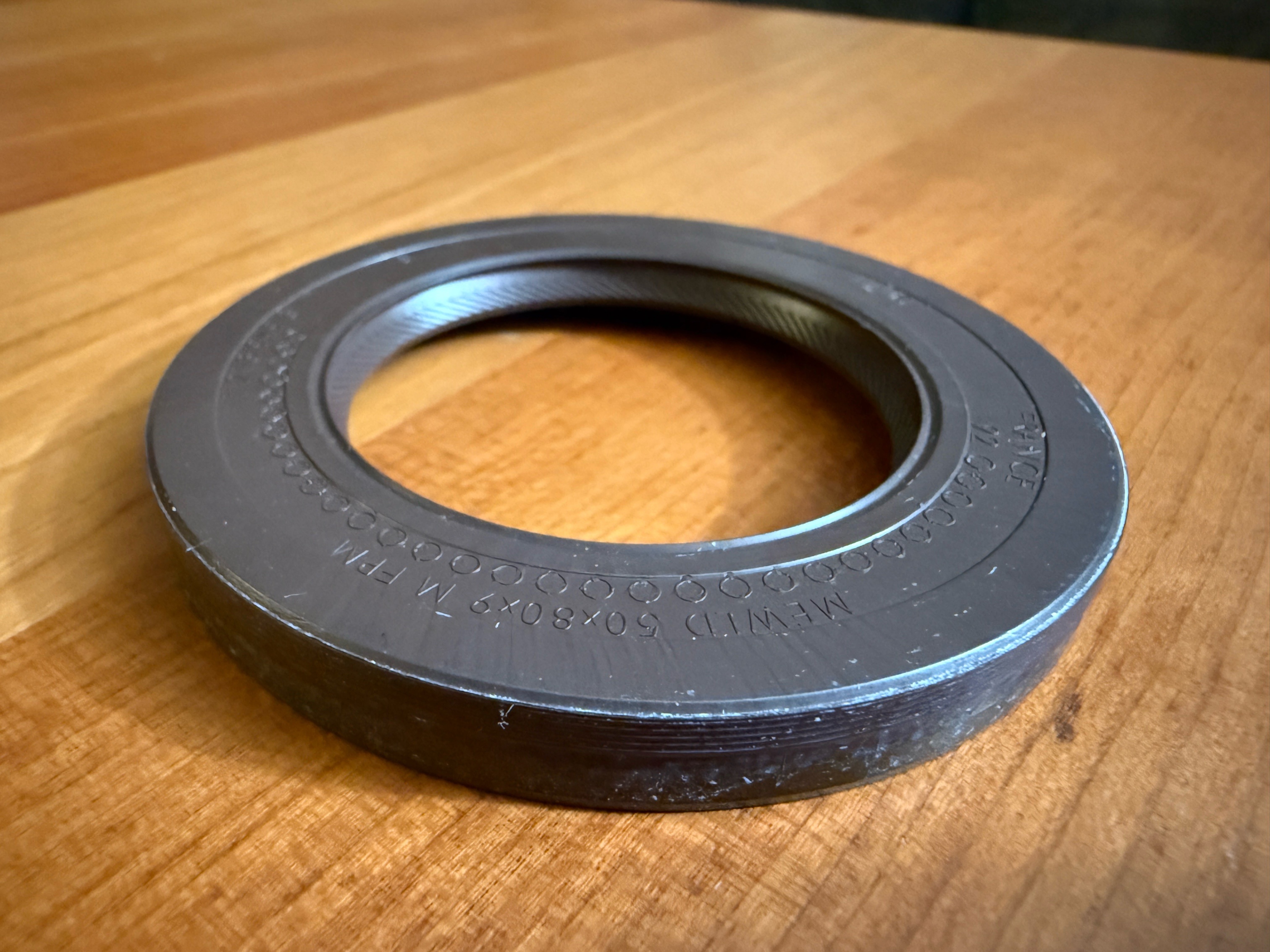

Knocked out the old seal with a screw driver and hammer just fine. Took lots of force.
I didn't find much about getting the seal seated evenly and not crooked, but it wasn't trivial and eyeballing it wasn't working. I ended up making a feeler gauge to go behind the seal between it and the lip on the inside of the output cover: felt good with a distance of 7.5mm between seal and lip. Hammered the seal in using a piece of 2.5" pipe. Lots of force again.

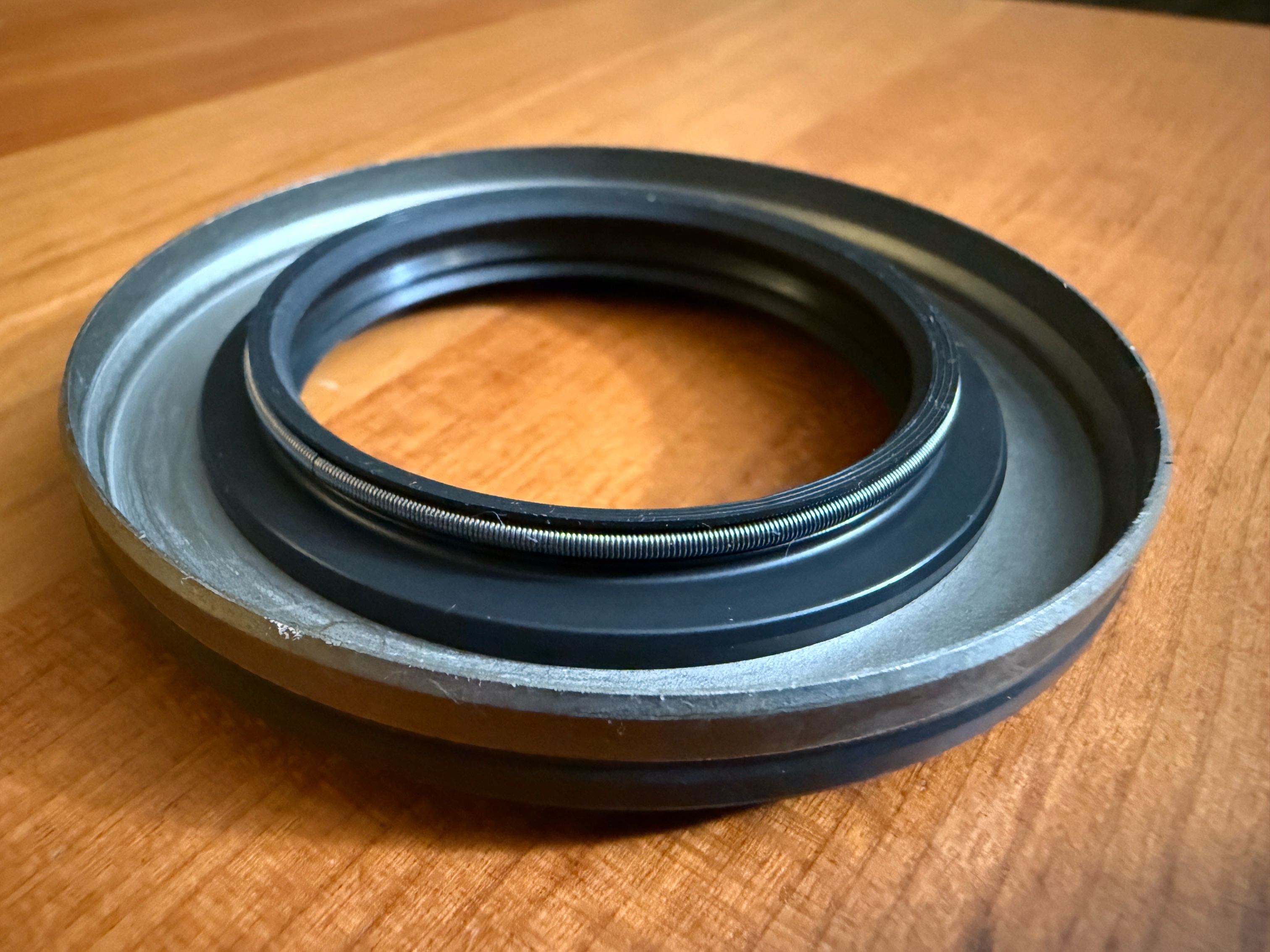

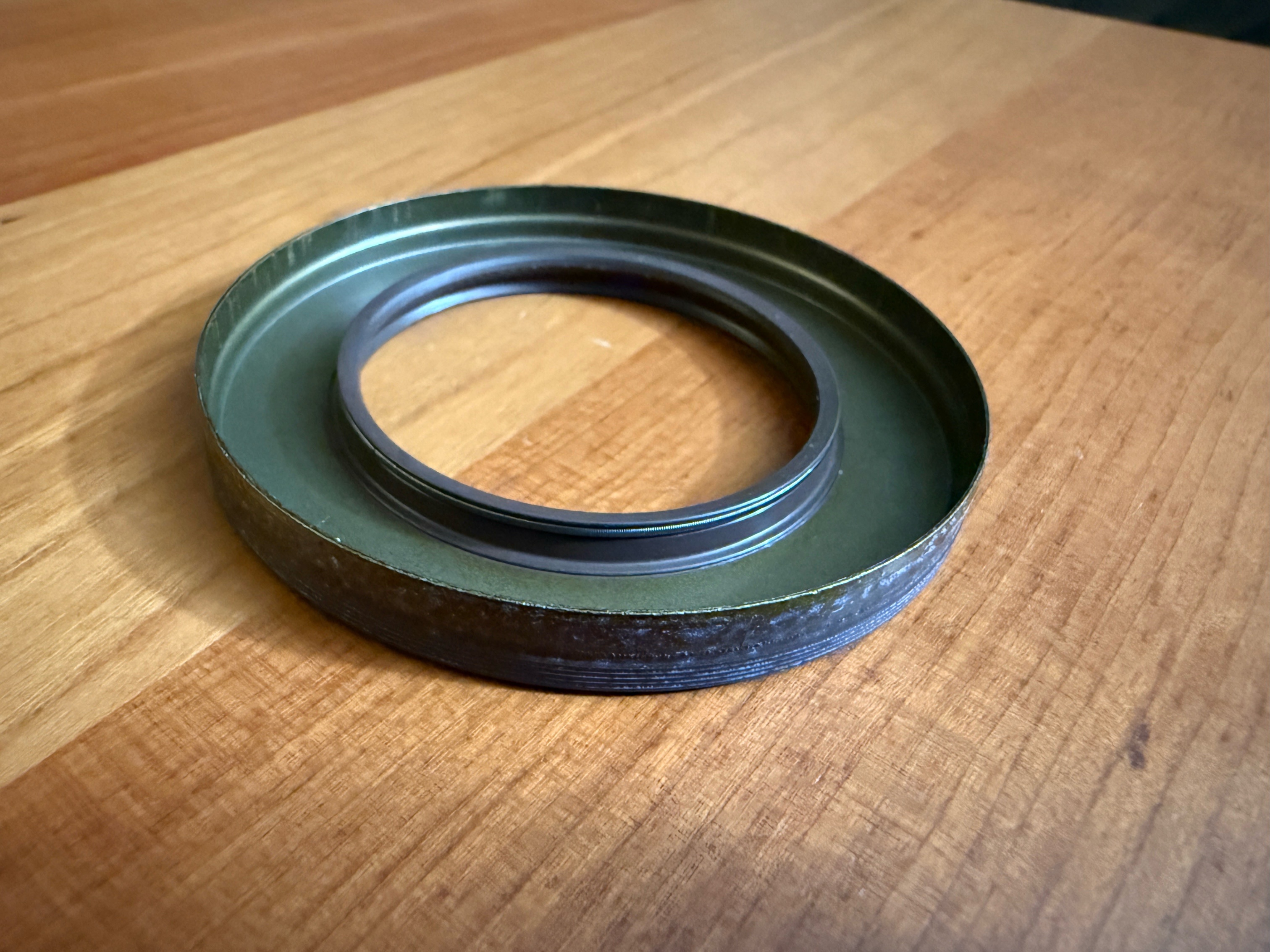

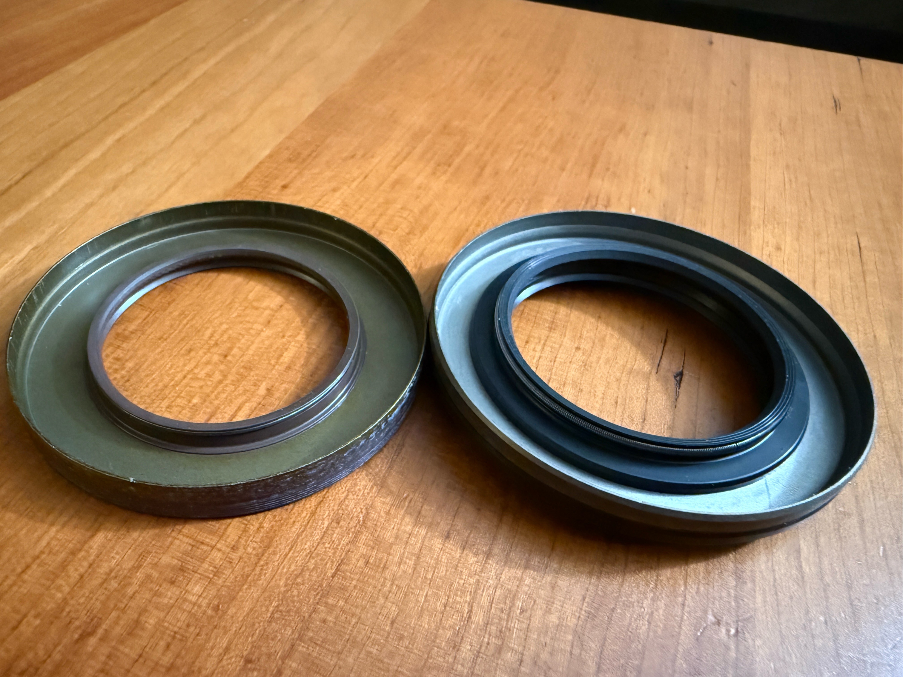

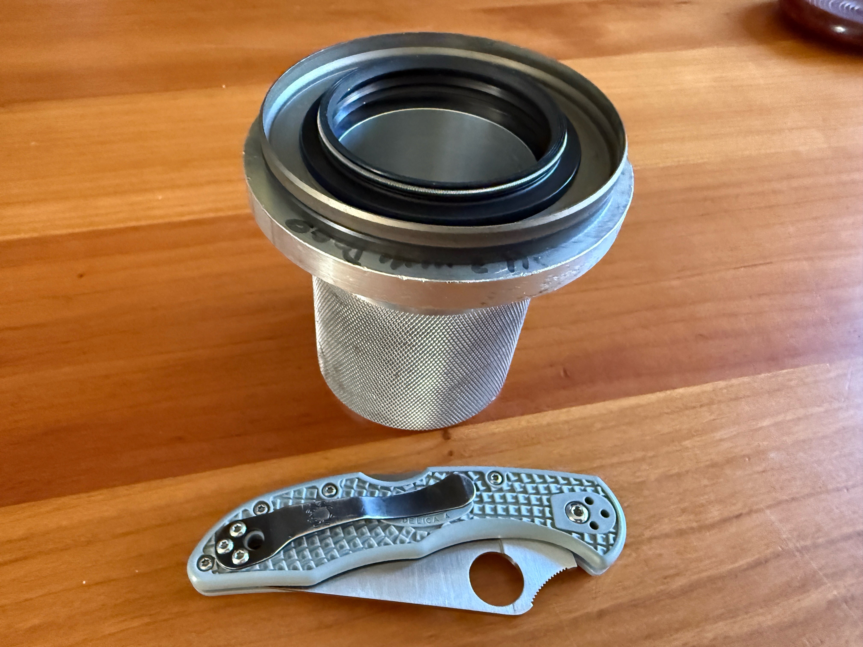

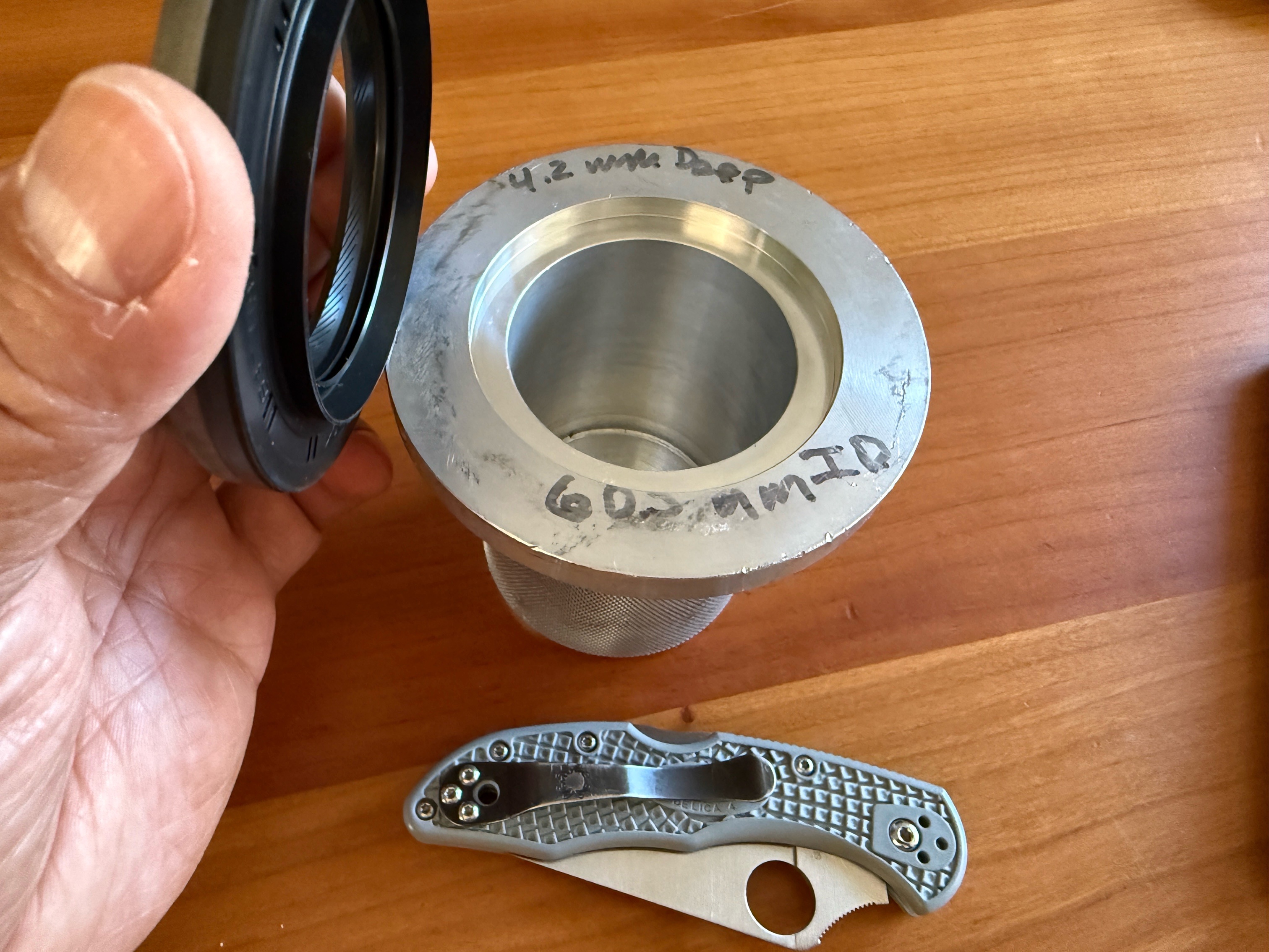

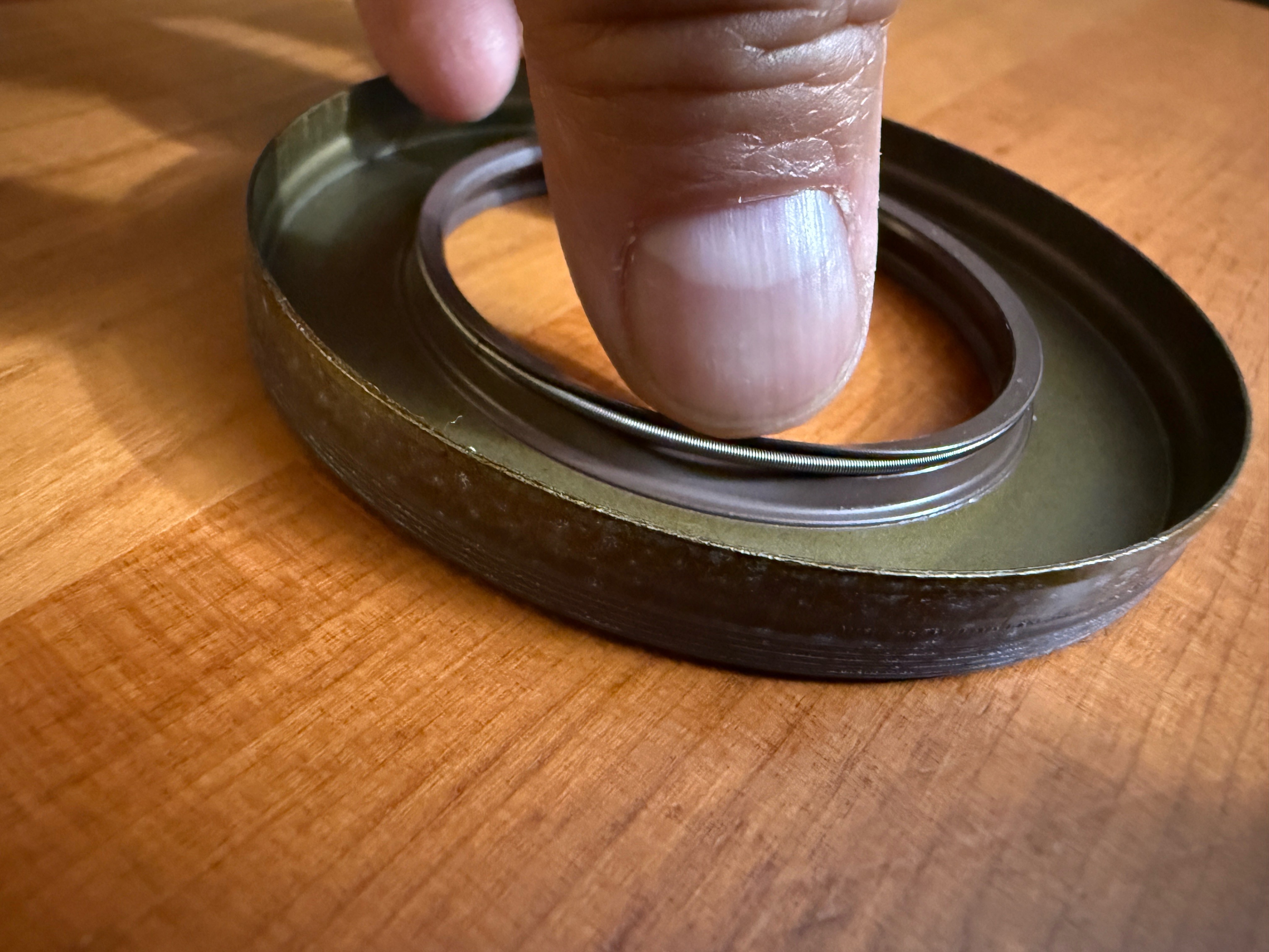

I’m going to try out the upgraded pinion seal from Corteco available from FCPEuro. I’m thoroughly convinced it will outlast the chap, weak bullshit BMW pinion seal. There are two extra seal lips to go through and a bigger, more durable spring.

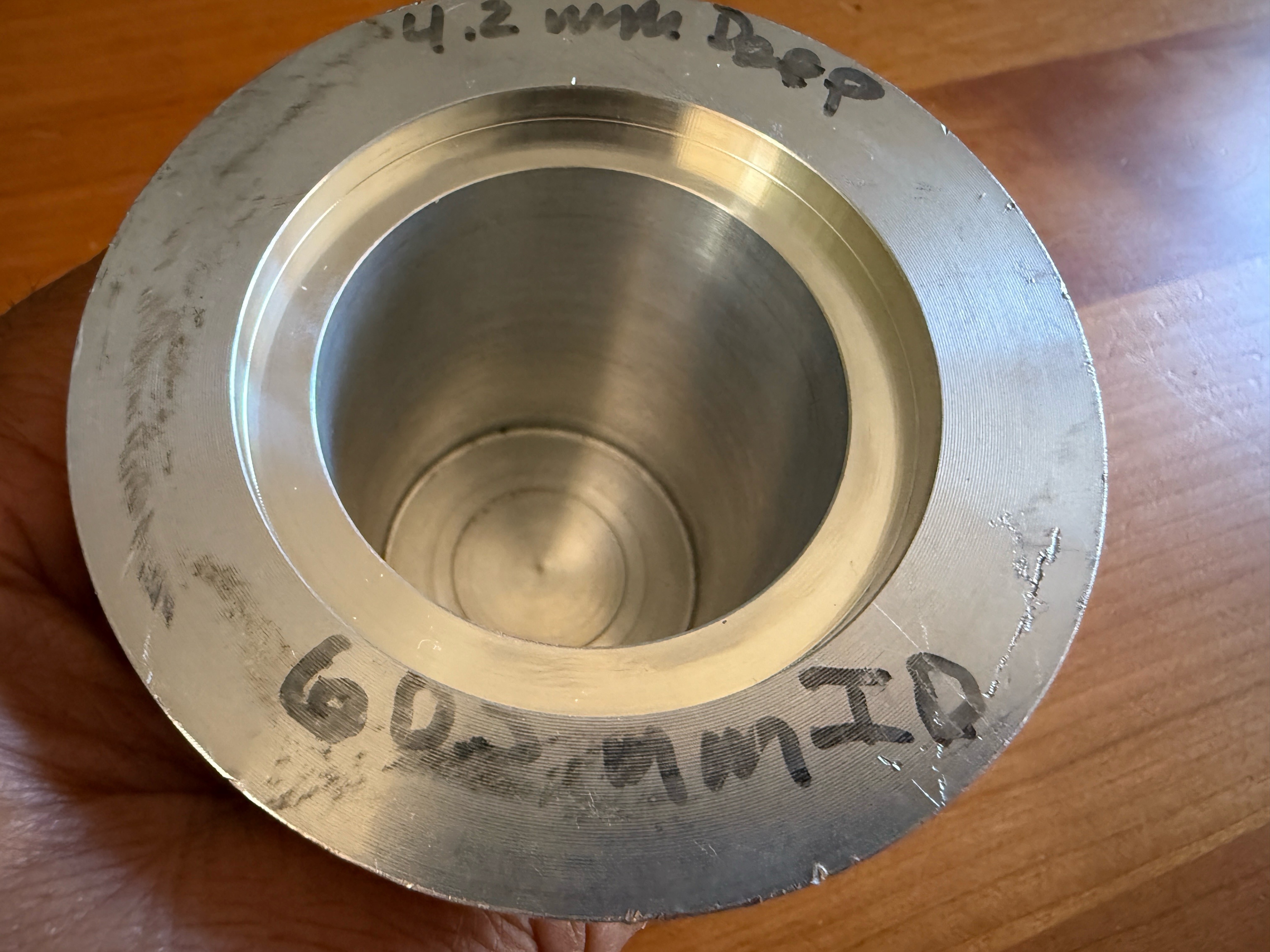

Had a machine shop open up a Miller 8891 installer to accommodate the extra lip on the seal
