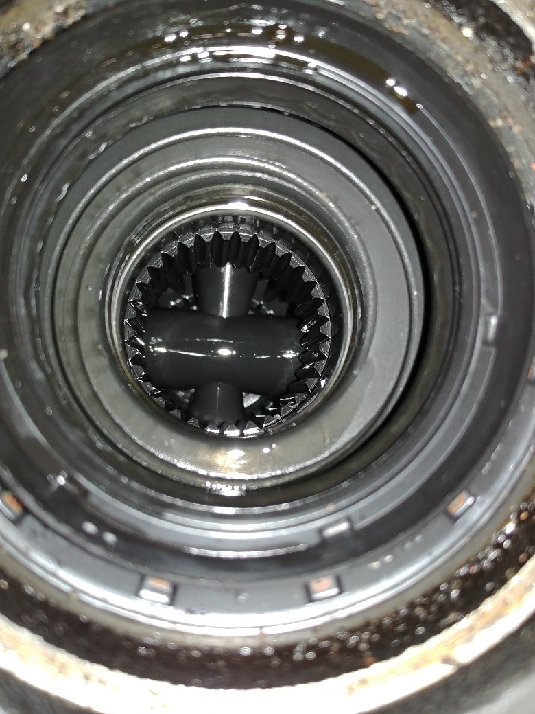

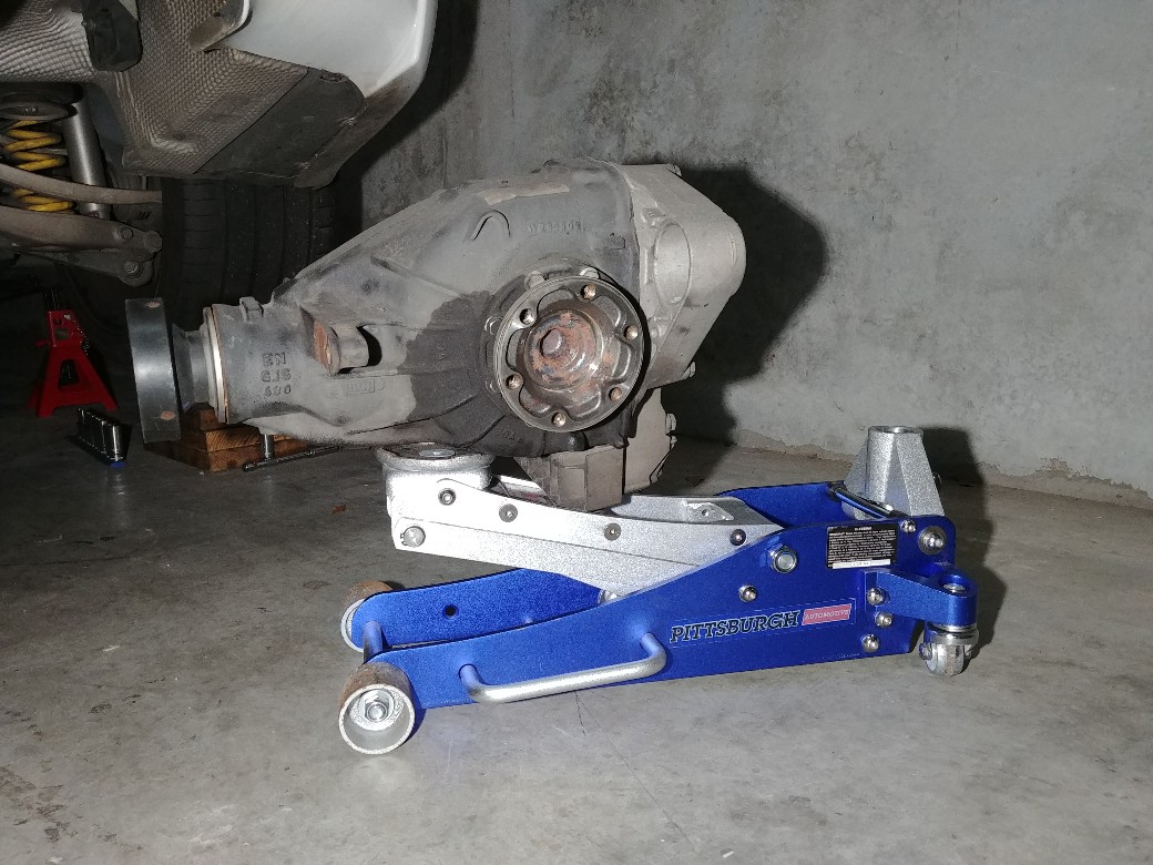

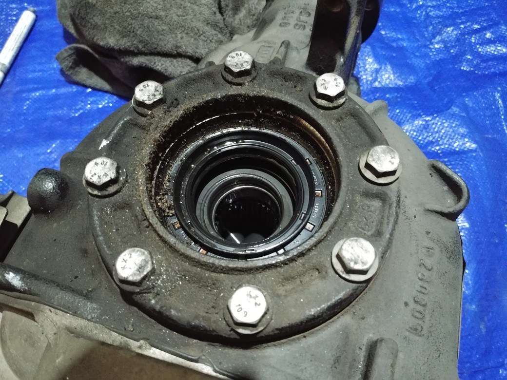

Also, when I dropped my diff I realized that it was leaking fluid at the axle seals. Looked like it was leaking a fair amount, but I pulled the filler plug (before pulling the drain plug) and it was barely pouring out of the filler plug, so it wasn't leaking very much (when I do a refill, I always pump until it's spilling out a bit then put the plug back in). I'm guessing that it must have just been slightly weeping for an extended period of time - I'm at 156k miles after all. So anyway, I decided to go ahead and replace both axle seals because it's never gonna be easier than with the diff on the floor. Also this was the first time I was able to fully drain the diff. After slightly tilting it until the drain plug hole stopped pouring out, I then picked the whole thing up and turned it sideways and a good bit more came out. Also checked the roller bearings that mate the axle to the diff internals and both of them were in seemingly pristine condition. Overall it was a pretty easy job, and I don't think it would be too much more difficult with the diff on the car. The only issue I ran into was the metal ring/cover that you unbolt took a good bit of persuasion to get off, not terrible though. I also rolled the dice on a cheap Amazon seal remover kit and it ended up working out perfectly. So $26 well spent!
Here's the DIY I used:
https://www.m3post.com/forums/showthread.php?t=1469414
Here's the Amazon tool:
https://www.amazon.com/gp/product/B07DC31TB3/ref=ppx_yo_dt_b_asin_title_o01_s00?ie=UTF8&psc=1
And here's a few pics. Would have taken more but my phone died.
