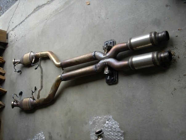

Stock system

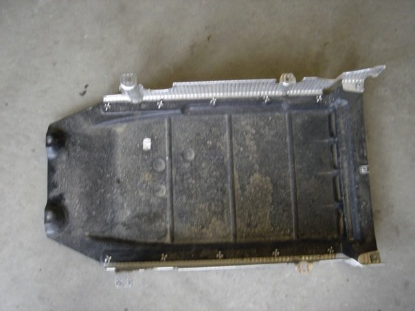

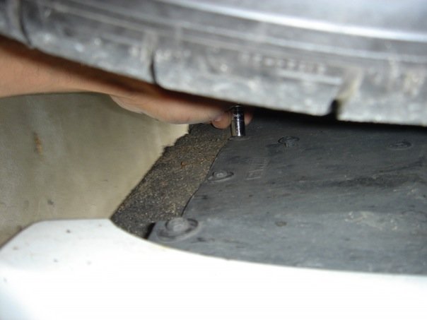

remove the Heat shield, front felt pieces, and skid plate.

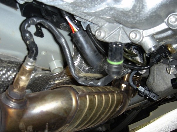

disconnect the O2 sensors and remove back brace under X section.

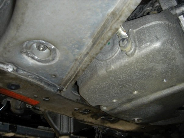

Sorry, this pic belongs in last post. This is the skid plate.

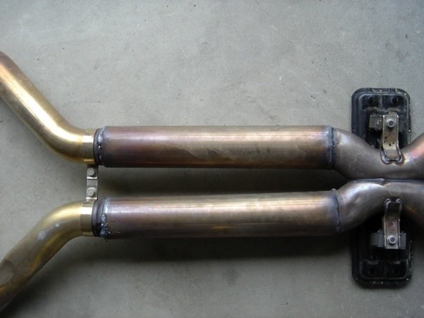

Unbolt flanges from headers, and resonators from connecting pipes, and center hanger from transmission. Exhaust will then drop down. Center hanger from transmission is not used on new pipe. It's not necessary without secondary cats.
Take out O2 sensors and put them in new HFC section

Close up of Secondary Cat Delete

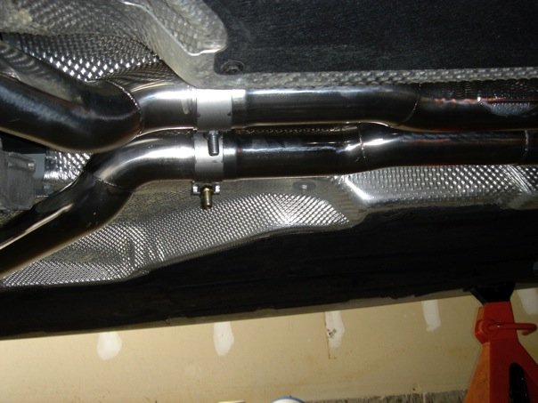

Loosely assembled x-pipe and HFC section, O2's installed and ready to go back in. Tighten everything once it's installed in the car. This makes it easier to adjust the pipes and get everything to line up perfect.

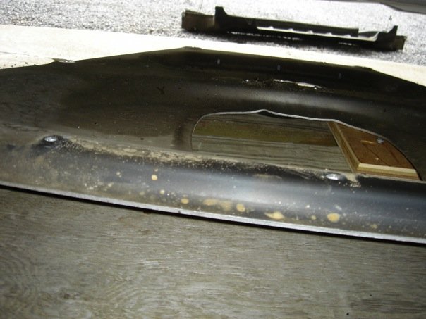

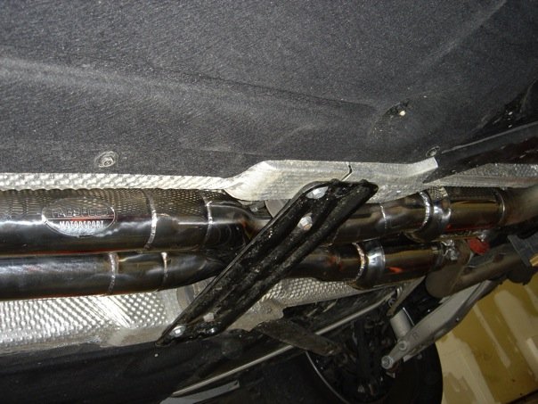

here you can see the HFC against the heat shield. I learned the hard way you have to bend it up first.
