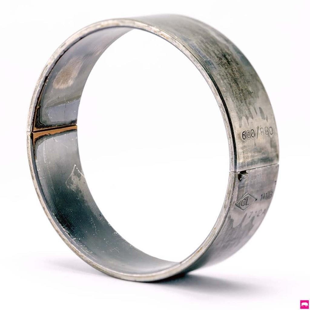

Did the rod bearing job a couple weeks ago on my '10 e92 lci, 105k Kms.
Took me ages to complete on jack stand, if anyone is wondering wether you should attempt it on jack stand the answer is definitely no. Either find a lift or pay someone to do it. I'd rather pay ~1k$ than doing this again.
That being said, here's a pic. I'd say not great but not terrible either. I'm glad it's over
EDIT : Car has been running on ESS VT1 kit for around ~40k km before. That might be interesting to know at least in my case it doesn't seem to have produced any additional rod bearing wear compared to similar mileage from this post

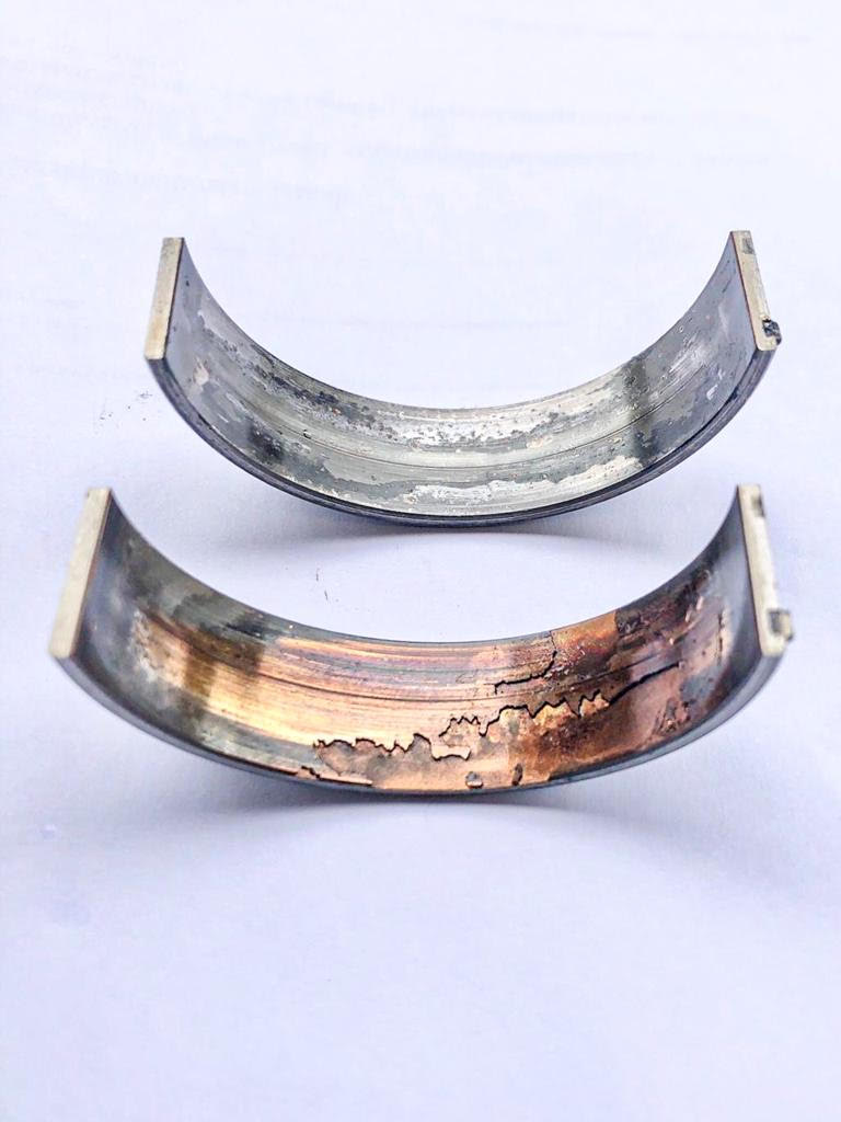

Bearings pulled from our 2011 M3 with 62k miles, not sure if any track time previously. Maintenance records show regular scheduled oil changes its entire life. Replaced with ACL mixed bearings from Lang Racing with work done by Edge Motorworks in Fremont.
Luckily bearings were not in too bad of shape. Obviously no wear is what you should see but we know the situation with stock bearings... glad we got them changed out!
Advanced wear, I think. Can't say that's not a bad shape.
Also, I think I'm seeing a nail tint right there! What's that for?
Who knows?!

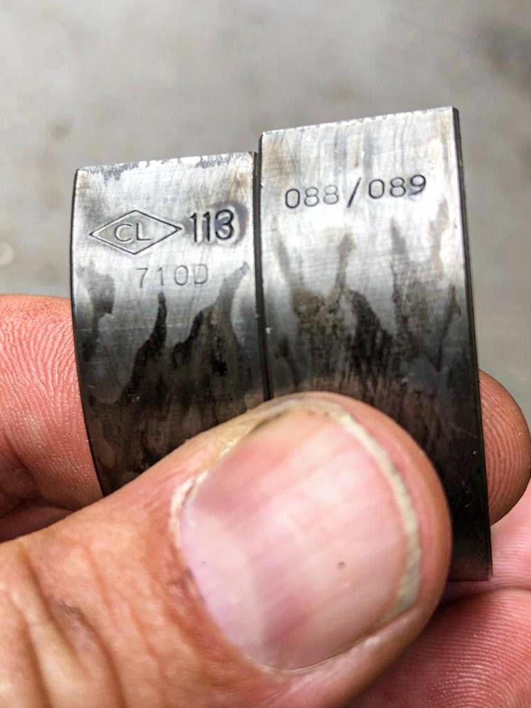

I suspect it's for marking fasteners that have been torqued - a common practice in some shops.
I mark internal bolts with a dab of red line assembly lube...
Exterior bolts with a paint pen...
But damn, some sparkly nail polish could really make the job POP!!

Here is Cylinder 7 bearing from an S65 engine I'm using for an engine swap. I was told it had 86,000 miles on it. I've checked the crank and luckily zero damage. Can't have been far away from spinning
I also have a 2008 E90 M3 and the bearings were done at 95,000 miles. The car has full BMWSH.
This was the worst one from that car...
PAM3Guy984.50
Idfkman477.50
Attachment 2403997
Attachment 2403998
Attachment 2404010
