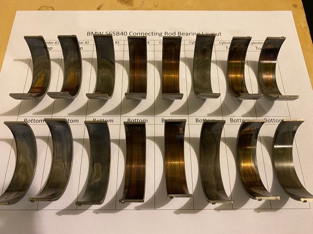

Been meaning to post for a while.
I bit the bullet and changed out the bearings.
FYI - I purchased BE bearings with the ARP bolts.
Mine is a 2009 E90 DCT with almost 90,000 on the clock and had the last owner for 9 years before I acquired the car.
Was advised car was not tracked/raced, which I was never 100% on, but based on some conversations over paperwork with the sellers family (post payment) - I got the impression it may have been the truth.
Bearings were in REALLY top condition, with very consistent wear.
They looked VERY similar looking to GewoW's post above mine, mine may have been even cleaner. So....they did not require a change really, but still glad I did it.
I'll try to take some photos, but yeah - mine is another S65 that could have added some more km's before the swap....definitely.
M3SQRD7937.50
      07-14-2020, 09:02 AM   #1745
DRLane
DRLane's Avatar
4388
3,635
Join Date: Oct 2018
Location: Colorado
iTrader: (23)
I keep seeing this comment "consistent wear". I believe they're not supposed to be worn at all... Hopefully someone can pipe in to elaborate.
Any how, congrats and smart move with the BE replacements. Enjoy

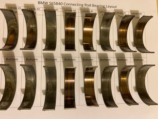

Just had my bearings replaced. The car is an '08 E90 with 89,650 miles on it. I've only owned it since February and bought it with the intention of having the bearings done for peace of mind. I replaced them with the WPC treated OEM bearings and BE rod bolts. I was originally going to go with BE bearings, but they were almost never in stock and I've heard good things about the WPC bearings and they were available so I decided to go that route. The car was clean and well maintained by the original owner (I'm the third owner, but the second only had the car for about six months) with a lot of service history. Anyway as you can see a few of the cylinders were well worn with cylinders 4 and 5 having by far the most wear. Just another data point for this ongoing discussion, but hopefully the engine has some miles left on it after this.
Shiny like new copper gutters. What oil are you running?
