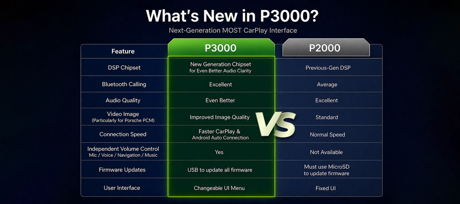

Trying to make sense of the latest P3000 changes, so bear with me:
- Is it true that it seems like a trade off between audio quality (+ P2000) and microphone quality (+ P3000)?
- Does the P3000 and CIC actually support 1080p rearview camera? If so, which GreenYi is the best fit? I see a few on Amazon.
I have a BNIB P2000 and GreenYi 720p camera that I bought just a few months ago and haven't yet installed. Debating whether I want to sell them for the P3000/1080 setup. Snappier software and higher res camera sound nice, but I value audio quality over microphone clarity.

wyatth wroteI find microphone quality much superior with the P3000. I haven't noticed any audio difference for music but it claims to be better than the P2000. It's certainly not worse. From what I've read, it does support 1080P but I haven't tried this myself. The Greenyi 720 camera I have is extremely sharp (just be sure to snip the wire loops - one is for the static guidelines and one is to switch the resolution from 480P CVBS to 720/1080P AHD)Trying to make sense of the latest P3000 changes, so bear with me:

wyatth wroteSo far couldn't have said there was any discernible audio quality difference between the two in our testing.Trying to make sense of the latest P3000 changes, so bear with me:

wyatth wroteMind sharing where you saw this? I've not seen anywhere a difference in audio quality noted. It definitely couldn't get much better than the p2000.like a trade off between audio quality (+ P2000) and microphone quality (+ P3000)?
And as to the video support you mentioned, 720p is pretty good. I have p2000/720p camera and I think it's pretty sharp. I guess what I am trying to say is you won't be missing out either way, if you don't care about audio quality.
I see you are in the bay area, I am in Pleasant Hill and happy to show you my car if you want.
Thumbie wroteAnd even Mr. 12 Volt confirms this way that the audio quality was (as I wrote numerous times now, people still argue with me about that) improvable đMind sharing where you saw this? I've not seen anywhere a difference in audio quality noted. It definitely couldn't get much better than the
Thanks, I missed that comparison chart.
Also, you said you get worse quality audio through mr12volt/carplay than when you stream with bluetooth. I responded that I think there is something wrong with your setup. Myself, and many others, observe that wireless carplay/mr12volt has significantly higher audio quality than streaming bluetooth. BUT maybe I will test this again just to be sure and report back.
