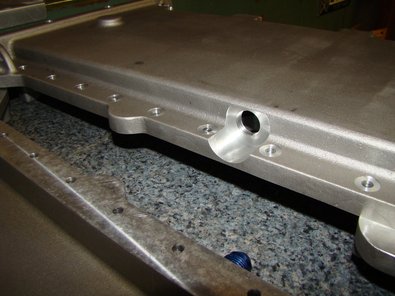

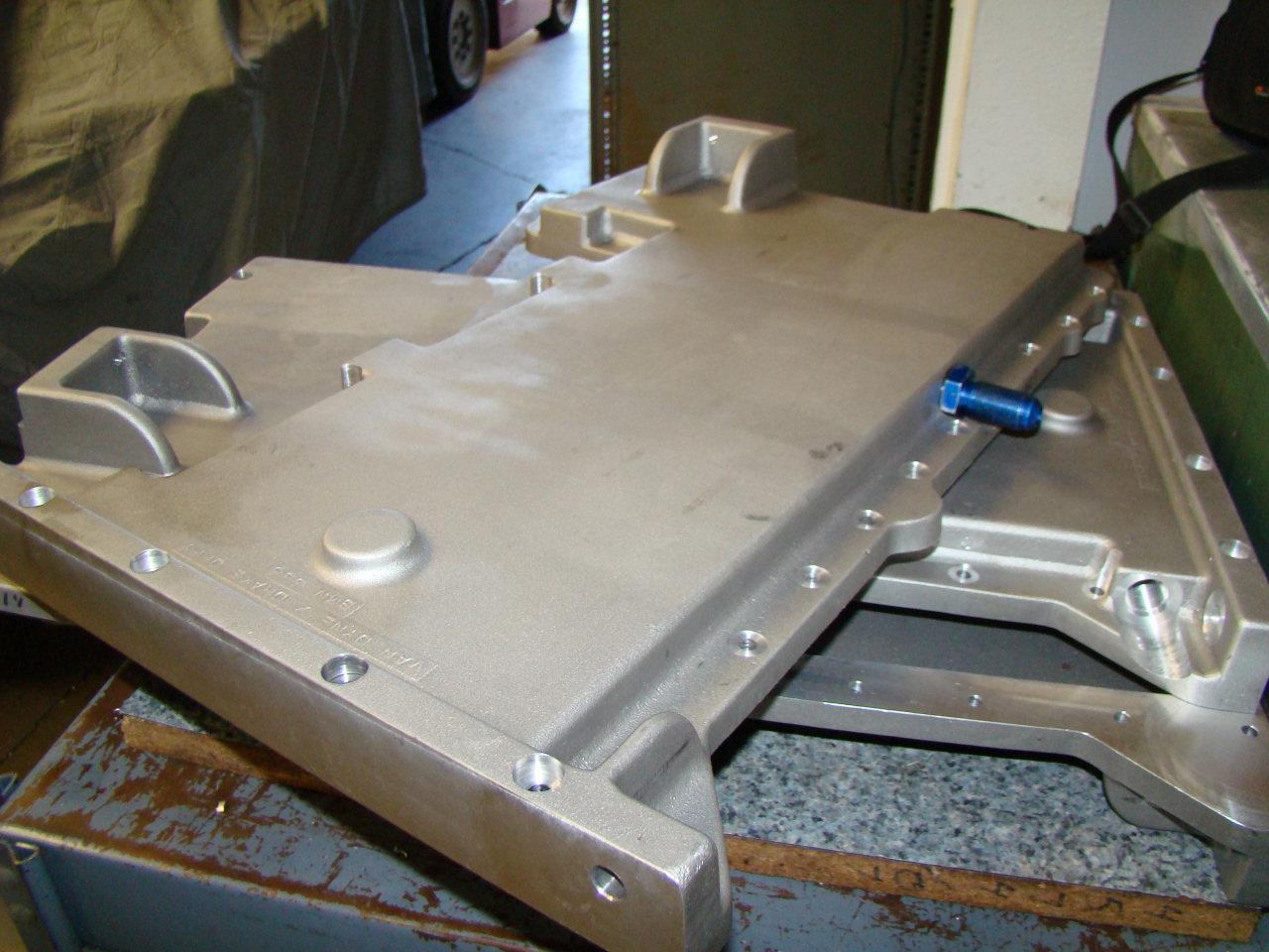

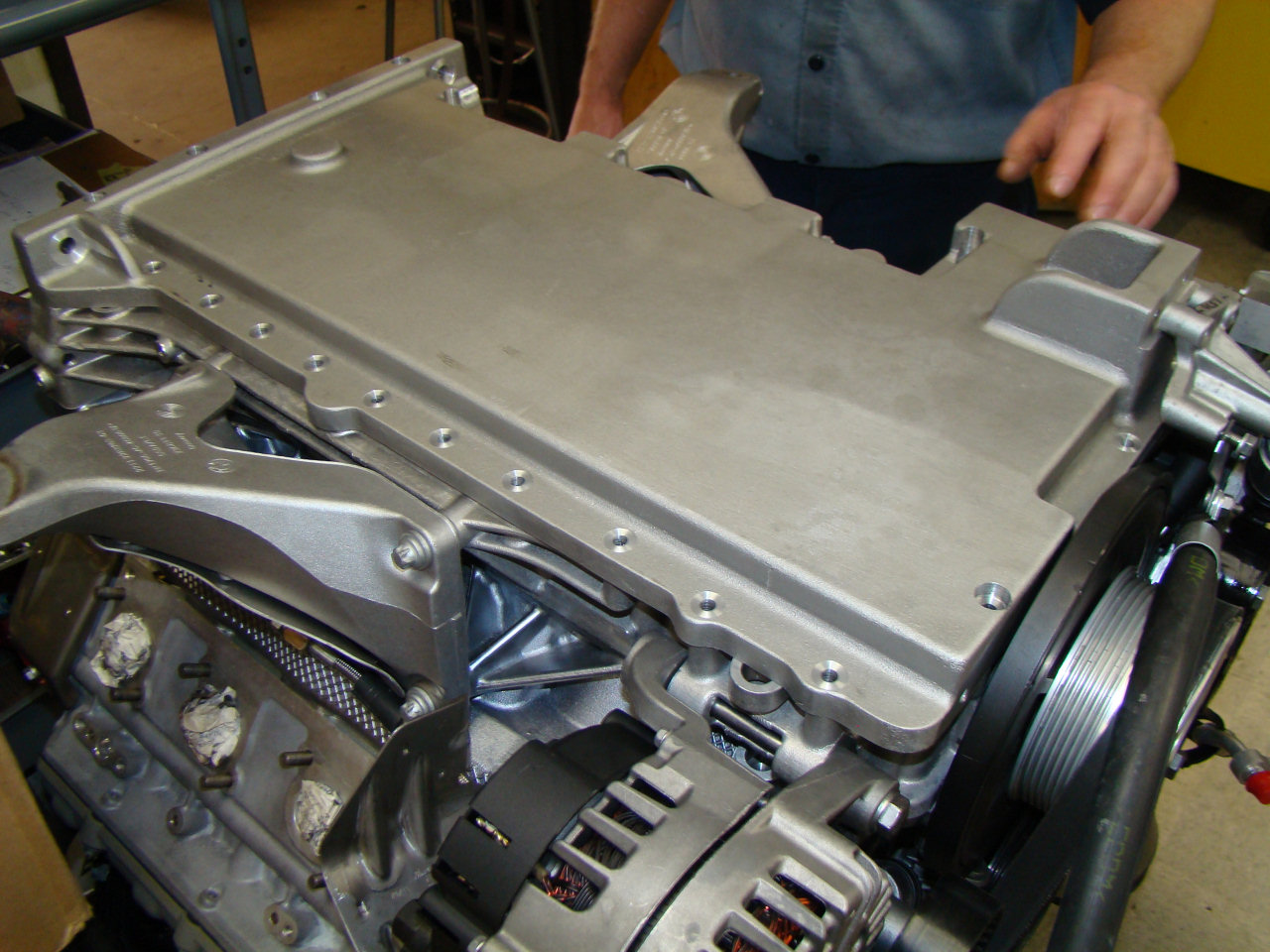

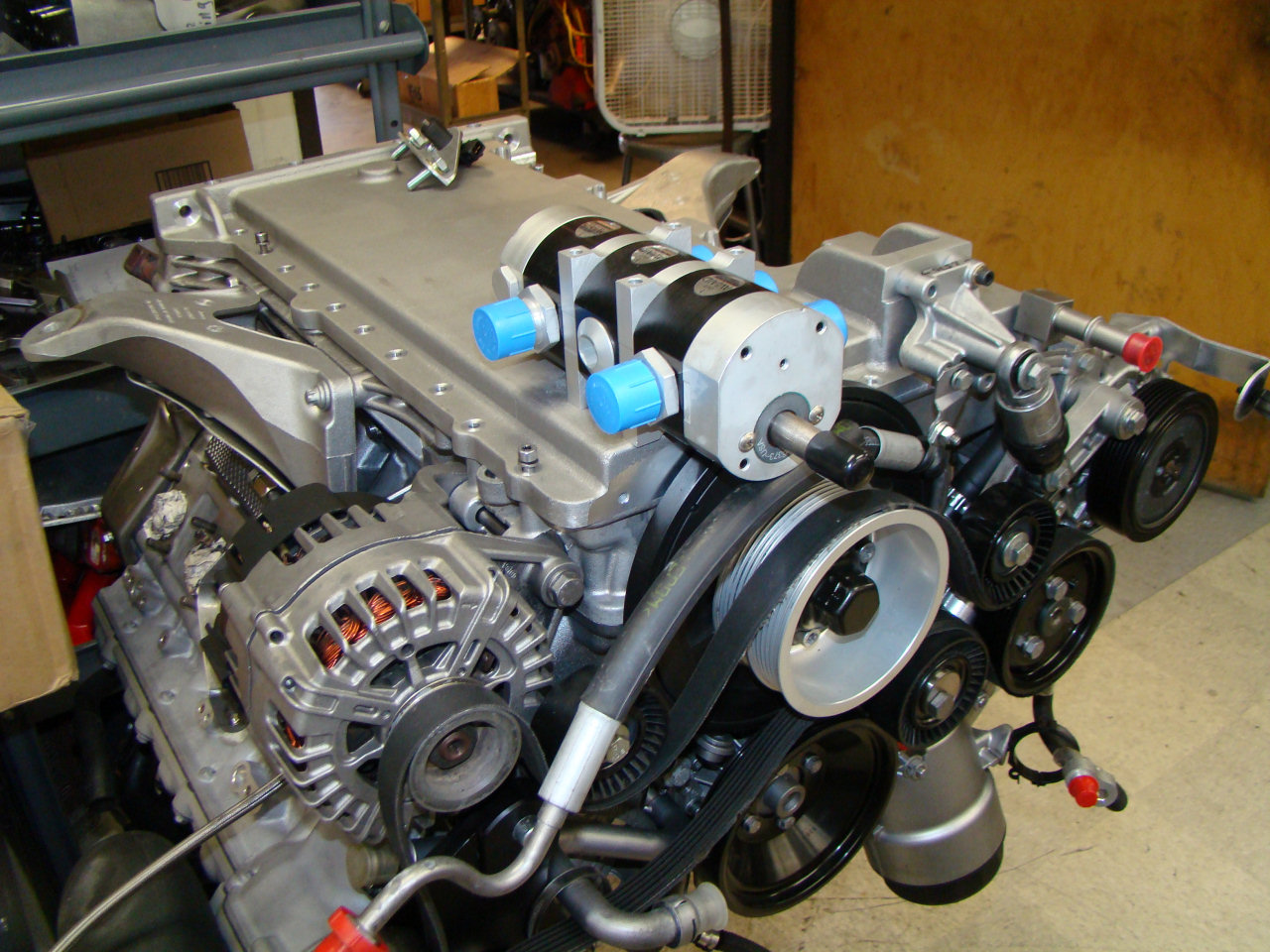

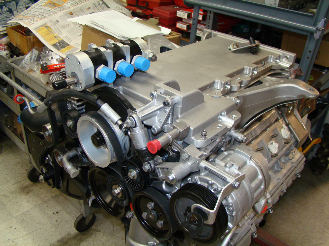

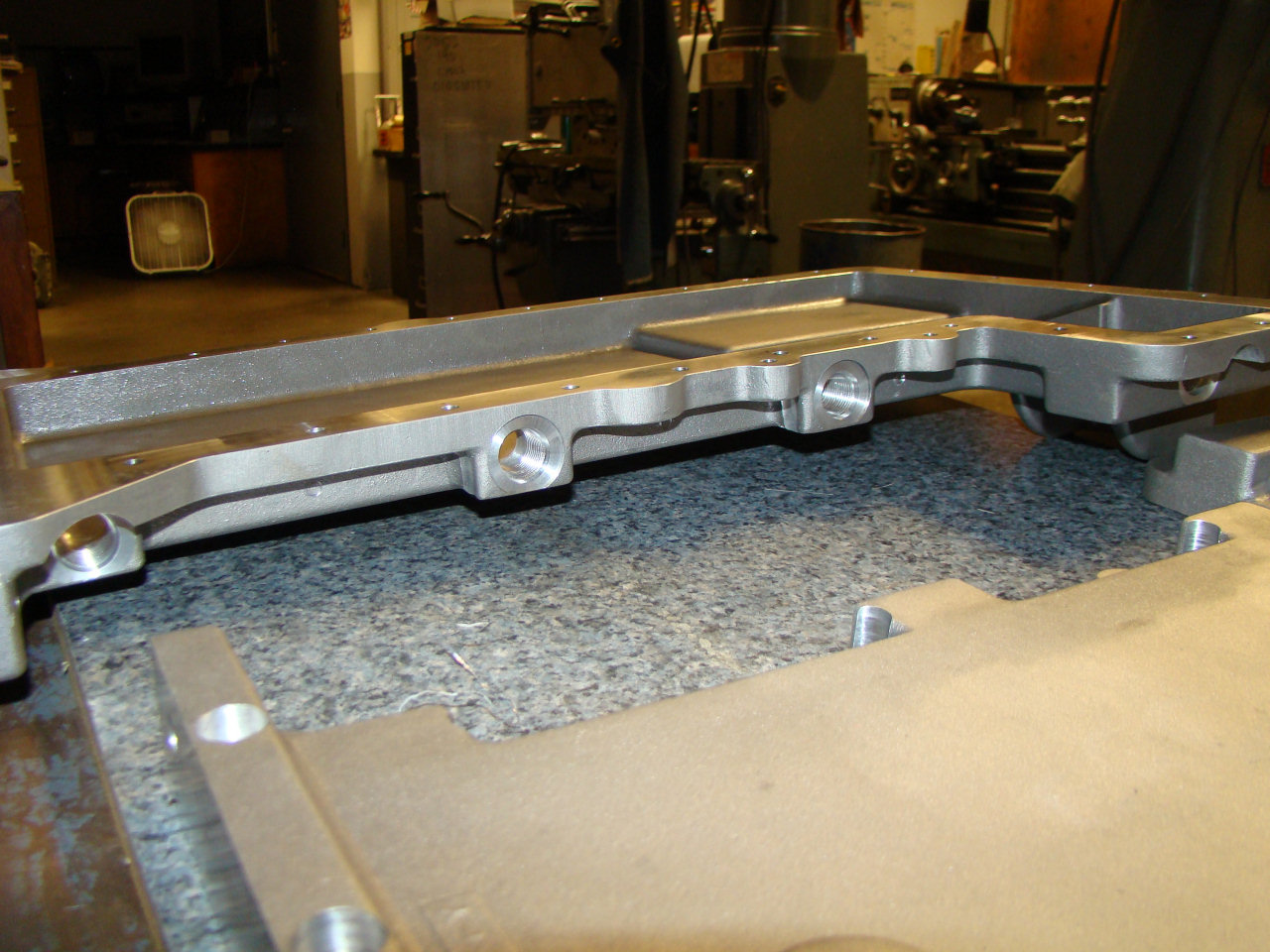

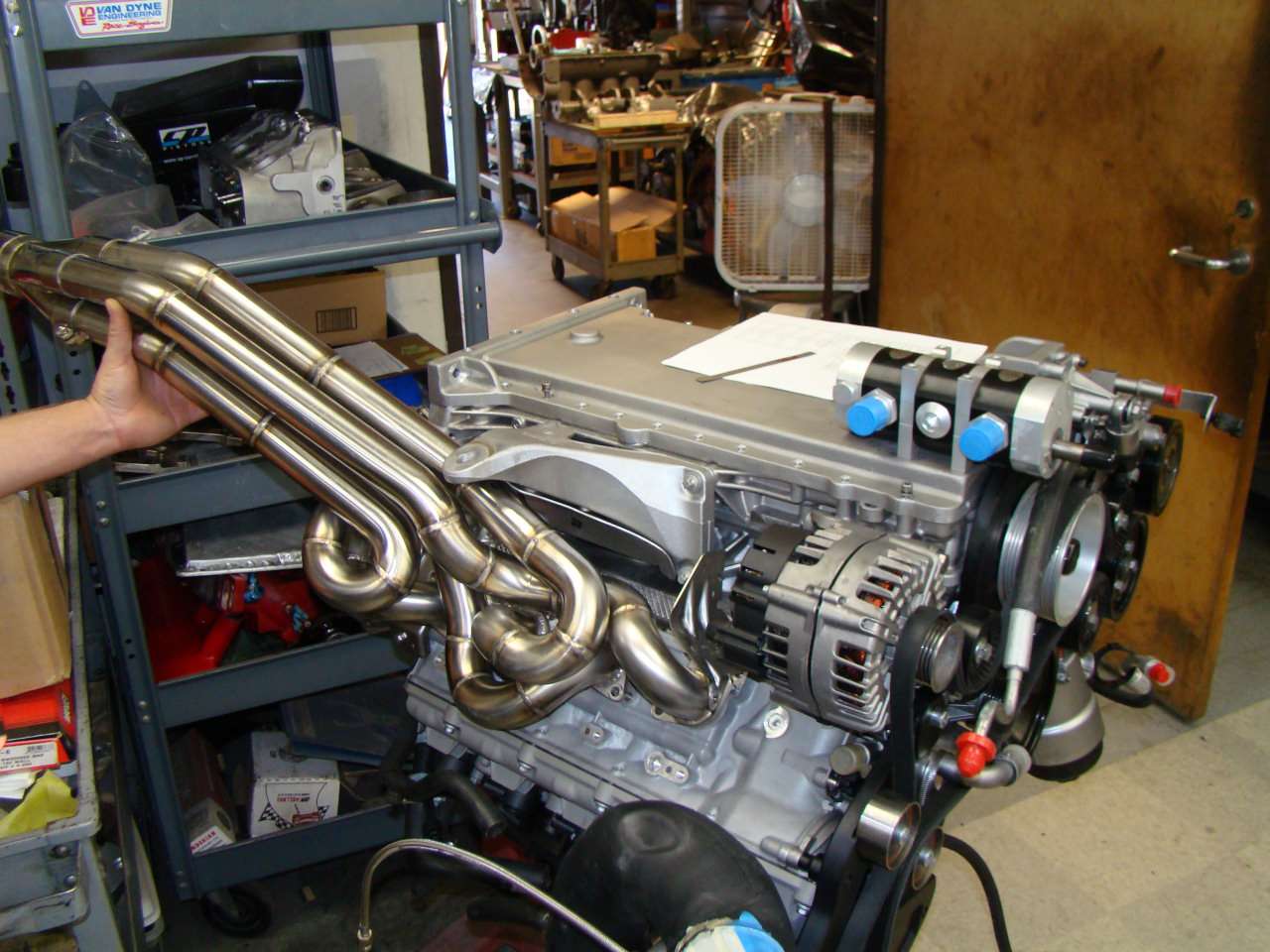

Here's some teaser pictures. The pump in the photos is a mock up that were taken before the real pump arrived. It shows relative placement. The real pump has arrived and is a five-stage pump as mentioned earlier. As soon as the pulley assembly arrives, I should be able to show some pictures of the pump mounted and pulley assembly installed. There's a few other minor details. But that's about all there is left to finish.

looks good! what would be the benefit of a dry sump system? I know the S65 has a wet sump, but it seems like a very good wet sump system that doesn't lead to oil starvation even during hard driving on a track.
And where would the oil go? The engine bay is quite cramped as it is and there isn't much room for a big oil tank
The current design does still lead to oil starvation. VAC and others have designed windage trays to mitigate the problem. One guy in our area who tracked his car had two engines damaged while tracking: one suffered main bearing damage, and the other oil starved during hard cornering and somehow spewed all kinds of oil back through the intake system (no idea how that happened). When the engine was eventually disassembled, six rings were broken. Honestly not sure if there's a connection with the broken rings and the track event -- but mentioning it for completeness.
I honestly don't know because I haven't looked into it yet. I know VAC and Turner sell the Daley dry sump kit. So they must be putting it somewhere. It doesn't need to be in the engine bay.

Who makes the LT headers...
Yeah those look yummy. I'd guess they are Robert's Racing Dynamics headers.
Yep.
