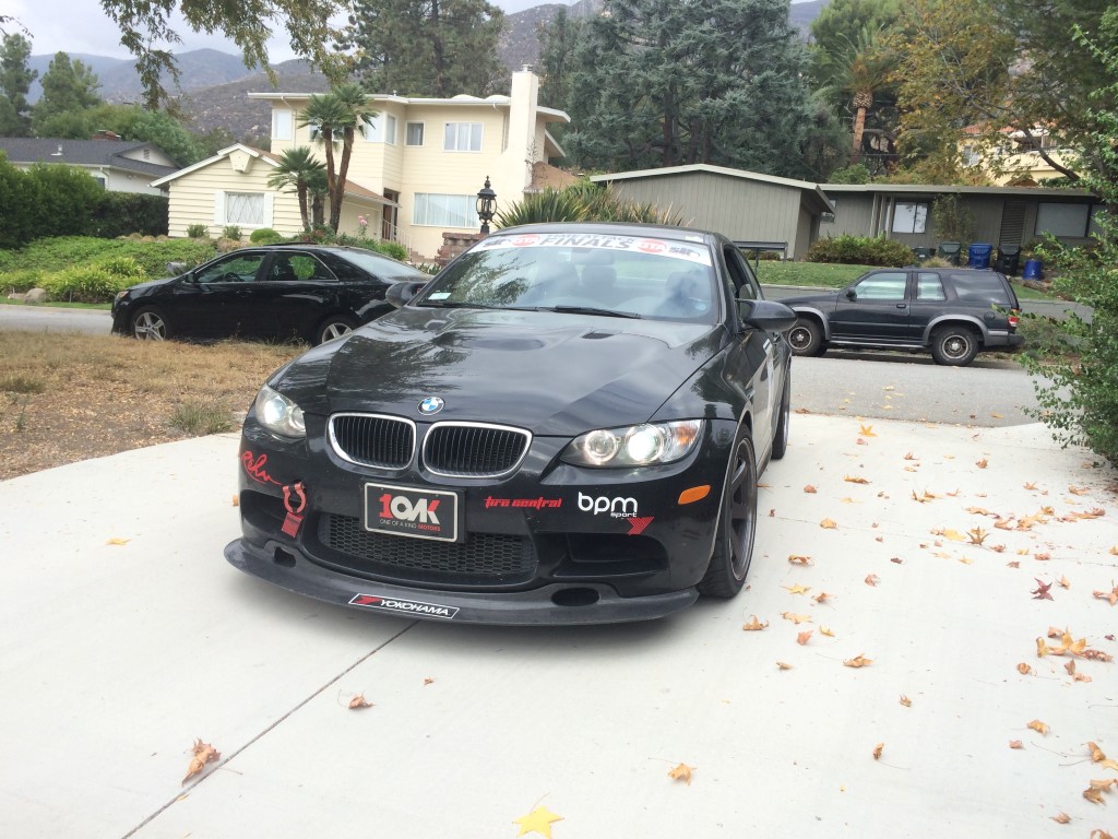

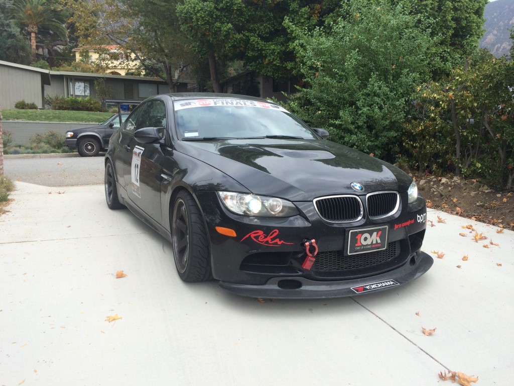

We wanted to share some pictures and information of our sponsored E92 M3 Enthusiast Class track car. Rif is an extremely talented driver that tracks a few times a month, participates in many time attack events, and also for practice to better his times.

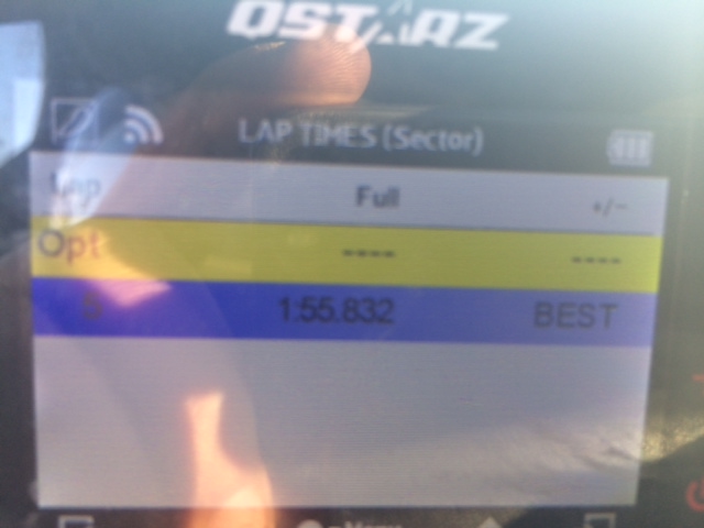

Update: Record setting 1:55 lap on Buttonwillow Video:
Vehicle:
2011 E92 M3 6 Speed Manual Transmission
Modifications:
-BPMSport Stage II Tune
-BPM EDC & TPMS Delete + Coding
-Akrapovic Evolution Exhaust System
-Brembo GT BBK, Front and Rear 380mm
-JRZ RS Pro Two Way Coilover Suspension System
-Square tire setup with Volk TE37 wheels, 18x10.5
-Tires: Hancook RS3/Yokohoma AD08R
-275/35/18 and 285/30/18 (200 Tread ware, street tires)
-Platteforme AG Chassis Mounted Front Splitter (added 12/12/2013)

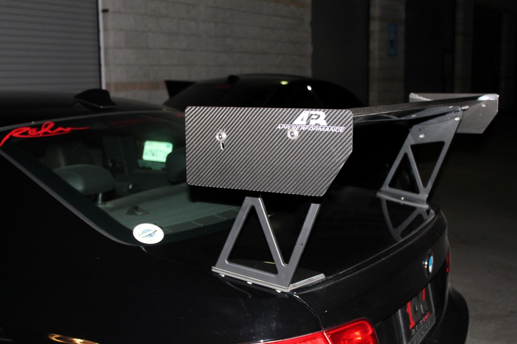

-APR 2D Carbon Fiber Wing
The car is stock otherwise and has not had any weight reduction. - ~3,800lbs.

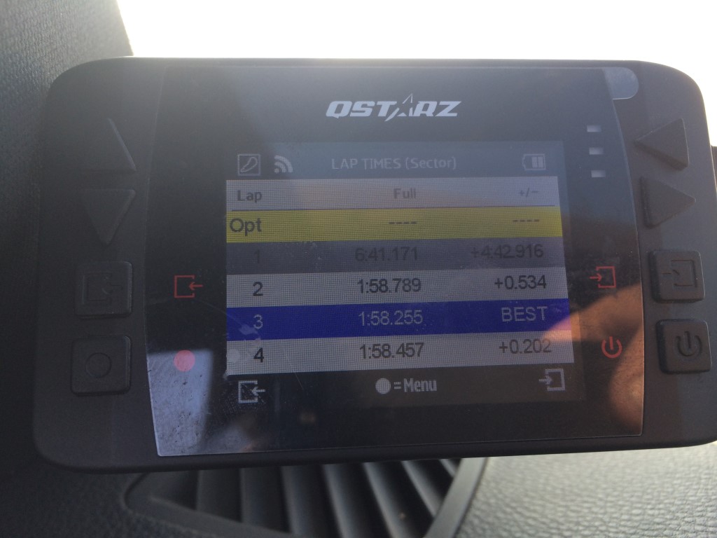

Track Times:
Buttonwillow: 1:58.2 – record holder by 2 seconds in Superlap Battle GTA 2013
(On a practice run he ran a 1:57)
Streets of Willow: 1:24.1
Fontana Roval: 1:53.1 (before many of the modifications)

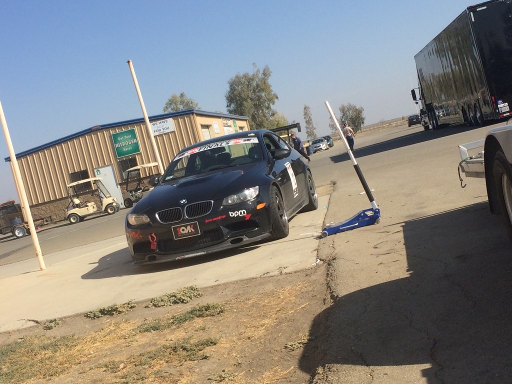

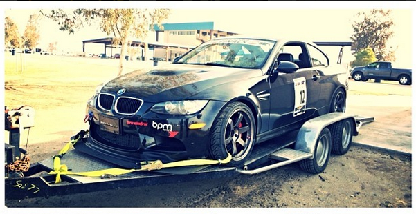

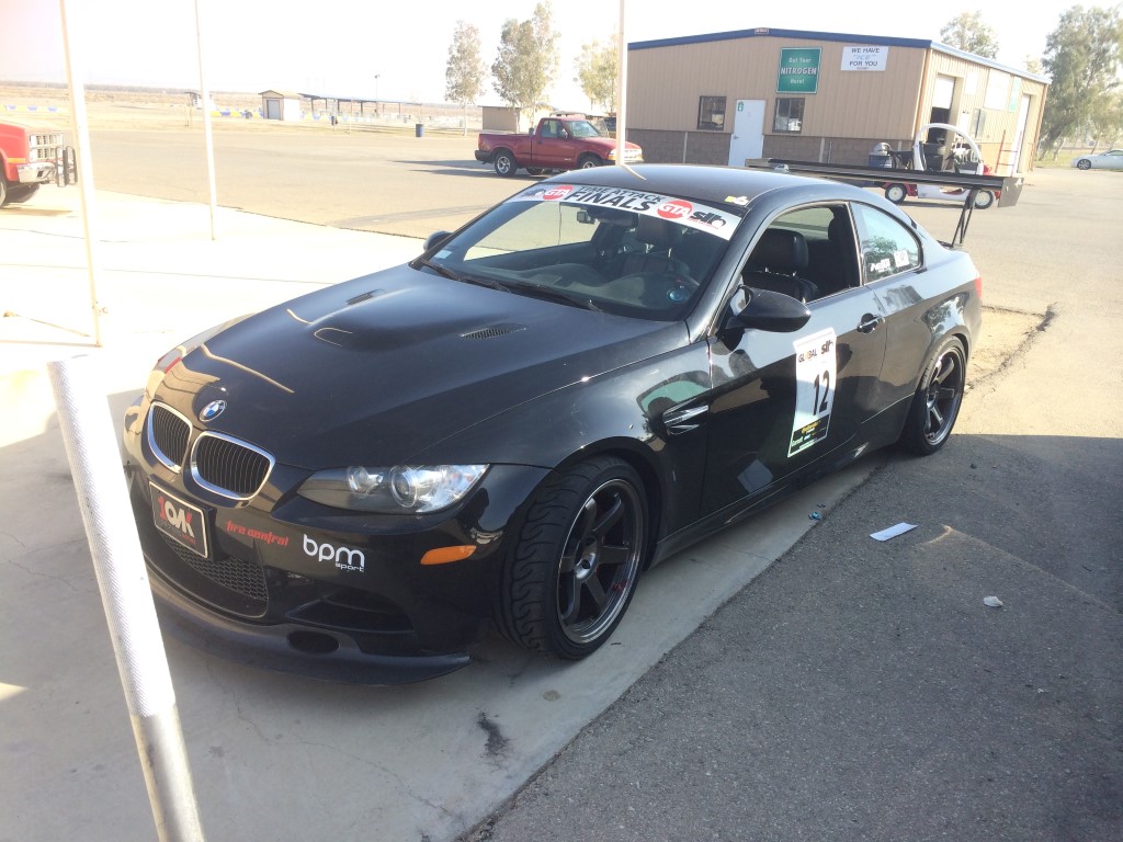

Here are a couple shots from the track (w/ one wheel off the ground):

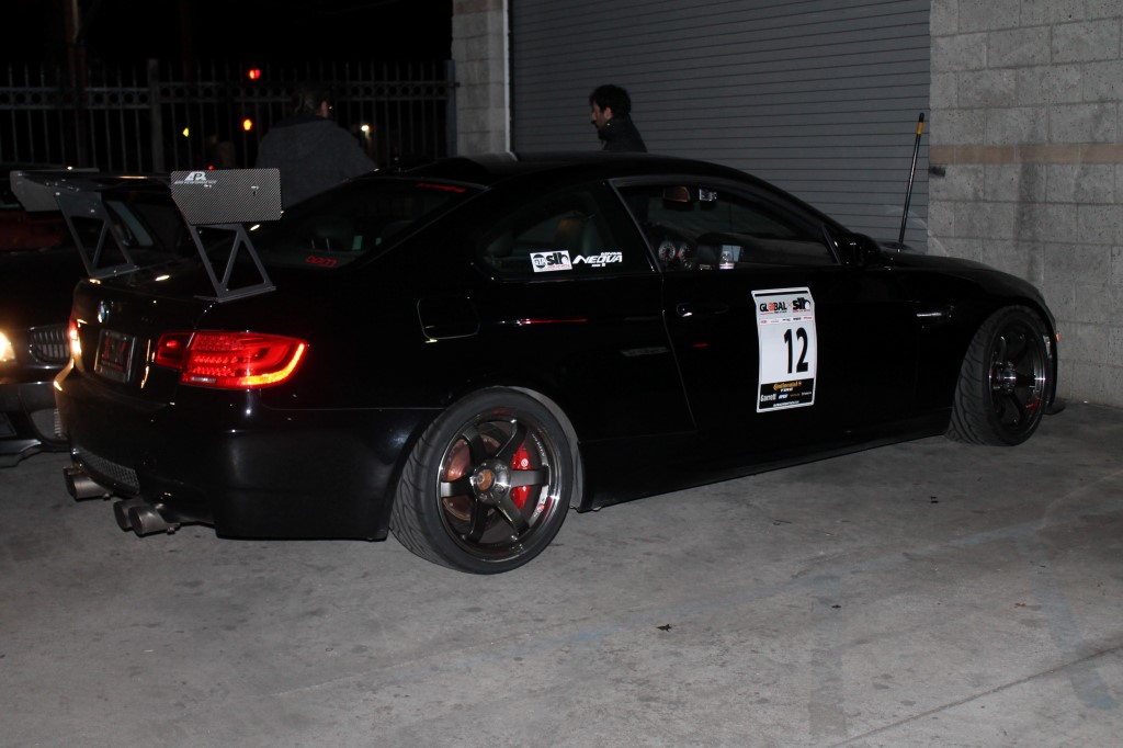

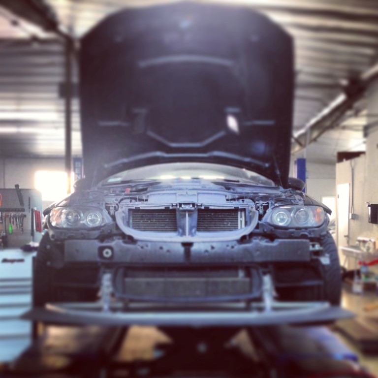

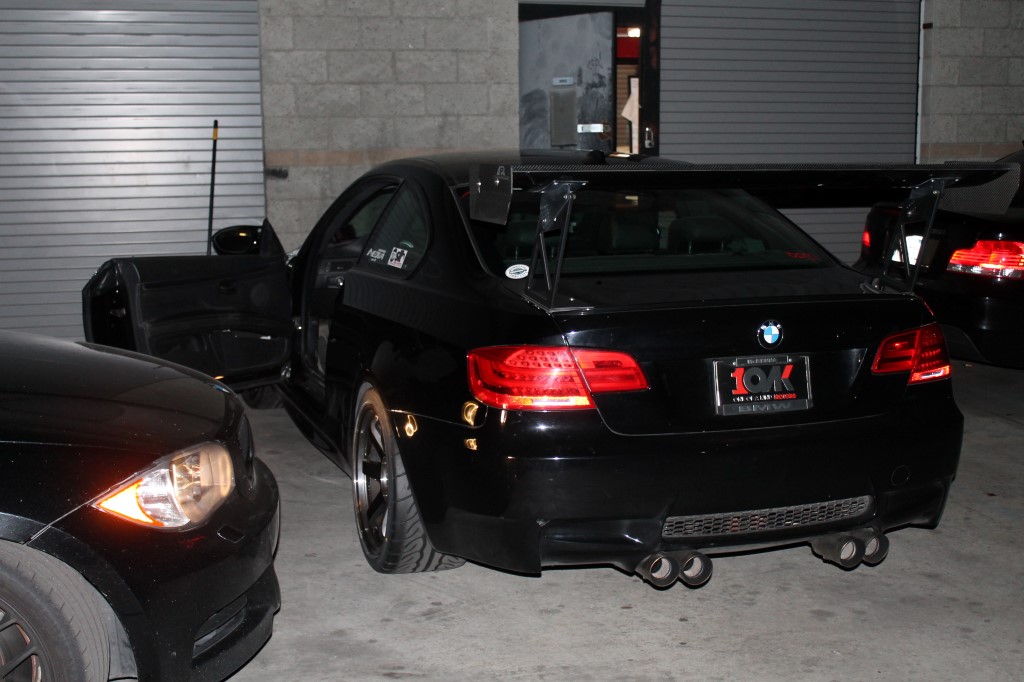

Yesterday he had some additional aero done to the car, here are a couple pictures of the new modifications which we hope will assist in providing additional downforce:

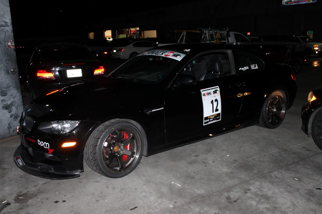

A few more late night pics after redline testing:

His car is corner balanced and weighed in at 3798lbs.

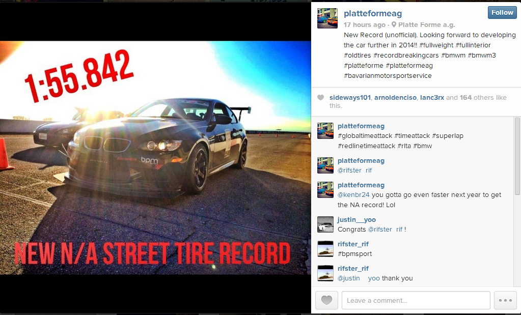

A couple days ago he broke the NA RWD Street Time record on Buttonwillow, improving on his previous best by two seconds.
Great job Rif!!

Here is a youtube video of his record setting 1:55 lap:

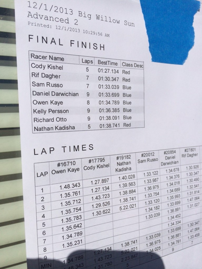

Good work. Not to take anything away from Rif but holy crap that 1:27 at Big Willow from Cody Kishel is unf0ckingbelievable.
They are both remarkable drivers, that's for sure!
One other thing to note is that Cody is supercharged (+ on R compound TD soft tires), and that Rif is N/A .
