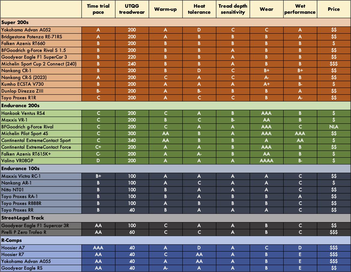

Here's a chart from Grass Roots Motorsports showing their test data for streetable track tires. To avoid tread compound delamination (chunking and tearing) due to the tread compound over heating on track, use at least -3.0 degrees of front camber, less steer angle when the front tires are at their limit (i.e. avoid temptation to dial in even more steer angle), avoid hot tread compound temps over 200F (come into the pits hot and measure temp data), use a pyrometer to dial in tread temperatures with <= 10F temp spread between inner and outer shoulders. For streetable (DOT legal) track tires, maintain a hot temperature ceiling of <=40psi on a car weighing less than ~4000lbs. Start with cooler cold temps if the ceiling is being exceeded.
Edit: See all of the "care and feeding" files attached and Michelin Motorsports .pdf tire catalog link: https://adzktgbqdq.cloudimg.io/https...compressed.pdf

Last edited by DrFerry; 03-18-2025 at 10:08 AM.. Reason: Added some literature files

Check out the GRM tire guide occasionally. DrFerry's image is a good rundown of the options but I believe they have updated it since and they do so every few months.

Originally Posted by bipp View Post
Honestly, I feel like -3 is a sort of minimum for our cars at the track... you don't lose much on the street and I plan on moving to -3.5 or so down the line to get better tire wear as even then I think I could get a bit more out of the outer edge. Every session on my tires right now is $60... would love to get that down.
I have never driven the PS4S or ECS02, only the original ECS. Those two should be similar. I chunked my original ECS, moved to ECF, and haven't looked back from 200s. You will need to not overdrive and take cooldown laps if you want 300+ tires to last.
For sizing, just go 275/35/18 or 295/30/18 square on 18x10.5 whenever you are able. The ability to rotate got me 2 more days since both tracks I have gone to are CCW. Effectively, that would have made a $450/day consumable down to $300/day. If I had more camber and got a 7th day, then that's a substantial savings as well. See (https://f87.bimmerpost.com/forums/sh...&postcount=503) for my current tire wear/breakdown. (I probably have a 7th day, but the outer tread is <1mm, the tires feel super edgy, and I have no desire to make a 6 hour roundtrip drive for tires that have a chance of cording. If there was more meat, I'd try to eke out a 7th day and maybe part of another just to get my money's worth)
-3.2F and -2R is my sweet spot for a car that’s driven to the track and back home.
On a conservative tire setup like 275/35/18SQ, it works well, but with wider tires, I have to bump it up to -3.5 or up to -3.7F and up to -2.5R. Having eccentric lockouts for the rear camber helps a lot with tire wear since camber changes dynamically without them.
