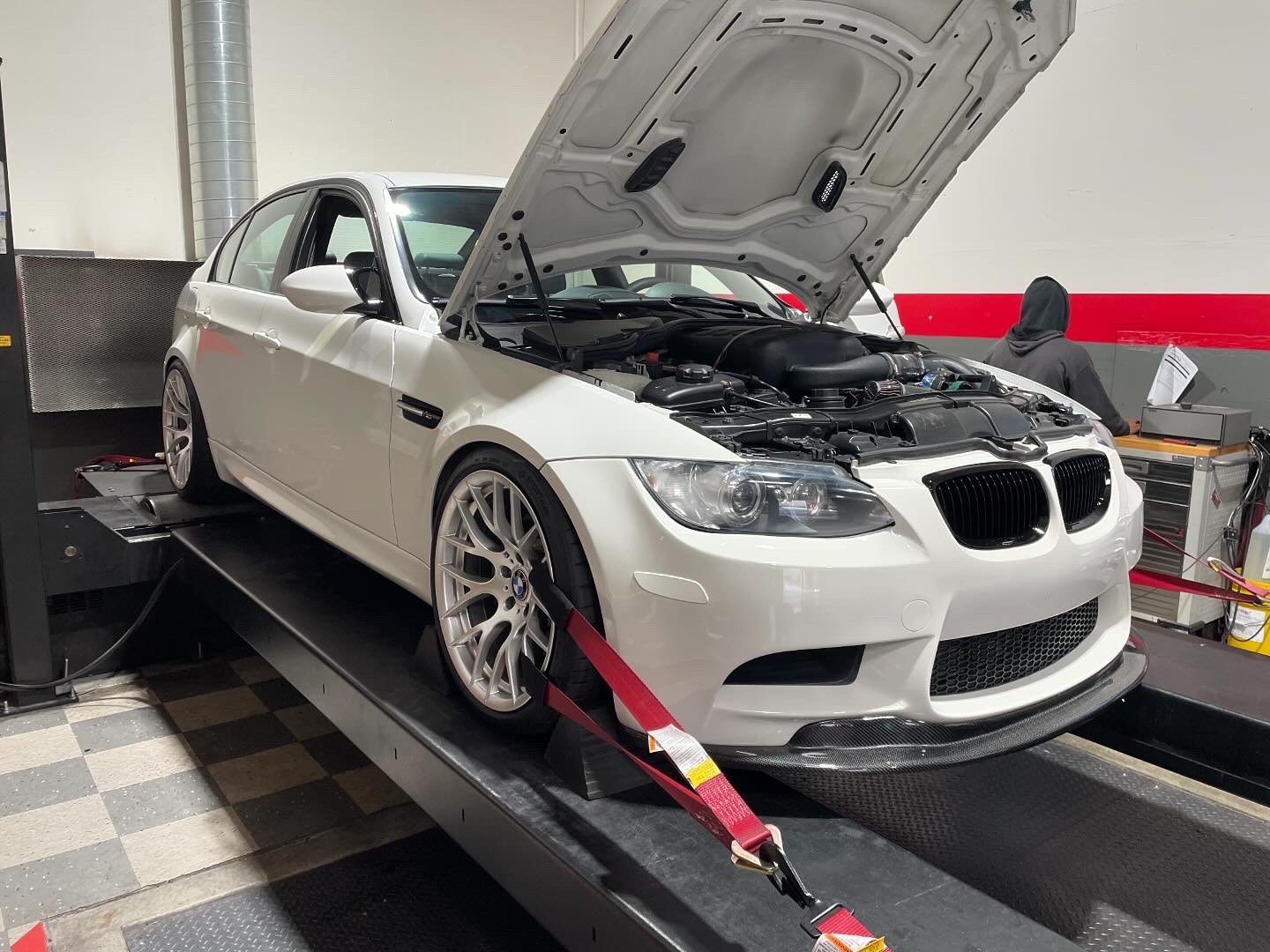

The Results
Multiple 600+whp pulls back to back (see dyno chart)
The first couple of pulls were shy of the 8500rpm redline so I told the dyno operator to stay in it to redline which shows the power right to the top!
Outside temps were 50 degrees F but the IATs were 95 degrees F getting to 100 degrees F at the end of the pulls. The dyno was in a back room and they only had a Swamp Cooler fan on it. I just drove 30 mins to the dyno shop and they hooked it straight up so no real cool down but at least its as real life performance as its going to get. Hotter summer months will pull timing with more heat but I'll look into a methanol injection system for cooler IATs.
Super happy with the results! The car drives perfectly on the street. The powerband is identical to stock, super linear, once 4500rpm comes around it just pours on the power and it pulls hard to redline. This makes it super manageable so there isn't any crazy wheel spin when the power hits.

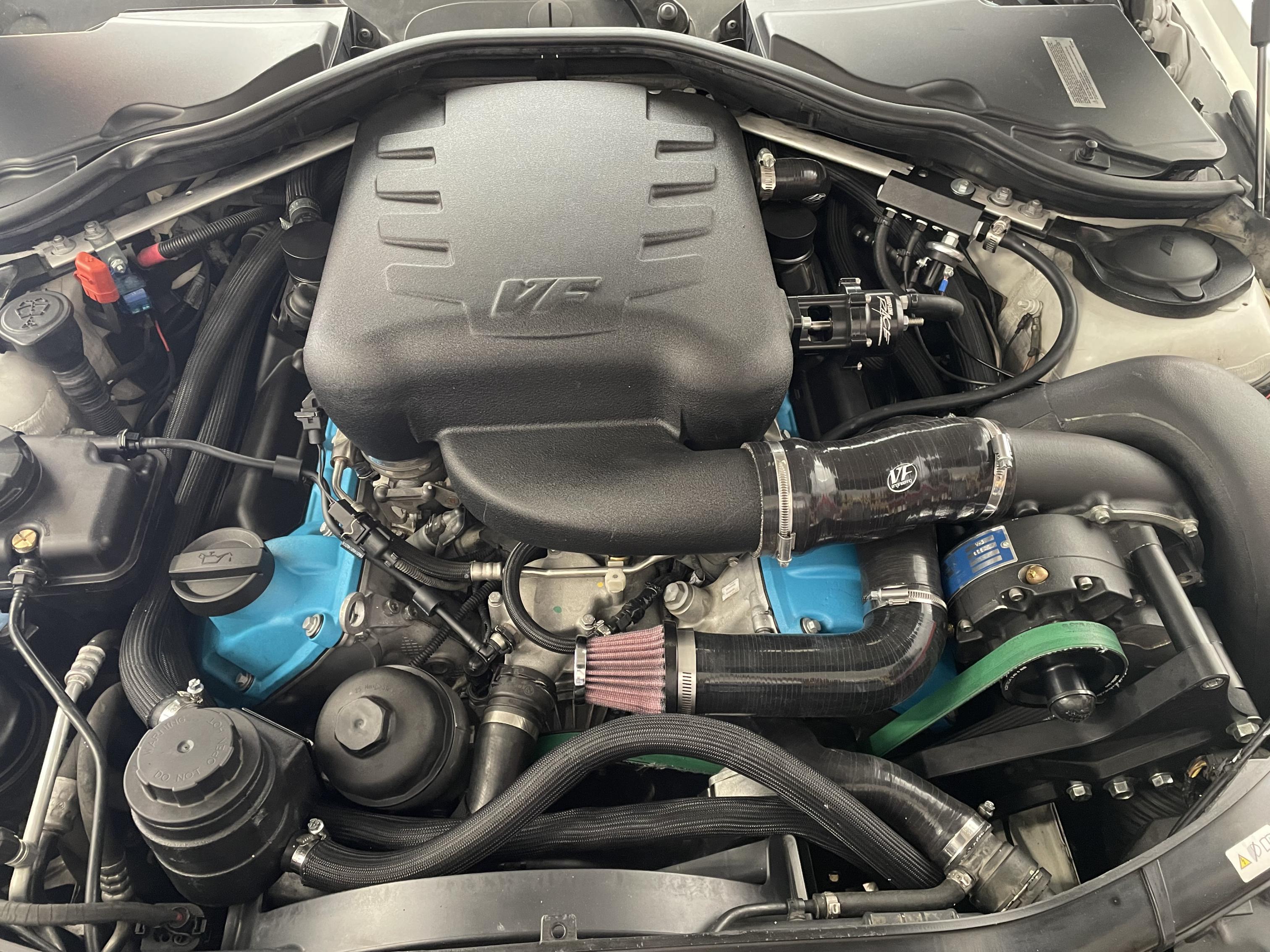

Originally Posted by Soden82 View Post
This helps in my decision to go with E85 come spring for my G1 kit.
Can you elaborate more on the secondary intake? First I’ve heard of it, and wonder if it can be utilized on the G1.
The secondary intake mod is when you vent the BOV to atmosphere and instead of capping off the hole/inlet to the intake elbow from the BOV you put a filter on it and now you are introducing more air into the compressor. Jordan from RK tunes did this on a video on his YouTube channel and the car picked up 1psi and the result was 20+whp. Here’s a pics of the old ess and new ess setup with them. You just find a silicone hose on Amazon and a smal filter to fit it.

Here is the link to the video and he starts explaining the mod at 7:20 mark, he gained 35whp by doing so.
Not flex tune, it is a Full e85 map or a full 91 octane map. No flex option that I know of at this time.
