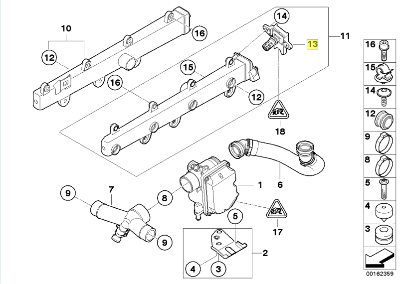

There is no MAF but there is indeed a MAP sensor on the idle strip. It's on the Bank 2 side sort of beneath the throttle bodies and inside the V.
There is also definitely a PID for this that you can monitor in ISTA or with a scan tool.
