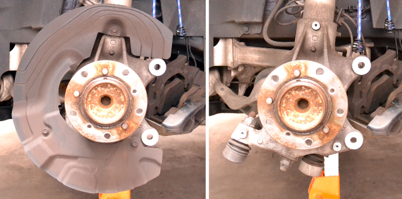

Do you need to cut the heat shields on the front and rear for install?
On the front, your dust shield is held on by three 10mm bolts, so you won't need to cut anything. Yes, we absolutely recommend removing it. You can see our full install instructions for the front kit here:
https://www.essexparts.com/storage/w...3_radi-cal.pdf
Here's a pic we took of the front dust shield removal:
On the rear, you will need to trim back or remove the dust shield (see step 6 in the manual below):
