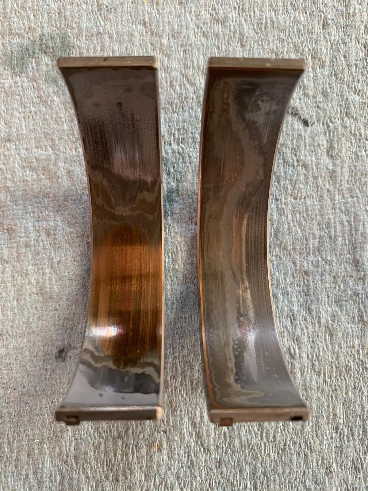

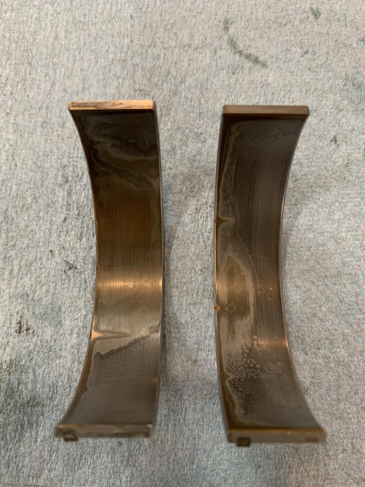

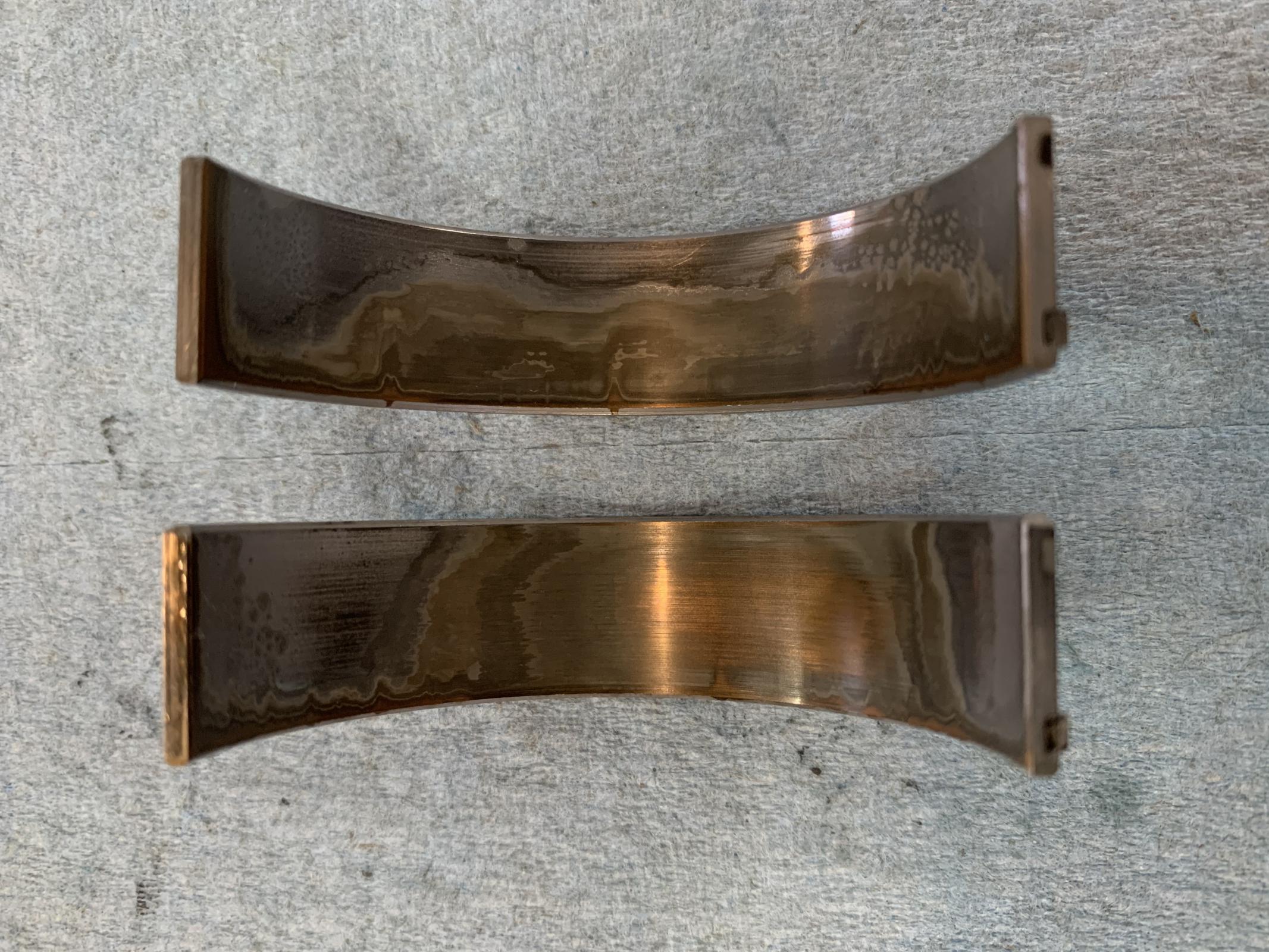

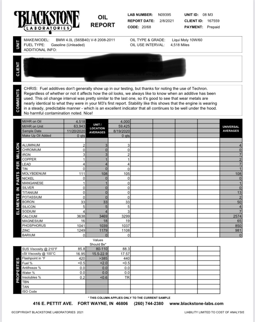

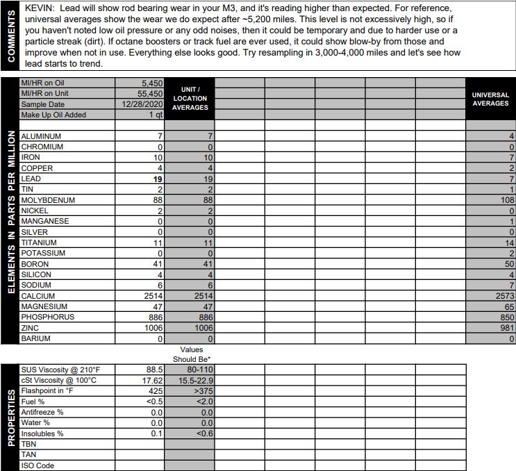

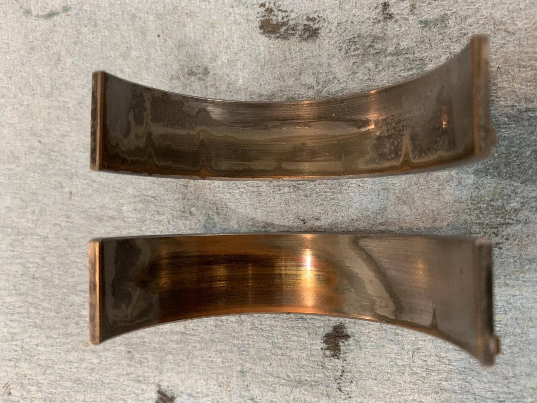

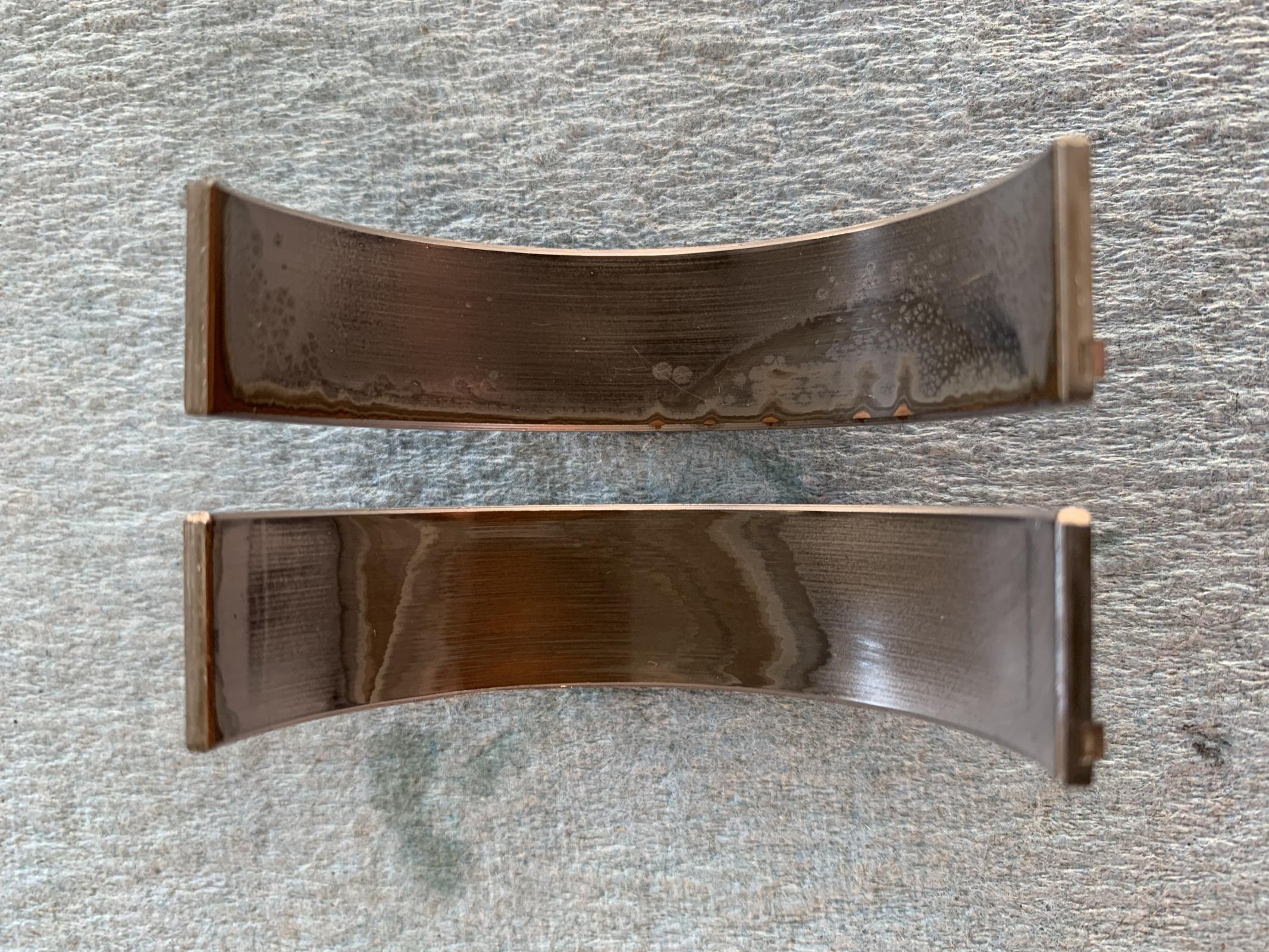

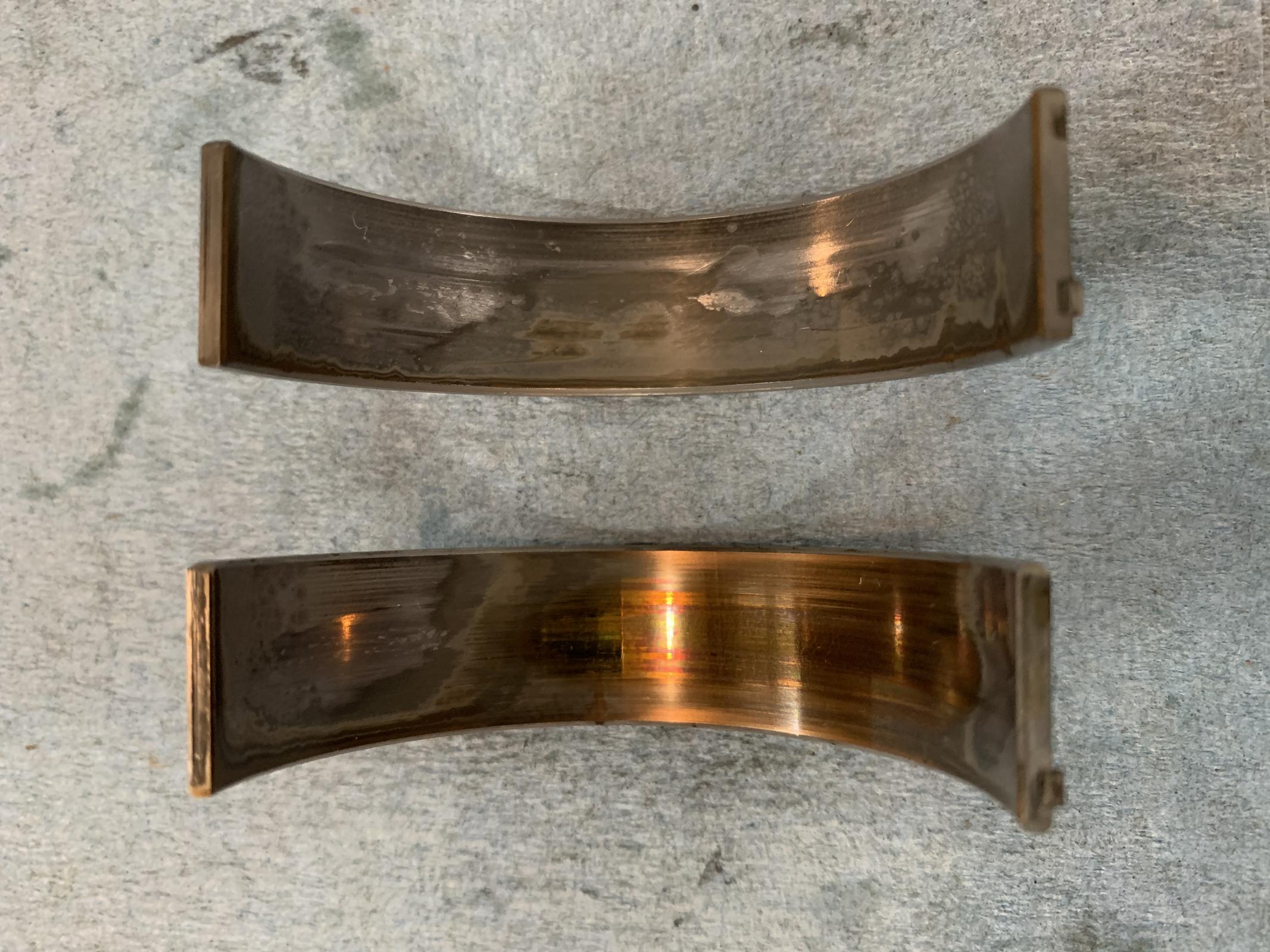

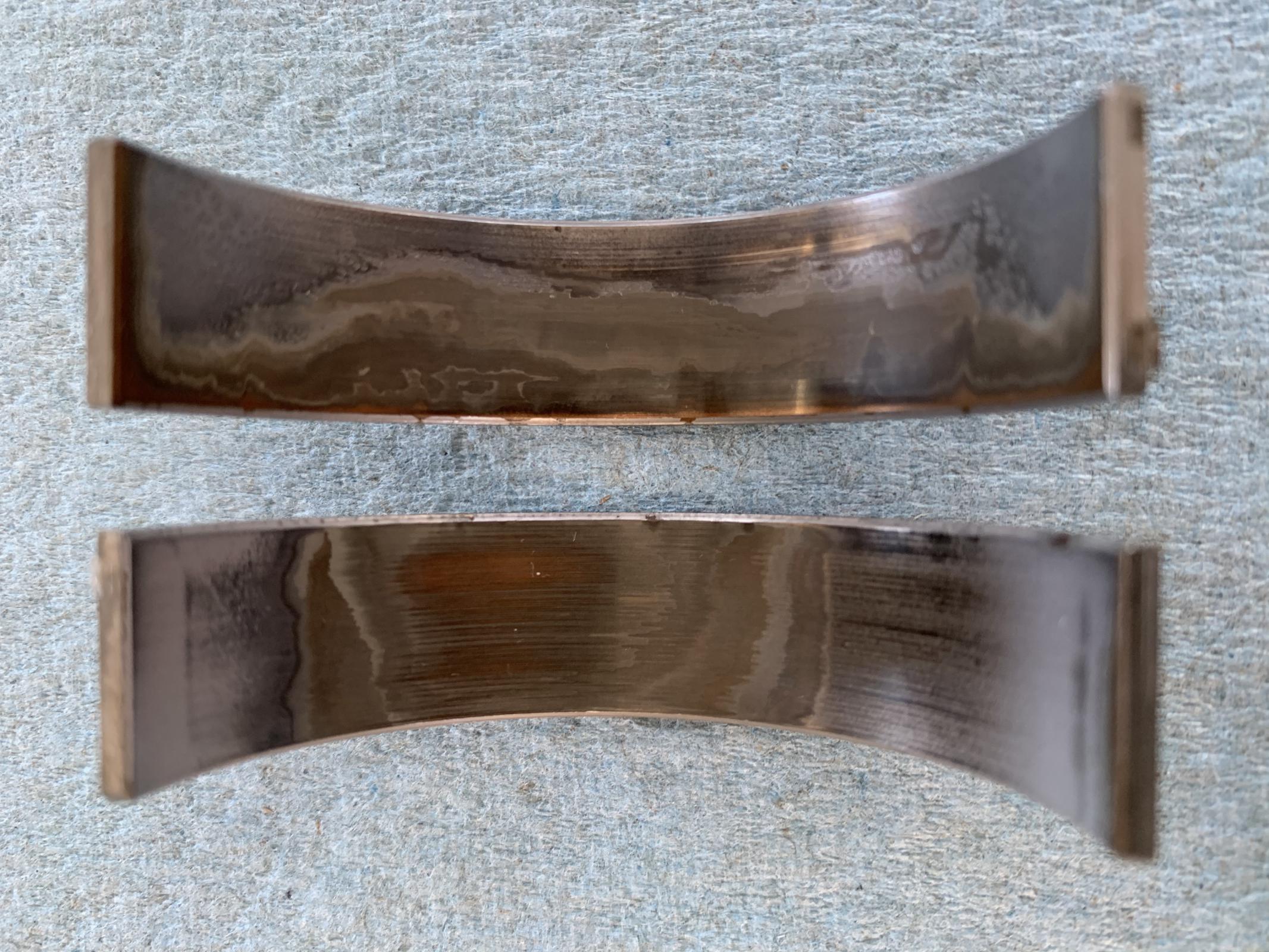

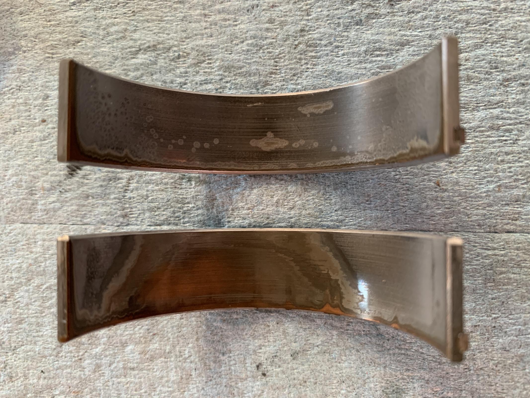

Here's the two oil reports I had done prior to my rod bearing upgrade.
To me, they look pretty good for lead and copper.
And here's the pictures of my rod bearings.
Seems like the lead and copper levels should have been higher?
All I can guess is that the wear happened sometime prior to the two reports and then slowed.
Most people that have seen my bearings, are of the opinion that they were close to failing.
I think if I had chosen to put all my eggs in the oil report basket, I likely would have regretted that choice.
Chris,
2008 E92
      02-09-2021, 09:47 PM   #1088
G80indy
Save the Manuals
G80indy's Avatar
2011
3,125
Drives: Z3, E46, G80
Join Date: May 2005
Location: Indy
Dang
That doesn't build faith in those oil reports, that's for sure.

      02-11-2021, 08:39 AM   #1089
Davisca455
Davisca455's Avatar
2242
867
Drives: 2008 M3
Join Date: Oct 2012
Location: Davis, California
Originally Posted by 330indy View Post
Dang
Based on the circumstances of my own situation, using an oil analysis as a way to predict rod bearing health seems like it would have to be done in a very narrow set of circumstances?
The only way that I can envision it ever being useful for that purpose, is that the oil reports would need to be started at the beginning of life, and then done at every oil change.
I only have 220 miles on my new BE Bearings rod bearings, so it seems like I'll have an opportunity to start fresh, if I choose to do so.
But, since this first oil sample would have assembly lube and anti-seize in it, I would need to know if the assembly lube or anti-seize contained any copper or lead, and if so, how much?
If I wait for the second oil change, then I'm not really starting from square one, and then I'm back to guessing if the rod journals clearanced themselves in the first few hundred miles?
It just wasn't a very complicated procedure to get the oil pan off, so I will likely invade the crankcase again when the car reaches 130,000mi (another 65,000mi), even if every oil analysis were to show low levels of lead and copper.
Chris,
2008 E92

      02-15-2021, 10:02 AM   #1097
Assimilator1
Assimilator1's Avatar
United Kingdom
877
1,289
Join Date: Sep 2019
Location: UK, Surrey
2010 BMW 330d  [8.00]
2008 BMW M3  [0.00]
Attachment 2525152
Attachment 2525151
Attachment 2525153
Attachment 2525154
Attachment 2525155
Attachment 2525156
Attachment 2525157
Attachment 2525158
Attachment 2525159
Attachment 2525160
How many miles after the report did you have you bearings changed? And how many miles in total had your engine done then?
And yep, OA doesn't always flag bearing problems!
The last report was done at 63,943 miles.
I changed my bearings at 65,253.
So, I put 1310 miles on the car, between the last oil change/report, and the bearing upgrade.
The car now has 65,463 total miles.
So, 210 miles on the new bearings.
