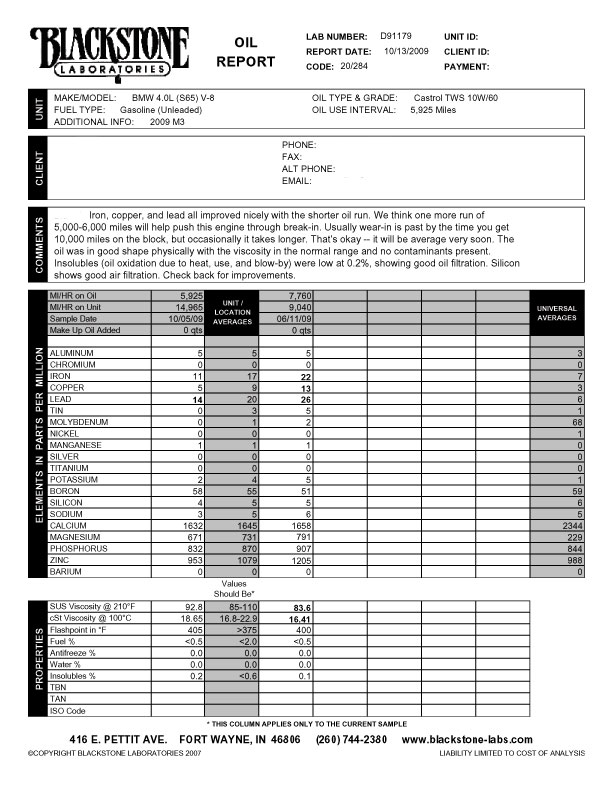

First sample from 808 MGuy @ ~ 8k
Originally Posted by 808MGuy View Post
Second report @ ~15k
2019 M2C MT (ED + PCD) | 2008 M3 Coupé MT | 1995 M3 LTW MT | BMW CCA HPDE Instructor

Here is my first report. I had about 7200 miles on this oil. Seems like many of us have high iron and copper readings. Probably will taper down after the full breakin. My lead readings are very low though compared to some of the reports in this thread. Not sure why.

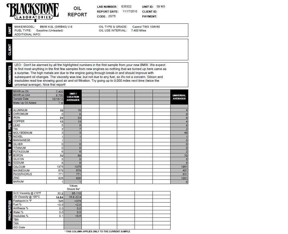

Here is my report, with 8700 miles on the car, and ~7400 on the oil. i think the high iron and copper are due to break-in. i wonder if the decreased viscosity is from track days. 8 days at 275degree oil temps may start breaking down the oil.
will post next report in ~7000 miles.
