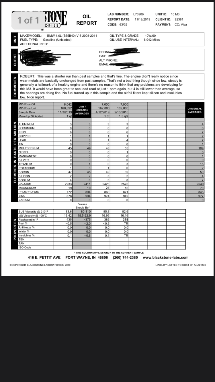

My oil analysis at 30k miles (47km).
A little concerning... Inviting insight...
Do you have any previous reports, or is this your first? Looks like your first but I wanted to make sure. Aluminum and tin appearing together does seem problematic but it's impossible to say anything meaningful without a prior history.
How is the car driven?

First analysis.
I'm the second owner and acquired it at the beginning of summer.
Low miles and a complete service history. Difficult to say how it was driven prior but used as a daily summer commuter now.
My intention is to change the oil at the stealership today to satisfy the very limited 3rd party warranty I have.
I was going to take the car off the road in a month, but by the time It would be on the road again, the warranty period would run out. Sounds like unless the part fails the warranty won't cover failing bearings but will call and confirm with them.
Just wished I had more similar analysis to compare to and the results of those cars. Maybe I'm concerned over nothing?

Originally Posted by 13Ghost View Post
First analysis.
Even if you did have reports from other cars to compare to, it's unclear what conclusions you could draw because each engine has its own wear profile even controlling for mileage etc.
Some options from here (not mutually exclusive):
1. Continue sampling at short intervals, as Blackstone recommends
2. Switch to something like Polaris Labs's "Advanced Engine Plus" service, which includes a PQ index (additional measure of iron wear for an extra data point, not much more money)
3. Pony up for much more expensive testing on your oil and filter (call Polaris or maybe some other labs and see what they advise)

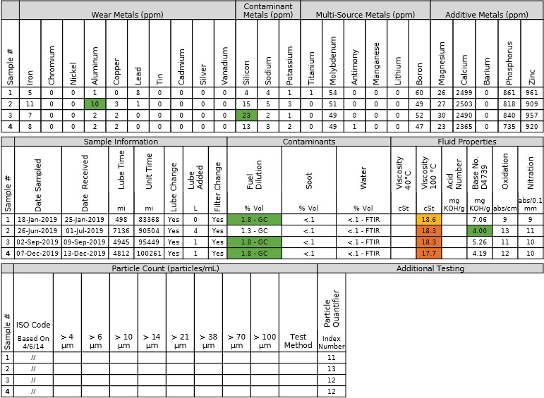

Follow-up from this.
Two road trips, a few blasts at the Tail of the Dragon, one tank of no-name non-ethanol gas, and one Techron treatment on this run. Also caught and fixed a pre-cat exhaust leak on one bank near the end, so there's probably some sub-optimal running as well (might explain the fuel dilution).
No idea where the silicon has come from. Maybe the VC gasket change I did just before this oil went in?
Copying the numbers here because Polaris's reports are kind of annoying to read:
Iron - 7
Chromium - 0
Nickel - 0
Aluminum - 2
Copper - 2
Lead - 0
Tin - 0
Cadmium - 0
Silver - 0
Vanadium - 0
Silicon - 23
Sodium - 2
Potassium - 1
Titanium - 0
Molybdenum - 49
Antimony - 0
Manganese - 0
Lithium - 0
Boron - 52
Magnesium - 30
Calcium - 2490
Barium - 0
Phosphorus - 840
Zinc - 957
Fuel Dilution - 1.8% (GC)
Soot - <0.1% by vol.
Water - <0.1% by vol. (FTIR)
Viscosity @ 100º C - 18.3 cSt
TBN - 5.26
Oxidation - 11
Nitration - 10
Particle Quantifier (PQ) Index - 12

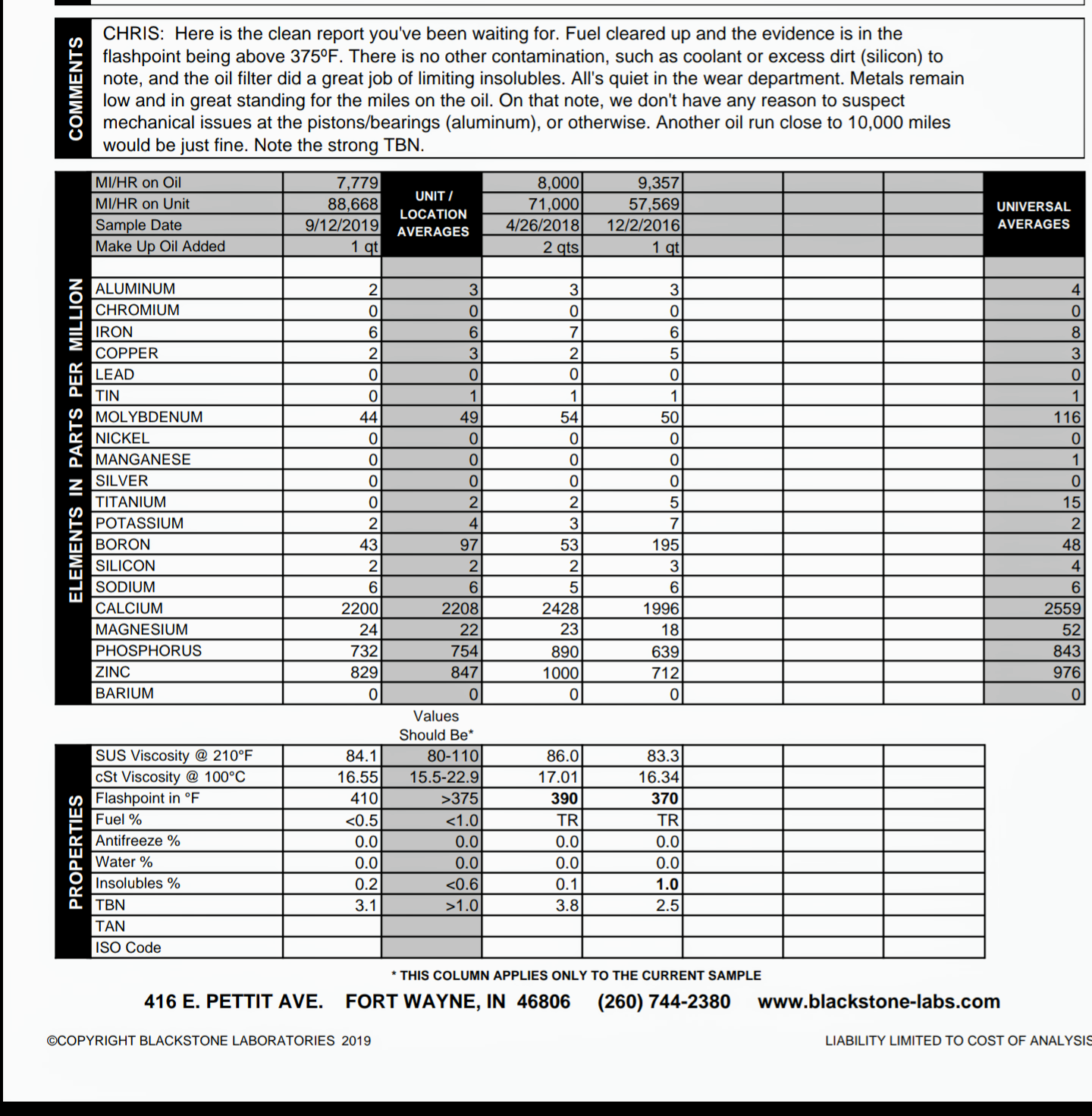

I just got the latest analysis for my 08 on original bearings. BMW 10w60
08 E92 M 6spd Gearbox Space Gray on Fox Red - Redline MTL - Redline 75W140 - 50% Llumar Film - OEM Exhaust Mod - Black Grilles & Gills - Dinan Software - Dinan Springs - F10 M5 Knob - Apex 19" ARC-8

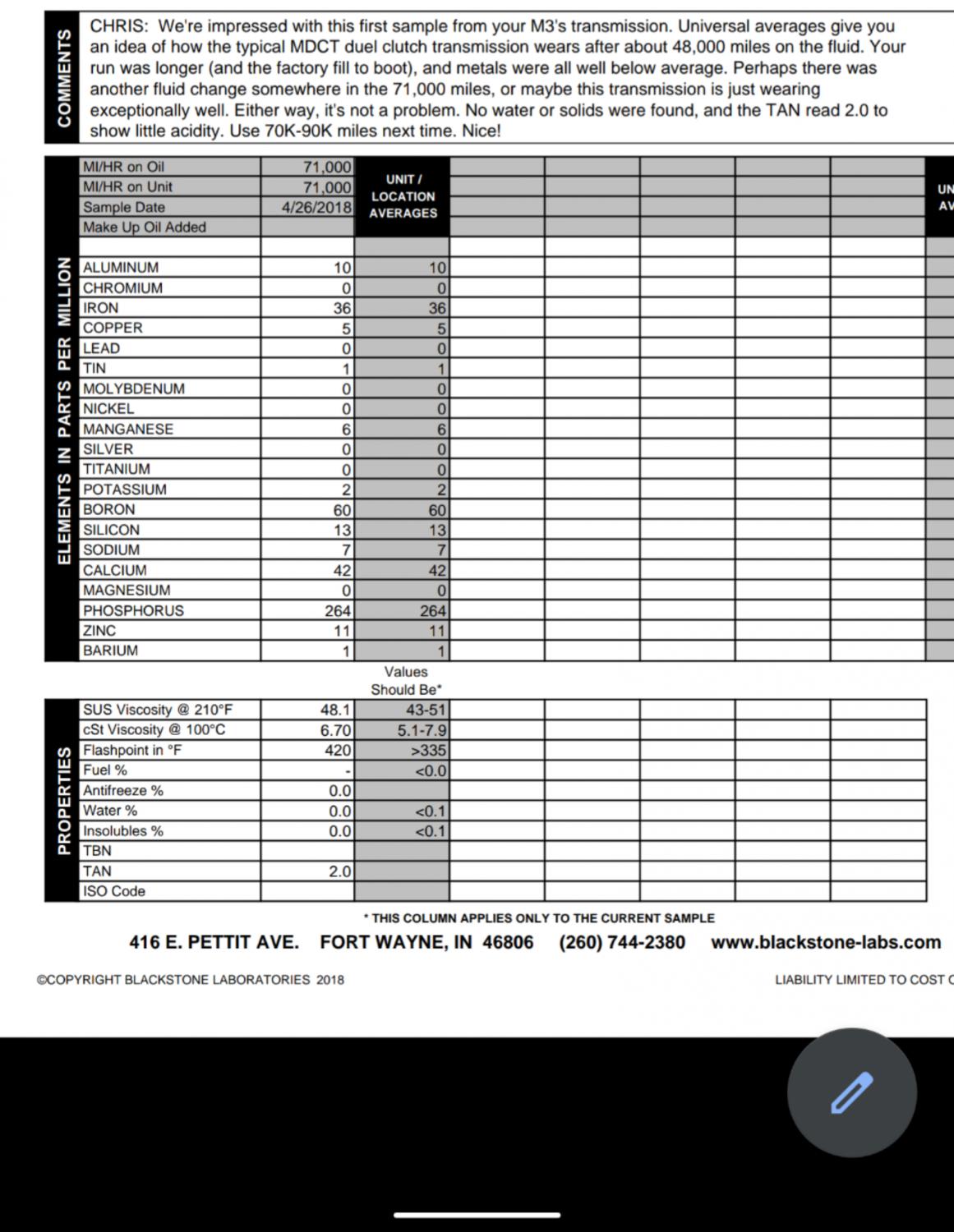

Uploading my most recent Blackstone analysis (~88.5k, original owner) for anyone who wants to take a look.
Also, adding a DCT fluid analysis at 71k I never got around to uploading.
The PDFs have your personal information in them. You should remove them and take a screenshot instead so you can edit it easier.
Looks pretty good. I think your change interval is spot-on.

2008 6MT (702/703 rod bearings)
4812 miles on the oil (BMW TwinPower Turbo 10W-60)
100,261 miles on the engine/car
A little more than halfway through this OCI, my car threw a code for a precat O2 sensor. As I understand, O2 sensors typically fail gradually, so I'm assuming this one -- and thus the engine -- had been running sub-optimally for some time before now. I'm also assuming the other O2 sensor wasn't far behind. Maybe that partly explains my historically high fuel dilution numbers. Hoping so. Replaced both about 2k miles before the drain and the car ran noticeably better.
Also ran a bottle of Techron in the fuel tank about 1000 miles before the drain.
Iron - 8
Chromium - 0
Nickel - 0
Aluminum - 2
Copper - 2
Lead - 0
Tin - 0
Cadmium - 0
Silver - 0
Vanadium - 0
Silicon - 13
Sodium - 3
Potassium - 2
Titanium - 0
Molybdenum - 49
Antimony - 1
Manganese - 0
Lithium - 0
Boron - 47
Magnesium - 30
Calcium - 2365
Barium - 0
Phosphorus - 735
Zinc - 920
Viscosity @ 100º C - 17.7 cSt
TBN - 4.19
Oxidation - 12
Nitration - 10

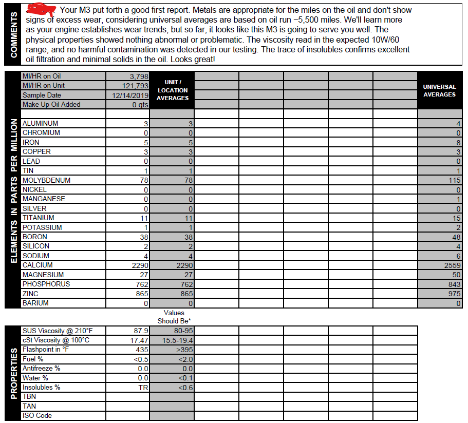

Got first report of my ownership. The previous owner did get the RB replaced but no oil analysis.
In general, the report looks solid, the new BE RB has about 40+ K miles and seems ok.
However, the universal average seems to be 2011-2013 MY, but my car is actually Jan 09 car/engine. It should not be too far off I hope.

e92zero, leo95se, MTROIS or anyone whose done regular oil analysis, have you got oil reports from the 1st service? (including running in service would be ideal).
Old post I know, but are the oil reports you mention shown in this thread? (or somewhere?)
Are you asking about the car's 1200 mile break-in service, or do you mean the first oil change after a bearing job? For either one, you will see high particulate counts and contaminants from assembly. The one I had done on my Corvette as part of the 500-mile break-in service had high levels of iron, copper, and silicon, for example. The numbers fell sharply on the next oil change, and then stabilized on the third one.
Past: 2011.5 M3 sedan ZCP
      04-02-2020, 08:43 AM   #1056
Assimilator1
Assimilator1's Avatar
United Kingdom
877
1,289
Join Date: Sep 2019
Location: UK, Surrey
2010 BMW 330d  [8.00]
2008 BMW M3  [0.00]
Yea all oil changes ideally, appreciate that the 1st one will show high metals etc.
Would like to see trends from the start (from new engine &/or new bearings).
One theory (for some S65s at least), is that the wear occurs early on in the engine's life (mainly thinking for OEM bearings). Hence I would like to see the whole history, but I appreciate that very few people will .
