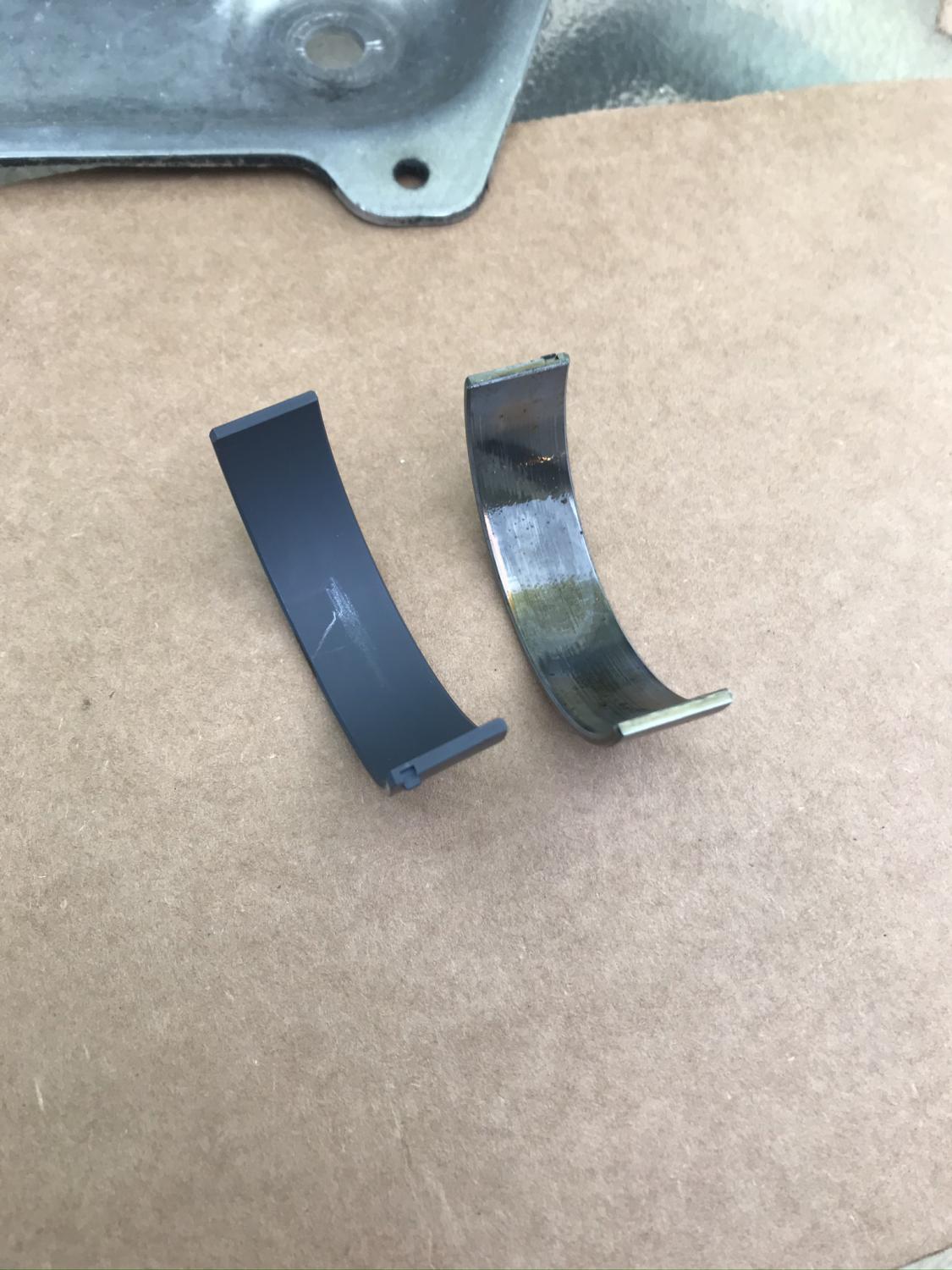

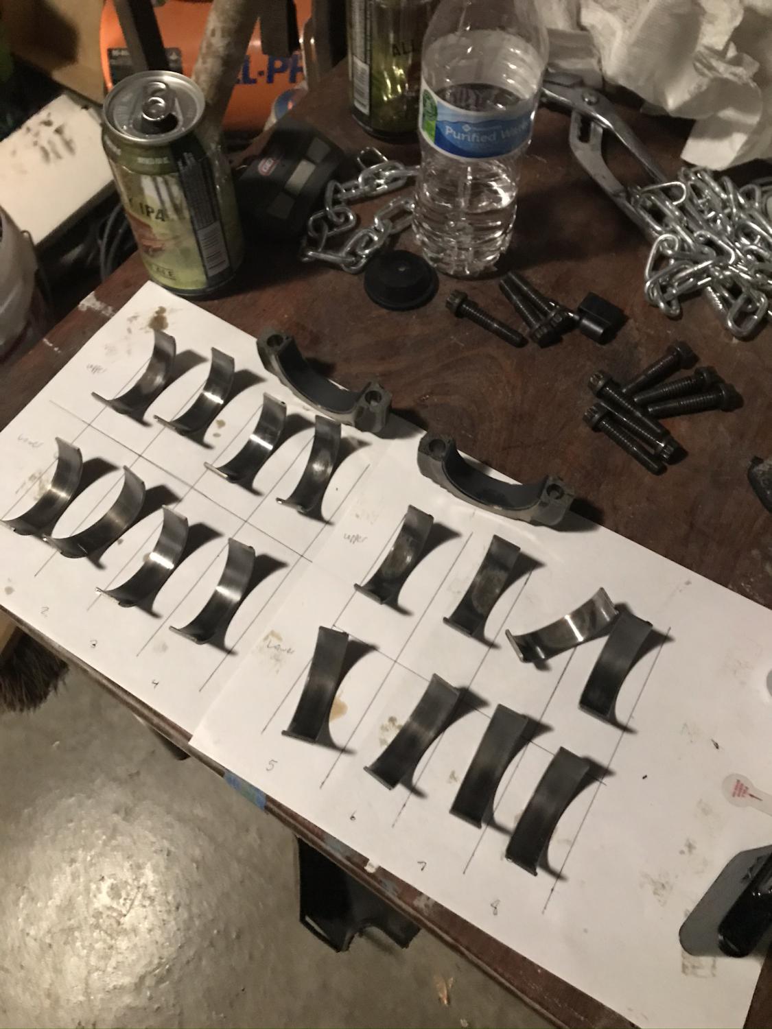

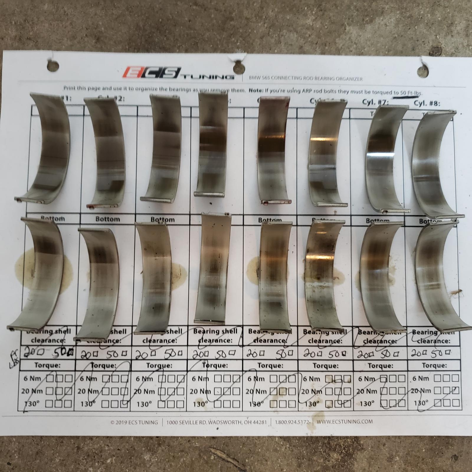

Finally got to my rod bearings on my 2010 DCT 97k mile E92 after rebuilding my throttle actuators 1k miles ago. And btw as a EE don't even attempt to rebuild this circuit, there's some kind of high heat adhesive underneath the transistors.
I have no idea on the prior history of the vehicle, however, it ran like a champ for the last 30k miles I put on it, and I was always on top of the oil changes (every 3-5k).
Did this on jack stands, not a ton of fun.
I did screw up by opening a car door mid procedure and I could hear something in the electrical system trying to actuate repeatedly. I realized it must be due to the removed ground strap on the oil pan, so I re-attached and it chilled out. Hoping this didn't cause any other issues, but I'll find out in a few days.
Also, I noticed that rod #1 had finger loose bolts, I believe this is also a cylinder that usually has a darkened spark plug. But I think this was due to a leaky oil cap, which has been replaced. Not sure if I should really be concerned with this or not...
I'm now in the process of reassembling this beast and juggling my 24/7 job.
But I enjoy taking my time with the car, as I enjoy driving this car way too much. I'm cleaning all the parts and electrical connectors as I probably won't have this much exposed again for a while.
I'm hoping to work out a few remaining issues on the car after putting back together and then taking a nice drive through the Rocky Mountains as it's been an ass of a year.

First off, great work doing this yourself on jack stands. That’s got to be a tough job. Judging by the marks on the new bearings I’d say you used BE. Excellent choice! I really want to know if rod bolts on cyl1 were only finger tight that can’t be possible. You would have had major issues prior to noticing. The oily plug is probably from a leaking spark plug tube above it or improper torque on that plug allowing it past. An oil cap won’t have anything to do with an individual spark plug. Did you drop in new plugs while you were at it? Cheers for the good work, but get some better beer than that founders all day stuff…
It’s typical for a flush mounted transistor heatsink plate on the back to be fully soldered to the board requiring great heat to release them. Usually a hot air solder station is required. Do you think this is the case or was it epoxied on the board? I’m tempted to go dig up my old TAs and see how they were done.
-It's quite possible that I was not completely focused when I was losing those up... I'm also doubting it was loose prior to me touching it.

BE and ARP done - 2011 M3 62K miles
BIG THANK YOU FOR THIS DIY!!!
Did this to my 2011 M3 62k Miles, BE and ARP only issues I had was missed 2 bolts on the pan, but once we saw them the pan fell down, so no need to pry or unstick gasket.
Took a solid day to do it all, one other issue was lining up the motor mounts, now I am thinking we should have left the lower bolts loose until it was pushed up into the top holes.
Used a hydraulic jack and a 4x4 to lift the subframe up.
The ECS guide says remove the F70 fuel pump fuse and leave the coil packs off to turn over for 30 seconds, but you have to just leave that fuse in or put it back before turning over.
All bearings had some wear, not as bad as I have seen, but there should be none.
Took 8.8 liters to fill exactly to correct oil level.
Had to lift the fan a little but left in, one bolt and some clips in order to reach the 32mm bolt to turn the engine.
One bell housing bolt would not come out completely due to pipe in the way but it came out enough to drop the pan.
Do part of Step 9, disconnect the headlight level sensor and sway bar.
Skipped step 8 and left the subframe hanging, with plenty of room to work.
Skipped part of step 12 photo 2 for the same reason, not removing sub frame.
Having the below printed guide helps a lot with the reassembly checklist too.
