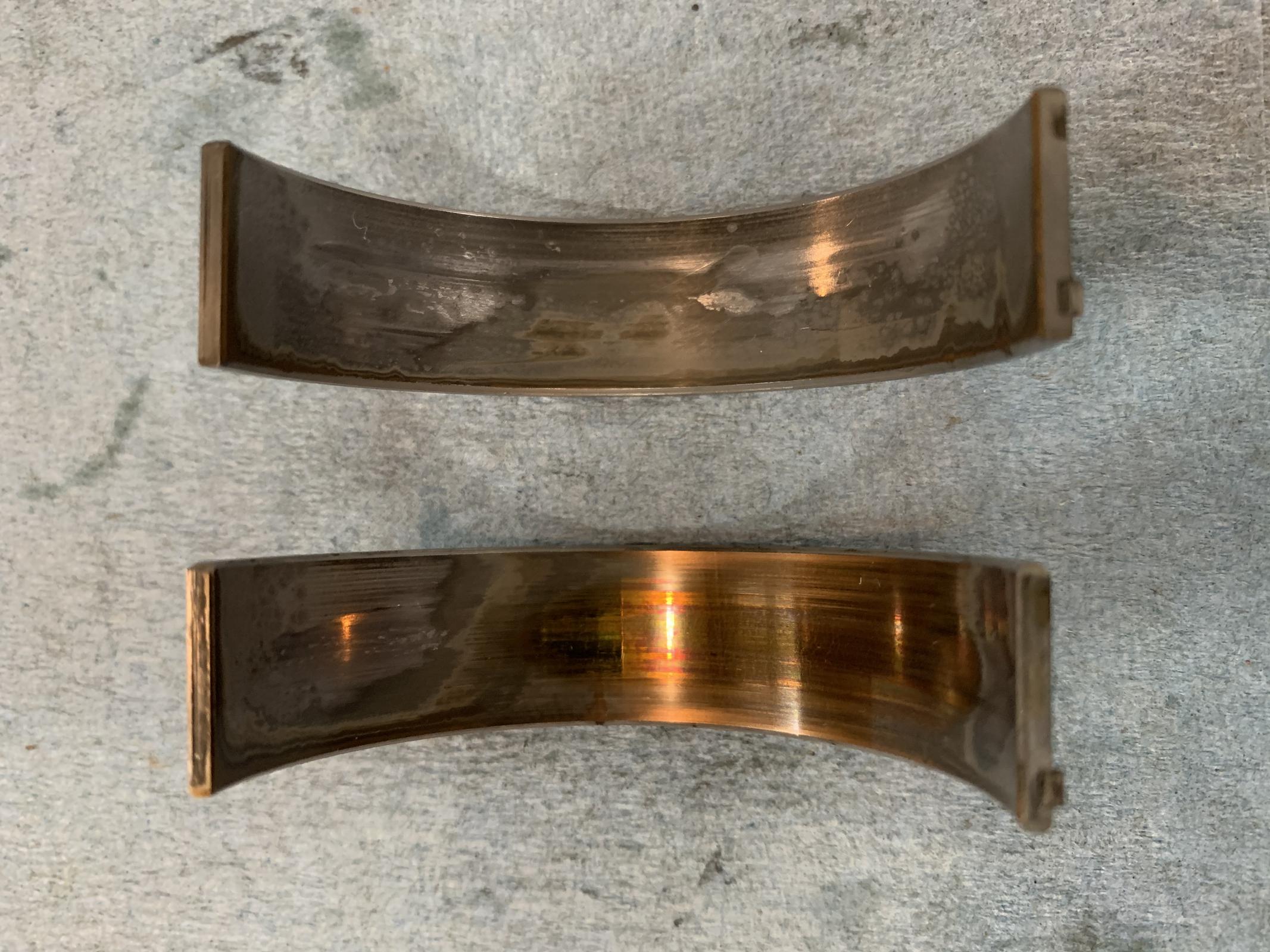

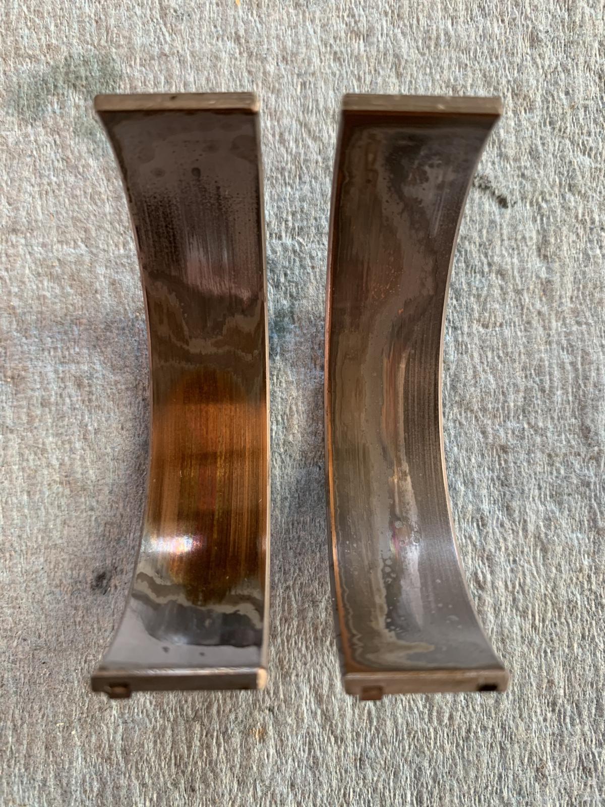

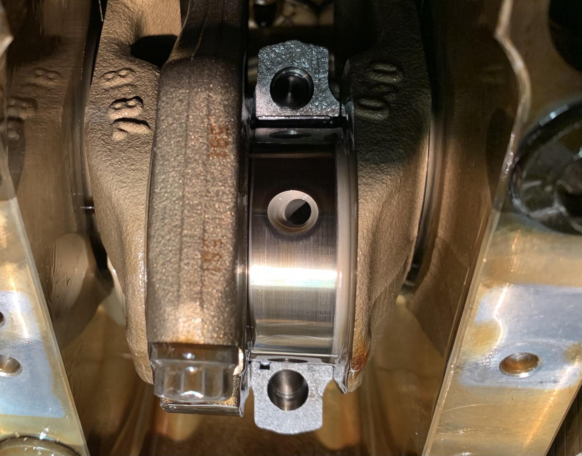

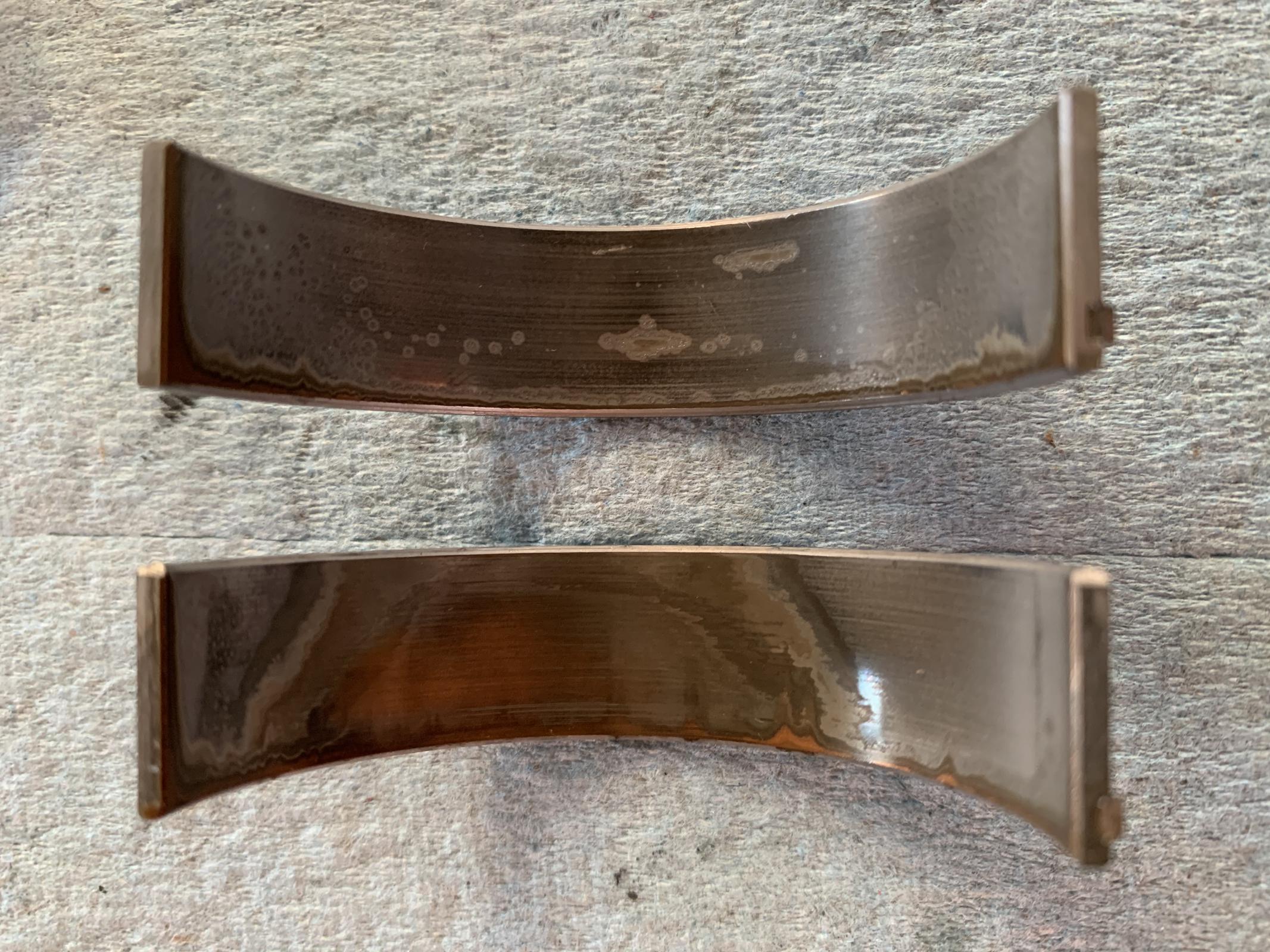

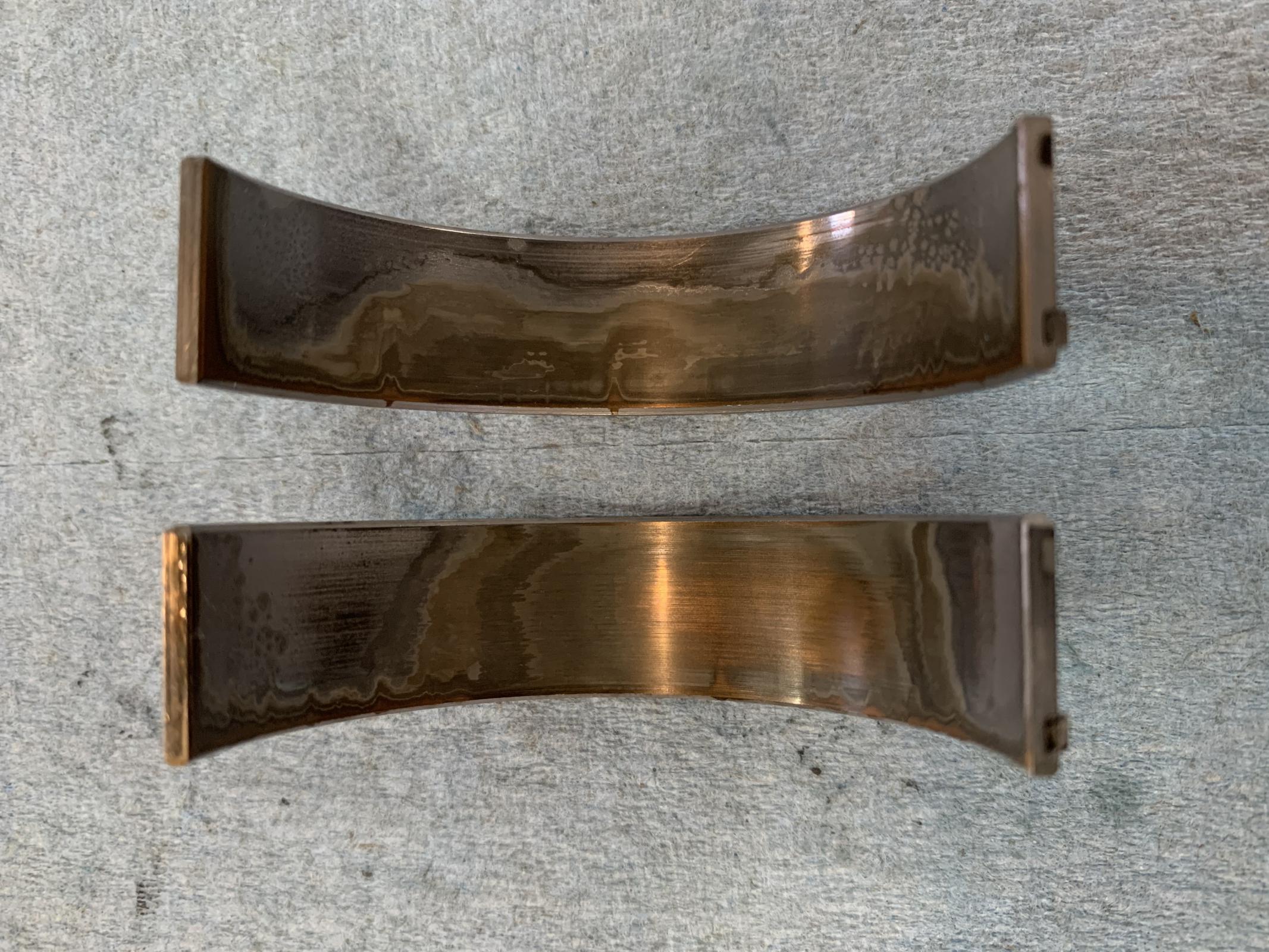

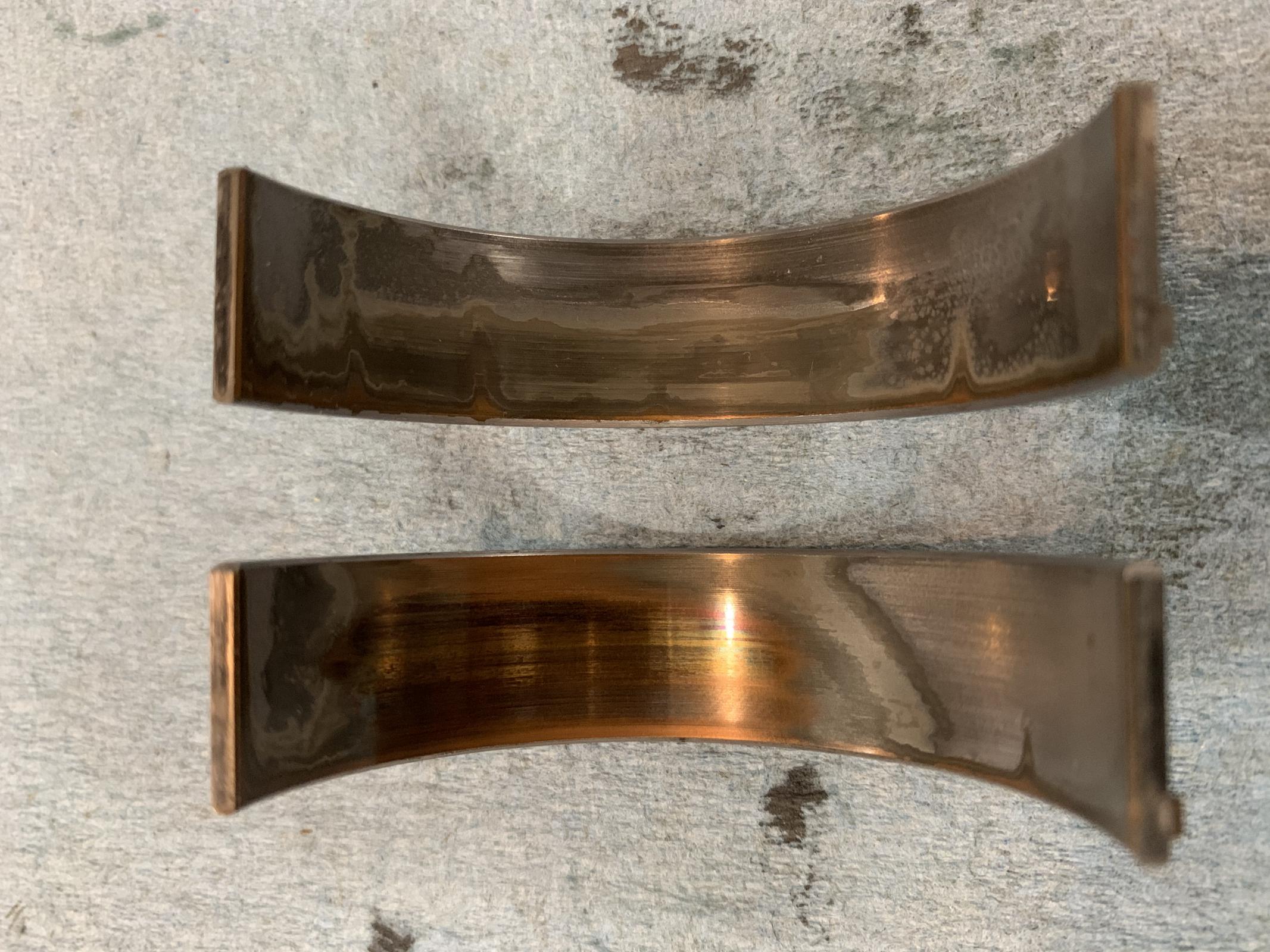

Crank Rod Journal Examples:
Attachment 2522439
Attachment 2522440
Starting at the front of the engine and progressing toward the transmission in order. All pictures have the Rod Shell on the left, or the bottom depending on how the pictures decided to upload.
#1
Attachment 2522444
#2
Attachment 2522445
#3 (Rod shell was relaxed and sitting gently on the crank)
Attachment 2522446
#4
Attachment 2522447
#5
Attachment 2522448
#6 (Rod shell was relaxed and sitting gently on the crank)
Attachment 2522449
#7 (Rod shell and cap shell were relaxed and sitting gently on the crank)
Attachment 2522450
#8
Attachment 2522451
