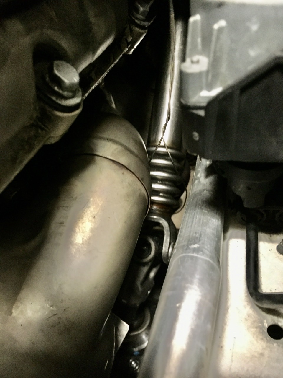

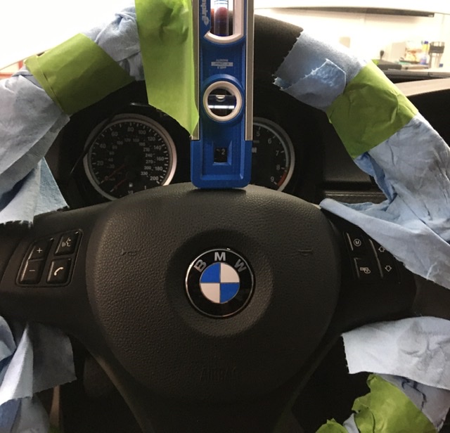

Off center steering wheel is bugging me. I don’t remember moving the steering wheel back to the highest position either before disconnect
Steering wheel is off center, although the rack is keyed I may have assembled a teeth or two off center. Going to pull the steering bolt back off and realign to see if that cures the issue. Good thing I bought extra steering bolts.

Off center steering wheel fixed
Always easier the second time around. I popped the hood, pulled the air box, removed steering coupler bolt and reinstalled in less than 10 mins. I used a magnet (pull the bolt out), steel fishing wire (hook the upper part of the rack) and serpentine belt tool (as a guide).
Steering wheel is now centered.
Interestingly, the wheel can be off even though the key fits.
Before doing this, I moved the steering to highest position which seemed to help.
