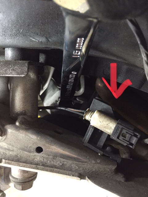

Cayman Islands
2891
4,444
Drives: Green Bastard
Join Date: Jun 2007
Location: Bishop Bend
Broke cable bracket
Servotronic cable bracket part number?
Tried realoem and couldn’t locate the part number for this servotronic cable bracket (Cable part number is 61129115546) that attaches to the front subframe. Anyone know the part number?

What did your google searching for e90 servotronic cable bracket show? Mine showed this:
https://www.m3post.com/forums/showthread.php?t=1459677
You are not the first to break it while working on your car.
Thanks. I used the forum search not google search. Lesson learned.
