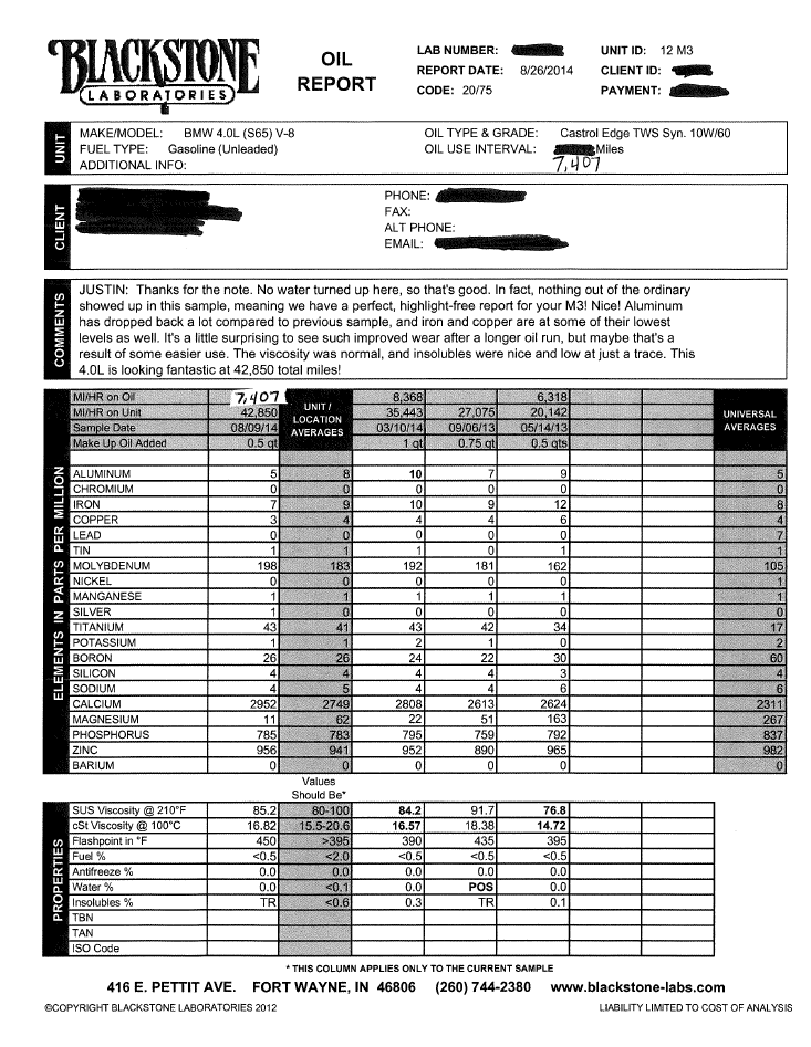

Here is my latest oil analysis. Only 2 track days on this oil which is lower than the previous ones. They also wrote the wrong mileage on the report so I corrected it. If you are wondering why he is talking about not finding water in the comments, it is because I forgot the sample container Blackstone provided and just grabbed an empty plastic water bottle I had just finished and tried my best to get it dry, but there were still some drops of water in it when I handed it over to the dealer.
Still not sure what metal to look at to determine wear in the newer bearings. Overall it looks like a good report to me with the metals being lower than in the past, but the car did not get hammered at the track that much this time.
Any comments and feedback are always welcome.

Things look fine, though you should be paying for TBN and TAN to understand the appropriate change interval. Particle counts alone are of limited use.

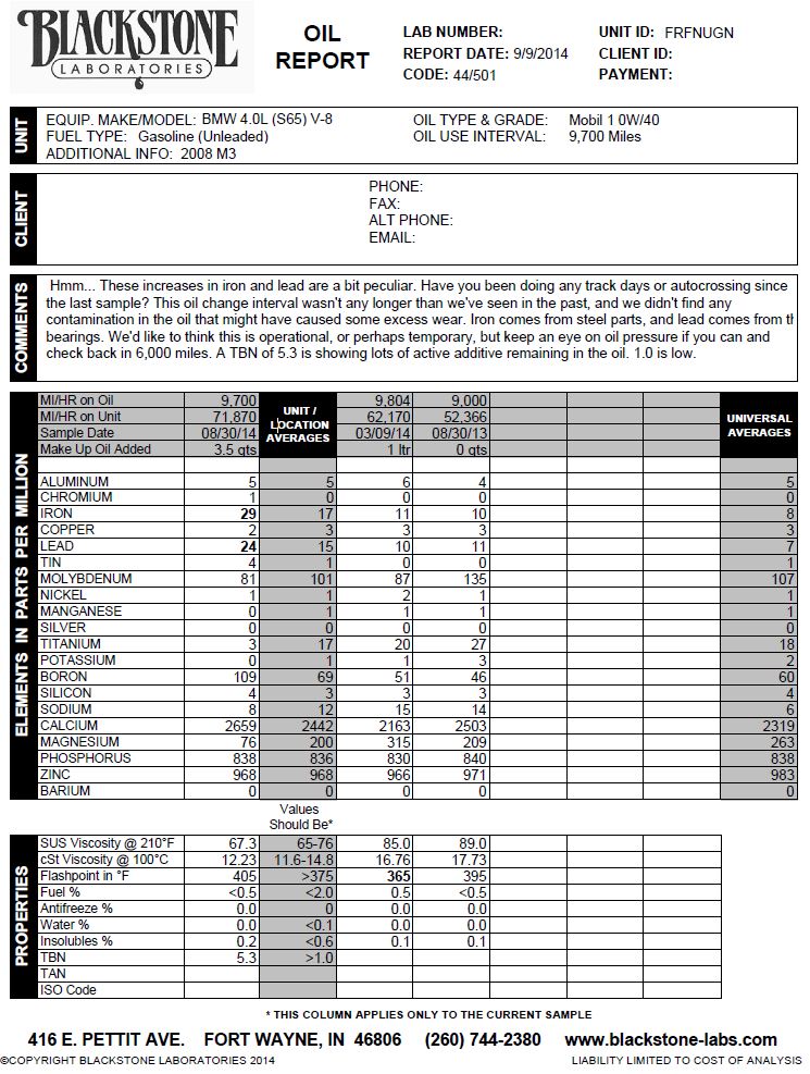

One word comes to mind when looking at my latest report...
Mobil 1 0W-40 with 9,700 miles and no track days or autocrossing. Just drove it like it was built to be driven, especially around round-abouts on the way to/from work. 8300 sure sounds nice when everything is warm (never with cold oil).

Location: Indy
Iron
Main bearing bedplate inserts

Iron
Camshafts as well.

Originally Posted by thekurgan View Post
Camshafts as well.
Mobil 1 0W40 is a good oil , but not for our S65 !
Increase of metals means lack of lubrication film especially on small clearances like knew of our S65 !
Personal i'll keep it with EDGE ! Actualy I had both between my fingers and could feel the difference , EDGE sticks more and longer than the Mobil !
Conclusion for me personal is that the lubrication film of EDGE is way better !

Isn't 9700 miles on Mobil1 beyond its recommended change interval? I know the Mobil1 Extended Performance oil says it can go to 15k miles. But the 0W40 is not available in Extended Performance.
I plan on changing my 0W40 every 5k miles.
Seems like most who are using 0w40 shorten the change interval to 4-5k miles.
But even at double that interval, that report above does not look normal.
