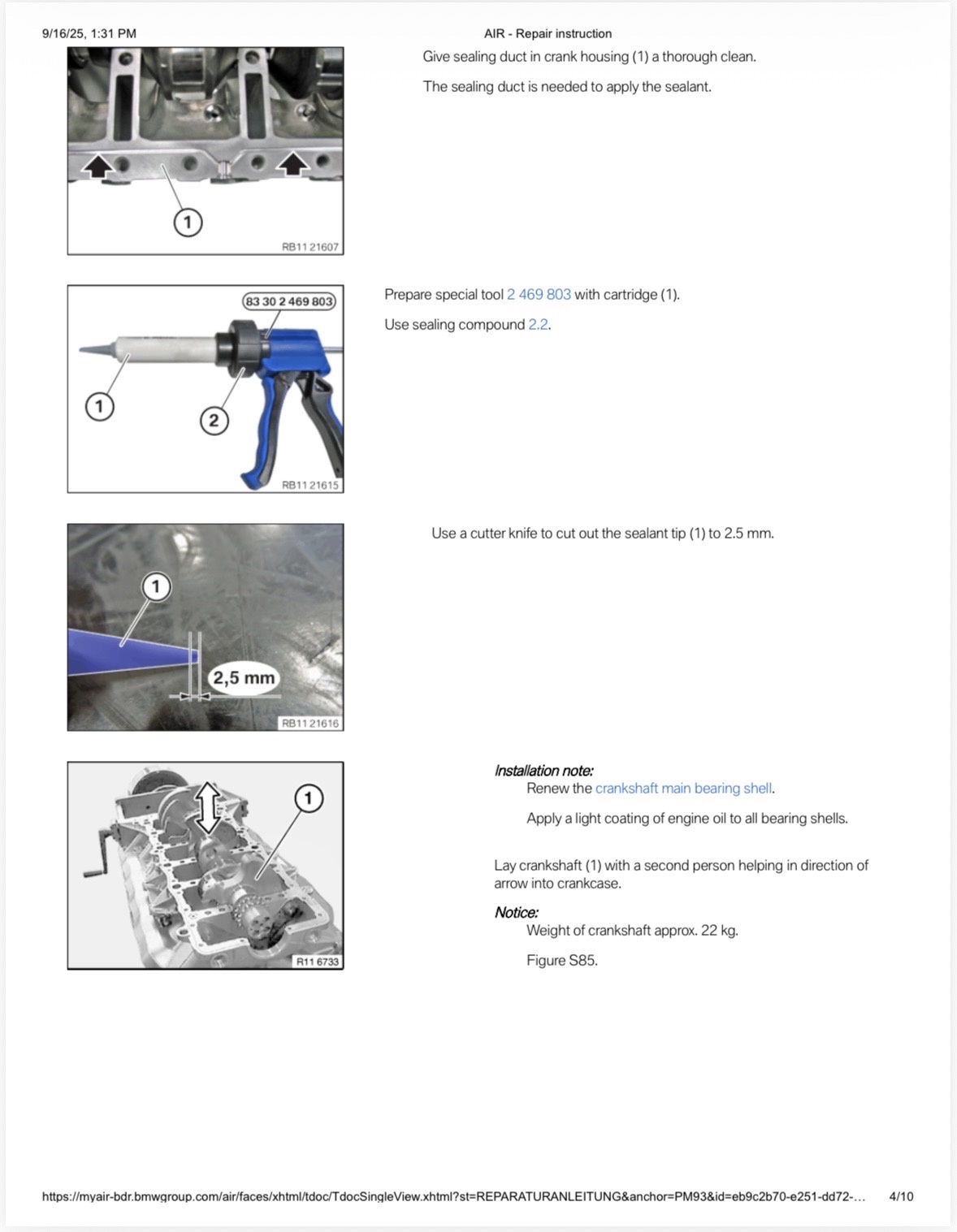

      10-19-2025, 03:18 PM   #165
Jbonly21
Jbonly21's Avatar
2210
1,197
Drives: Bmw 15 F80, 2011 X5 35i, E46 M
Join Date: Mar 2019
Location: Los Angeles
I reached out to a couple of S65 engine builders, and I was told they reached out to loctite. And it was confirmed they are no longer making that sealant. This is the new procedure and this is what mine looked like when I did it. I have done 200 miles so far.

      10-24-2025, 06:48 PM   #167
Assimilator1
Assimilator1's Avatar
United Kingdom
877
1,289
Join Date: Sep 2019
Location: UK, Surrey
2010 BMW 330d  [8.00]
2008 BMW M3  [0.00]
Yea, except the AIR exert doesn't say how wide the bead should be.....

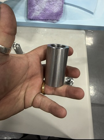

Yeah, we were EXTREMELY frustrated with this. In our opinion, "good 'nuff" just isn't good enough. Aside from using feeler gauges, nothing we do is done by feel. Every specification in every motor we build is manually checked for certainty, especially where critical tolerances are concerned. The idea of smearing sealant onto the bed plate had me pressed. So I designed this:

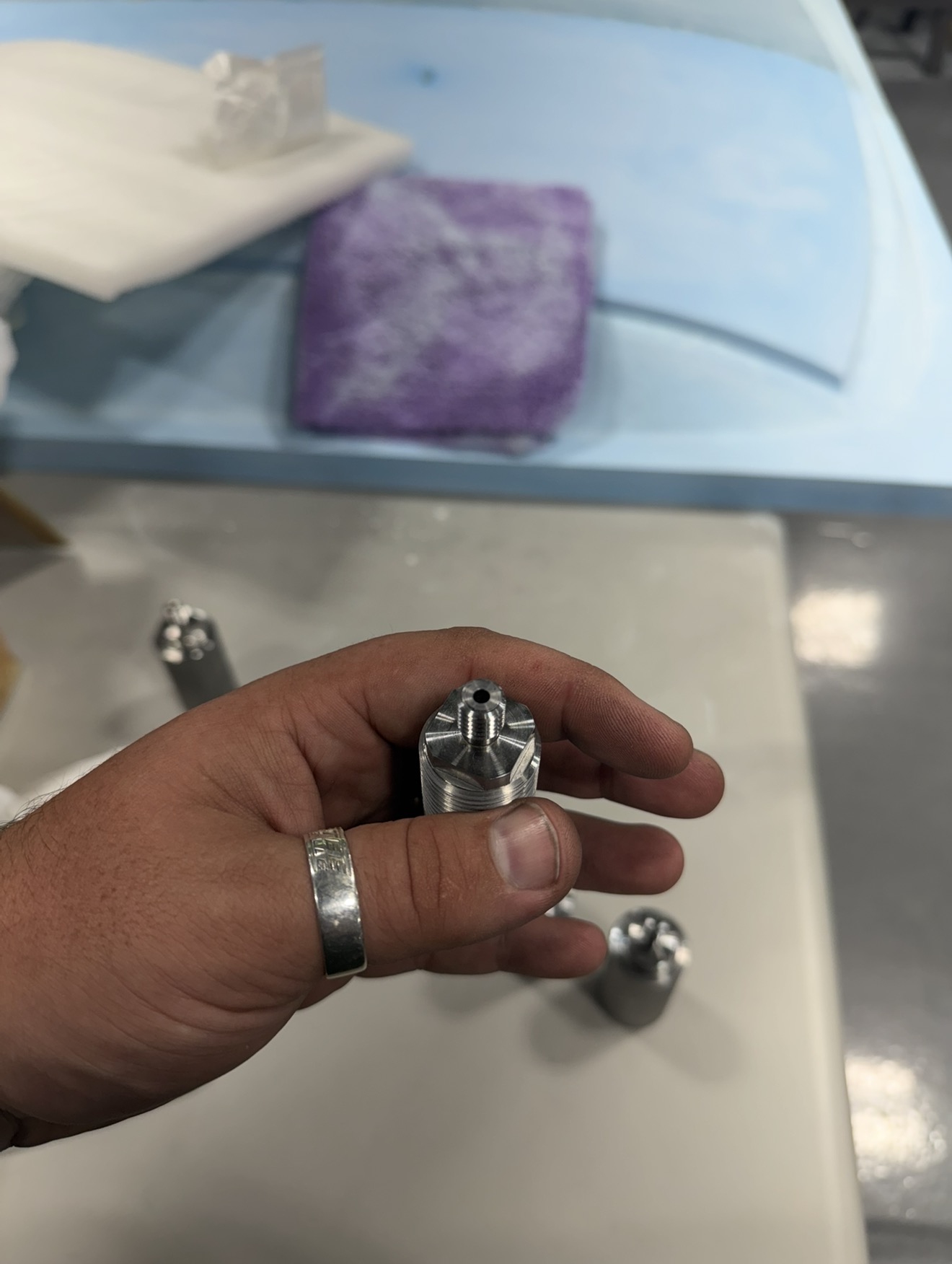

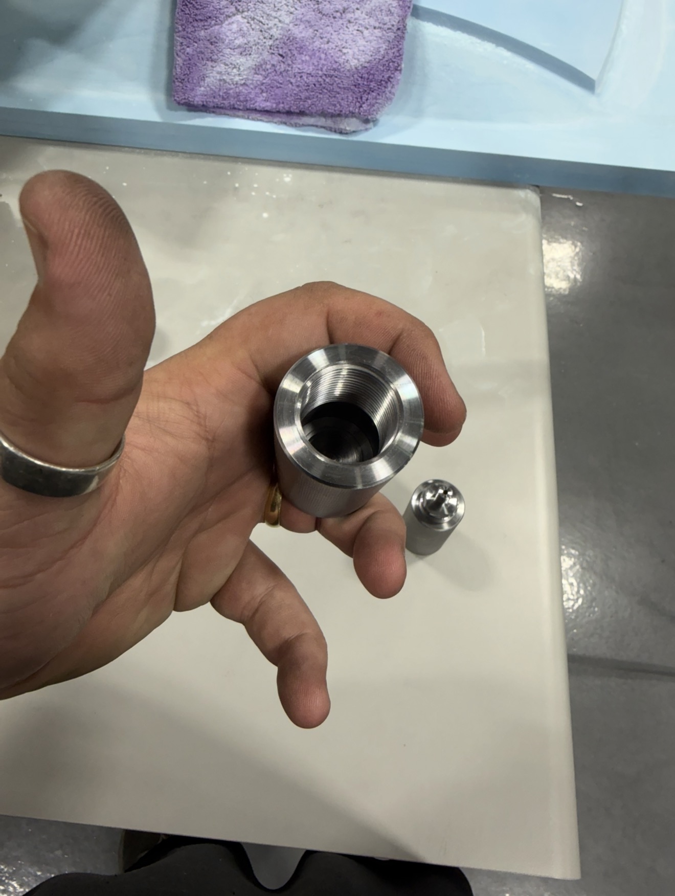

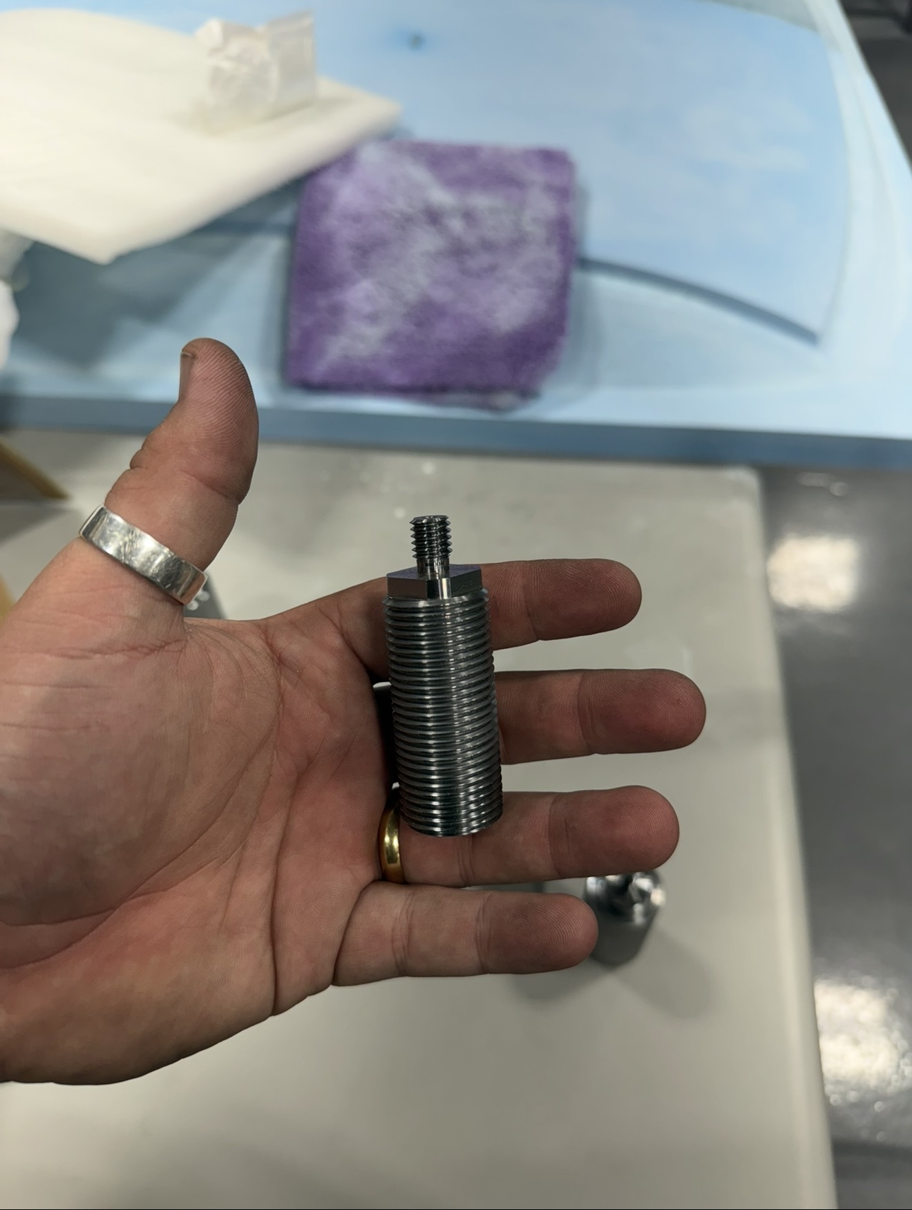

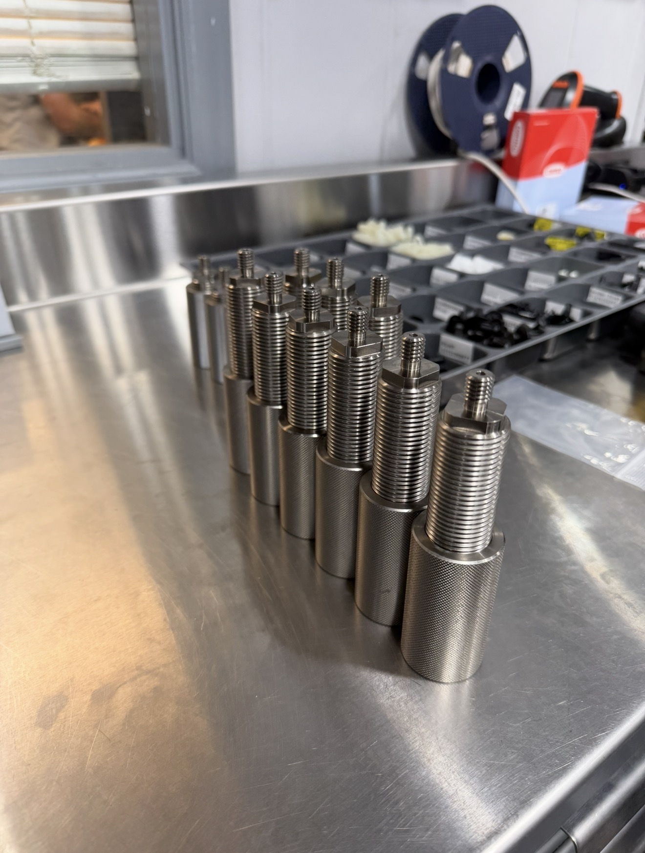

https://parteeracing.com/store/other...njection-tool/
Essentially, once the block is prepped and ready to check main clearances (bedplate bolted and torqued to the block), you tap the original sealant port on each side of the block with a 3/8" tap (I know, I know, it's a standard bolt size on a metric motor; I hate it too. But the sealant port is the exact diameter you need for a 3/8' tap, so using 3/8" eliminates the need to drill the side of the block before tapping it.), then go about taking your measurements as normal.
When you re-open the block to install the crank (assuming you were happy with clearances ofc), you can then clean out all debris from the tap, install the crank, re-torque the block, and once the main seals are installed, use our injection tool to inject the new BMW recommendation for bedplate sealant.
The process is extremely simple- easier IMO than the original stuff. Simply hand-thread the injection tool into the block, and then start turning the knob. The knurled knob is threaded onto the injector body; turning the knob will press the billet plunger into the injector body, which will then hydraulically force the extremely viscous sealant through the channel with ease.
The injector tool will create well over 10,000 PSI at just 14Nm of torque applied to the knob, but in our experience, far less is required- we have never needed more than our hands to inject the sealant all the way through the channel.
General Manager

      08-06-2026, 01:42 PM   #169
charliev68
charliev68's Avatar
370
366
Drives: bmw m3
Join Date: Feb 2020
Location: CA
Picture of the tool doesn’t show up.
Jbonly212210.00

Originally Posted by Chrisyphus View Post
The process is extremely simple- easier IMO than the original stuff. Simply hand-thread the injection tool into the block, and then start turning the knob. The knurled knob is threaded onto the injector body; turning the knob will press the billet plunger into the injector body, which will then hydraulically [...]
Procedure is to install the front and rear oil seals before injecting the sealant.
Due to the thicker compound, did you inject the block using the new tool before or after the oil seal installation?
DrFerry10035.50

      08-07-2026, 05:54 PM   #174
Chrisyphus
Chrisyphus's Avatar
475
194
Drives: e92 M3, Model 3 Performance
Join Date: Jan 2024
Location: Danville, Va.
Sorry about that! Not sure what happened to the website's photos; I'll repair that in the morning.
For now, iPhone pics will do. These are all from before they were finished with ENP for corrosion resistance
We still install the main seals first and allow the new sealant to squeeze out the gap to create the best seal possible.
Me being a Honda guy, there's nothing better than Yamabond / HondaBond for sealing a bedplate.
This debate rages internally lol. All of us agree that all the aforementioned options are good. Either will work with our tool- those or the OE recommendation.
