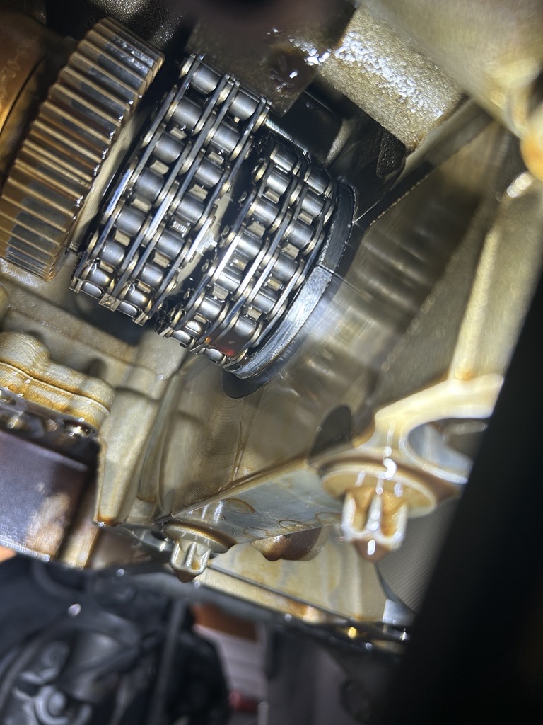

Also the oil pump gearing puts load on the front main; reactionary forces.
Two double-row timing chains also put a load on the front crank.
In comparison to the S85, the S85 only has a single row chain per bank.
All of which make the front of the crank want to climb up the main #1 bearing.

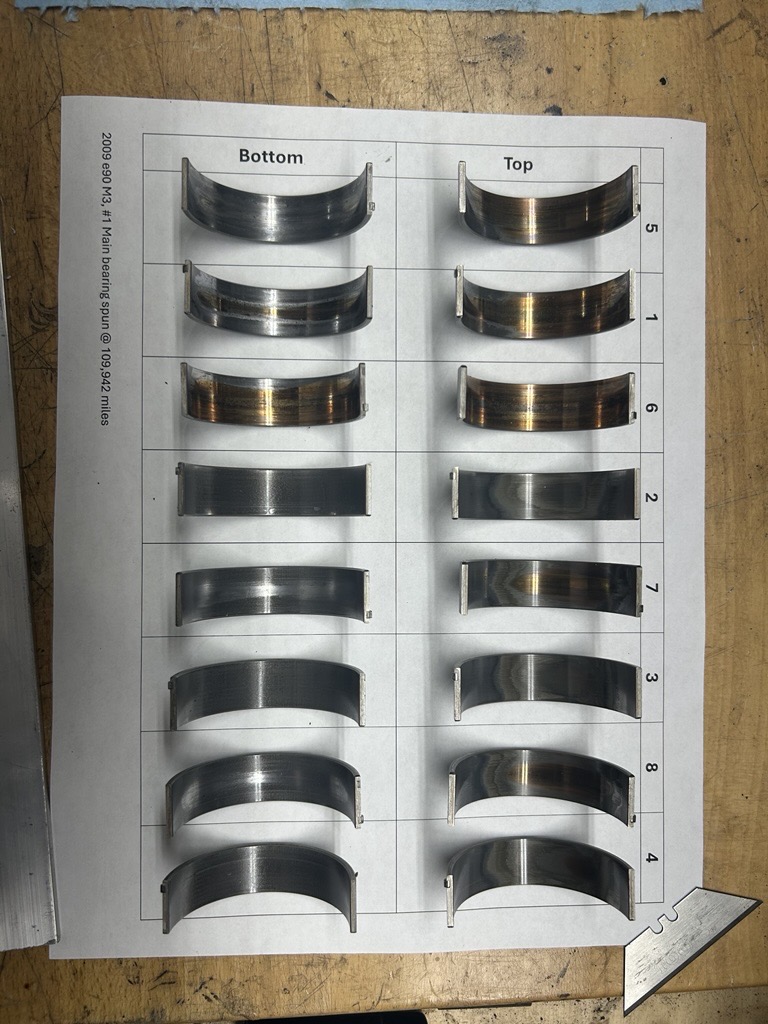

I just spun #1 main bearing on my e90, it shat all it's parts and pieces through the first three RBs. The rest of the RBs looked to have typical s65 wear @ 110k miles. Currently on the search for a motor. Oddly the motor still ran and idled smooth and quietly, it felt a little down on power then really didn't like a load on it, so I towed it home and pulled the pan to find sparkly oil and slivers in the oil picks. I'd planned to do the RBs soon when I got some free time, glad I didn't now, that would have sucked. Of what I can see the crank looks good, just won't know until I get the motor out and pull the bed plate.

I'm afraid to say that if no1 main has spun, the crank won't be ok, nor likely the block .
Sorry to hear about your engine (I'll add it the blown engines list).
What year is your car btw?
OE RBs?
