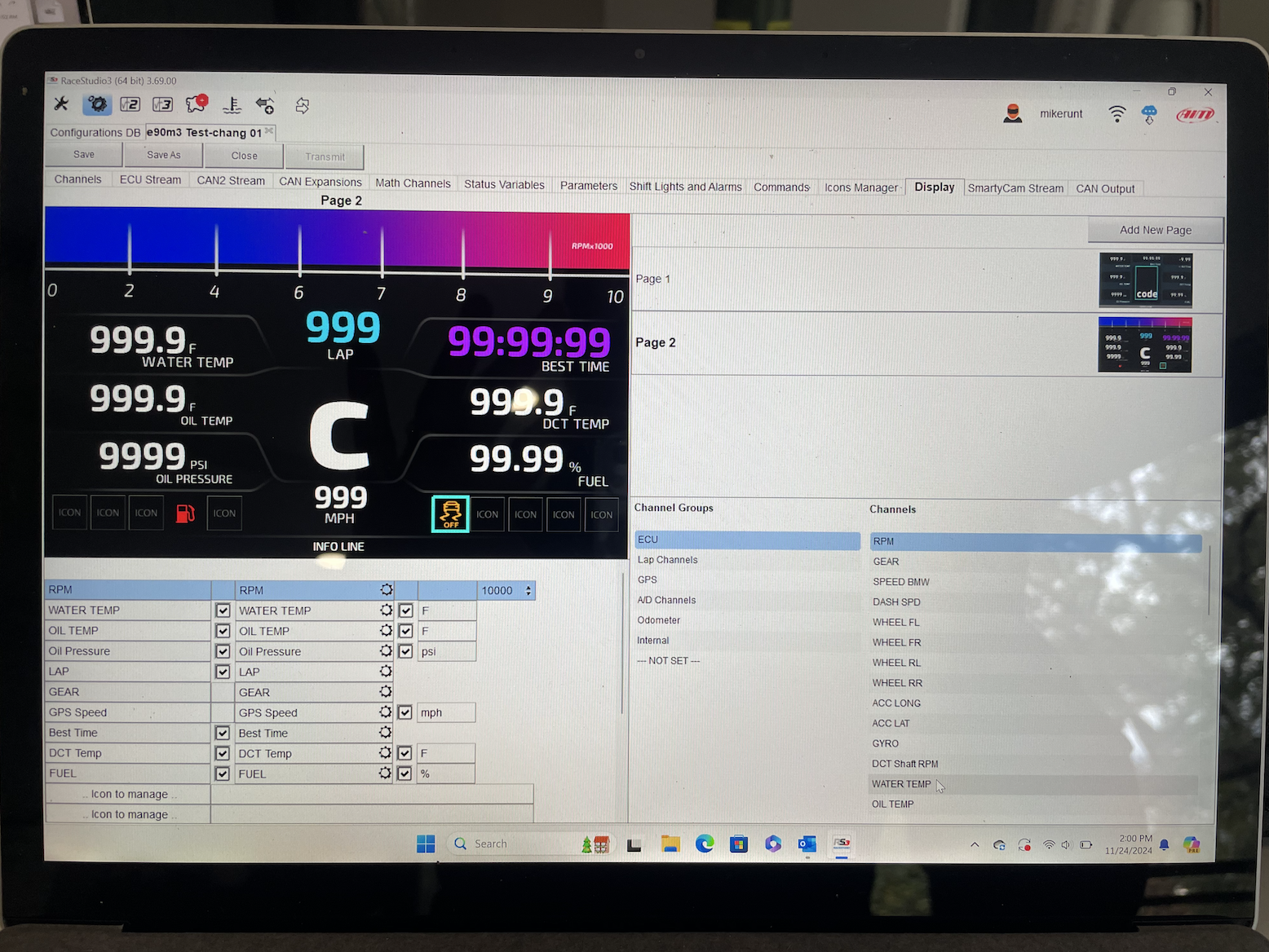

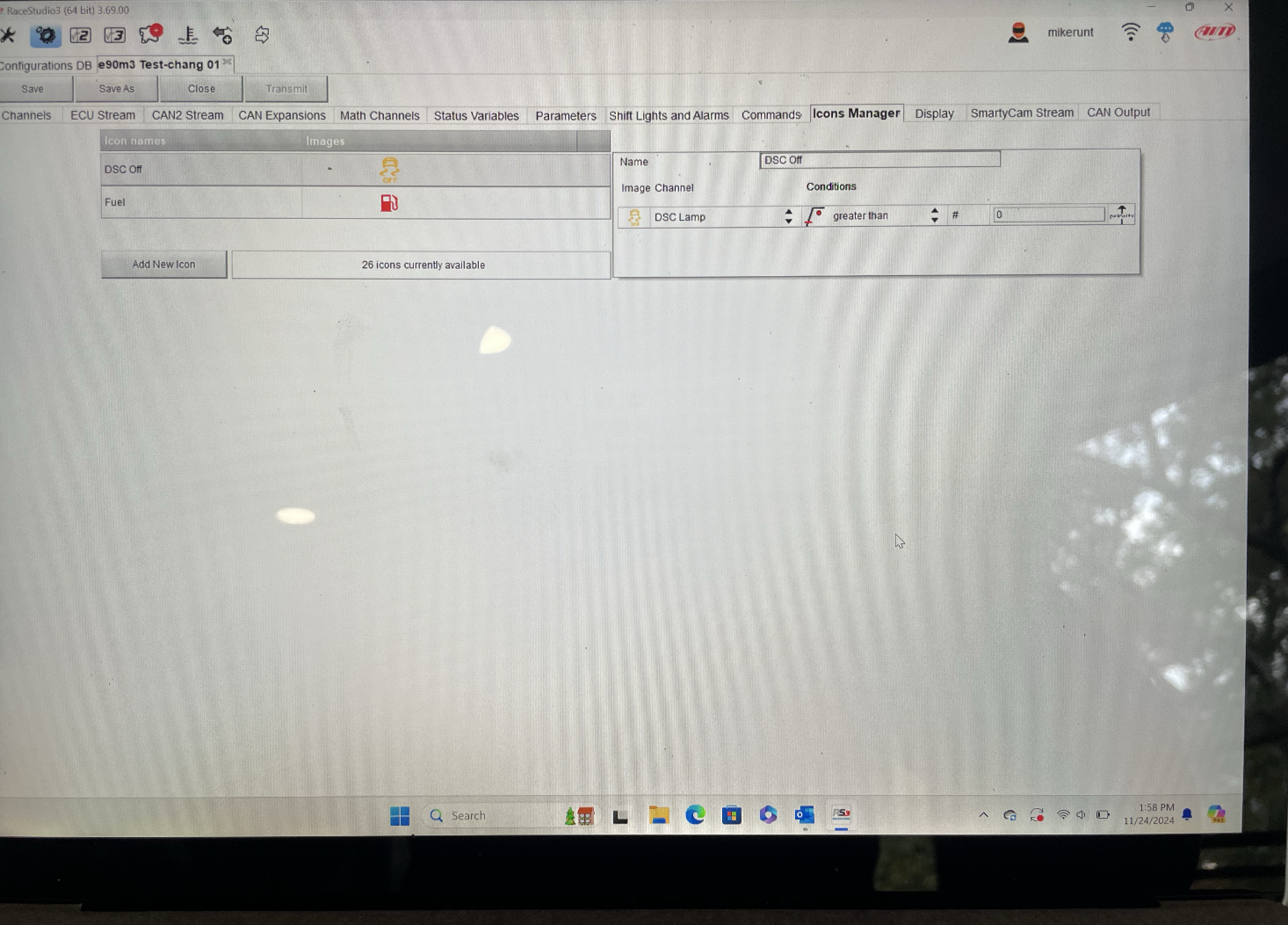

This is how i am aware of getting the 'DSC' info onto the AIM. it is not 100% accurate and takes a little tinkering, but it's how i got it to work. i dont have my car in the garage right now so cant go out and show for certain, but this should help get you in the ballpark.
Make sure in the ECU Stream that both DSC Status and DSC Lamp are enabled. i forget 100% if it is 'lamp' or 'status' that indicates when DSC is turned all the way off vs when the car is actively intervening.
Name:  Screenshot 2024-11-24 at 1.10.52 PM.png
In Icons Manager, attach the ICON you want to use to indicate when DSC is or isn't active. you'll see on the right side you need to set the conditions for what drives this - i get confused on this part, but by trial and error you'll figure out what parameters are correct.
Name:  Screenshot 2024-11-24 at 1.10.44 PM.png
On your Display, choose a dash setup that allows for Icons. you have an MXG i think, so not entirely sure how this looks on your end, but this is my MXS. under ECU --> CHANNELS towards the bottom you will see the DSC from the ECU stream - drag that to an open ICON area. it will open another dialog box from where you made the Icon, and you just select the one you made and click OK.
apologies that this isnt more prescriptive and exact, but it will get you close. when i have my car in front of me i can do a better video if this still doesnt work.
Attachment 3607983
Attachment 3607985
On your Display, choose a dash setup that allows for Icons. you have an MXG i think, so not entirely sure how this looks on your end, but this is my MXS. under ECU —> CHANNELS towards the bottom you will see the DSC from the ECU stream - drag that to an open ICON area. it will open another dialog box from where you made the Icon, and you just select the one you made and click OK.
Attachment 3607983
+ 1, have that on my MXS as light. Don’t recall how i did it as its been 2 yrs. But this seems right.
