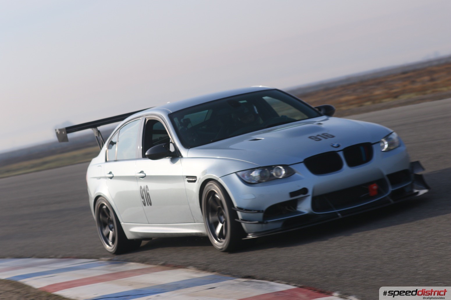

Here are current track pictures. I will take and post a few of the current look this weekend. The HGK pieces (certainly the most exciting of the list) have not arrived yet and I pick up the seat from EAS on Saturday (although, it's just a seat, so not all that exciting)

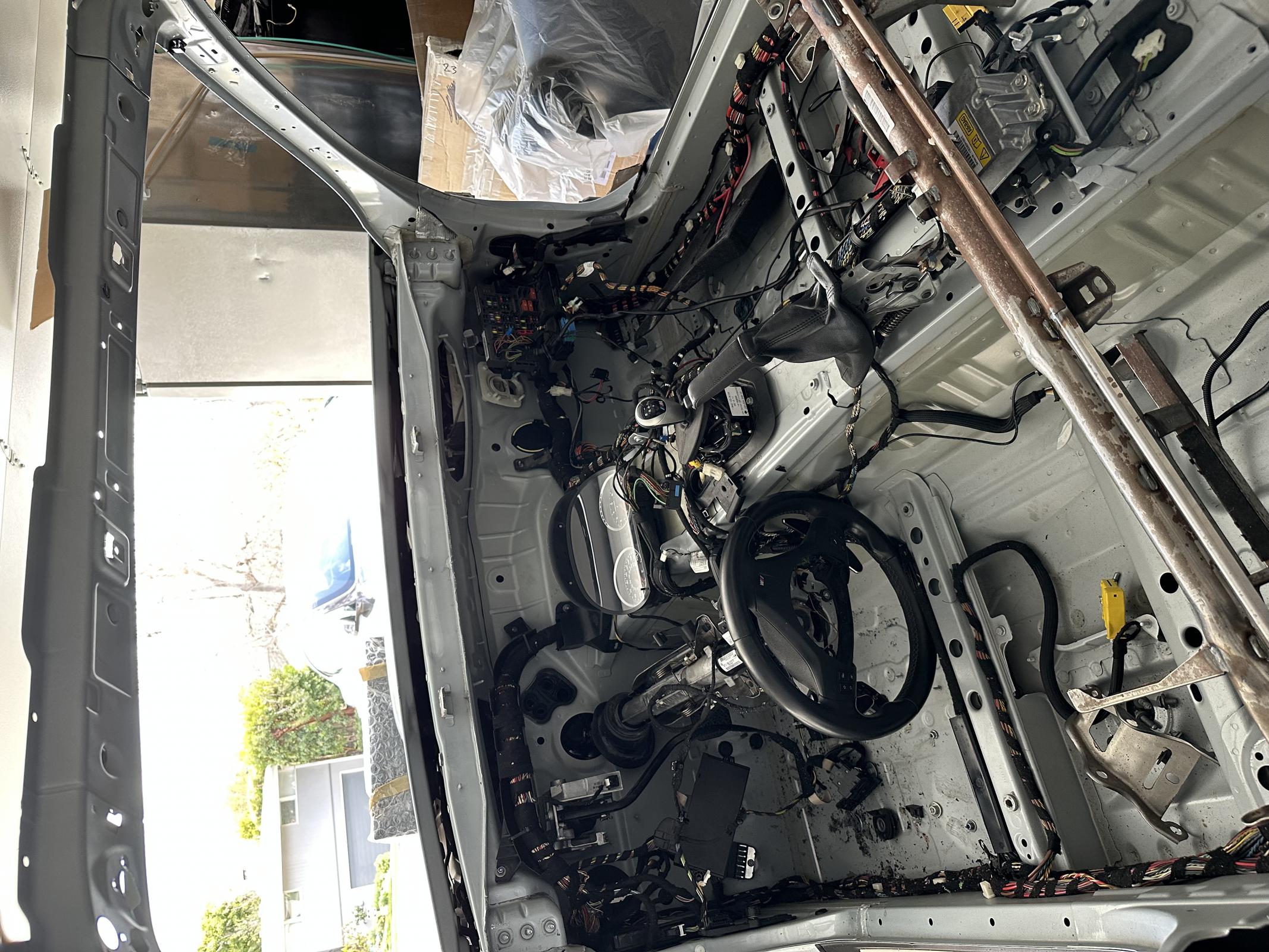

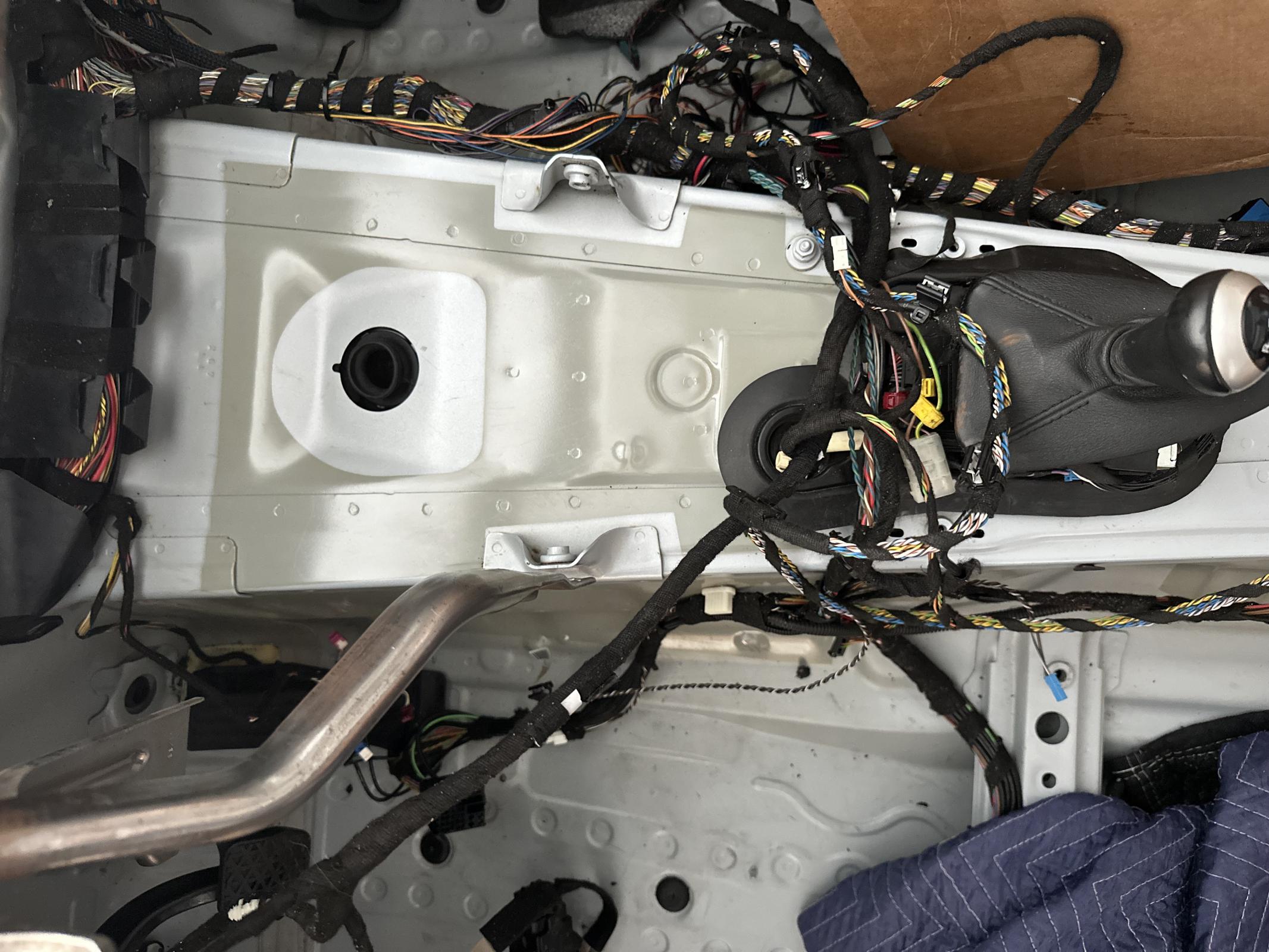

Who’s doing the wiring or is the plan to leave it in place? If you’re on the fence might be worth connecting with StripclubDJ regarding options.

I just don’t know the extent to which I want to thin it out. Definitely need the input of an expert and I’ll be at EAS Saturday morning picking up my new seat.

If you’re investing all this and having the cage work done, seems like now is the time to do it properly with wiring. Thinning it isn’t super complicated.
Also worth installing a fire auto-suppression system. I know it’s 3-5lbs of undesirable weight but shit can happen.

I agree and very much appreciate the thoughts and insight. I am mostly concerned about chasing gremlins, so I am simply wary about removing too many things and then one day someone simply says, "sorry, you should really just go to a motorsports ECU" and that's just not a place I'm interested in visiting, especially with the supercharger.

You’ll end up with more gremlins that you can’t identify when you have endless error codes stored for disconnected modules and wire groups you can’t easily diagnose or visualize. Plus propensity for random ground or damaged wires that sends you into the unknown. Will be a bitch managing those one a cage is in the way.
Again, food for thought.

I spent the last 2 weekends finishing up the dash cleanup and man was that a lot of work. However, I'm super proud of myself for taking it on and accomplishing what I never imagined I'd be capable of. It was important to me to do it though because I want to feel like I participated in this build in a meaningful way.
roastbeef mentioned in a recent post that there is a lot of sound deadening behind the dash. Well, he wasn't kidding. I was able to get it all out and I saved all the pieces so I can weigh them. I will try and do that sometime this coming week.
Anyhow, enjoy the pictures (or don't)...
Also, since my car gets picked up this week to start the cage build, I picked up the new seat and mount yesterday from EAS. LFG!

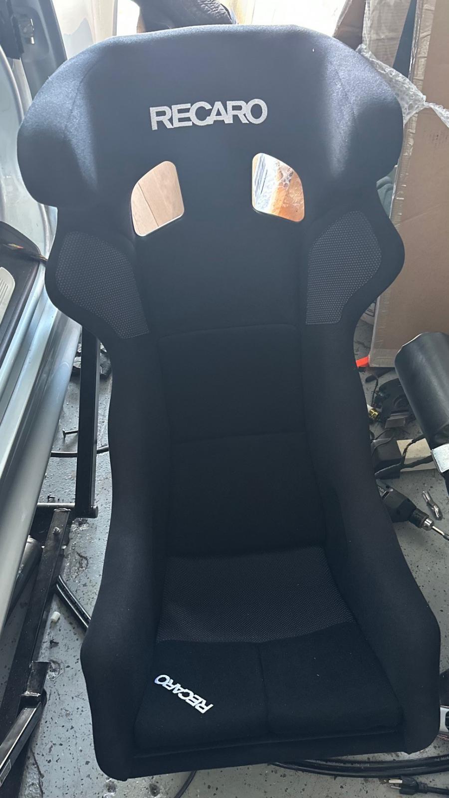

Here you go
