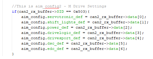

If only there was a device that someone was working on that let you program your M-Drive settings in it via AIM's RaceStudio which would then mimic the packet from the iDrive to allow that to be freely configured on gutted cars.
Name:  Screenshot 2024-10-08 091012.png
Attachment 3571413
this place needs heart emojis.
glad i'm on the list!!
