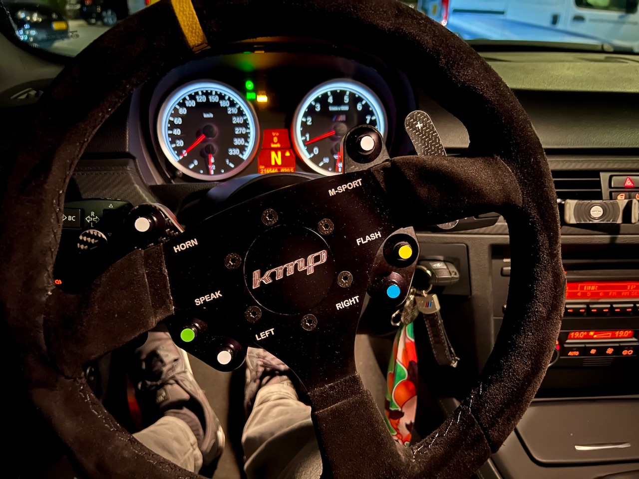

Just took it for the first test drive and DCT in combination with the 3.85 diff is so good!
Sadly cold and no traction at all but first testdrive was a Suc6!
