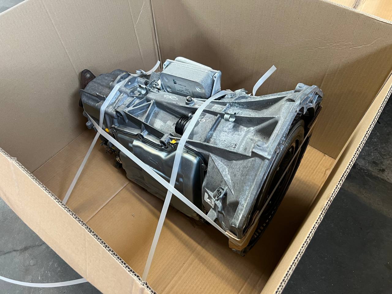

So its gonna happen, just got my DCT trans in.
Going to do the swap myself, think it will be pretty straight forward but was just wondering if someone already did it? Especially wondering if the 6MT driveshaft fits? I know the DCT shaft is a little shorter.
