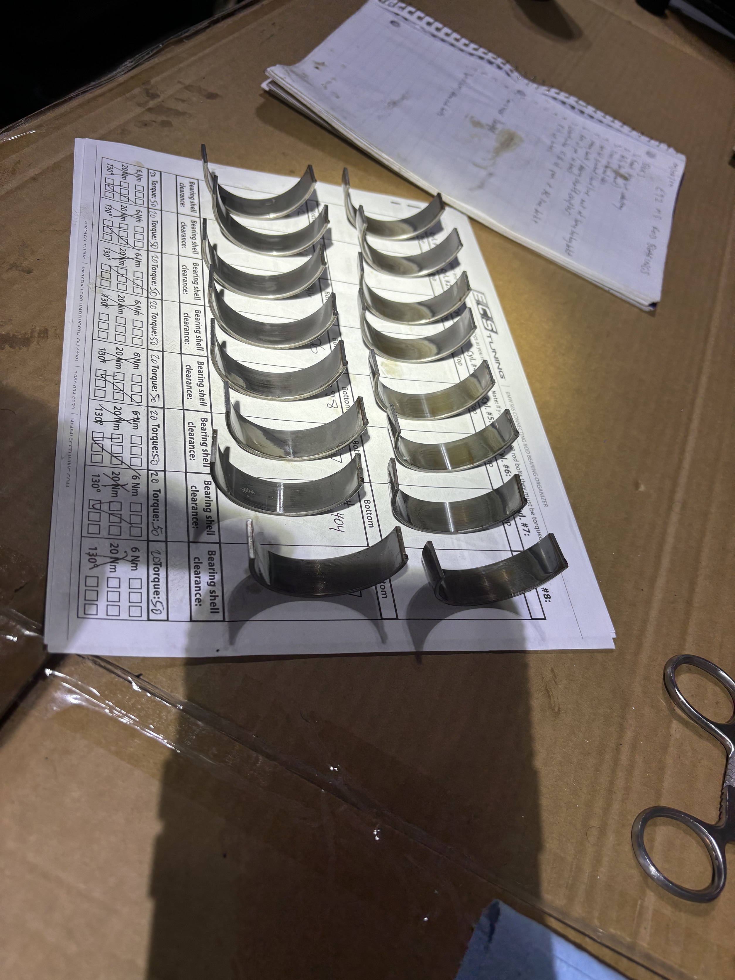

Hey guys ,are these cams need to be replace ?
DrFerry10035.50
      09-27-2024, 01:15 AM   #3064
spammysammich
spammysammich's Avatar
3073
1,799
Join Date: Oct 2021
Location: Edmonds, WA
2009 BMW M3  [10.00]
Cams? Your crank is fuct.
DrFerry10035.50
Who did the disassemble job? You really don't know what's going on?
Crank (journals), not cams.
And as said, your crank is damaged (and the conrods with the spun bearings), as can be seen in the 3rd and 4th photo.
How badly is hard to tell from your photos, you might get away with just replacing the bearings, for a while (if it's not too bad), but a proper job would require a new crank.
I don't think these cranks can be reground?
DrFerry10035.50

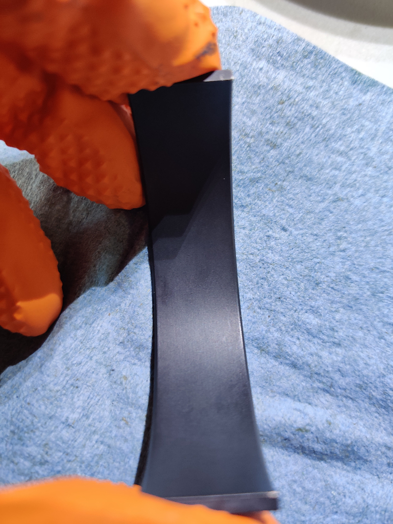

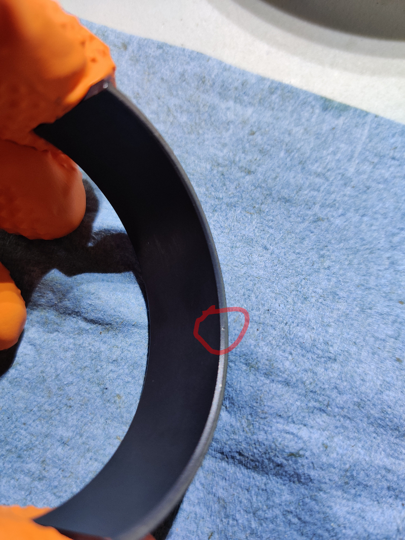

Looking for some opinions and figured this thread would be the best place to ask.
I'm just getting around to installing some BE rod bearings I ordered back in 2021. The very first top bearing I go to install slipped out my hand and bounced on the ground. Upon inspecting it I've found a tiny ding in the beveled edge on the bearing. I can't feel when I run my fingernail down the main surface of the bearing but I can feel it if I run it down the beveled edge. Any thoughts on if its still safe to run? I know BE bearings are generally unavailable at the moment so I feel like I might be potentially screwed in getting a replacement.
Here are some photos of the bearing.
Size:  864.5 KBName:  IMG_20241001_151214.jpg
DrFerry10035.50
      10-01-2024, 02:51 PM   #3068
IamFODI
610
625
Drives: 2008 E90 M3 6MT
Join Date: Dec 2018
Location: SE PA
Ah, man. That sucks. Might be fine, but I wouldn't use it.
No need to feel bad about dropping something. Accidents happen. But this is definitely the kind of job where it's better to take the general attitude of being willing to accept a little bit of pain now (e.g. waiting for replacement bearings) to reduce the risk of a lot more later, even when it comes to small details.
Attachment 3566436Attachment 3566437
You should be OK.

Hmm, would probably be ok I think.
Can you look at it edge on, perhaps using a magnifying glass to see if it's caused a slight 'hump' above the ding on the bearing surface?
Although tbh, I'm not sure if you'd see anything even if it was significant to the bearing clearance (bearing in mind BEs (v1) clearance of ~0.06 mm), e.g would a hump of 0.03mm even be visible??
I wonder, if you took it to a machine shop, or engine shop, whether they'd be able to check & measure it for you using precision instruments?
DrFerry10035.50

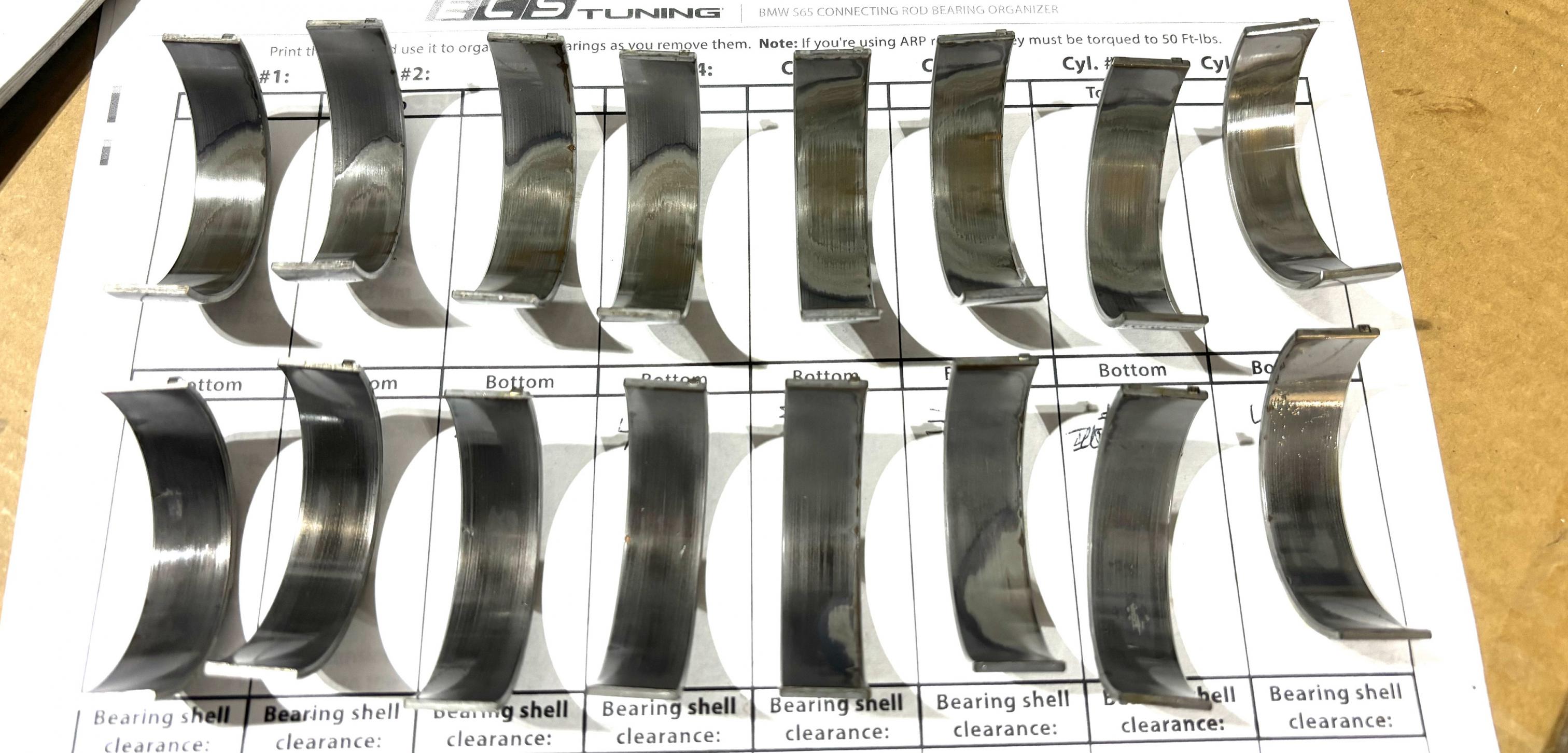

2008 E92 M3 99,450 miles original bearings
Finally was able to get my Rod Bearings done. No. 3 top bearing was starting to cavitate. All my journals looked good. Definitaly some copper showing and my last oil sample had shown a slight increase in copper also. My M3 made it to 99,450 miles. Also motor mounts were trash. I drove it on a two day road trip to OC to get them done as no one in my rural area can be trusted with doing this job on a BMW. lol.
Also, a MASSIVE shout out and props to Malek and his dad at MRF engineering. They did an excellent job. I had to trust I was able to head back to N. Nevada on a two day trip after a large job as this and my M3 with no problems and it ran like a champ!
No to cams, but YES -> the crank and rod bearings need to be replaced.
Looking for some opinions and figured this thread would be the best place to ask. I'm just getting around to installing some BE rod bearings I ordered back in 2021. The very first top bearing I go to install slipped out my hand and bounced on the ground. Upon inspecting it I've found a tiny ding in the beveled edge on the bearing. I can't feel when I run my fingernail down the main surface of the bearing but I can feel it if I run it down the beveled edge. Any thoughts on if its still safe to run? I know BE bearings are generally unavailable at the moment so I feel like I might be potentially screwed in getting a replacement. Here are some photos of the bearing.
If you really want to be sure you could ask Green-Eggs via Private Message or contact B.E. Bearings.
Technical: bert@bebearings
Sales: ernie@bebearings

All journals were flawless from what I could tell with basic visual inspection.
Good Blackstone UOAs x4 spanning the last 15k miles.
Name:  Photo Oct 09 2024, 07 55 20.jpg
On this next photo I max'd the exposure setting to enhance defects.
Name:  Photo Oct 09 2024, 07 54 20.jpg
I've had the car for two months and this was an interesting way to get acquainted. Also did the engine mounts, and like everyone else these were beyond smoked.

Originally Posted by DW_CT9A View Post
Did mine about a month ago.
111,073 miles
US market car, 05/2008 production, DCT
088/089 bearings which appear to be original.
Attachment 3593928
Attachment 3593929
Kinda close to what my early 08 M3 looked like at 99K miles. Weight of my shoulders I tell ya!
