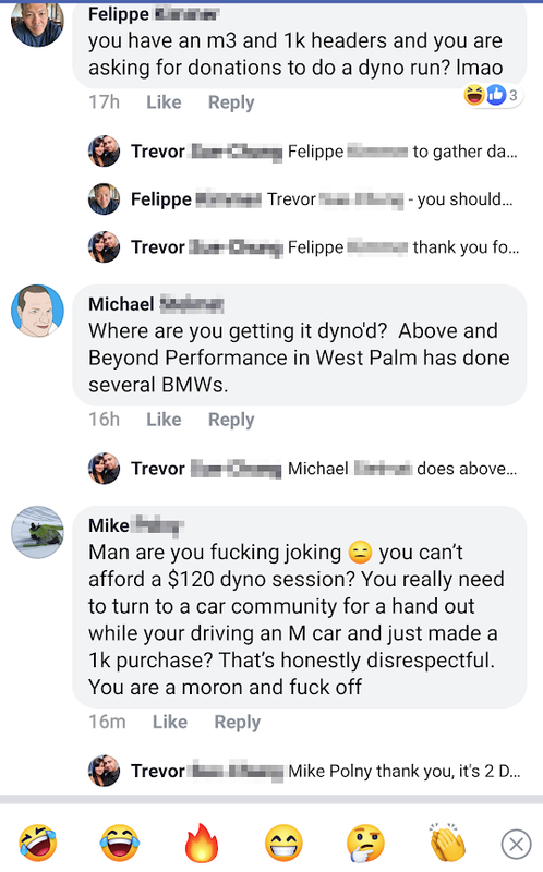

Got flamed on the fb group for this, was trying to get over the 70% hump:
One of the reasons I almost didn't bother posting this, but support on here has been great so far. Thank you all that have contributed.
What group was this posted on? Most of the facebook community consists of guys who own 335i and lower anyways who think they can gap M3's.
This is the E9X M3 V8 Owners Club. Yea I wouldn't post in any of those 335 infested groups, would have been even worse.
