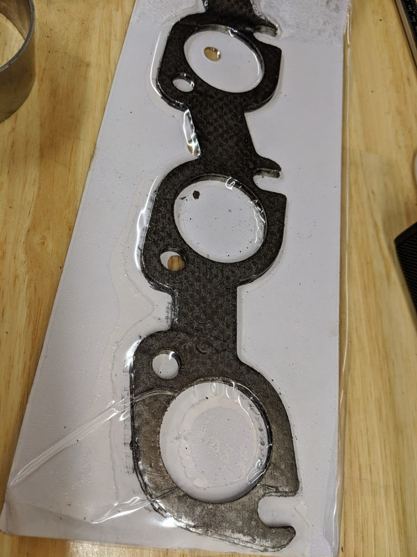

I remember someone saying the gaskets these type of headers come with are usually not good and to use oem gaskets.
The OEM gasket is slightly smaller than the ports on the headers, assuming the exhaust ports on the head are the same size as the gaskets i don't see this being a problem so I'll probably still use the oem gaskets if that is the case when i remove the headers:
This is what the Becker gasket looks like:

The OEM gasket is bigger than the head exhaust port. The port is the limiting factor. It should not matter whether the gasket is a little smaller than the header opening.
the hardware that comes with these kind of exhausts are terrible.
judging by the photo that you have taken the OEM gasket is just fine. Even if its a mm undersized it shouldn't be a big problem. had the same kind of experience back when the e46 m3 headers on ebay were a hot item.

are they ceramic coated or just polished, i would spend the money on ceramic, cause u lose most of the heat shields
Pretty sure they are just polished
I plan to try to reuse most of the heat sheilds, even if it involves some cutting, but we'll see once I get to the install.
I agree, I plan to use the OEM gaskets. From pictures I have seen, the exhaust ports are smaller than the gaskets so no big deal.

For what its worth being an amazon / ebay setup, I have the becker full catless exhaust system (which is a steal at $950 when I bought it) and after 2-3 years its holding up fine. Only downside I had was the catback had to be extended an inch so the elbow wouldn't rest on the diff. Also, the gaskets it came with are trash, I got misfires in almost all cylinders.
