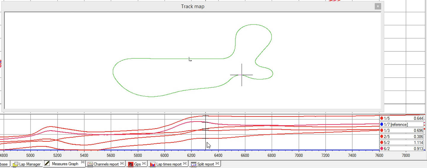

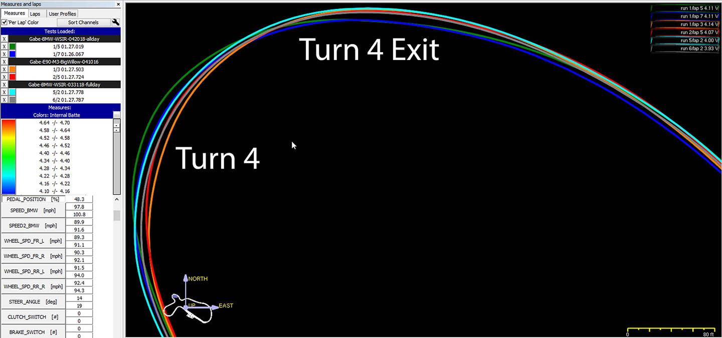

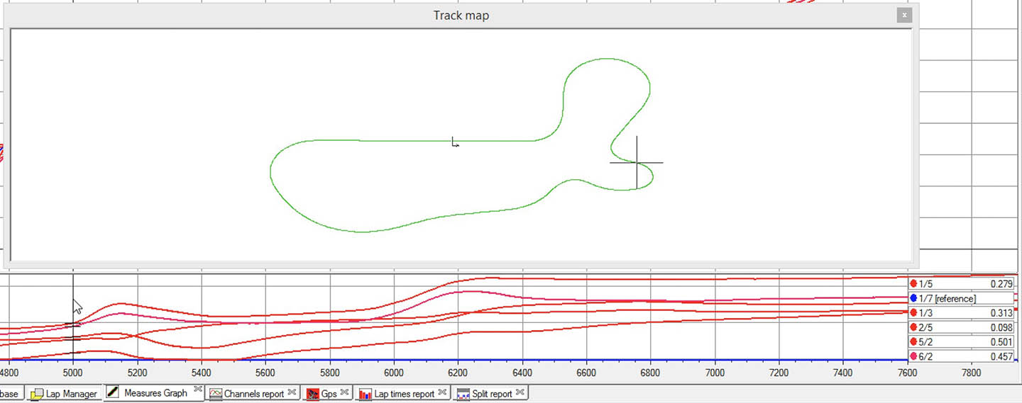

i like your line through 3-4-5, i'm going to have to experiment with that a bit.
a little more experience over the years has shown me that what works for one car/driver may not work for another.
did you do anything different in your 3-4-5 combo, or did it just execute the way you always intend to?
I changed my approach.
In general, I aim for the shortest way around a track as possible. This is the approach I used to take at Turn 3/4/5. I would stay mid-track/fairly tight at the top of Turn 4 to try to avoid wasting track length. My old way of thinking was that I'm not really going THAT fast at the top of Turn 4, so why not turn early and hug closer to the inside of that curve. The idea was not necessarily terrible, but what it didn't account for was that at the end of Turn 4, when you want to really get on throttle, there is very little grip due to the track heading down a hill.
Turn 4 presents some interesting challenges because there's very little grip there at the exit. Somehow---and I know this is weird-----if you are turning the steering wheel a lot---which you would be doing if you hug the inside, you understeer.....and then a moment later, the ass is stepping out on you and you're counter steering. All that nonsense is a big time waster and it prevents you from getting 100% on throttle again.
It turns out, it is more efficient to run to within a few feet of the top edge of Turn 4, tap the brakes if you have a lot of speed and then turn down the hill to the exit of Turn 4 from the top where there is some grip. The big advantage this method gives you is that, by going further to the top of Turn 4 and turning up there, you're doing most of your turning up there and you don't have to turn the steering wheel AS MUCH at the EXIT of Turn 4 when the pavement is falling away, and this allows you to avoid the understeer and oversteer moments by turning the steering wheel less. This allows you to get back to the gas pedal more consistently and you can concentrate more on charging down the hill towards Turn 5. Again, getting kicked out wide on the exit of Turn 4 is not fast. It forces you to wait to get on the gas as you go down the hill. You want to go down the hill as straight as possible, not get kicked out, so you can get as much acceleration in as possible before the braking zone of Turn 5.
In this chart, you can see different lines through Turn 4. The Dark Blue (1:26.0) and Grass Green (1:27.0) lines were from my latest track day there. The Green line was the previous lap to the 1:26 lap. All the other lines are from 1:27.x laps from previous days. You can see in Turn 4 at the top, the Blue and Green lines go wider than previous laps. At the exit of Turn 4, you can see both of those lines don't get kicked out as far as the older lines that tried to keep it tight through Turn 4. I am heading more straight down the hill which allows me to get back to the gas faster. The Orange line, which was my previous best from 2016, was really tight at the top of Turn 4 and I got kicked out to the far edge of the track. The Grass Green line took it the farthest out to the edge at the top, and I learned on that lap that I didn't have to go that far out. So the Dark Blue doesn't go out as far. But I still was able to head straight down the hill.
And it's worth showing that I picked up a nice little chunk of time on that fast lap when I felt like I finally got Turns 3/4/5 much better. In the two pics below, I have the cursor set at two different spots so you can see the time gains from Turn 3 to the apex of Turn 5.
You can look at the map and see where the cursor is on the track. The red lines in the low chart represent the time delta of 5 laps compared to the fast lap. And you can see the time delta in the bottom right corner.
In the bottom chart, you can see all the red lines rise from 5000 feet to 6300 feet. Those lines going upwards means they are losing time to my fast lap. And they all go up. By looking at the two charts you can see how much time was lost to my new fast lap. The time gain ranges from .3 sec to .6 sec. That's a pretty solid time gain from just approaching the turn differently!
Beginning the climb of Turn 3:
Entering Turn 5:

How to read the info in the pics: Each pic has five graphs lines.
-Graph 1 at the top: my actual brake pedal press
-Graph 2: Front left caliper activation
-Graph 3: Front right caliper activation
-Graph 4: Rear Left caliper activation
-Graph 5: Rear Right caliper activation
We can see where MDM is doing it's thing by looking in the blank spaces where I'm NOT pressing the brake pedal, but the computer is activating the calipers. In virtually every case at all 5 tracks, the rear brakes are basically never activated by the MDM system.
In this first chart at Buttonwillow, we can see that at 750 ft, the Front Right caliper activates on it's own. Between 6500-7500 ft, you can see the Front Left caliper is active for a whole 1000 ft as you go around Riverside which is a big rounder. The caliper activations are not huge....they're usually just nudges.
And then, you can compare that to the 6th chart at the bottom where I show my 1:49 lap at Buttonwillow with DSC-off. You can see it's totally quiet in between brake presses on all calipers.
The Big Willow chart is interesting. MDM is activating the Front Left caliper for very long stretches---1500 ft in Turn 2 and 2500 ft (!!) in Turn 8/9. It wants to make sure the rear of the car stays in the rear, so it's encouraging more of an understeer situation where it's sensing oversteer might be imminent. If you're in a rounder going to the right and the front left caliper activates, it's encouraging the front to understeer which helps keep the rear behind you. At the same time, MDM is probably holding back the rpms if you're pressing hard on the gas because it doesn't want to add more speed to the situation.
Again, the caliper activations are fairly mild, but I'd say that 2500 ft of that at 130 mph is still building some serious heat.
So, at a wide variety of tracks, it seems that DSC uses the front brakes in most cases.
Since we're on the topic, the other thing that is sort of interesting to see is how the braking system activates the calipers when you press the brake pedal. If you look at the activation profiles of the fronts, they are usually different. At Big Willow, the computer is definitely working hard trying to figure the best way to activate those calipers and keep the car going in a straight line on what is a poorly paved track. The first brake press and the press at 6000 ft are quite different between the two front calipers. At Laguna Seca, where the pavement is much better, you can see the brakes activate much more uniformly. Anyway, I find it interesting that we can see how the braking system is making [very quick] decisions to keep things under control regardless of whether DSC is on or off.
Buttonwillow: 1:51 MDM-on
Big Willow: 1:27 MDM-on
Chuckwalla: 1:55 MDM-on
Laguna Seca: 1:39 MDM-on
Sonoma: 1:51 MDM-on
Buttonwillow: 1:49 DSC-off
