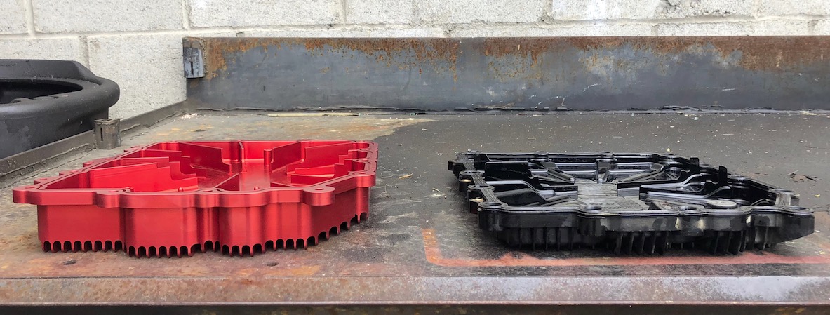

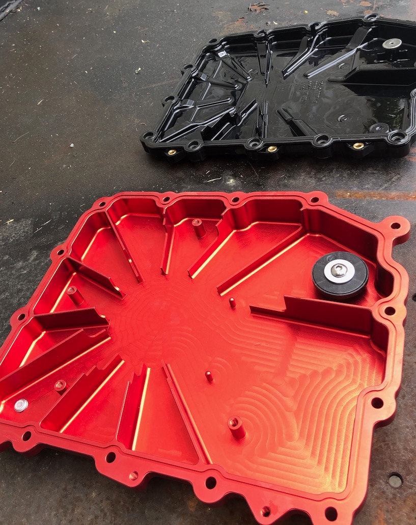

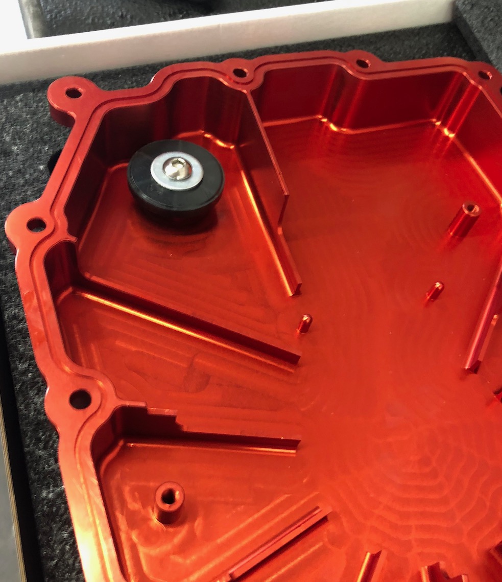

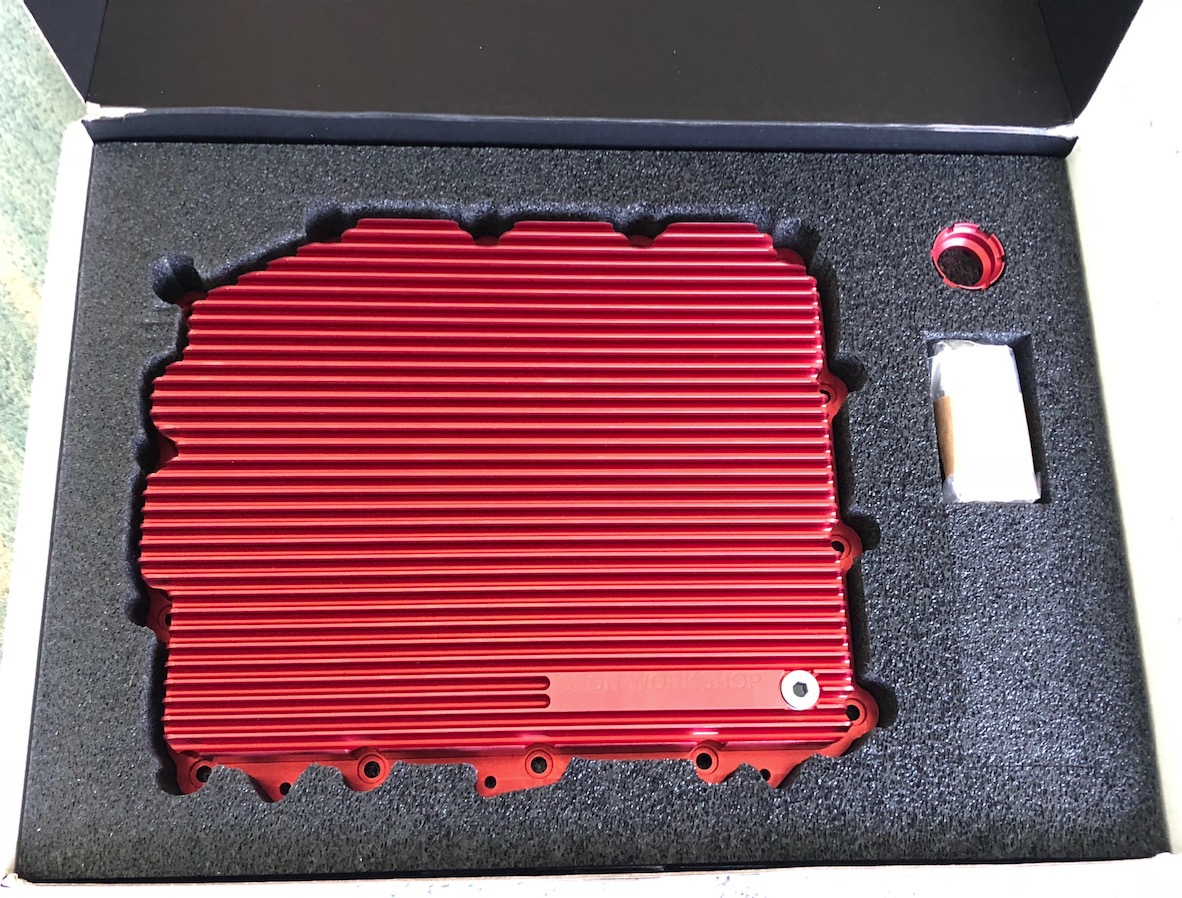

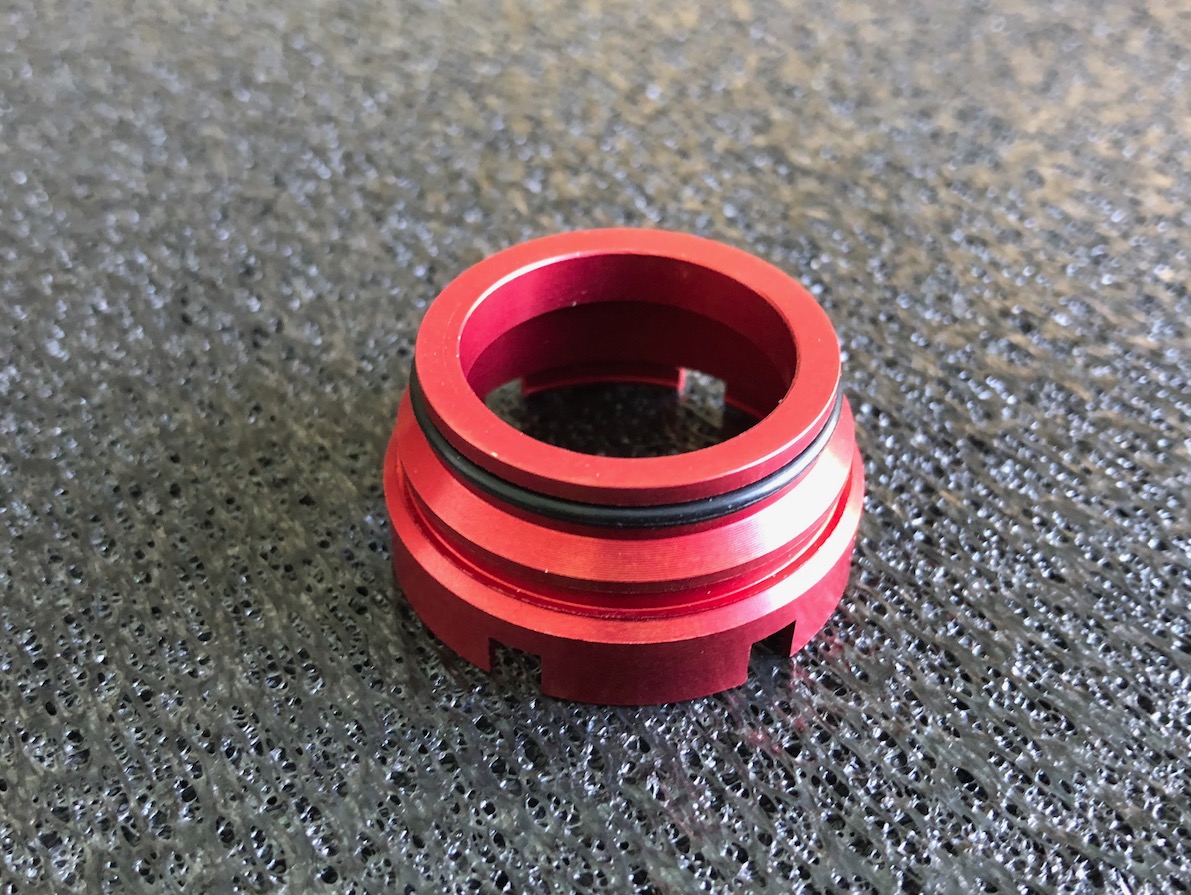

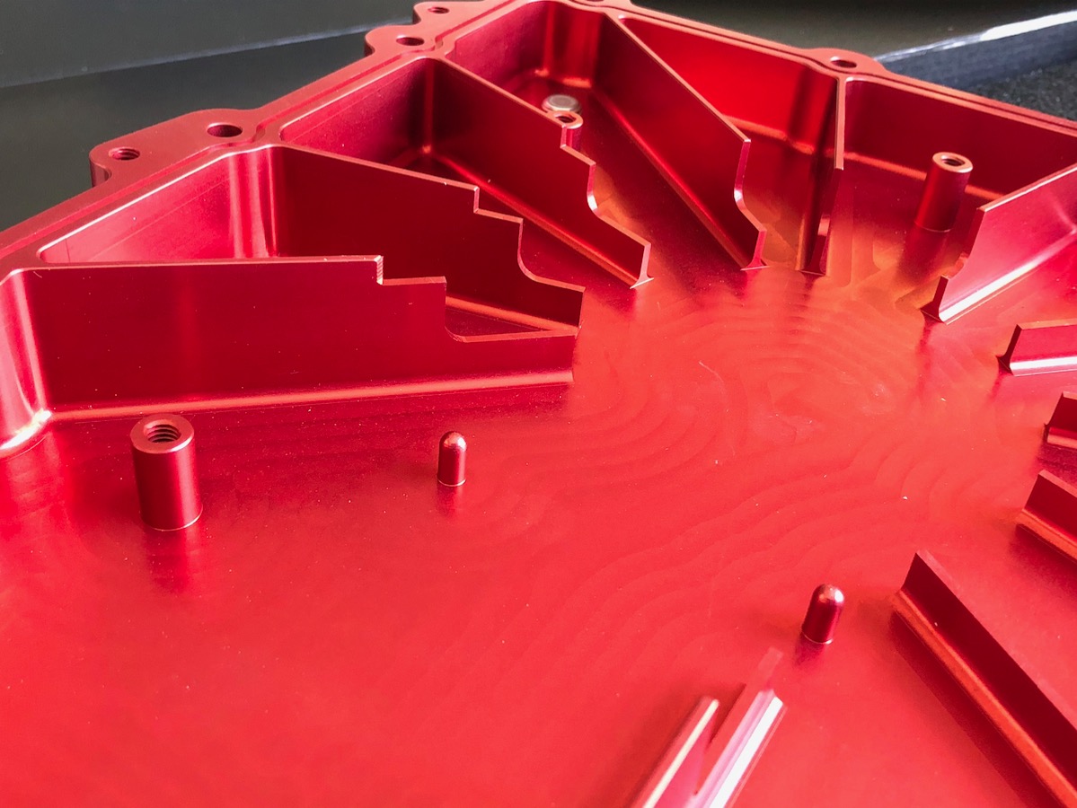

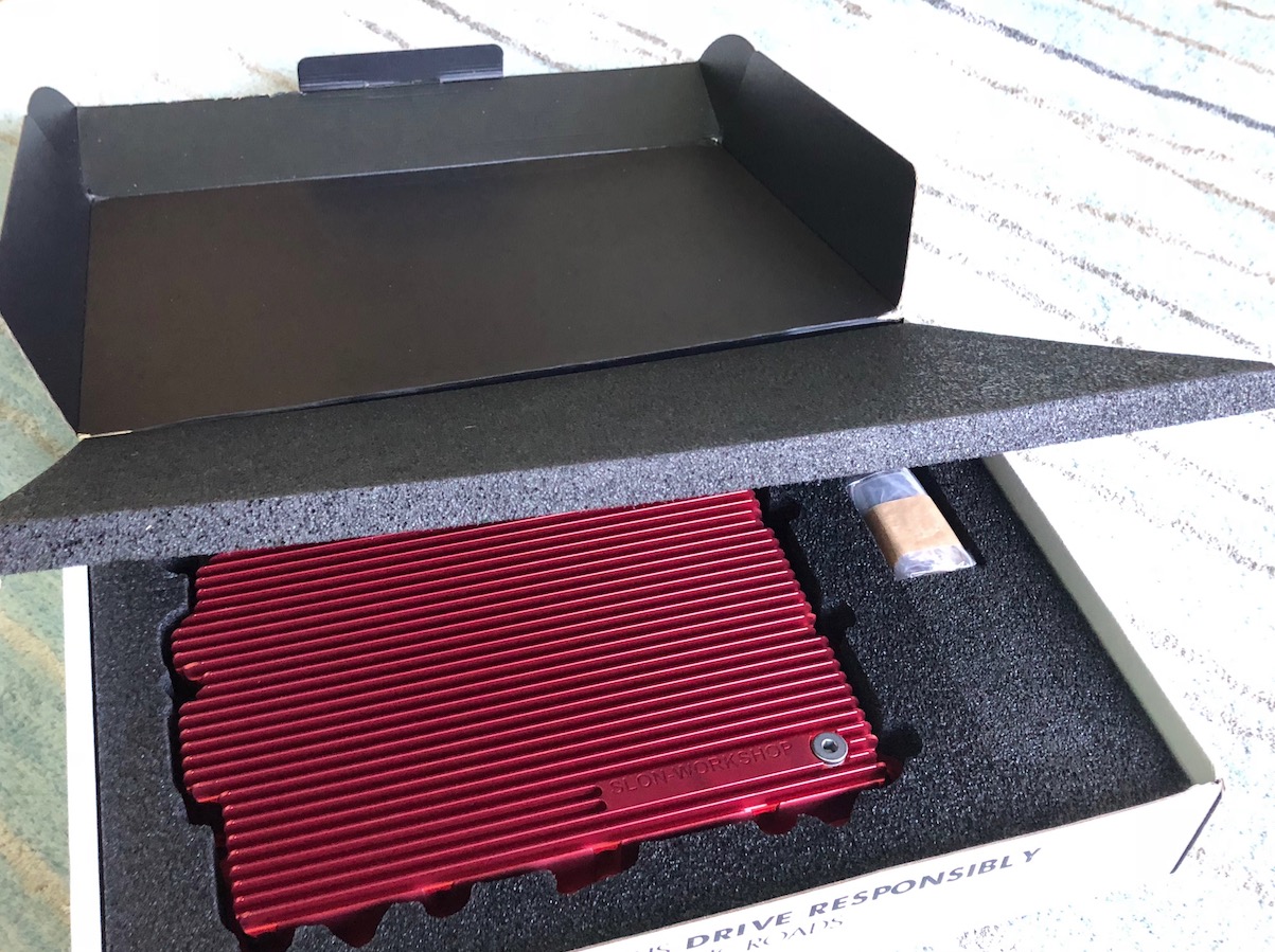

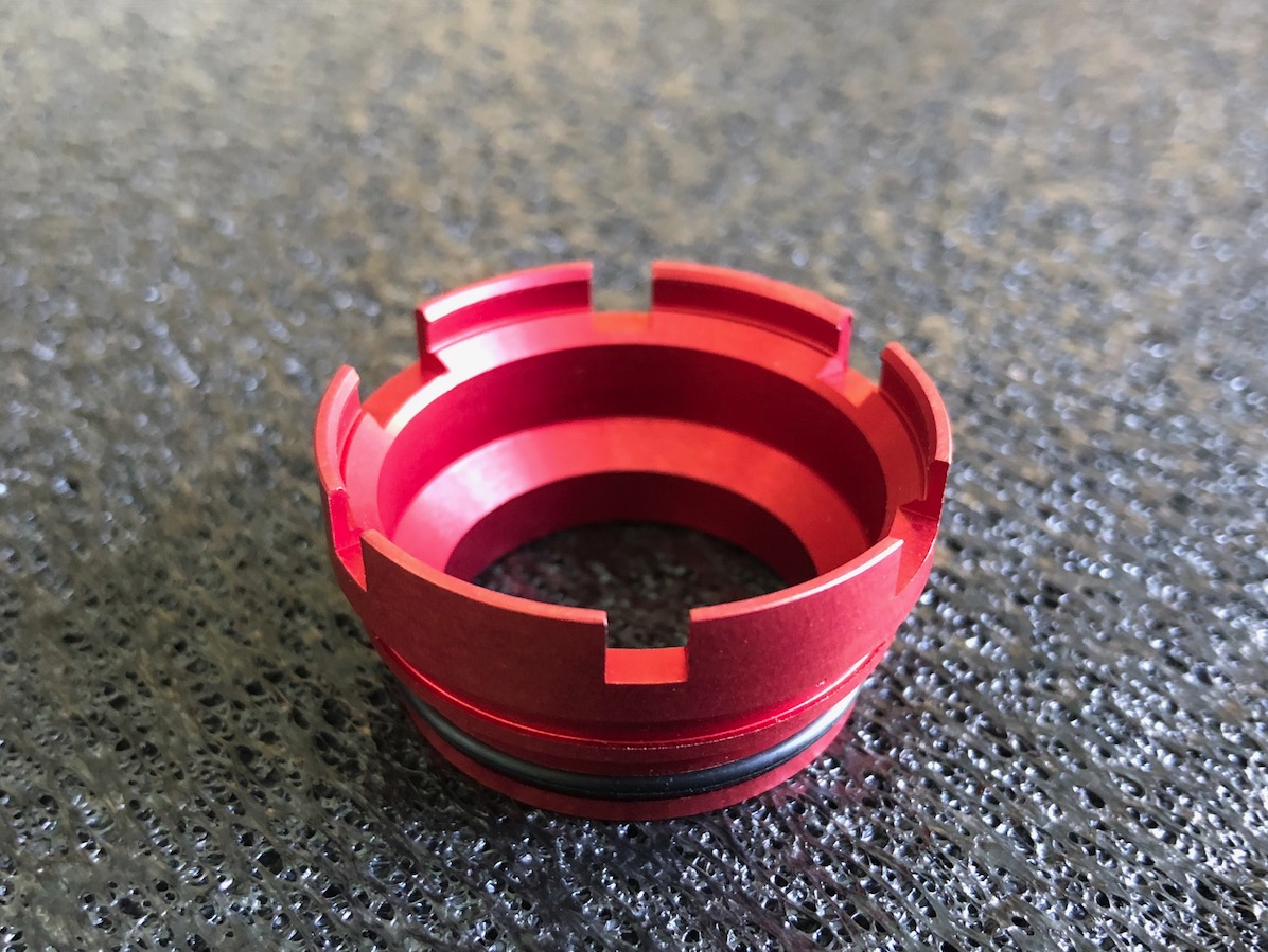

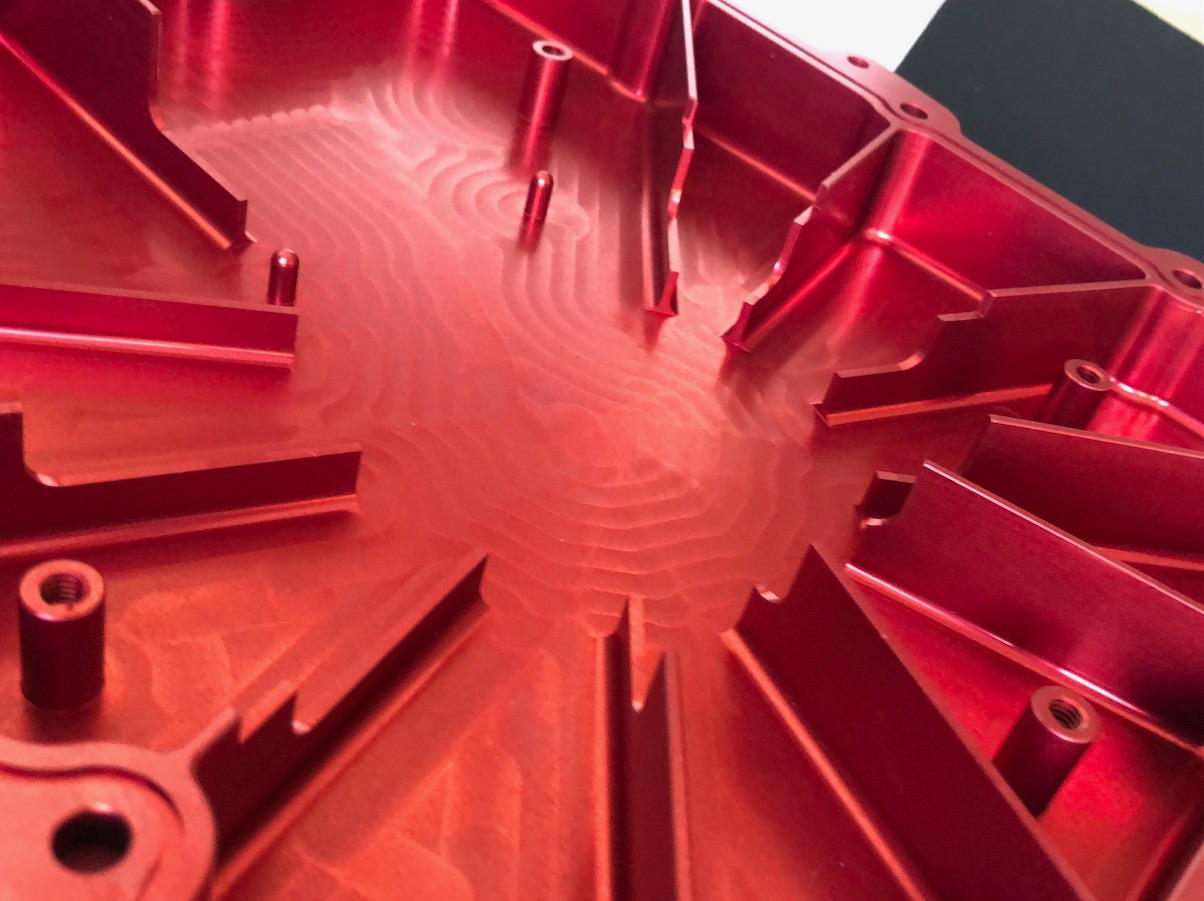

The Group Buy of the Slon-Workshop DCT oil pan was a success. I have it in-hand. (There was a mixup in shipping, but the vendor was very proactive in helping to solve it, and SYT_Shadow made a generous offer to help solve it even quicker. SYT_Shadow offered to send me his pan because he didn't need it until June. Thanks for all the help! (A new pan is already on it's way to SYT_Shadow).)
Ok, this thing is a beauty! It really is a piece of CNC art. I mean c'mon, look at the inside of this thing! It looks like something from Star Wars. I sorta feel bad about slamming it on the bottom of my car.......only sorta bad though...
And they have nice packaging!!
The internal baffles looks great.
This spacer/suction extender is the thing that I REALLY hope helps solve the oil starvation issues. This will sit on the oil intake and make the system suck oil from lower in the pan. In my opinion, a deeper pan is only part of the solution. You have to do something about the suction coming from all the way at the top. I really hope this has a chance of solving the issue.
Due to the shipping issue, I ended up Skype-texting with the vendor. He fabricates quite a lot of custom one-off parts for their customers. Many of them are not sold to the public because they don't market them out, but they make all kinds of things---DCT oil line brackets, caliper brackets to make brakes fit that don't have any other way of fitting, rotor hats....very cool. I only heard of Slon-Workshop when I came across their DCT pan, but they have a pretty cool operation and seem to thrive on making creative solutions. (Slon means elephant in Russian.)
The pan is being installed on Thursday at minicorsa. (I'll try to get a couple pix.) I'll be on track with it Friday at Willow Springs. I don't really have shifting issues at Big Willow, but it will be a good place to shakedown the car. Buttonwillow, where I've been having the most issues, may have to wait until May.

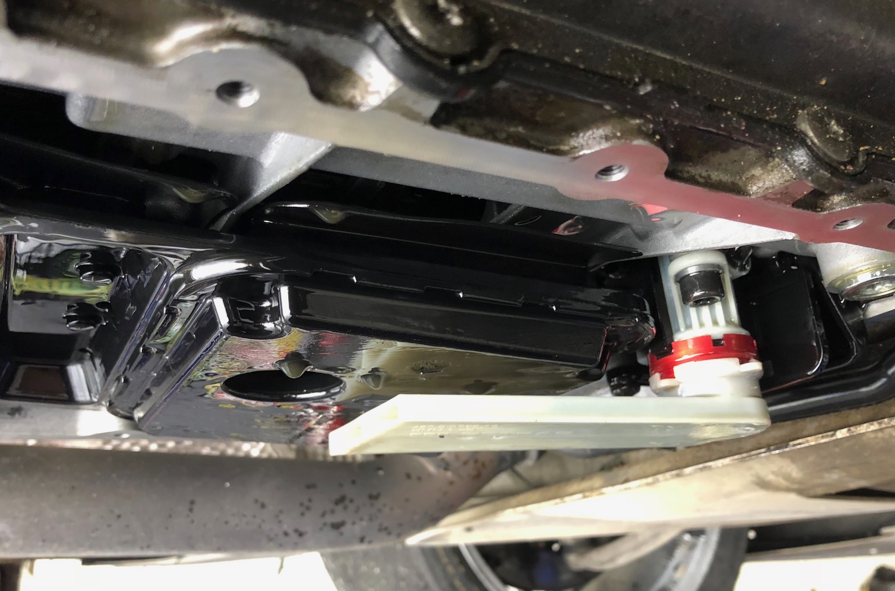

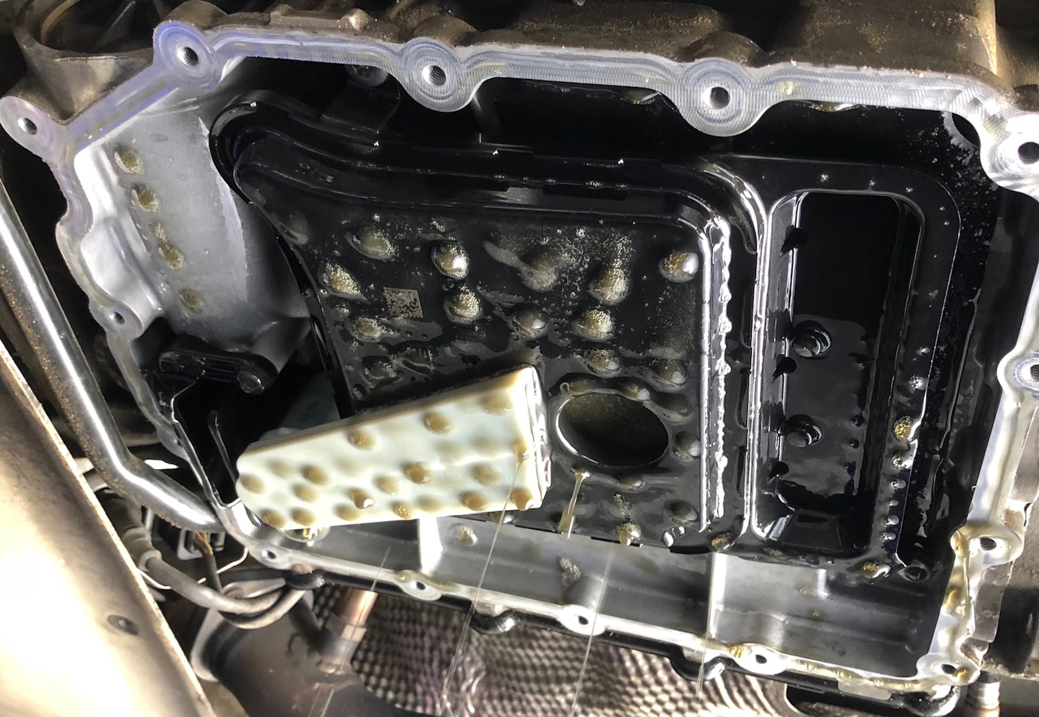

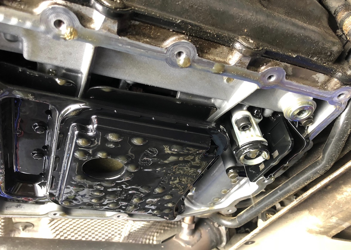

The Slon-Workshop DCT oil pan is on the car.
It went smoothly from what I can tell. The main thing is----don't be in a rush when you do it. Make sure you have plenty of time. You'll have to sit around for some time while the DCT fluid drains because you'll really need to be able to clean up the edges for the Loctite Gasket Maker. And then once the Loctite is on there, you should wait an hour for the Loctite to set. Just those two things will take awhile.
A couple of notes from the install:
-Be gentle when removing the white flat suction intake tube.
-When re-installing the suction intake with the red spacer attached to it, it takes a bit of a tap to get that thing to set on the vehicle's suction port. You'll find yourself trying to press it on and it's resisting going on there.
-Jacking the car up on the right side and slamming more fluid in there is....interesting. You really gotta get under the car to reach the filler hole, so MAKE SURE YOU HAVE SAFETY IN PLACE.
I didn't document with pictures at the DIY level of detail, but I took a few pictures for you guys to check out.
The white intake suction tube in it's original position. Sorry I didn't get it from the same angle as the next two pix.....:
White suction tube removed:
Suction tube reinstalled with the red Slon spacer in there. You can see it sits lower as a result.
Moved the magnet from the OEM to the Slon pan:
Comparison showing the depth of the two pans side-by-side:
General shot to show the baffles of the two pans:
We put the felt DCT cover back on there because it does fit over the pan, but it touches the pan. I'm not really sure what was the right thing to do there.....Obviously, we are reducing the pan's ability to cool with the cover on there. But I think I would rather have stuff from the track hit that felt cover instead of the pan itself. The felt cover does have vents in the front so air can get in there.....who knows.
The pan obviously sits lower than stock (duh). It's just a bit lower than both the x-pipe tubes and the front-center jack point. I believe it's a new low spot on the bottom of the car. I'm not worried about it; just thought I'd mention it.
Appreciate 7
