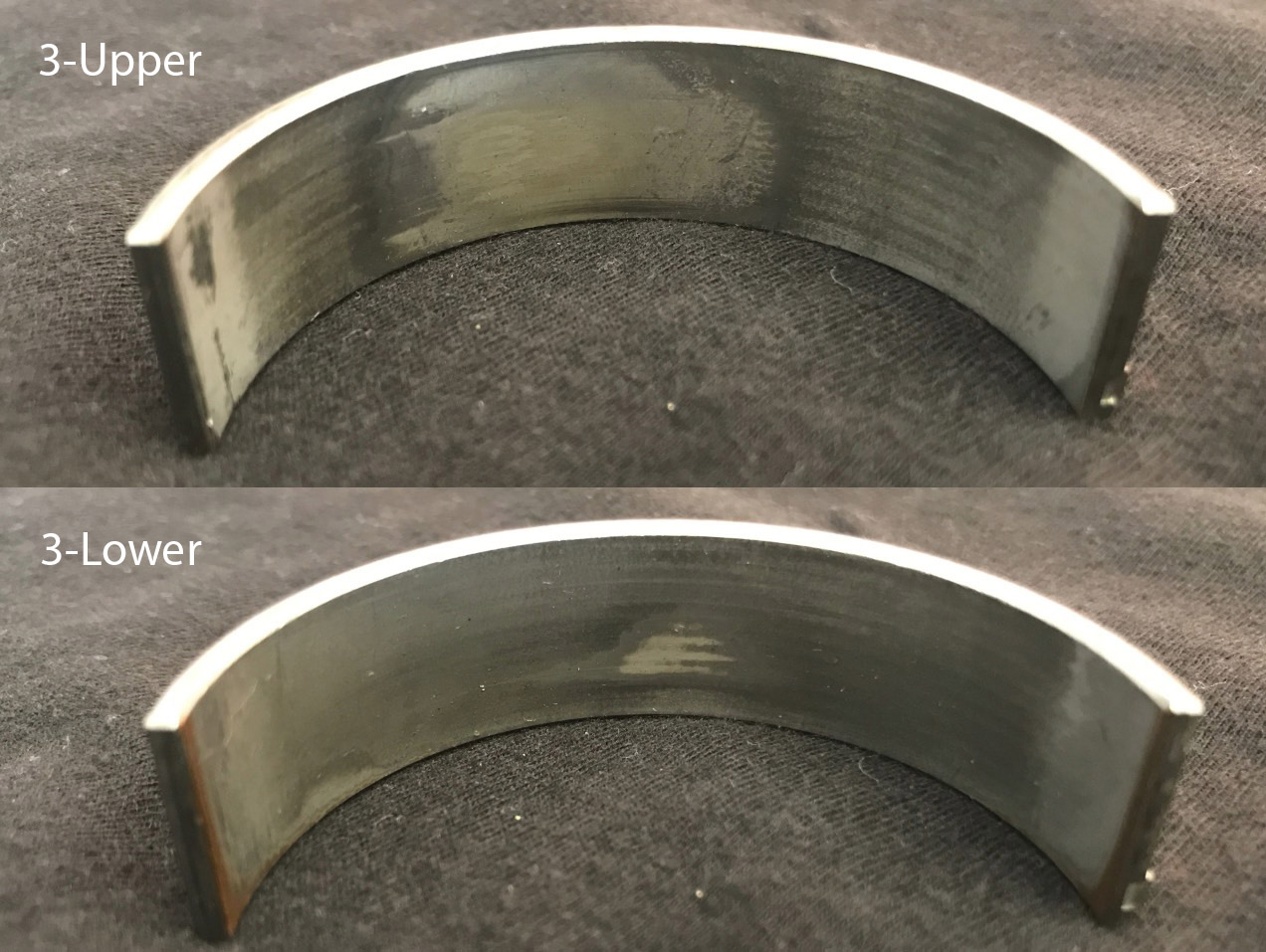

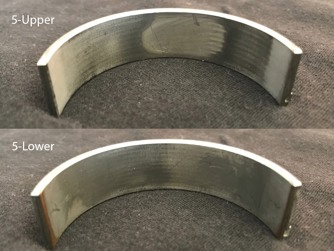

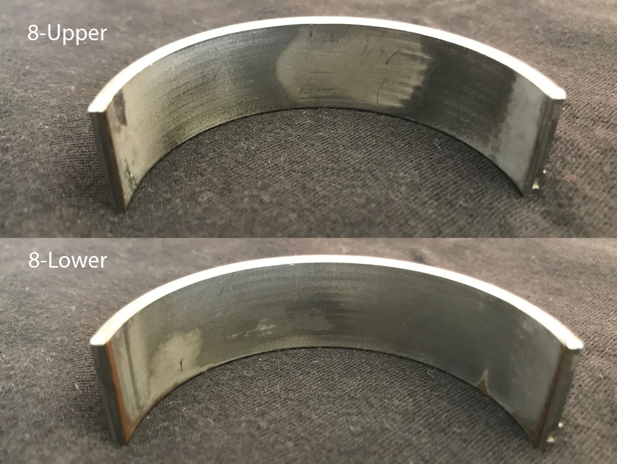

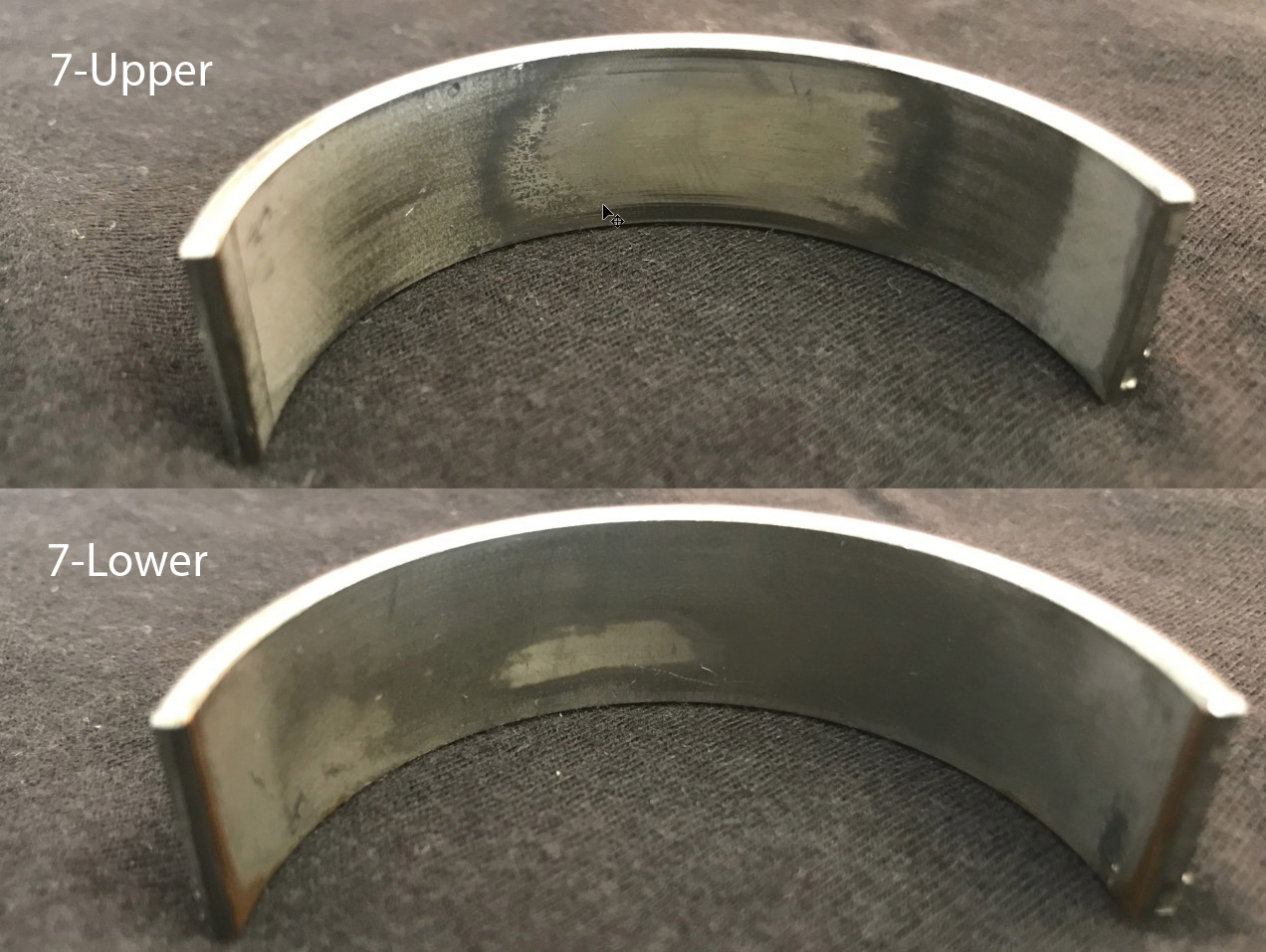

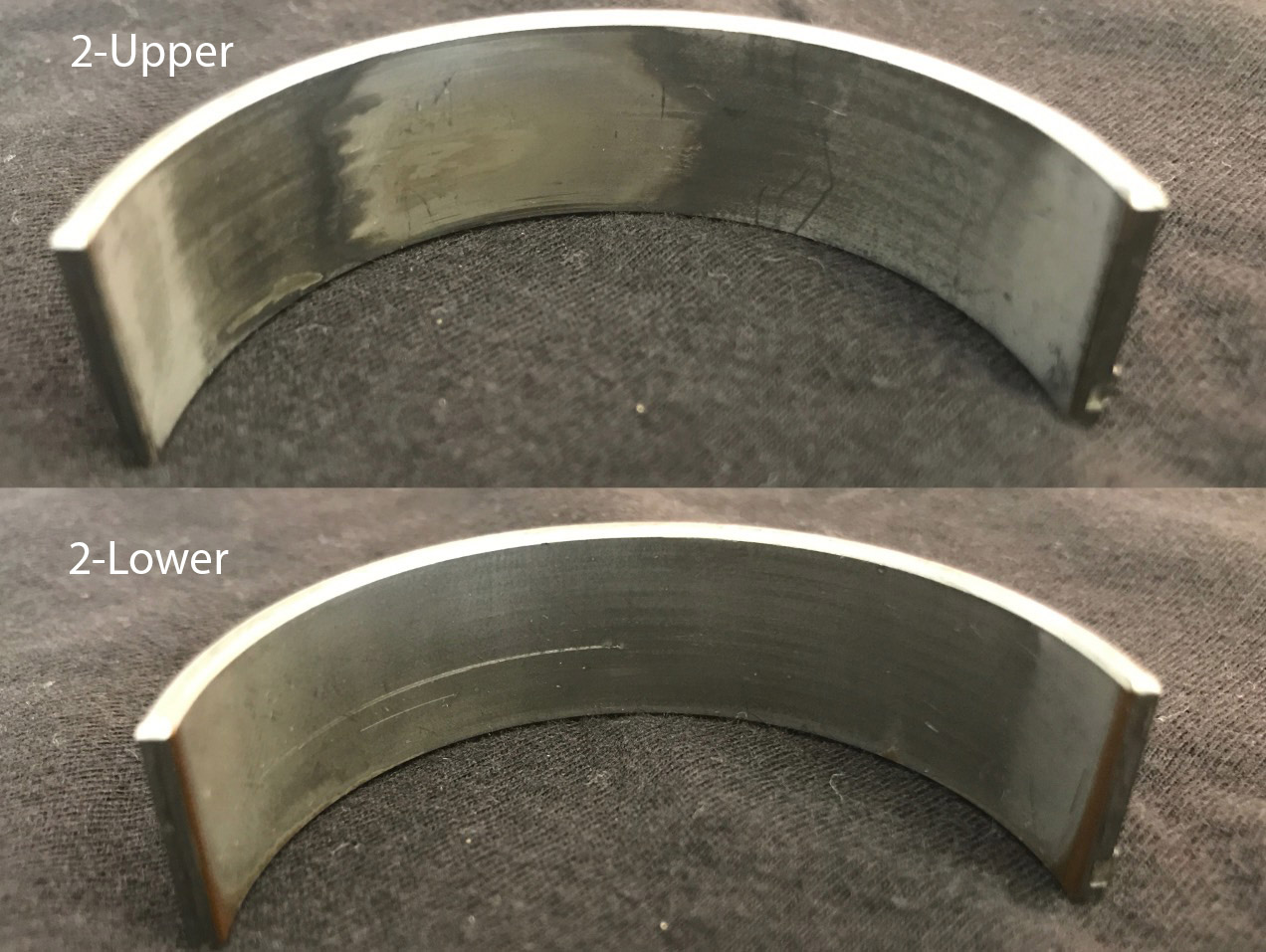

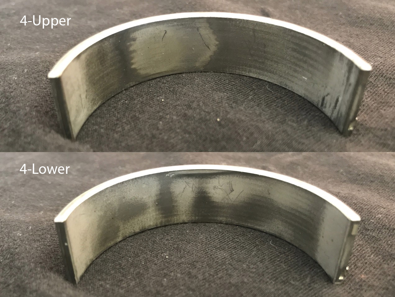

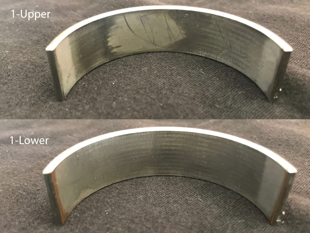

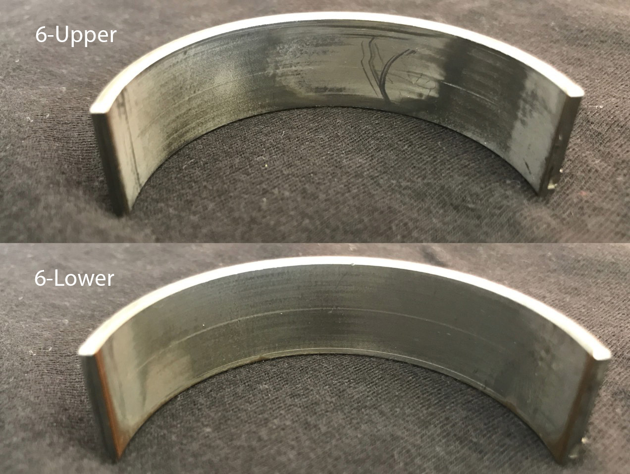

Hi Everyone.
Time to talk Rod Bearings!
I have gotten the question many many times-----"are you still on original rod bearings?" The answer was yes. People were curious that my car had so many track days on it, AND was supercharged, but that it kept on going fine.
However, now with over 100+ track days during the last 5.5 years and 51000 miles on the odometer, I have swapped out the rod bearings in my M3. Blackstone Labs has been reading my oil samples for several years, and the reports came back with low Lead levels for quite a long time---they always reported 1 or 3ppm. But earlier this year, the Lead levels started to creep up. And then the last oil sample before doing the job, my Lead levels rose over Blackstone's universal average. The universal average for Lead in our engine as seen by Blackstone is 8ppm. In May, my car rose from 7 to 10. One might say that a 10 might not be cause for alarm, but the one nagging thing that was always in the back of my mind was that I'm quite certain my oil samples have FAR less miles on them than the vast majority of other people who send samples in. I change the engine oil usually after every 2-4 track days. I NEVER EVER go more than 4 track days on engine oil. (I used stock 10w-60 oil.) So, the question was----if I'm above the universal Lead average in just 2 or 3 tracks days, which means just a couple hundred miles versus other people with thousands of miles on the oil, are my rod bearings wearing more than one would normally think? And should I act now? I decided to go for it.
So, the car went to EAS for rod bearings and a few other things, including a compression test, new spark plugs, new belts, new air filter, new blower fluid, and a dyno. Over the years, anytime the supercharger has needed to be touched, EAS has dealt with it. And after almost 6 years of working with Tom, and knowing the quality of Steve and Sammy's tech work, I had no doubts about their abilities on this round of work. EAS uses tin bearings with a WPC treatment and ARP bolts.
So----what did my rod bearings look like? Check 'em out below. I'm not an expert on this topic, but I think it's safe to say that this was a good time to do this job. The rod bearings are showing a fair amount of wear.
The Upper bearings show quite a bit of wear in the middle of their arches, and all the Uppers seem to show a solid 1/2" of wear on their edges too. The Lowers show generally less wear, but #4-Lower definitely saw some action unlike any other bearing. And several of the Lowers seem to be showing copper on the edges.
As far as the rest of the work done on the car---the compression test went well. All the cylinders are reporting consistent psi. And the dyno (which was done after all the work was completed) turned out very nicely. The ambient temps in the shop were 98ºF and the car still pulled 550whp. I'm quite happy with that.
Anyway, given the number of track days on my car, the fact that it has a supercharger, the numbers in the Blackstone reports and knowing that the S65 engine has this Achilles heal, I was not surprised with the condition of my rod bearings. I hope my results can help others to decide what to do.

Very interesting. Why would you put in a bearing that takes away your ability to monitor through Blackstone though?

Thanks for sharing and congrats on getting this job done! Good photos also!
Here's what it boils down to for me (and I understand if this doesn't work for someone else): I'm just viewing this as a maintenance item every few years now. It's a track-only car and I can count the track days. If I still own it in a few years, I'll just replace them again as maintenance. This may be a band-aid, but given the amount of money I spend on the car otherwise, a rod bearing job every few years is a drop in the bucket.
Looking at the bearings, was it time for the bearings to come out? I think most would say yes. Do you think the report from Blackstone reflected the state of the bearings with a result of 10 for Lead? I think most would say no. So, while I do like Blackstone and I think they do a good job, I do think an oil report has to really be considered amongst a host of other factors---like power, usage, frequency of oil changes, etc. I changed the bearings less because of an oil report and more because my engine was supercharged and had more than 100 track days on it. I understand rod bearings are not supposed to be a consumable item, but given what others have been experiencing with rod bearings and the abuse I've put mine through, I'm comfortable that they have had a full life-cycle and I can live with the idea of just doing it every few years.
The car is awesome otherwise!

Your rod bearings look pretty good to me for a pedestrian car. For a supercharged track car with 100 days, they look remarkably good. I debated whether to do mine or not and finally decided to do them as insurance. Cheers to another 100 track days.

What was the copper trend like?
In the last 5 oil samples, Copper was Zero.
How many miles supercharged on the car?
37000 miles supercharged. All 100+ track days have been supercharged.
Supercharger went on at 14000 miles. Rod bearings done a few weeks ago at 51000 miles.
