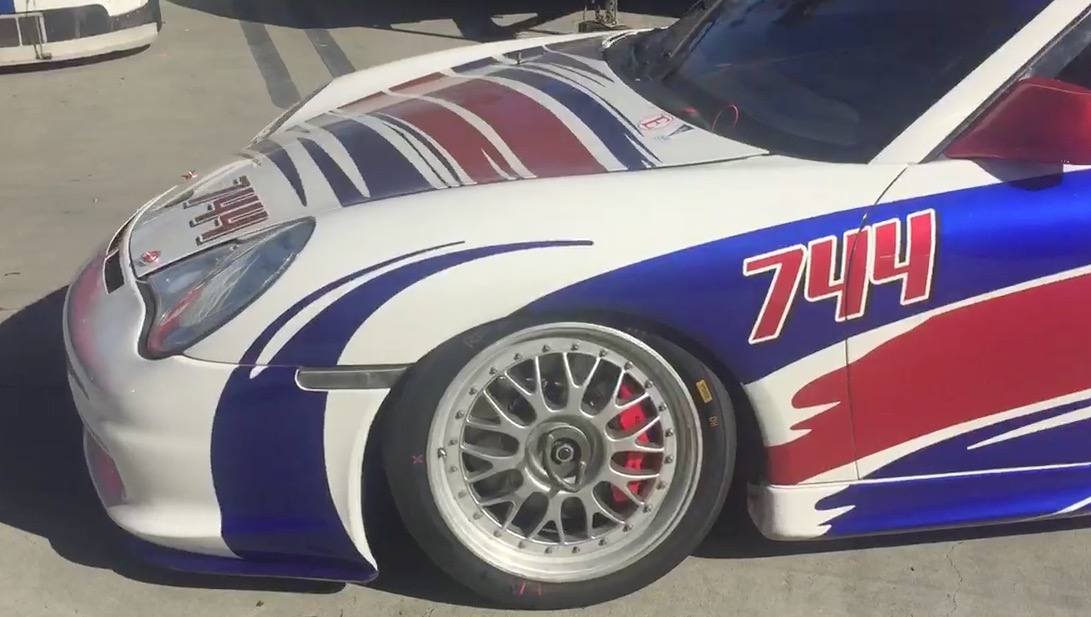

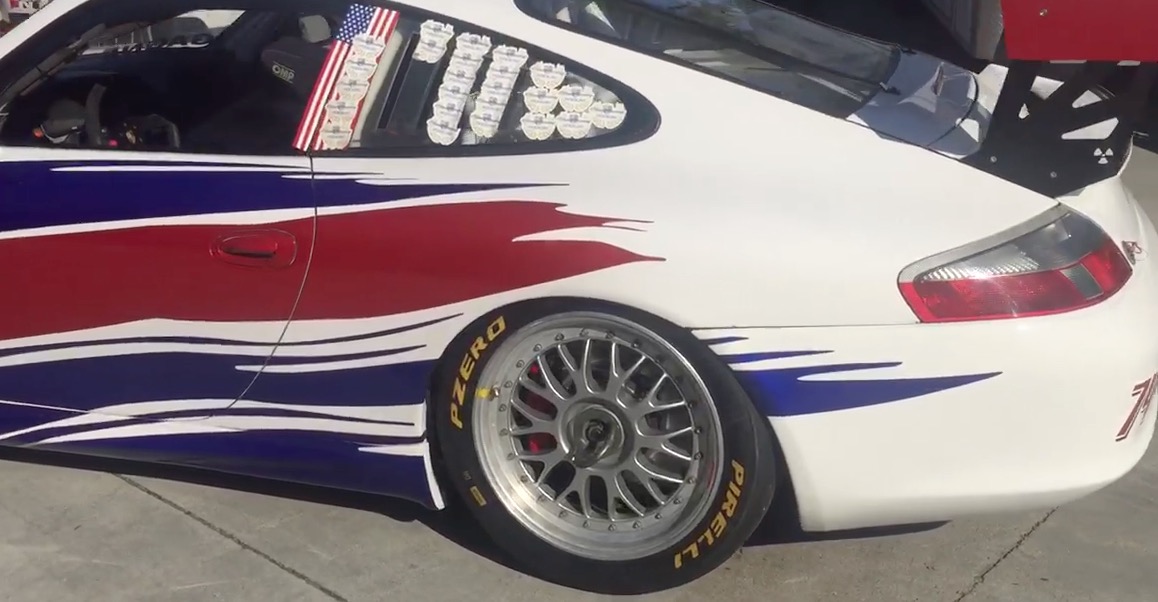

The reason I mentioned lowering the rear is the Conti GAGS cars ran what appeared to be zero or even negative rake and very low in the rear (like, low enough that some on here would make fun of them if they were a street car because slammified ride height) on the square 275/35-18 ish width Hoosiers-no-wait-they're-Contis-ok-fine-we'll-just-buy-Hoosier-so--now-they're-really-Contis,sorta. Rake can have a big impact on balance
here's an example of one of the Fall Line cars, iirc your car seems to sit a bit higher in back and about the same up front but that picture I saw might be old:
I know eyeballs are not the most accurate setup tools, but you can learn a lot just by ripping off other people's approximate setups, heh.
Anyway, yeah, suspension tuning especially with aero is not easy or everyone would do it and the best way to learn is to suck at it, that's how I have learned and continue to learn, certainly

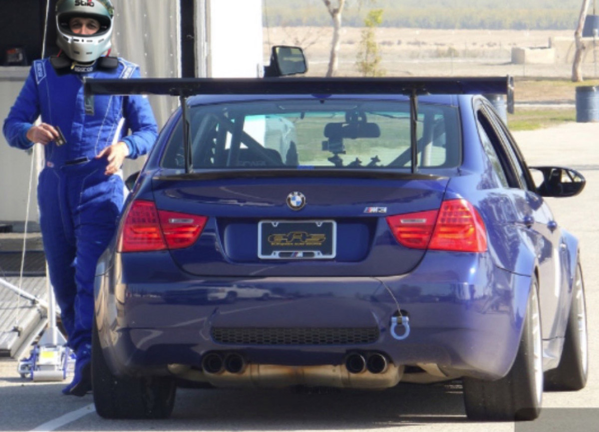

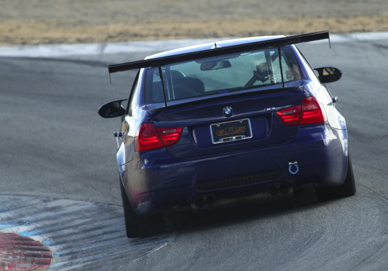

A few things come to mind when I look at the picture of the Fall-Line car.
- I'm quite certain I have more power than the Fall-Line car since I have a blower, which makes my car potentially squat more on acceleration, especially from low speeds where the car is launching out of turns. I don't think I'd want to squat much from that position.
- My 67" rear wing is enormous compared to the rear aero on that car. I suspect I'm dealing with quite a bit more rear downforce.
- I pulled up the most recent non-moving pic I have on the fattest/fastest tires I have sitting on the flattest ground I could find---Auto Club Speedway at Bimmerfest a few weeks ago. It's not an alignment rack, but it's the best I have. (I did rotate the Fall-Line picture a bit because the background was tilted, so I rotated it enough for the garage door edges to be totally vertical.) Comparing their car to mine, I don't think I'm running a rake monster. For sure, the rear of their car is lower than mine. (I think my front may be a tad lower.) But I would argue that with more power and more aero, I would want a bit more rake. Since the rear springs, aren't super duper stiff, they do compress under these larger horsepower and aero forces.
-And then of course, we're still left with the problem that I can't really lower the rear much more anyway.....

have any pics of your car from the rear that shows the wing size?
I think this is a nice rear shot from Laguna:
Here's a pit shot:
This front angle actually shows the wing quite nicely too:
Here's a pit shot:
Wow that's wide. Is this a standard fitment for sedans or are you running a wider wing than normal.

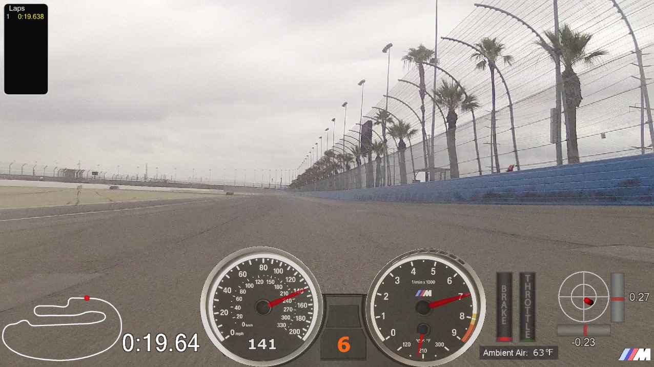

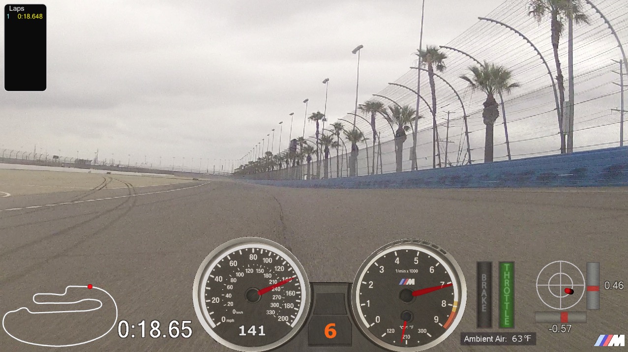

I was thinking about my recent days at Auto Club Speedway. I was there on 6/3 for Bimmerfest, and then again one week later on 6/11 for a regular Speed Ventures day.
What I was turning through my mind was that I kept blowing the braking zone for Turn 3---the 90º left turn off the Oval into the In-Field road course.
I have mentioned before that I don't have much track memory for Auto Club since I don't go very often. But I found it fascinating--or frustrating--that I blew that braking zone at least 4 times after having a good fast Oval---really frustrating to push it on the Oval and then blow it immediately on the next turn. I didn't run a ton of at-my-limit Ovals, so blowing that braking zone 4 times was actually a high % number of misses. When I was not braking it correctly, I was overshooting.....so I was braking too late.
So, I was curious----when I missed, how much was I missing it by? I wasn't careening out of control, but I would just go past the outer-edge cones for the turn into the In-Field and have to weave through them back onto the course. The results were interesting. I thought I'd share.
Guess what tool I'm using to analyze the situation! (Cue Trumpets!) Yes! The AIM Solo DL! How did you know?!
So, on the AIM solo I can see how many feet down the track I press the brake, and you can overlay laps, so it's pretty quick to look at.
On the laps where I was missing, I was braking about 53 feet later than my successful braking on my PR lap. Looking at my speeds at the moment of braking---around 145mph---I'm traveling 212 feet per second. So, 53 feet is about 0.25 sec later. hehe a quarter-of-a-second......that's not a lot of margin to get it right!
So, getting back to track memory, I can tell you I have never identified a braking "marker" for Turn 3. And with me working to go faster on the Oval, the "marker" for braking is changing for me anyway. But with such a narrow margin for missing, the first thing I will do the next time I go to Auto Club is try to identify a braking marker. Although, looking at my current videos, that stretch of track is a bit funky with the wall and fences. And at 145mph, things are moving pretty quick.
Here's what it looks like at the moment I touched the brake pedal on my fast lap. 53 feet later than this, and I couldn't get the speed down in time for the corner. It's not exactly lit up with braking markers. Although, I have to laugh----I JUST noticed right now while writing this, that they put braking cones UP ON THE WALL!! haha I never saw that before!
Here's 1 second before I hit the brakes. Again....not exactly full of markers to catch your eye. Actually, I find the fence whizzing by and all those regularly spaced light posts to make it even more difficult.
Anyway, when I talk about track memory, this is the exact kind of thing I'm talking about. Having a 0.25 second margin between success and failure definitely requires some built-up reflexes. And this particular corner, with traveling SO FAST and having to bleed 100mph of speed exaggerates the challenge.
Anyway, just thought I'd share.
I'm looking into possibly getting rear aero now but my buddy who had one I don't think was that wide. Or maybe I'm wrong.
I ran bfg r1s and got 7 good heat cycles LOLOLOL
I figure aero and nt01 will give me similar lap times but at least run more than two days. Did a 1:54:7 in my car but it seriously was like crack. 20 minute high and going to broke chasing it. Ha.
Racewerkz Engineering recommended the 67" width. As far as I know, it is not a special width. (My friend has a wing of the same width (on a sedan).)
But this 67" recommendation was based on the ultimate overall strategy that front aero would be going on the car some day. I believe that if I had an M3 that was still closer to stock weight and still generally still had the OEM weight distribution and was never planning on running front aero, I would most likely run a smaller wing.
(I've talked about this before) In my case, I was trying to fix a problem. Prior to the car being gutted and caged, I had a nicely balanced M3. Then, we went and gutted the car and the car's balance went to shit. Most of the weight comes out of the rear, and it was a HANDFUL to drive without aero. I was not used to the car being so nervous in the rear. I didn't find it much fun to drive like that to be honest. The rear was BEGGING to step out. Even traction control was struggling to control it at times. My Porsche buddy drove it at Laguna Seca without aero after it was gutted. He came back in the pits and the FIRST thing he said was "this thing needs a wing." If a PORSCHE guy tells you the rear wants to step out too much.........you need a fricking wing.
So, I no longer had a refined car with good balance that I was trying to mildly improve. No....I had a strange unbalanced beast that needed help. And my ultimate goal was full aero, but I didn't want front aero right away, and I didn't want to buy two wings---a small one now and a big one later. So I bought the 67", and yay, the rear was planted, but boy did the front understeer in high speed rounders when going fast----like 80+mph in Riverside at Buttonwillow. Ultimately, it took putting front aero on to finally regain balance.
Regarding R1S, I'm guessing that vehicle weight must affect their life. (I'm not overly surprised.) I don't know what your car weighs, but you get 7 heat cycles. I get 16 before a cord shows up. Joe at Trinity claims he gets 23. His car is 400 lbs lighter than mine.
The fastest I ever went on R1S was on their 8th heat cycle. I believe they are faster when new, but they are NOT slow by the 8th heat cycle. I've said before, I think they are quite fast up to 10 heat cycles. And still pretty darn quick up to 16. After that, when I assemble scrub sets after one of the cords, then they slow down a bit, but are still quite fun to drive.
Are you running them square? And are you careful about rotating them? I always rotate them after 2 sessions. Every 2 sessions, they move. If you don't rotate them, then they'll cord more quickly.
Josh Haddox has a nicely setup E90 M3 (by Racewerkz) with basically stock power. The car is pretty well gutted and has full aero. He ran a 1:54 on NT01 at Buttonwillow.

I guess it is worth mentioning that it was possible to dial out a fair amount of the rear aero by lessening the angle of attack. But I warn you-------once you get a taste for the rear of the car being planted, YOU DO NOT WANT TO GIVE IT UP. PERIOD.
I did experiment with reducing the AOA and got less understeer, buuuuut the rear wasn't as planted......forget that. I put it back and tried to sort out the understeer. Yup----front aero.
The problem is if you don't want as much downforce as a big wing can provide, and dial the angle of attack back, you still have the big wing hanging out back there causing some degree of drag, so it can hold you back on the straights.
