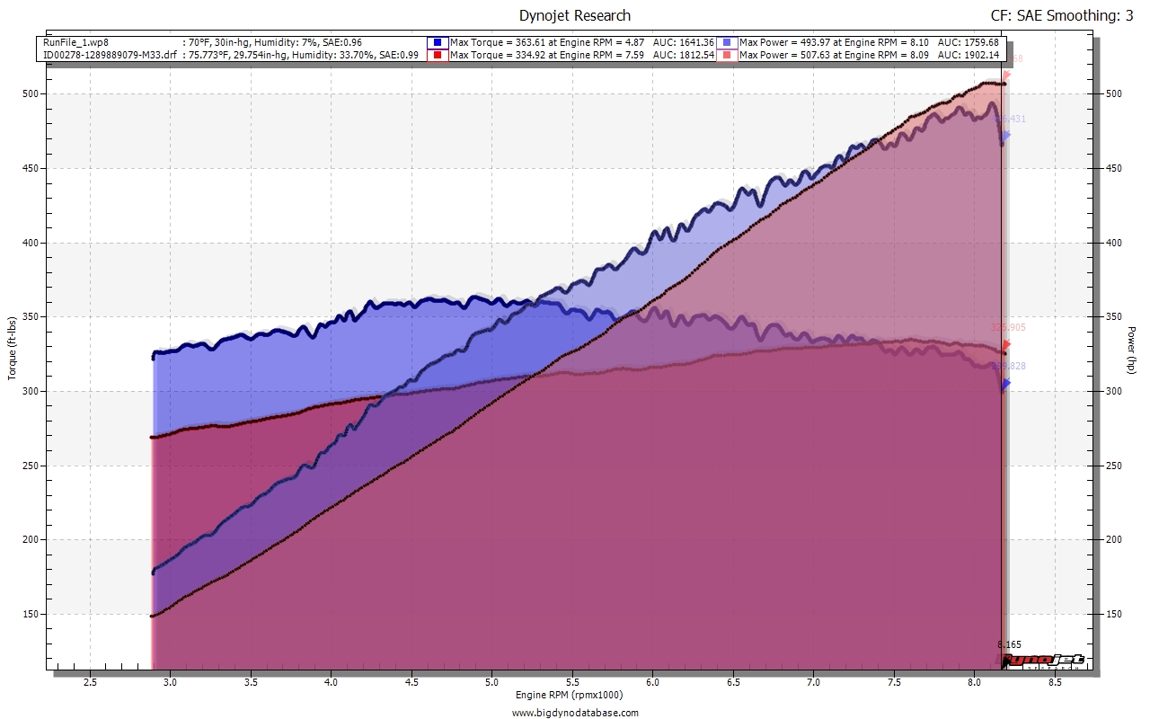

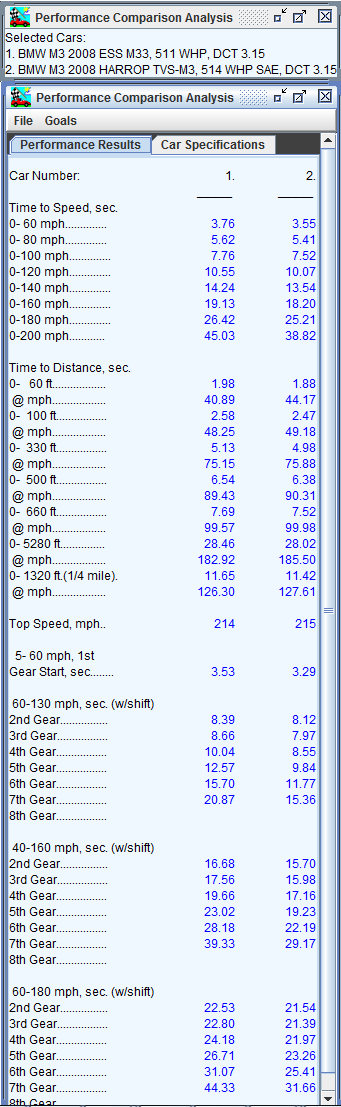

Sorry this took so long...been real busy. Here's the comparison I promised.
Here's the area-under-curve graphs, and the CarTest estimates for ESS @ 511whp vs. Harrop TVS. The closest I had for ESS was 490 or 511. You guys wanted 500, so I shot over to 511 instead of down to 490. The CarTest results are using the actual WHP dyno charts input into CarTest for analysis.
Is that a VT1 dyno RG? That looks like VT1 power. Most VT2 cars make around 550 whp. You should do the same graph with a standard VT2 car making 530-560 whp.
I posted a bunch more comparisons between the Harrop and other kits in the main Harrop thread. This particular comparison came from m33 on his first kit. I was asked to compare to about 500 whp, and that was the closest I could find.
http://www.s65dynos.com/showDyno.php?recID=278

Thanks for setting that up regular guy!
