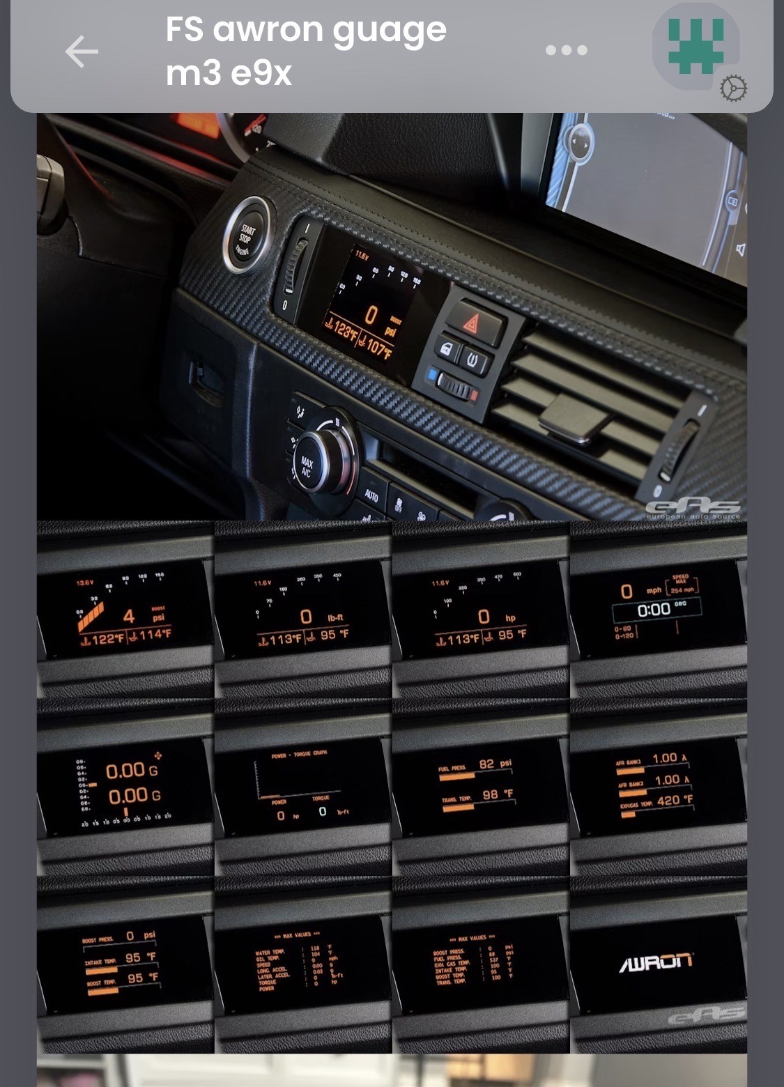

Originally Posted by IamFODI View Post
Apologies if I missed this somewhere in the thread. Given that there's a pressure sensor of some kind from the factory, is fuel pressure not viewable via OBD?
Yes it is. A friend of mine had a screen installed in one of the air vents, where he monitored the fuel pressure and several other variables.

Originally Posted by jvictormp View Post
Thanks for the kind words. Unfortunately I already needed, and wasn't ready, so this is my second engine.
The thread for that is here: https://www.m3post.com/forums/showthread.php?t=1851485
I assume the vent mod your referring to is one of the units in the picture, I cannot confirm it monitors fuel pressure but its currently for sale on this site by another member.
One of the pictures shows fuel pressure indication.
And yes, that's what I'm referring to.
