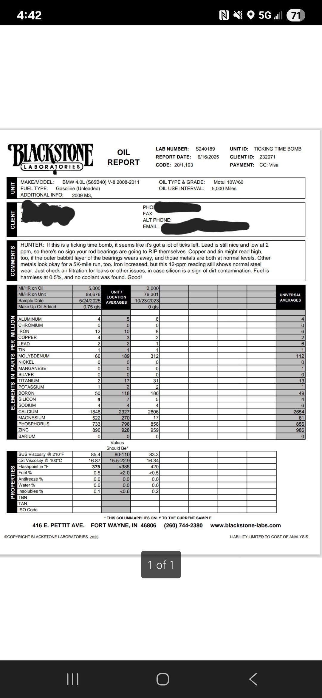

Howd I do?

Originally Posted by S65Hunter View Post
Howd I do?
What bearings are you running? Any track time? That viscosity sheared like ass. On a similar OCI mine on Red Line 5W50 was at 18.8 cSt.
Your copper, tin and lead numbers look good. Mine were higher at 7, 3 and 1, respectively.
[img]"]https://bobistheoilguy.com/forums/attachments/1734224790476-7d9cd6ff-40da-4ec8-8714-17bb90c54bbe_1-3-webp.254191/[/img]

Originally Posted by a5m View Post
What bearing are you running? Any track time? That viscosity sheared like ass. On a similar OCI mine on Red Line 5W50 was at 18.8 cSt.
The PO had the bearings replaced by BMW do its their "updated" bearings. No track time, it's just a weekend car. Though I drive it very hard every time I drive it. Not sure if this Texas summer heat has anything to do with that. I've been considering replacing the RBs with a better alternative as well
Howd I do?
My conclusion would be that your fuel dilution is much higher than the "fuel dilution" reading suggests. I've seen this a lot with Blackstone reports – they show zero fuel dilution when the viscosity and/or flash point say otherwise. In your case, it shows more than zero, so I suspect the actual number is higher – especially given how low the viscosity is. That might also explain the slightly elevated iron wear.
For street use to come anywhere near track use in terms of wear potential, you'd have to be abusing the hell out of your engine. Burnouts, donuts, launching and redlining the first two gears at every traffic light, free-revving to redline, going too hard when the oil is cold, etc. High throttle and RPM at low speed, a lot. If you were to drive fast enough on the street to mimic track use in this car, you'd get arrested or killed long before your engine wore out.
Re. rod bearings: how long has it been since the PO replaced them?
For street use to come anywhere near track use in terms of wear potential, you'd have to be abusing the hell out of your engine. Burnouts, donuts, launching and redlining the first two gears at every traffic light, free-revving to redline, going too hard when the oil is cold, etc. High throttle and RPM at low speed, a lot. Fast street driving alone will probably kill you or get you arrested and your car impounded before the car wakes up.
Yeah im definitely not THAT hard on the car. But it very frequently see red line typically 2nd-4th. And I always wait til the oil is about 200F before driving that way. RB have just about 20K miles on them.
Got it. In that case:
1. Sounds like you're operating well within what this engine was designed to take in terms of mechanical stress. Track use is ~4k to redline, mostly WOT, nonstop, and this engine was made to take that for very long periods of time even in hot weather.
2. Given that, I'm even more confident saying you need a second opinion on fuel dilution, because the only other explanation is that Motul 10W-60 just can't hang. I use Polaris Labs, and one reason is that they test fuel dilution by a different method that's much more trustworthy IMO.
3. For your rod bearings, the only thing I'd be worried about is install error, but 20k miles is enough that you're probably safe from that. The updated BMW bearings are fine, at least when used with BMW bolts. They had some failures early on, but the discoloration people assumed was wear is actually superficial and we have yet to see a single set that shows actual wear like what we saw with the original bearings. Down the line, feel free to replace them with something else if you really want to, but zero hurry to do so now.
To be clear, I do think you have a problem: that viscosity loss is awful. I'd be surprised if it didn't cause excess wear. I'd want to diagnose and fix it ASAP. I've done a few track events and had fuel dilution up to 2.6%, and I've never seen viscosity that low with BMW 10W-60, especially after they switched back to Castrol from Shell.

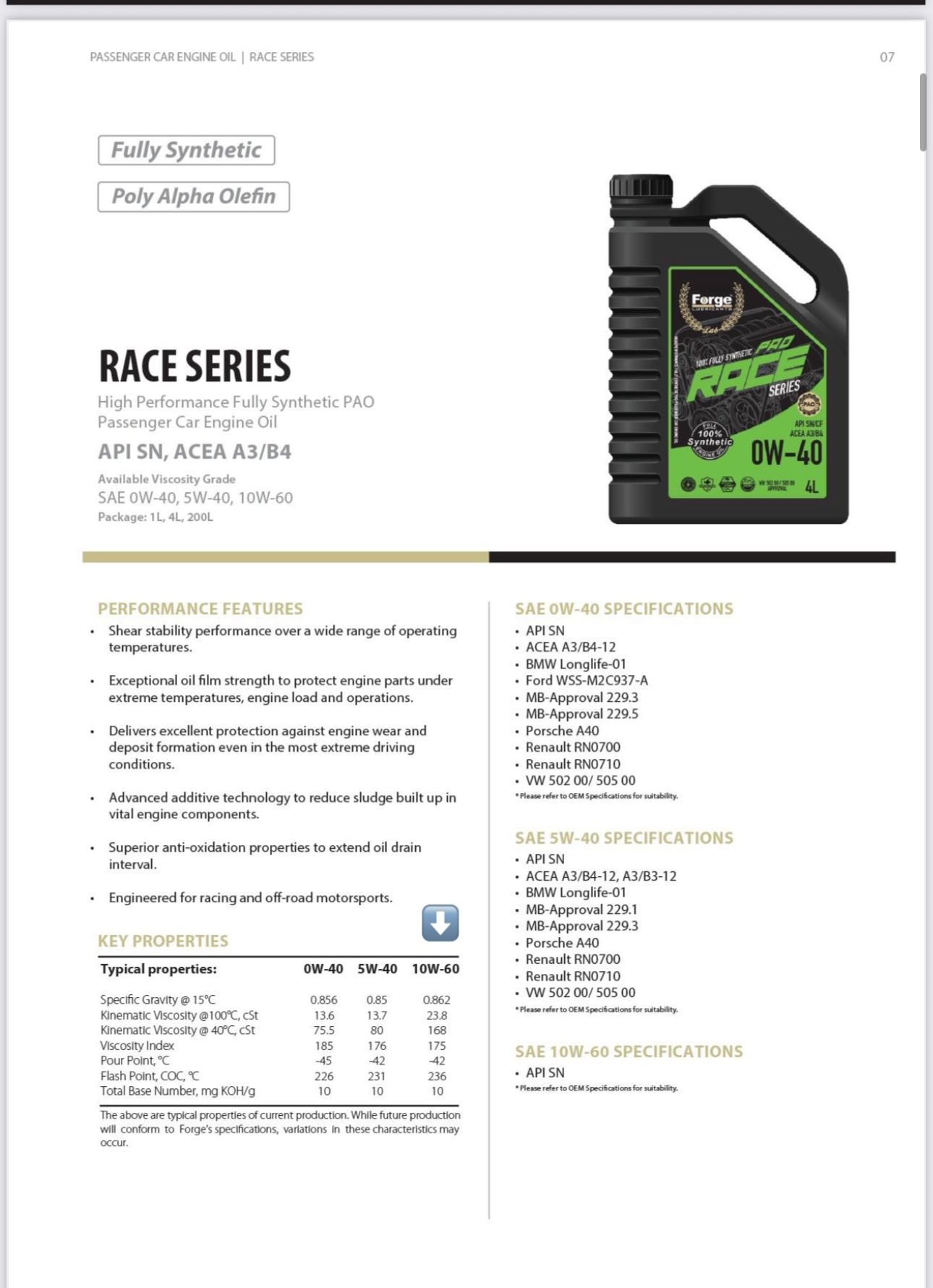

Talking of OA.
For my car, oil was 2 years old, mileage in report. Did 4 track days on it.
I was surprised that soot was at 0 seeing as how dark the oil came out!
Had to ask for the 40C testing .
PaulGros Got TAN done too seeing as you thought it'd be useful .
New oil specs as per 2021 datasheet:-
Kinematic viscosity @100C 23.1 cSt
@40C 160.1 cSt
Density @15C g/ml 0.8458
So if I've got this right, my oil has sheared down to the upper end of the 50 grade @100C.
But I can't work out what the equivalent grade is for the cold end at 40C w rating using the viscosity grade table I have. Can anyone else?

Seeing as your oil is also 10w60, I don't get why they say it should be between 15.5-22.9 at 100C as that corresponds to 40 to 60 grades!
60 grade is from 21.9-26.1 @100C (going by the attached doc).

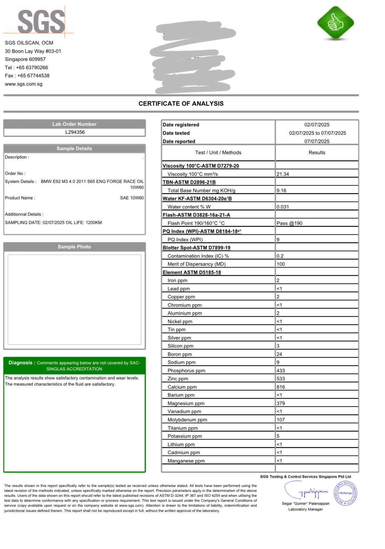

not sure if u guys tried this PAO 10W60 before but i did and the result seems good?! I am on BE BEARING too but 2 years old.
