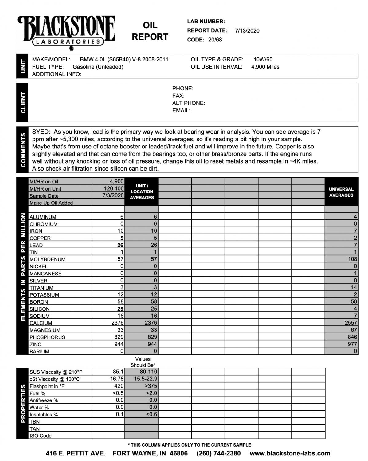

      07-07-2020, 07:06 PM   #1062
ekfc63
24
Drives: 2008 M3 Sedan
Join Date: Sep 2016
Location: Vancouver
Just got the oil report back for my 160,000km (100,000 miles) '08. The oil had 10,000 miles on it. Very high Lead and Copper. I use regular 94 octane gas.
It looks like I'm overdue for new bearings.....
      07-07-2020, 07:20 PM   #1063
byroncheung
192
593
Drives: e90 m3, 997.2 c2s, x166 GL450
Join Date: Nov 2014
Location: Westchester, NY
Yeah better change them soon...

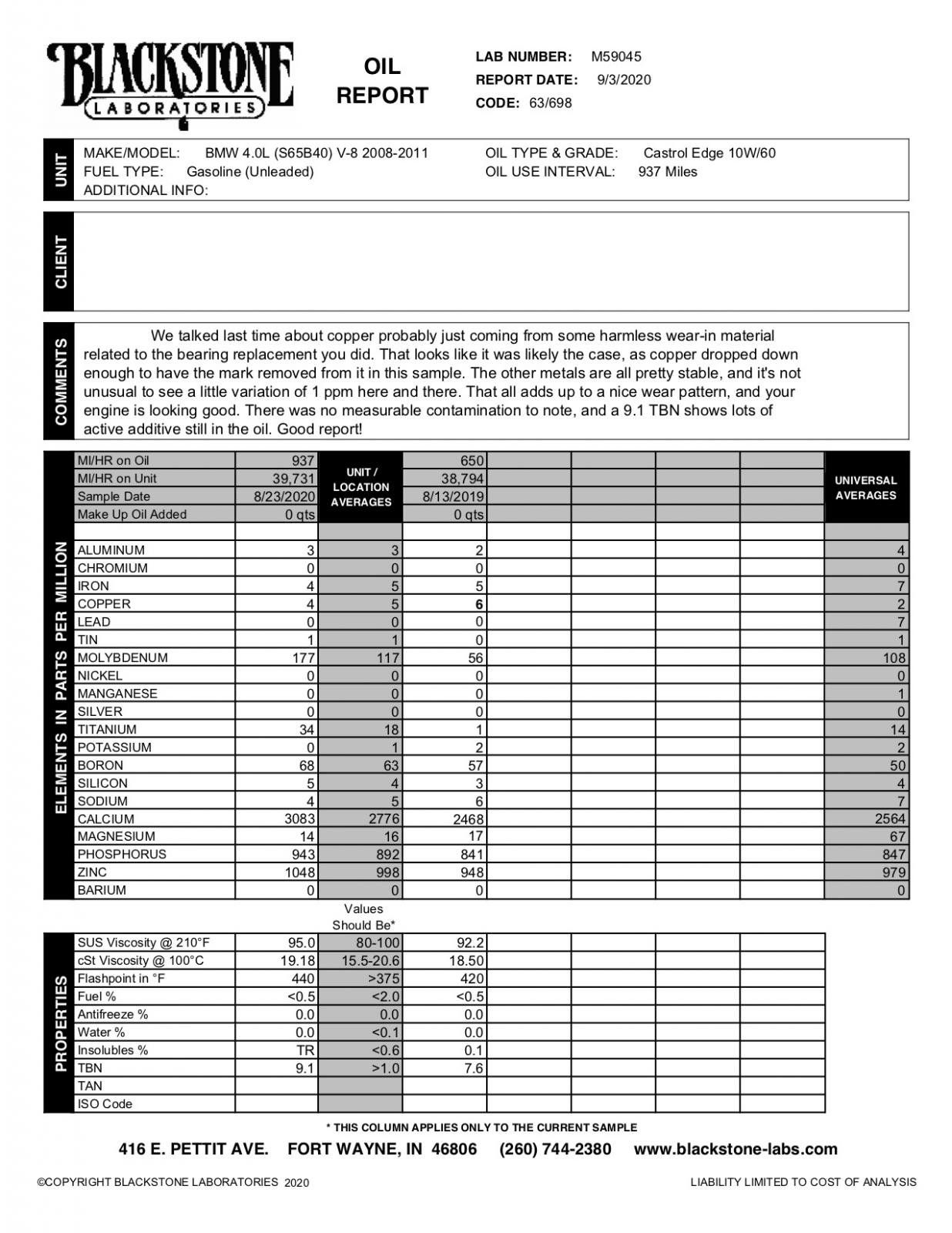

      09-03-2020, 01:54 PM   #1068
kcdedric
kcdedric's Avatar
773
649
Drives: E90 M3
Join Date: Apr 2011
Location: Norcal
Originally Posted by kcdedric View Post
Oil change after 650 miles on new BE bearings. Oil is Castrol 10W-60.
Follow-up report after 937 miles.
interesting. Mine report is similar to yours.. some copper but no lead. I am very curious as well

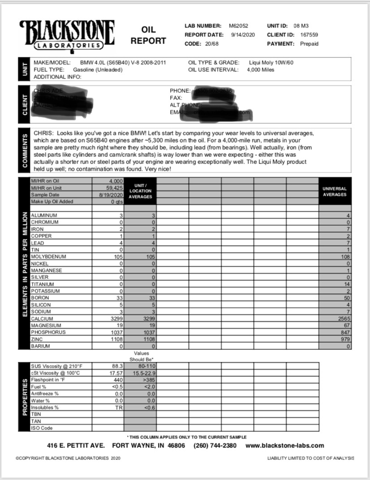

      09-15-2020, 12:41 AM   #1070
Davisca455
Davisca455's Avatar
2242
867
Drives: 2008 M3
Join Date: Oct 2012
Location: Davis, California
Here's my first Blackstone Report.
2008 with just over 60,000 miles now.
Original rod bearings.
The car was parked for 4 years before I bought it in August of 2018, but didn't get it drivable until the following November.
Bought it from a friend who is the original owner.
It had just over 42,000 miles when I bought it.
Original owner never tracked, always warmed up, but not babied.
Has had a G-Power blower since the 6000 mile mark, so that's 54,000 miles with the blower.
The car was well maintained and was on a yearly oil change schedule at the local BMW dealership.
When I bought it, I switched it from the oil (TWS 10w60) that the dealership was using, to LiquiMoly 10w60 on a recommendation from a local BMW specialty shop.
I change the oil myself at 5000ish miles, but more often if there are track days involved.
I always let the idle calm down after starting it, usually sit in the driveway for a few minutes, never over 3000rpm until fully warm, always drive in M mode (Power/EDC comfort/DSC off).
California car, so 91 octane Chevron, sometimes Shell.

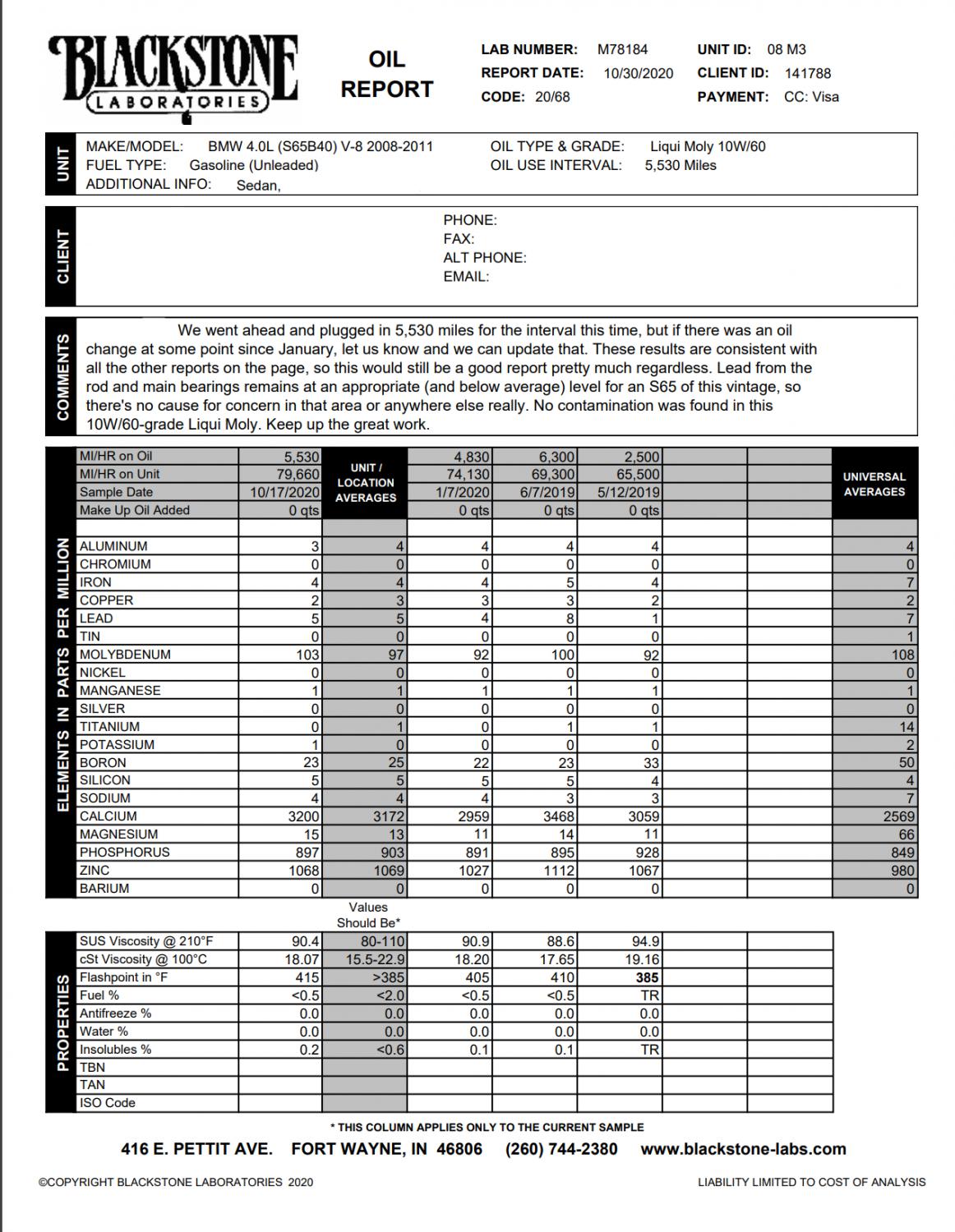

      10-02-2020, 06:29 AM   #1072
ASW338
10
Drives: .
Join Date: Jan 2014
Location: NY
Hi, I got my oil report showing increasing copper in ppm every test. Rod bearings was replaced with BE bearings and OEM bolts at 70,000 mileage on motor and now is 106,000. Just only 35,000 on BE Bearings. I hope to get some thoughts from expert here. To my understanding, that BE Bearings are made by multiple layers, Clevite TriArmor Coating (outer), Babbitt Alloy (center) and the last layer Lead-Copper Alloy. Is it showing the rod bearings already worn to copper layer and should I worry about it? What other parts in the motor would cause this increasing copper? Any inputs and advice will be much appreciated. Thanks in advance.

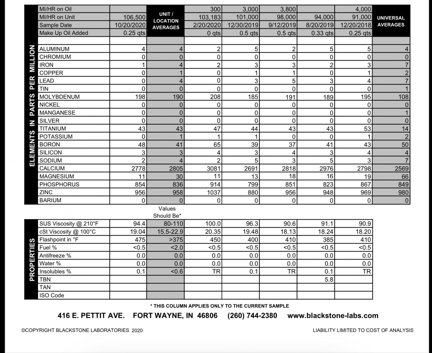

      12-12-2020, 10:00 AM   #1078
Bubbles
Bubbles's Avatar
Cayman Islands
2891

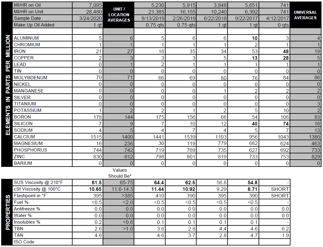

4,444
Drives: Green Bastard
Join Date: Jun 2007
Location: Bishop Bend
106,500 miles report (BE bearings after 6,500 miles)
Nothing interesting to report which is exactly what I was hoping for. No lead or copper.
