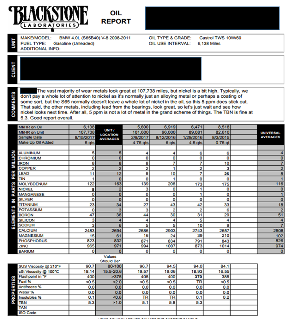

Originally Posted by kimiraikkonen View Post
From the latest Blackstone oil sample:
"The vast majority of wear metals look great at 107,738 miles, but nickel is a bit high. Typically, we don't pay a whole lot of attention to nickel as it's normally just an alloying metal or perhaps a coating of some sort, but the S65 normally doesn't leave a whole lot of nickel in the oil, so this 5 ppm does stick out. That said, the other metals, including lead from the bearings, look great, so let's just wait and see how nickel looks next time. After all, 5 ppm is not a lot of metal in the grand scheme of things. The TBN is fine at 5.3. Good report overall."
What's the feedback on nickel content for our S65 engines?
I'm not sure, that is kinda weird. Nickel is used in bearing coatings, but I'm not sure if the S65's have any. It's also an alloy for valves, the crankshaft, and camshaft in some cars. Again, not sure where the S65 used nickel.
In previous analyses, did you have any nickel show up? If you don't have any previous reports, I would just keep driving and monitor things. If the nickel is elevated from last time, I would watch closely on the next one.
Thanks dparm. Here's my full report as fyi. I know older BMWs from the 90s had the Nikasil issue, but shouldn't be any nickel coating on the S65s.....
BMW hasn't used Nikasil for a long time.
The rise of nickel over time is suspect given that your change intervals appear to be similar. Also, to be clear, are you really adding 5 quarts of oil in between changes? That would mean you're burning almost 1 quart per 1,000 miles driven. How did that suddenly happen in early 2016?
You may want to post this on BITOG to get some other opinions, but something is wrong if the car is burning that much oil and has nickel rising over time.
The first oil change 0.75 qt is misleading, as I did the oil change shortly after I got the car.....so unknown status on how many qts was put previously by the owner during that oil service period.
That being said, the car has been fairly consistent at 1200 mi / Liter......so am chalking this up to how some S65 motors consume oil.

Originally Posted by OlBloo View Post
Wow a liter per every 1k is huge especially w/ 10w60. Bad piston rings or valve seals maybe?
And for myself, as I'm considering cashing in my warranty, at what range of lead levels are considered high?
Every engine is different. Some will consistently show 0, so anything >0 is considered high, and others will consistently show 10, so anything above 10 would be high.
This is why you want to do reports over time and establish a baseline.

Cams are a high nickel steel alloy IIRC, but I would think you would also see more chrome if it was cam wear and that's a zero (chrome and nickel content are around the same approximate concentration in those alloys)

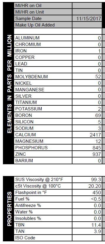

Here's a VOA of the oil that I understand went into my S65 in June/July 2017. I had Blackstone re-run the viscosity with it coming back the second time at 21.84cST @100C. UOA coming shortly.

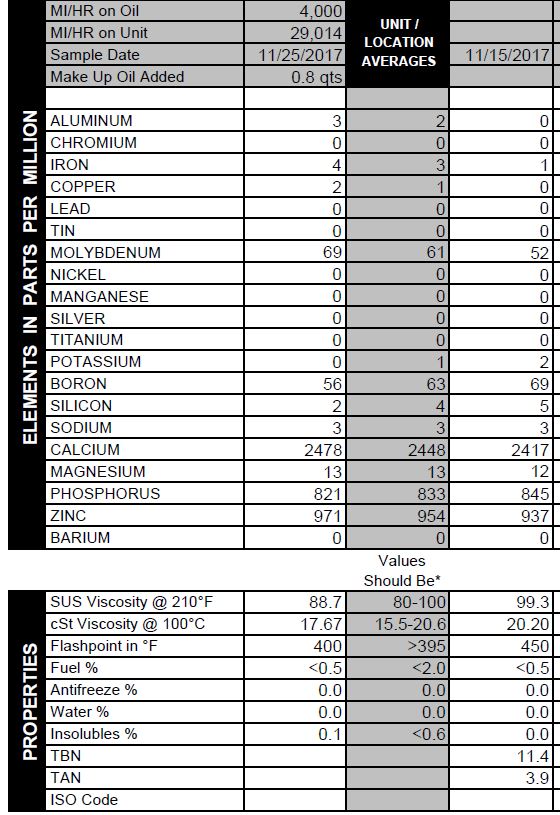

2011 E90 6mt Uoa
BMW Twin Turbo Power 10w60 UOA (Right) and VOA (Left). Build date is 12/10. I'm not looking to extend OCI's so no TBN.
