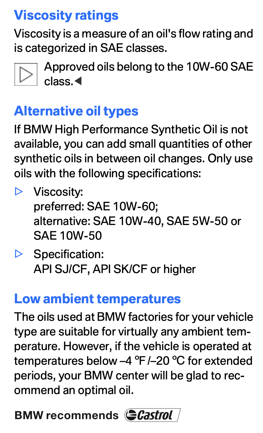

SoCal is an abbreviation for Southern California often used in American vernacular. I see this information below in the E9X M3 Owner's Manual.
