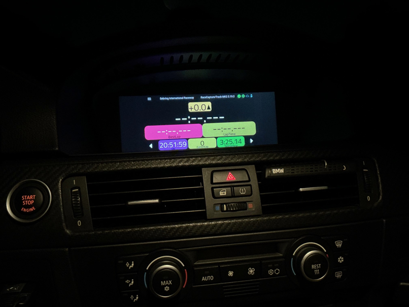

Tonight I was in the "Factory Mode" menu to update the boot logo, and I discovered you can do screen mirroring over USB!
Mission accomplished! I'm really excited about this!
