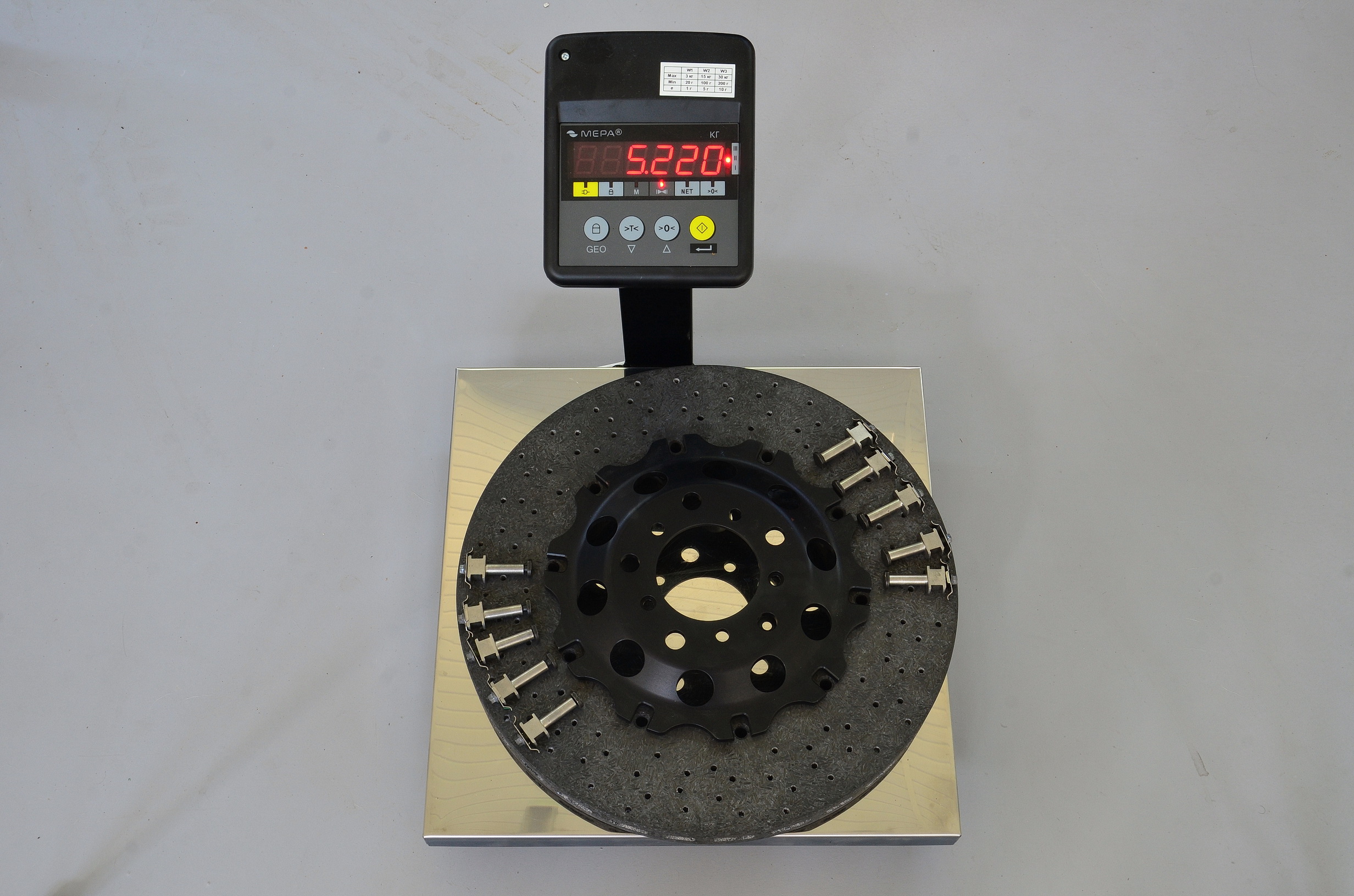

front rotor of this kit on scales, 390x32.
Image hosted on: pp.userapi.com

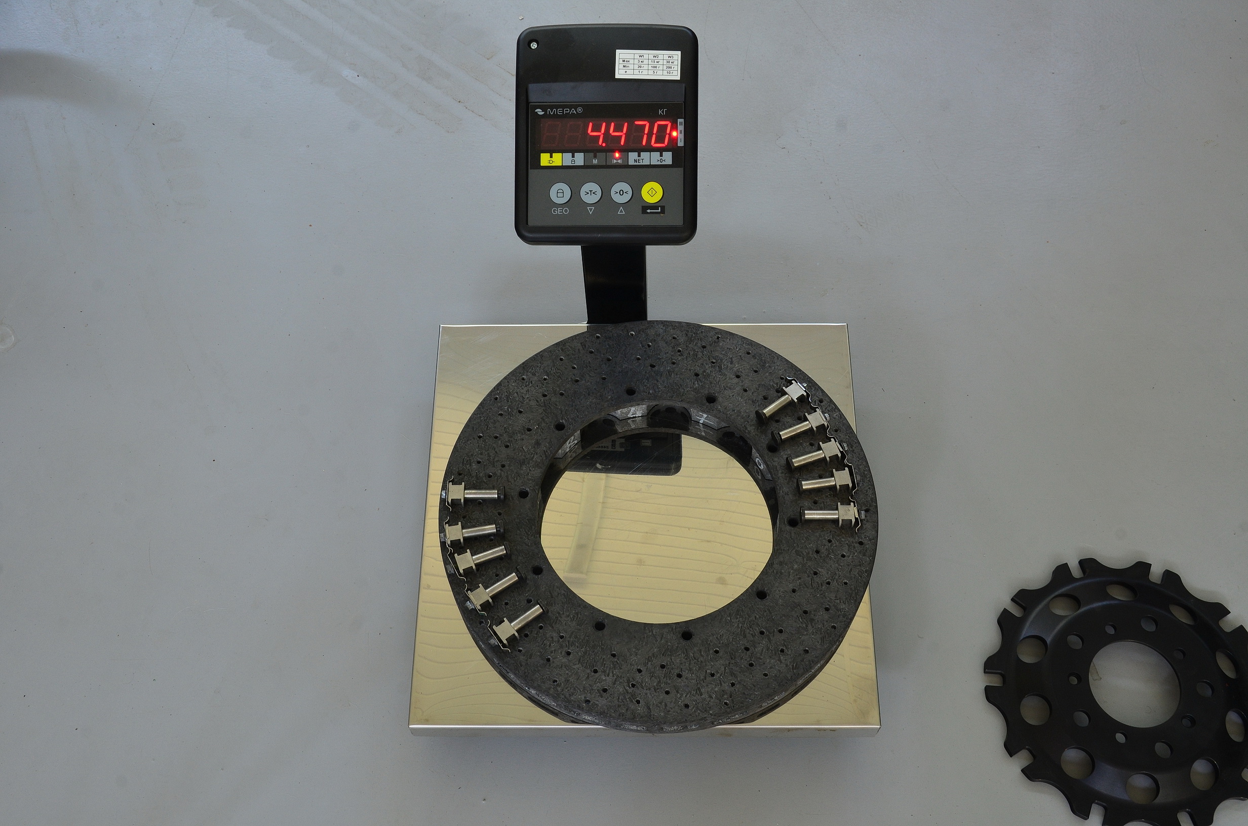

rotor with hardware without hat

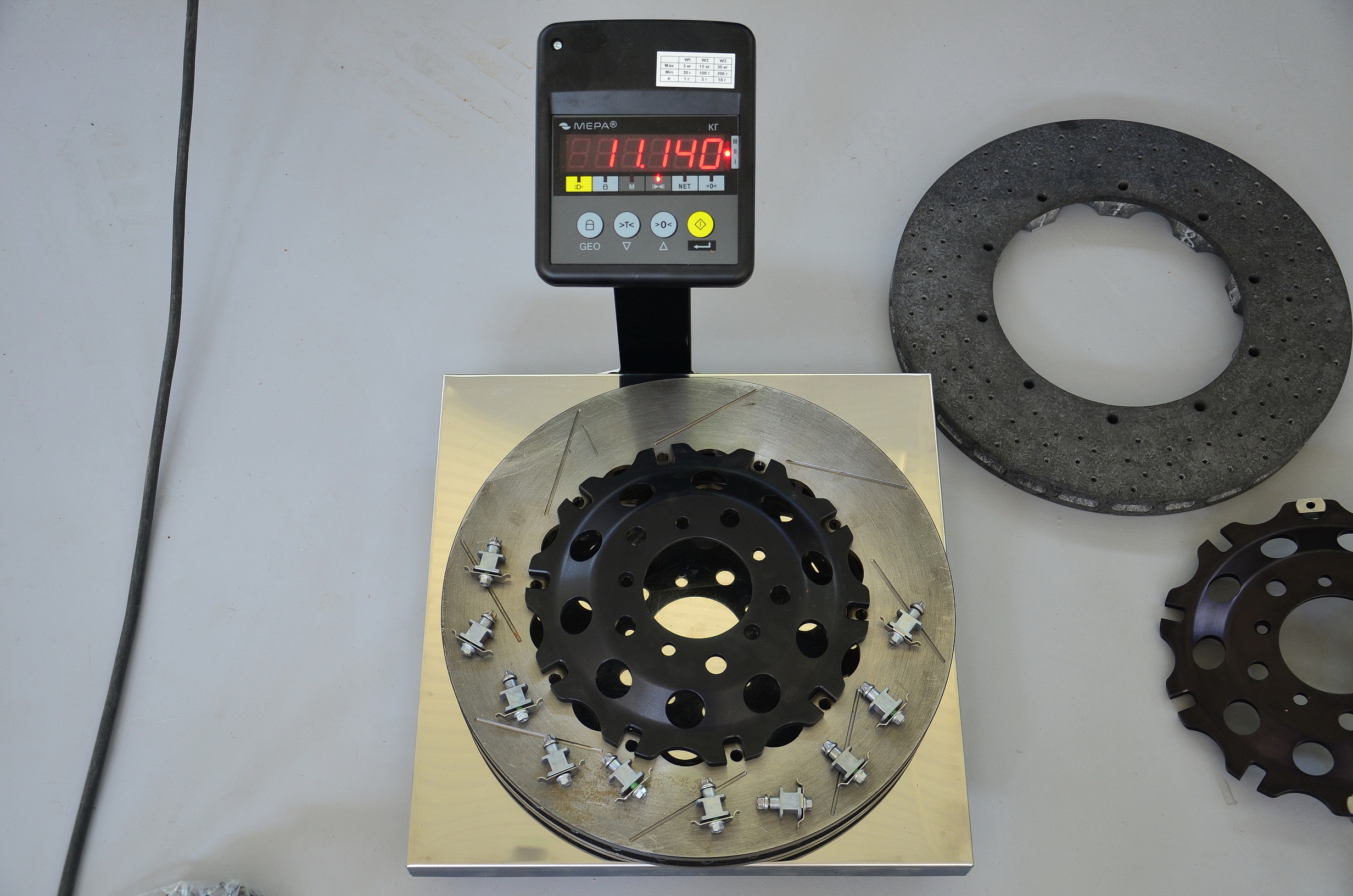

our lightweight two piece floating rotor for comparison, 380x34.

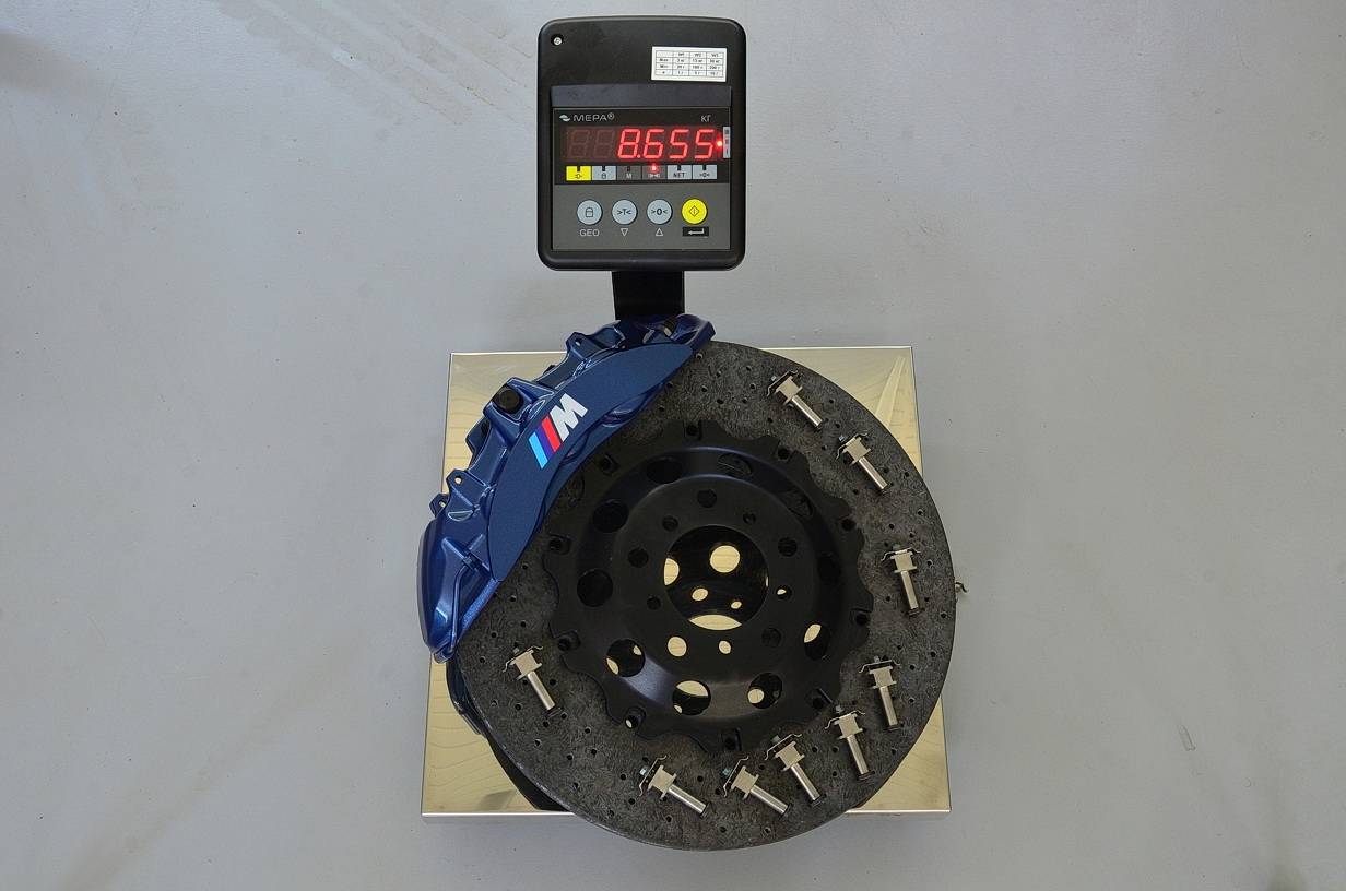

with our 6 piston brembo caliper
plus bracket

)) we've made this calipers for f80, and i took them from the shelf to use for photos with my rotors.
those calipers on car. similar kit for f8x, oem 380mm rotors with our 6 piston brembo calipers.
