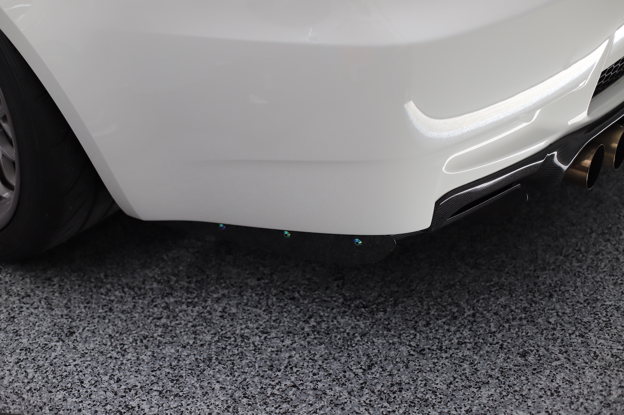

Alight guys, here's the update on the RW Carbon Under Tray and Diffuser.

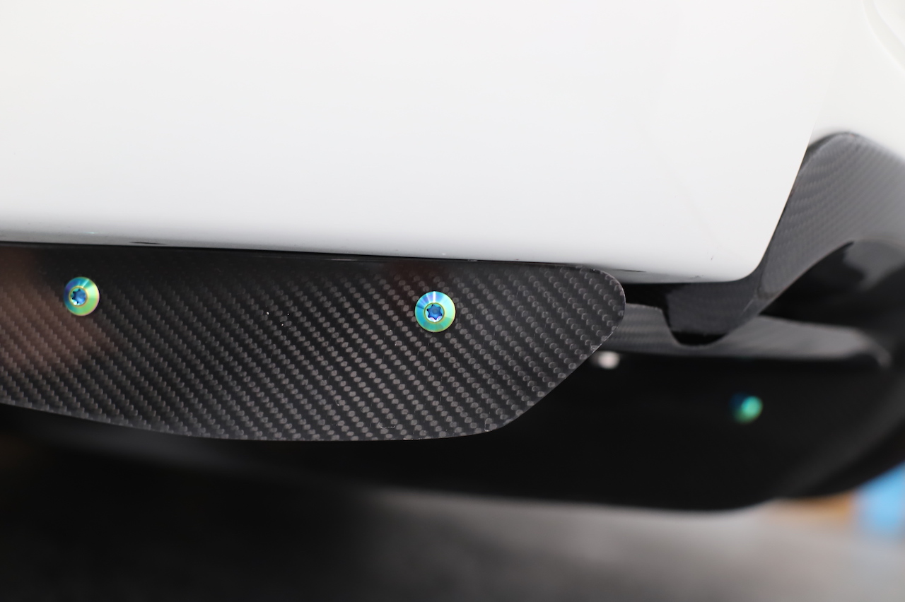

For the diffuser, I went ahead and took the tape off then use 3M Body Panel Adhesive to make it permanent. 3M VHB tape kept coming off after car washes and drove me nuts.

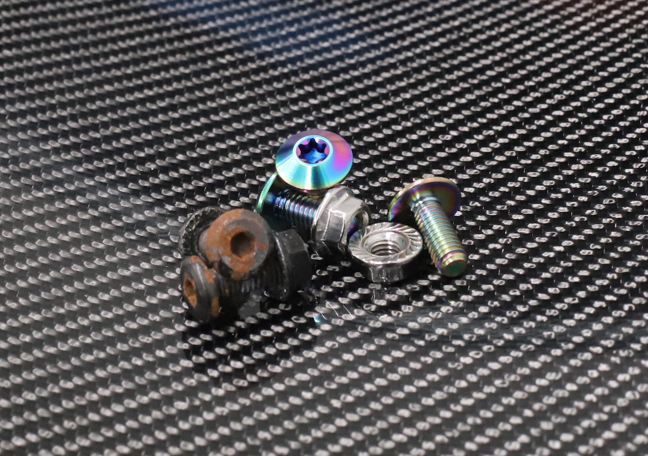

For the tray, RW Carbon's supplier uses non-zinc coated hardware so it started rusting. Other than that, I have 0 complaints about the product which is holding strong at speeds and strong wind gusts. I replaced the hardware with titanium bolts below and 304 SS nuts. I'm loving the look and the couple ounces of weight savings :D
Titanium bolts:
(22) M6 x 15mm
(2) M6x12mm
https://www.aliexpress.us/item/2251832460881302.html
(2) M6x25mm
https://www.aliexpress.us/item/3256804544484260.html
1 pack of M6 Serrated 304 SS Nuts:
https://www.amazon.com/dp/B071XHYWLW?psc=1&ref=ppx_yo2ov_dt_b_product_details

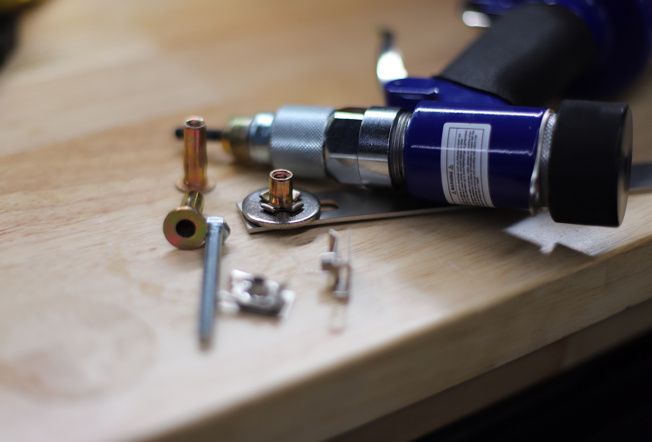

Update: Swapped the clips out with Plus Nuts. For faster removal and installs (track vehicles, nice to be able to remove the trays for diff service / links etc.).. You will need to remove the rear bumper (super easy) and replace the clips supplied with these M6 plus nuts.
Note, plus nuts (makes a plus when contracted with a tool) are stronger than rivnuts (expands). Tray help up great at 130mph with 40mph cross gusts.
Got the titanium bolts on Amazon. Great tip.

Get the plus nuts, remove rear bumper and install M6 plus nuts. You'll cuss a lot less whenever you remove and reinstall the tray, lol.

Over a year in and a track season... Once I've updated most hardware to titanium and true stainless, changed the bumper M6 clips to M6 plus nuts, everything is still held on strong..
