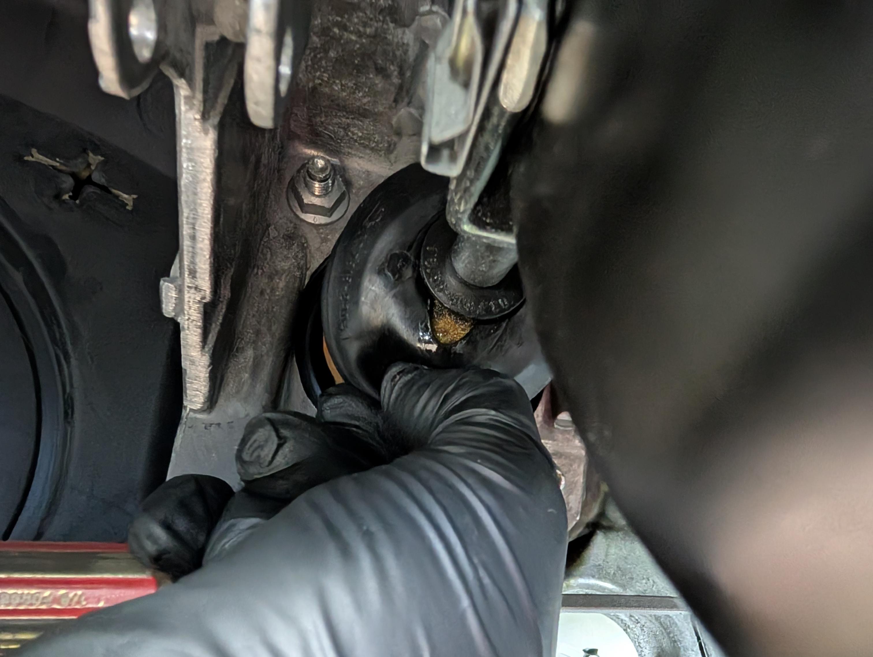

Hi all,
I wanted to get some opinions on my situation and the picture above. I have a dead / soft pedal at the top, say 10-15% of travel. I have bled the brakes probably 4-6 times, including moving from whatever was in the system when I bought the car 3 years ago to a full flush with Castrol SRF. So it has had SRF in it for three years and I've bled it 4-5 times using both a manual bleed procedure as well as with my Motive Power Bleeder. Each time after a bleed it appears to be resolved but then after driving for some period of time it will return. This is especially frustrating because I track the car and no matter what I do, I seem to get a long, soft, pedal on track. Important to note that I am running the Stoptech ST-60 front BBK and ST-40 rear. I have used both Stoptech performance pads as well as Carbotech XP-12/10 combo and I've had the same issue with both pads (getting a soft pedal).
I have used a torque wrench on the bleeders on the calipers and I don't think that is where the issue is coming from.
To try and figure out what is going on, I have inspected the master cylinder and brake booster under the hood (under the cowling) and I don't see anything obvious. I then went under the dash and found that there appeared to be some wetness around the master cylinder rod boot and there was definitely fluid inside the boot. Not enough to be pouring out of the boot though. I wanted to get opinions on what I found and see if this is a definite sign that the master cylinder seal(s) has failed or if I should keep looking for some other cause.

It should not be leaking, especially that much. Time to replace that booster.

Okay, so there shouldn't be any moisture in the boot at all, I assume? As you can see from the picture there is definitely some amount of fluid which I think is brake fluid. I guess I'm ordering a new one from FCPEuro.

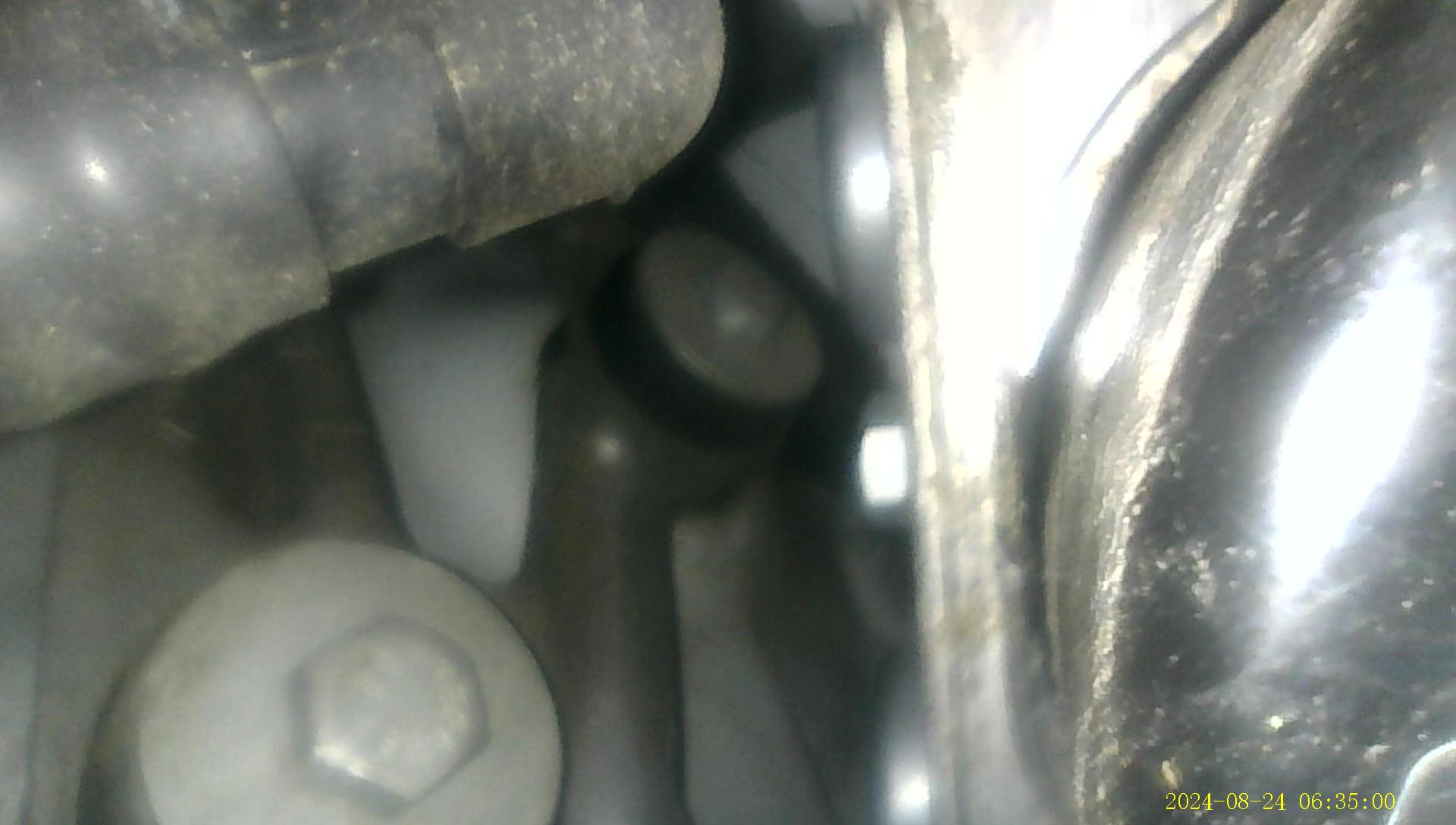

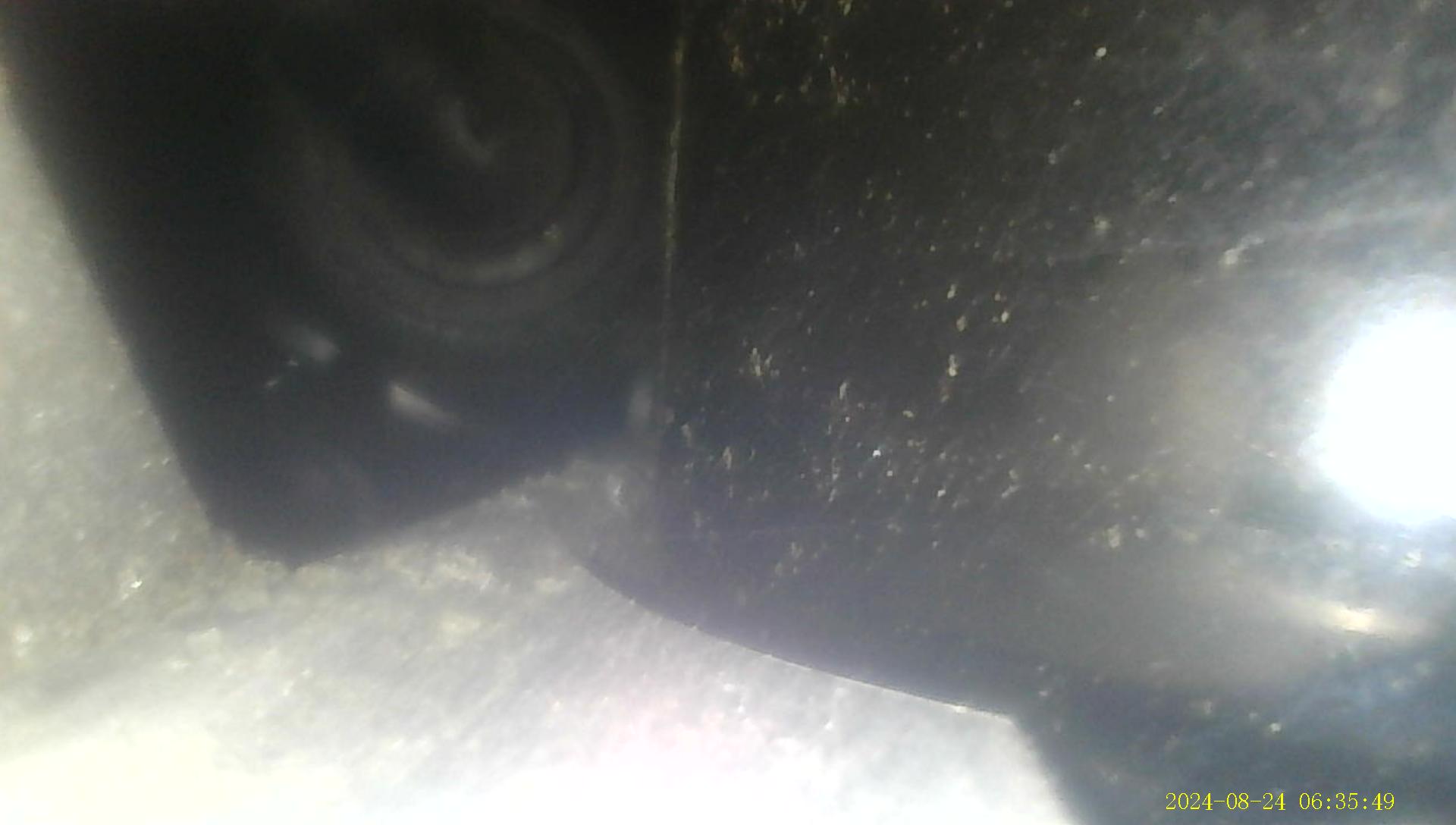

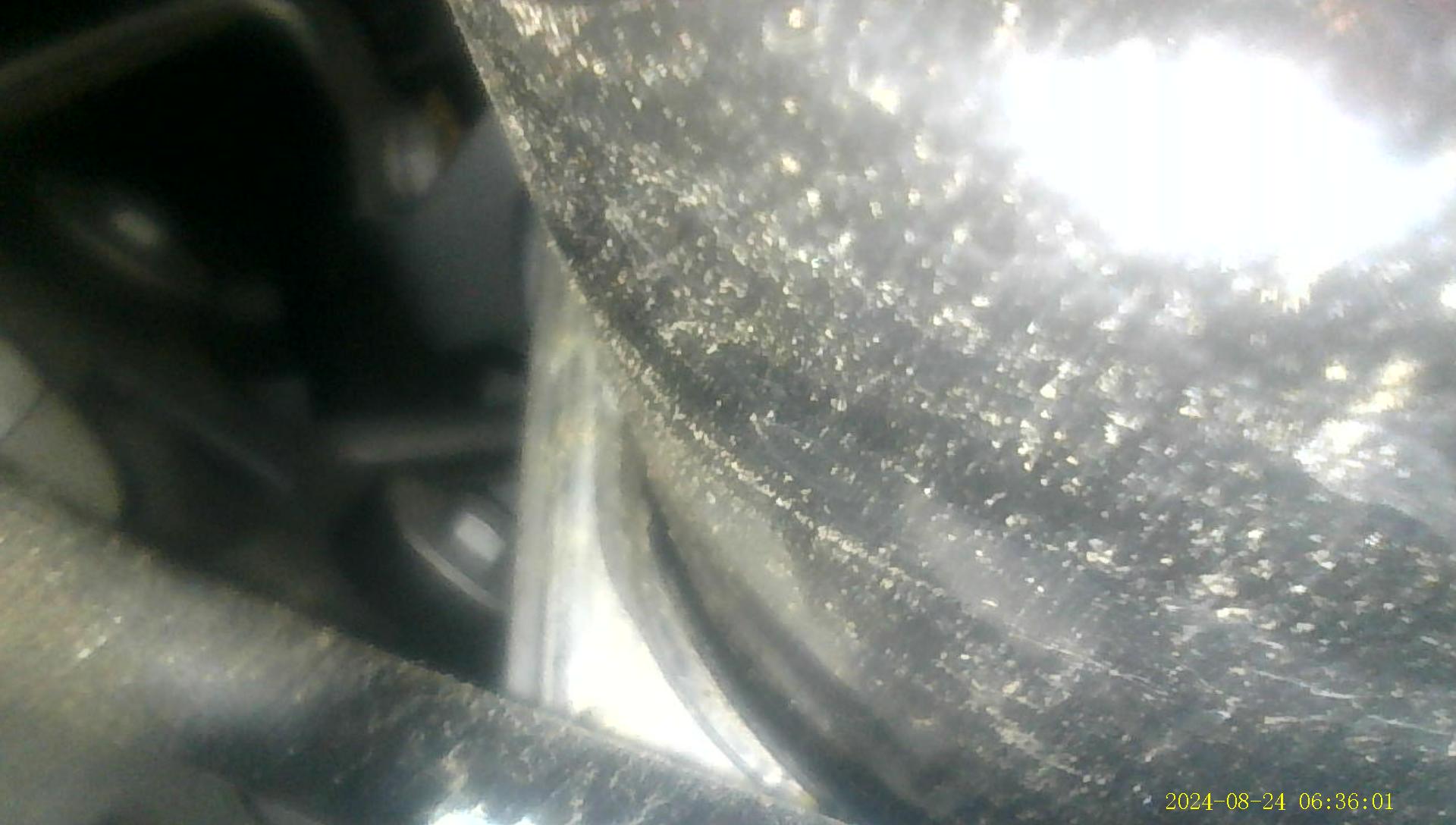

Thanks for the link Redd. I did just take a good look at my DSC/ABS module and it all looks dry and good.
Size:  93.0 KBName:  IMG_0023.JPG
I was able to use my boroscope to inspect the entire outside of the module / pump and everything looks very dry and pretty clean. Do you think it's possible that it is leaking internally still? I have ordered a used booster and master cylinder as well. Thanks for the input!

If the brake booster is leaking brake fluid then it is coming from the master cylinder which should not be leaking.
Replace both.
