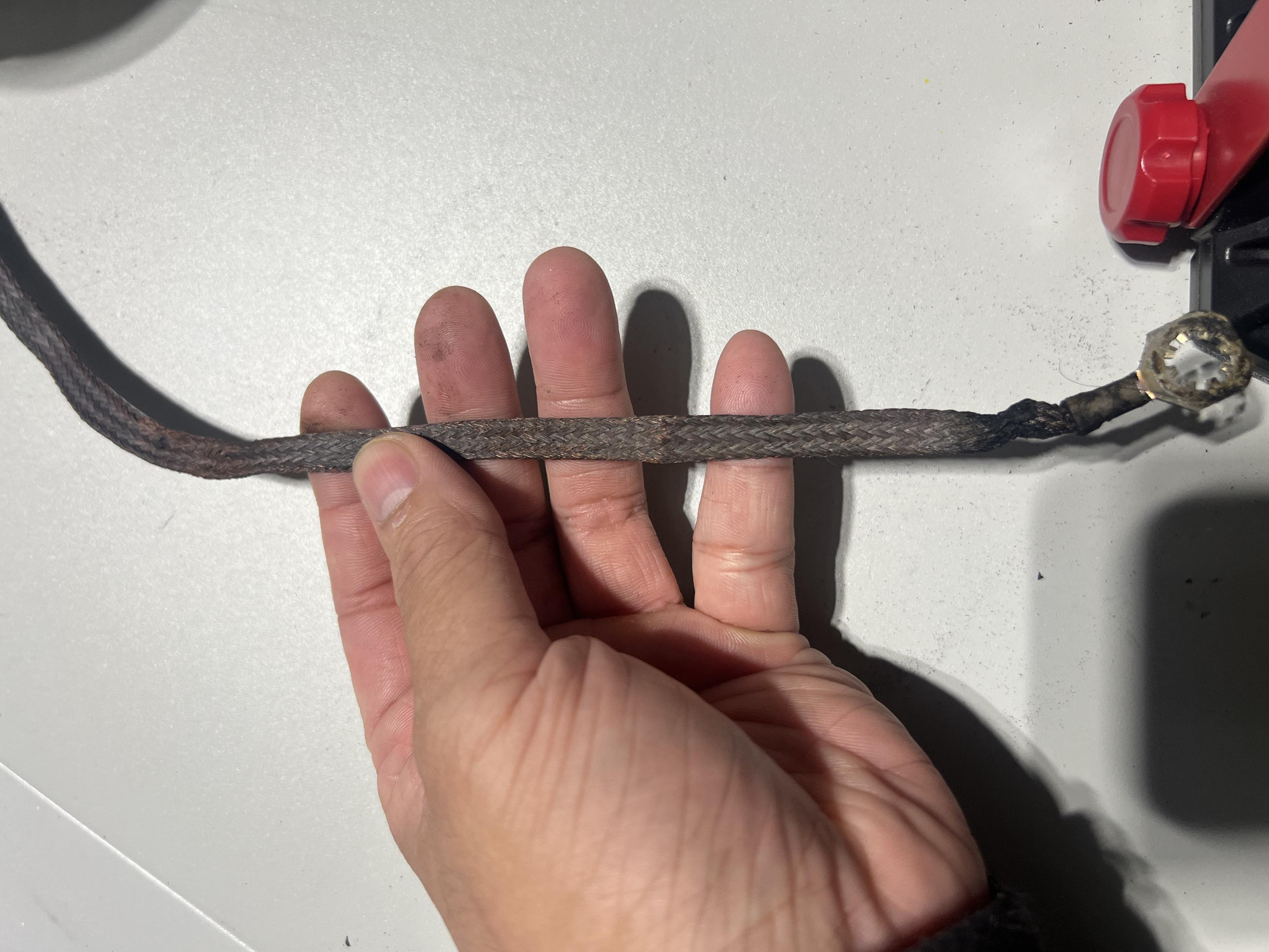

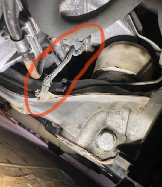

Attach is the ground strap location. It's on the engine cover bolted to the body. You can use what ever strap but use a decent gauge one. Mine looks rough.

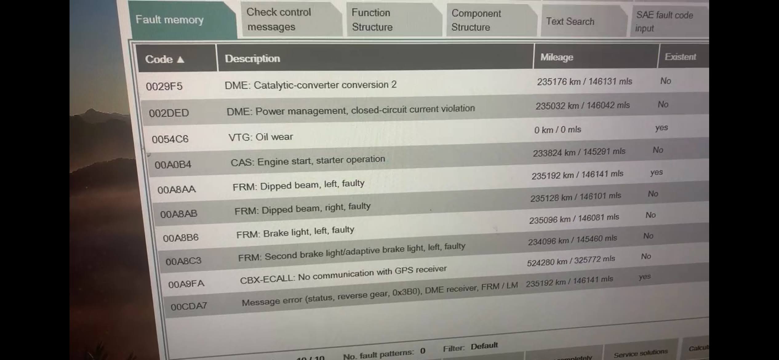

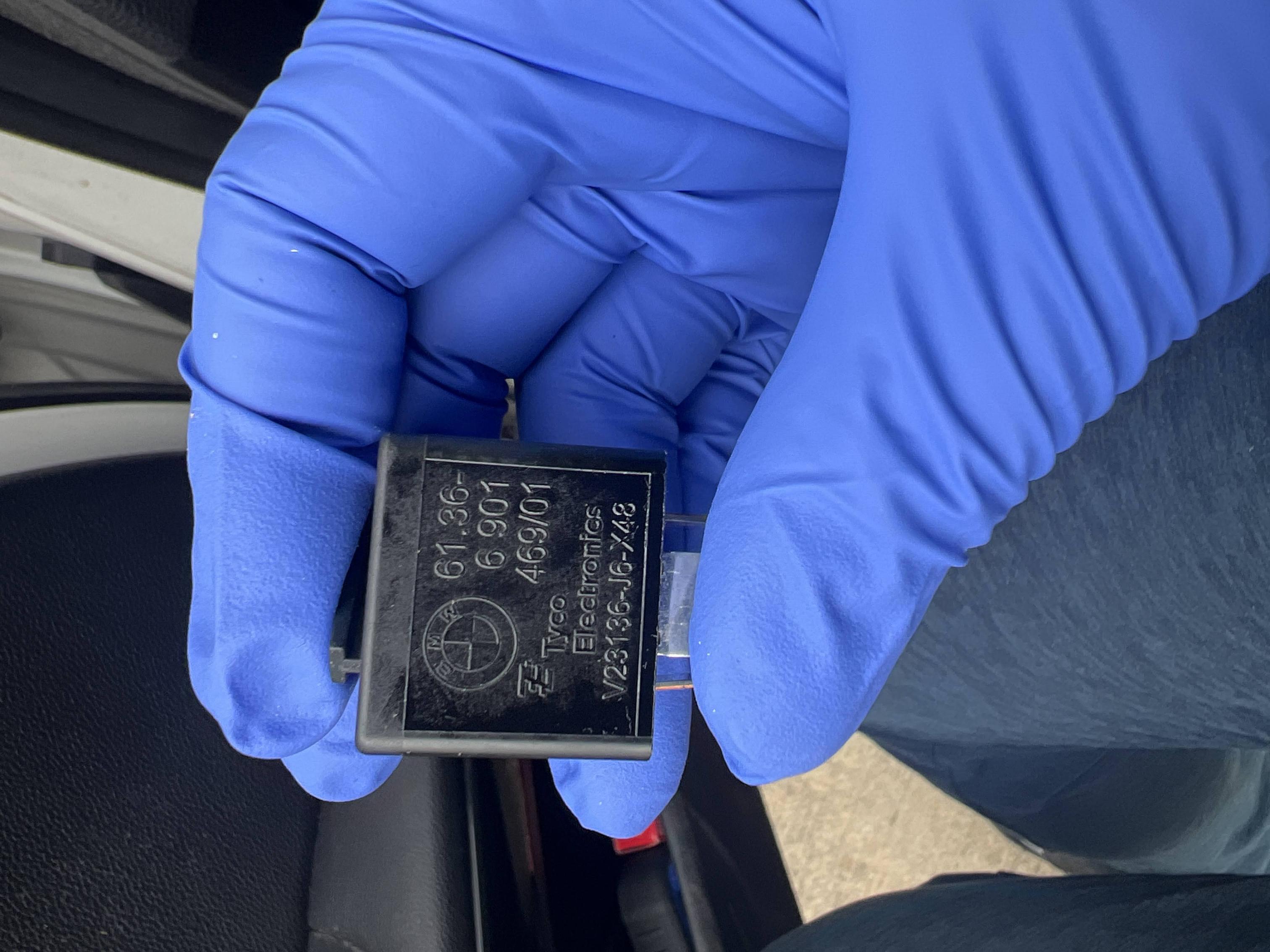

My current problem Car has issues starting (A0B4 Error code)
My symptoms:
-sometimes no starts
-have to charge the battery to get it started (needed full battery or nearly full to start)

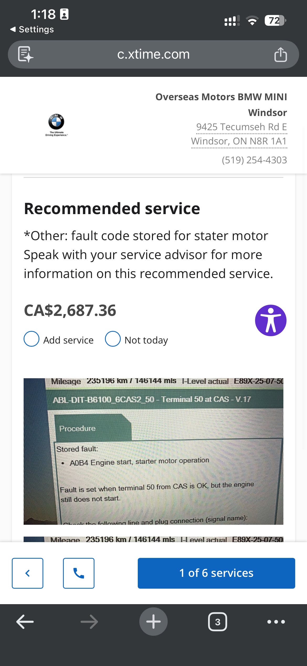

-A0b4 error code - ista says fault is set when terminal 50 from cas is ok, but the engine still doesnt start. BMW wanted $2687.36 to replace.

-replaced the aux relay (behind glove box on passenger, BMW part number 61-36-6-901-469) Same code no change

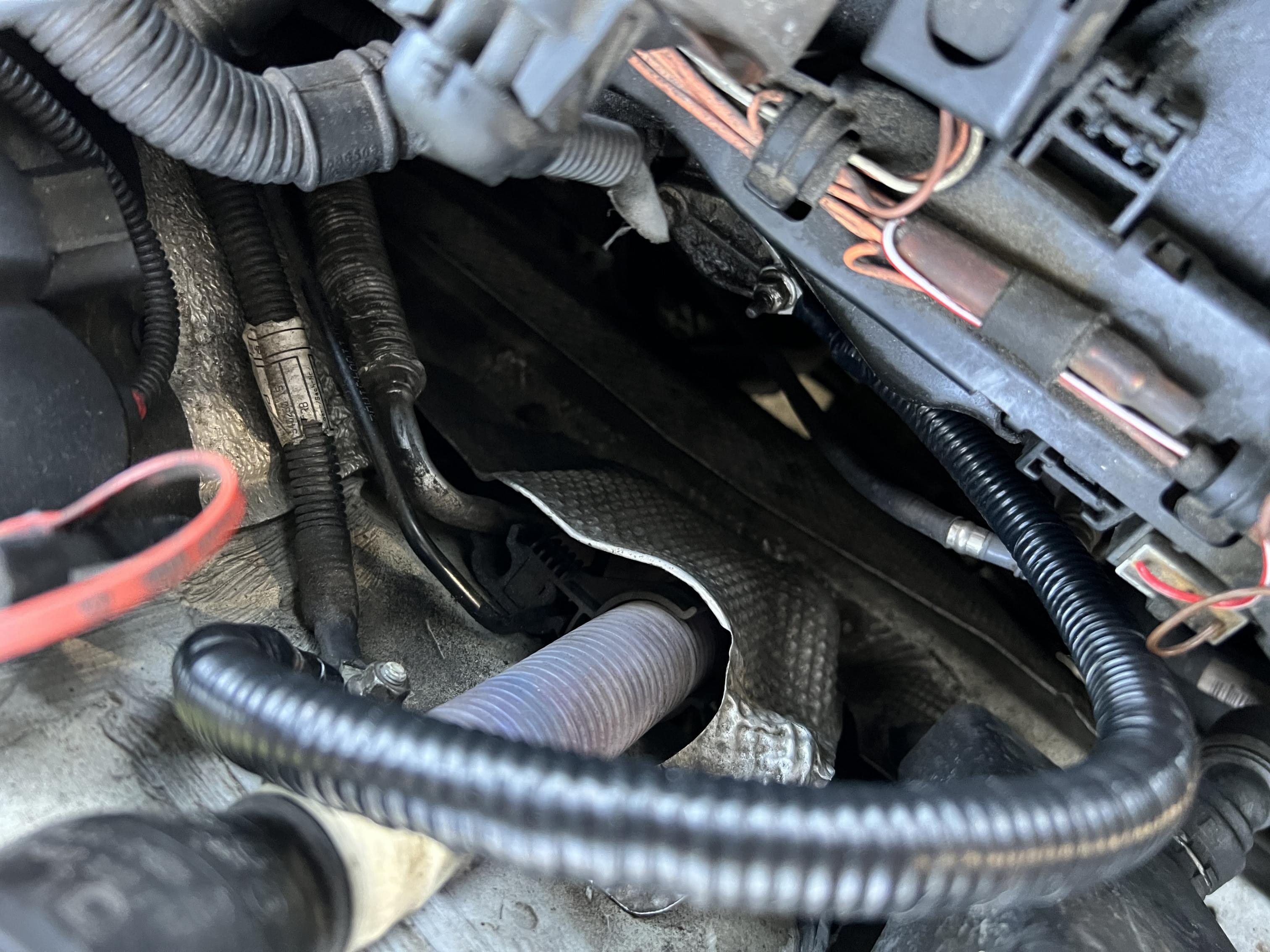

-looked at the ground strap, it looks rough, burnt and I could see some burning on the shielding of a brake line.

There is a 2nd strap under the car that is usually green, I have included an example. But that is usually fine.

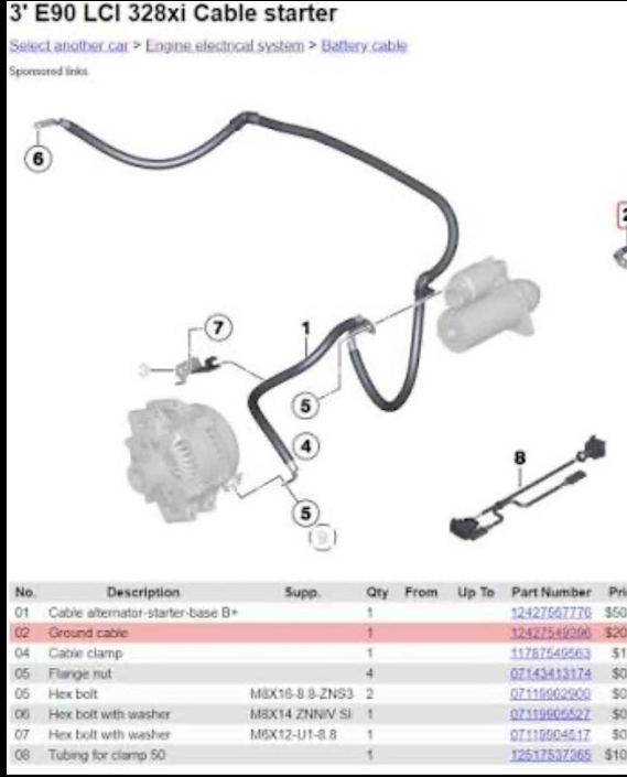

I have also included the a picture of how the positive cable attaches to the alternator to the starter.

Replaced the ground strap with a GM one from amazon (part number 15179982) because it came overnight. Autozone only has gauge 4 wire. It also has shielding, which helps from the heat.
