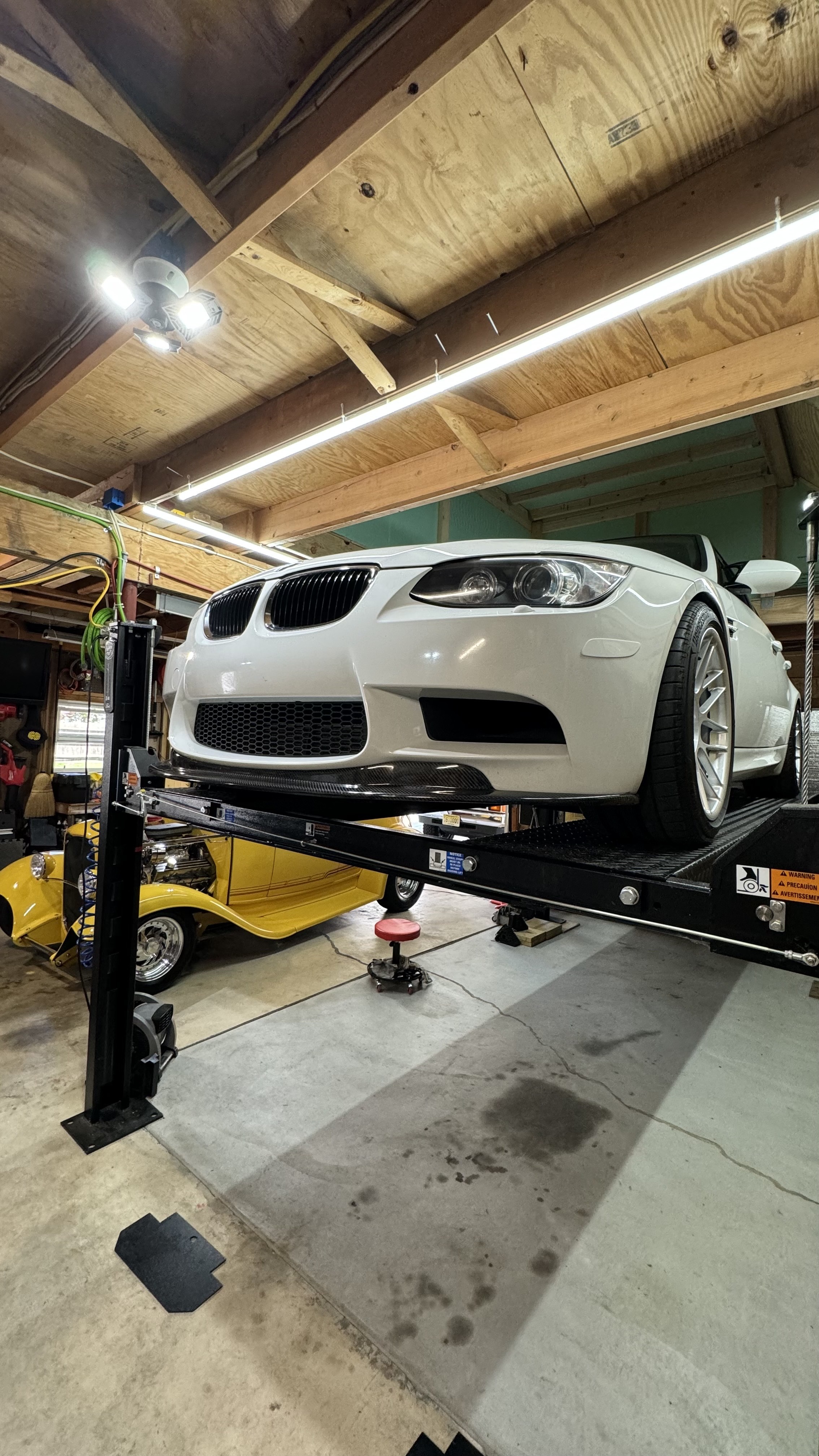

You wont need to pull the pins to get them to fit. These are 275/35R-18 Bridgestone Potenza Sports on 18x10.5 et22 no spacers and stock EDC struts w/swift springs.
I got them from a member on here that ran them with ohlins r&t with no issues also. They will not fit on ST Coilovers or anything without "bee hive" springs without spacers.

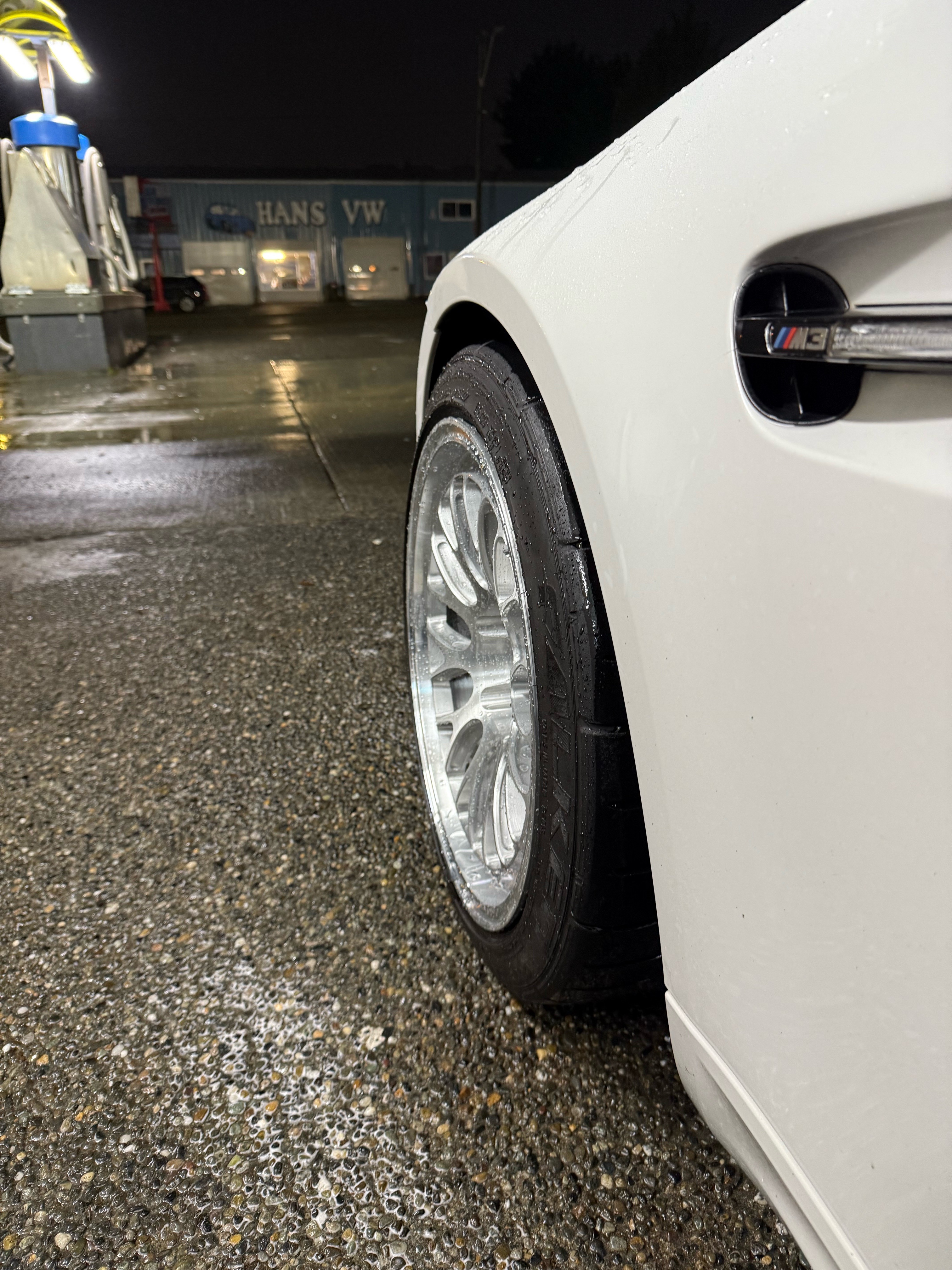

Nice! I grabbed the wheels and am running on stock EDC with no spacers. Checking your post was helpful. Lowering it would help with fitment for sure, but I have no rubbing.
