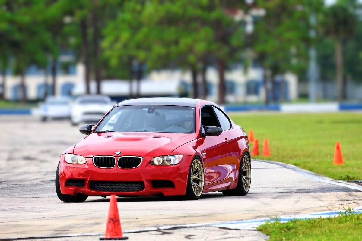

bent 2 fairly easily on curbs imo.
switched to forged apex vs5rs and i'm much harder on them without any issues so far.
Much happier with these:

Could be due to different tracks, speeds, level of experience.
Driving miss daisy sure, you can go decades without bending a wheel. But at higher speeds and in competition it's fairly easy to bend a wheel or two, esp if you have an off. Sebring a track I frequent is known to be a bumpy track with punishing curbs, could be the reason...
How often? Not that often, back in 2012 - 2016, I had a set of Apex Arc8s, two had slight bends, nothing major, balanced out but annoying on the highway drives. 2017 - 2023 had a set of Ta5r, similar issue two had slight bends, nothing major, balanced out but annoying on the highway drives. 2023 - current, vs5rs holding up well so far, had more abuse than the previous two sets (became an instructor/more frequent track days + started time trials competition).
Ask any w2w racer, bent wheels are fairly common even forged sometimes.....

What’s the point of showing pictures of high-downforce prototype and GT3R purpose-built race cars which will be using extremely lightweight forged wheels and replacing them continuously throughout a single season? There’s zero comparison between pro racing and track days (including non-pro w2w, TT, instructor/advanced). I’ve been going to the track for 40 years and instructing for 36 years. Only four bent wheels over this time period and two of them were on the incredibly lightweight 18” SSR Comp forged wheels. BTW, I have three sets of TA5Rs and zeros issues so far. I must not be driving fast enough and/or using curbs aggressively enough

The pictures were to show the curbs at Sebring.
Carrying on, no need to get your panties in a bunch. I'm just stating my experience.

My panties aren’t in a bunch. You stated your experience level and usage of curbs equates to more bent wheels especially if they are flow formed wheels. You initially said TA5R wheels “bent 2 fairly easily on curbs IMO” and then that you need to not abuse them by avoiding pot holes and curbs. Sounds like you think they are complete garbage compared to your APEX forged wheels? Also, did you actually bend them or is it “IMO” they might bend easily? I have multiple seasons on my sets and not a single issue even when aggressively using curbs on track. I personally don’t change my driving style whether I’m on a forged (HRE R40 and R43, Forgeline ZX3R, GTD1 and GZ3R) or a flow form (BW TA5R, HRE FF15) wheel. Some curbs are notorious for bending wheels, forged or flow form, especially when not driven properly or potentially when driven differently for different types of wheels.
