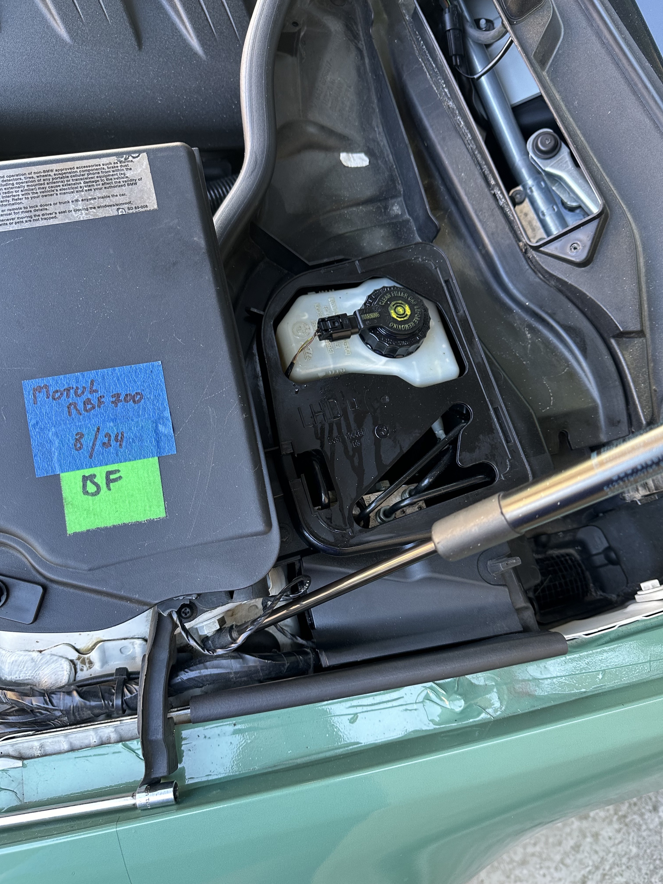

Brake Fluid boil over ?
Has anyone been dealing with this issue?.
I recently swapped out Castrol SRF fluid because I got wind from certain race cars and race series stopped using the fluid because they had brake failure because of the fluid.
I ran SRF in my E36 race car and same thing ….I was getting boil over everywhere. never happened in the past of all my years of tracking.
Open till the week ago, I swapped over to Motul RBF 700 and still getting boil over. Yesterday at Limerock after first session I check everything as usual and walla…it’s back. I’m stumped. Is the system on its last leg of failure ? Brakes are brand new… Stoptech ST40 Trophy with PFC Race Pads stock rear calipers with PFC race pads with upgraded rotors and braided lines.
With my E36 race car I just swapped out the SRF and put in endless 650 fluid as I’ve heard great things. I’ll keep whoever is interested posted.

What level did you fill the fluid in the reservoir? I do it an inch or so below the maximum to avoid venting. It looks like it's on right but I always double check to make sure the two pieces of the cap are on tight.

The level was actually right at the marker, what I’ve been doing for years.
After really thinking about this. I was on PFC BBK front and rear prior to this braking system I currently have. For me…I felt the PFC BBK was a bit over kill for my driving style. I do drive hard and I feel now the system is working alittle harder to compensate. Make sense? Maybe ? I’m dumb

Are you getting total brake loss when this happens? If the fluid is really boiling, you should have zero braking power.

I think you overfilled it

it doesn't "boil over" at the reservoir. you may have overfilled it and it is spraying out as it sloshes around venting off a litte pressure.
a more likely scenario is you overfilled it, then changed brake pads, and it pushed all the pistons back in the calipers, which pushed fluid out of the top.

Beware the vacuum pressure sensor.
